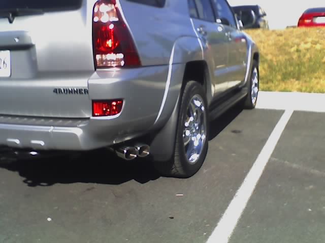

I took this with my camera phone. Not the best quality but you get the idea.;):

Sorry I forgot to answer your other questions. There is no highway drone at all. You can hear the exhaust under acceleration only. At cruising speed and at idle it's quiet. I'm in woodbridge so feel free to stop by and check it out for yourself.;):
