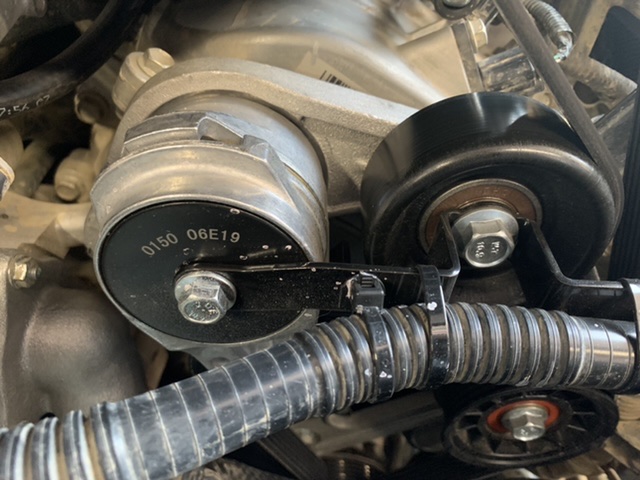

Can I see the other side of the new tensioner you got. I want to see which one I have on my kit. This is the one I have.
Sent from my SM-N970U using Tapatalk
The one you have is the older style tensioner. I had that same tensioner and it was the cause of my issue.

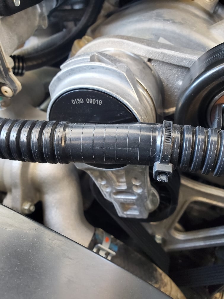

So it seems like the tensioner that I have is a newer one ? But it have a lot of play and the rattle noise is louder with AC on.

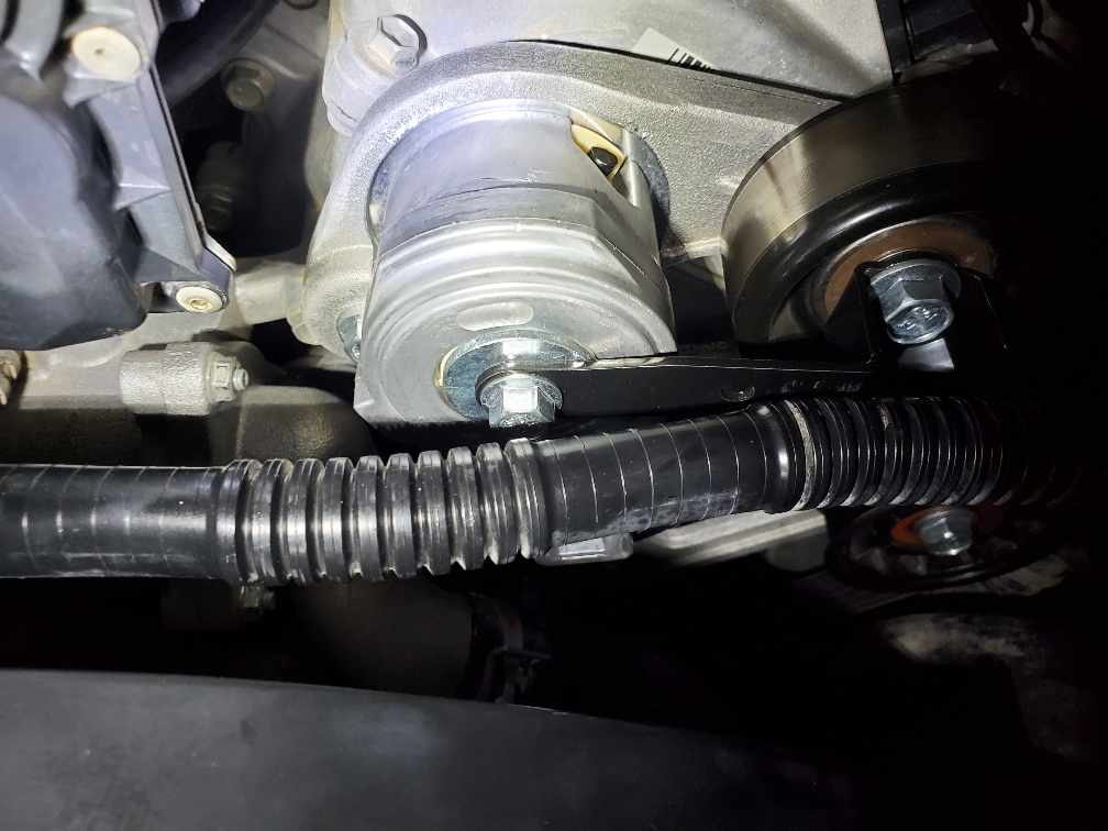

I responded to another thread but I had the same issue. Received a new tensioner and the rattle is gone. The new one is completely different. No black cover anymore. Here is the new one and the box it came in. Several people have noticed that the pulley and other parts look completely different than the dayco part number so I'm not sure if magnuson changes some of the components before shipping it.
