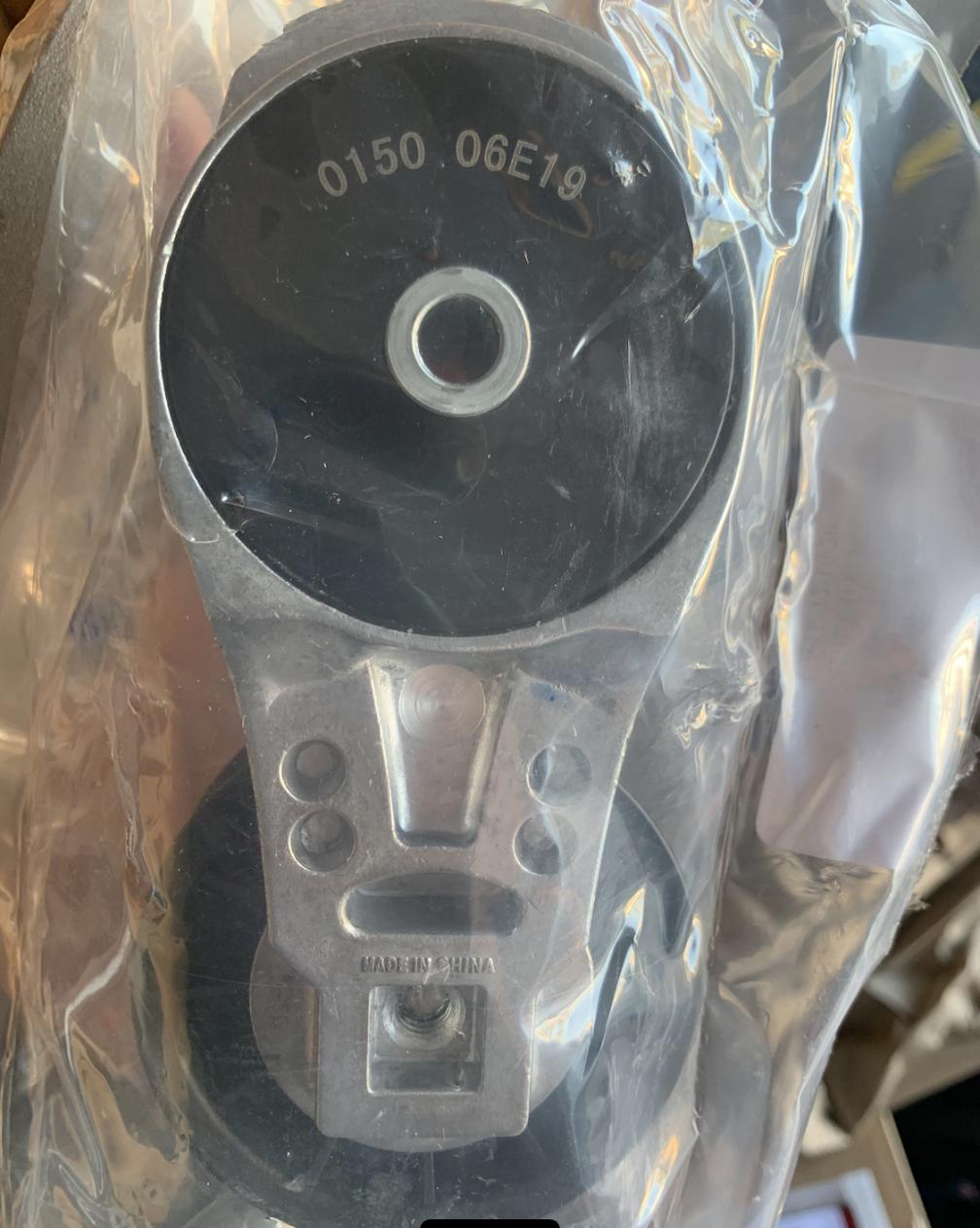

Shipment arrived! Need to plan a weekend for install. Picture of tensioner shipped ~ February 2021.
Thats the made in china tensioner, the same one that goes bad on these kits and went bad on mine. They sent me a made in EU version that is the all silver one no black front different design with a deeper 1/2" drive cutout. The china ones round out super easy w your breaker bar bc they are very shallow and you cannot get good engagement so BE CAREFULL and tape around your 1/2" drive to keep ut solid in there when trying to get your belt off. Maybee use 2 peeps to work belt loose as you use 2 hands to relieve tension. Call/email maggie and demand the non China-man version!
