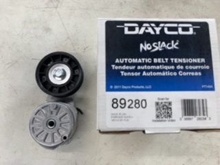

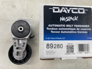

So when I emailed Magnuson and show them a video of what happened. They shipped out a new tensioner assembly ( Dayco) brand also. They shipped it and received within one day! That was impressive !
The new one I got look the same as the one I had with the kit. So I swapped out and so far it’s good, but let’s wait for a few more days until I say it’s totally fixed. I had my SC installed about a few weeks ago. So on the second week that’s when I notice the noise and belt tensioner won’t stay tensioned. Pictures are the new ones I got from Magnuson. Didn’t take a pic of the old one because it’s the same everything.

Sorry but here are the pictures of the new one.

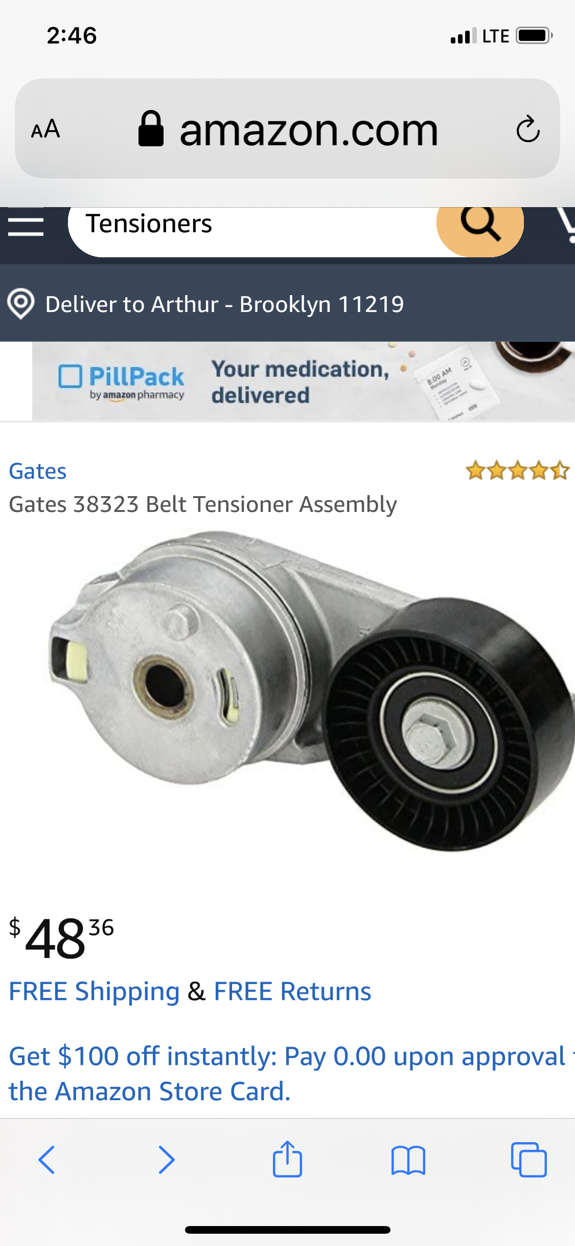

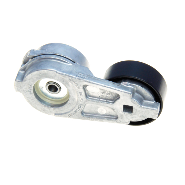

Okay. The reason I asked you this, that there’s no Dayco tensioner that looks like yours. But I found another manufacturer that makes tensioners just like your. If you can look at it and tell me what you think? Thanks
Look up 4861277AD, it’s a Mopar part number, from a 2.4L Jeep Wrangler. This part also matches the Dayco part that comes with the kit. Might be something worth looking into.
I would need to see the other side unfortunately. I did a search on Google with the part number you have there and this looks like it may be the other side which looks nothing like mine either.
