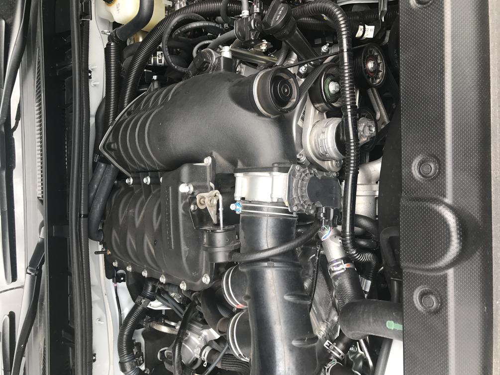

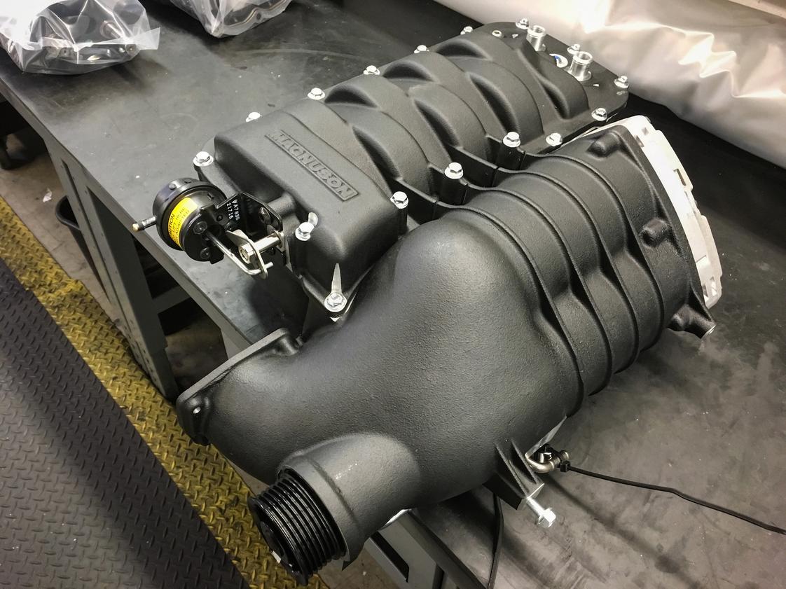

Installed in Magnuson Prototype Vehicle
More images to come
