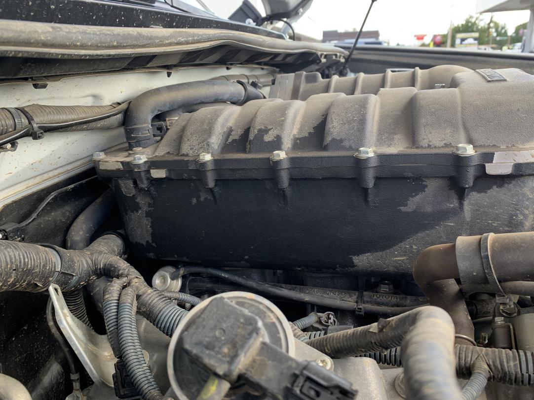

So I noticed this damp marking on the side of my magnuson SC on Tuesday 9/17/19 when stopping to air up in Crested Butte after a day of light wheeling. I had just travelled from Kansas City to Crested Butte on 9/15 just 2 days before. I can say I never noticed this damp spot any time recently. It’s fresh and still damp to the touch.
Waiting on my local shop and Magnuson for some answers.
It’s now 9/20 and I just did 3 days in Ouray and been checking the marks/wetness daily since did I noticed it in Crested Butte. I’m in Denver now, still 9/20/19. It appears that the dampness is so slightly growing and still damp (not dripping) to the touch. I mean it’s growing but very very little.
Any thoughts/ideas what’s going in here?
My coolant reservoir for the SC is still at good levels and I see no other fluids/leaks around the engine bay. I have put 17k miles on it and only been at altitude above Kansas City (about 900’) for the first time this week while in Colorado.
