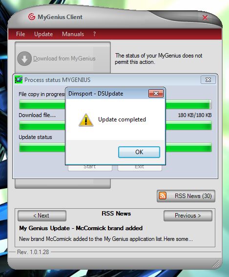

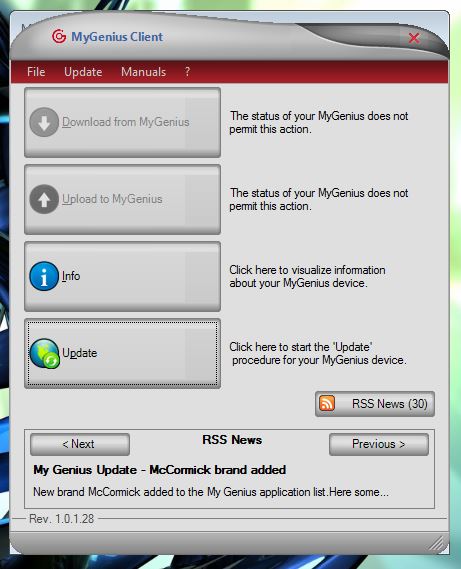

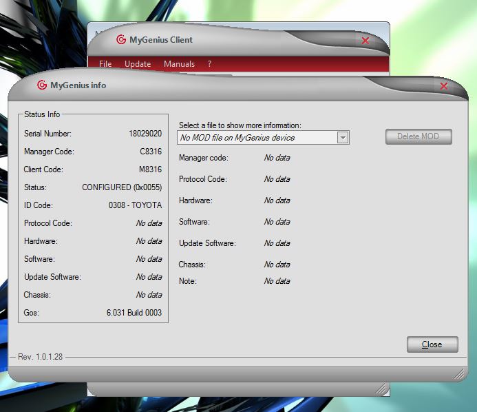

Was going to start the process of uploading my stock map to Magnuson for configuration, but ran into the same problem as some other people with the handheld tuner connecting to the ECU. I get to step 16 where the handheld tuner is identifying the correct serial protocol, and then nothing, it just gets stuck. I made sure to follow step by step, and was able to successfully update the handheld tuner with MyGenius client several times. Anyone know what's going on? I contacted Magnuson, just waiting to hear back from them. I'm hoping I don't need to send in the ECU and handheld tuner. This kit shows a build date of 8\8\2018
I would've hoped they had ironed out the bugs with the handheld tuner by now. This is on a 2017 SR5 Premium 4x4

Figured out the problem. Just a heads up for anyone planning on doing this kit. If you have an aftermarket alarm, or any electronic that ties into, or uses a T-harness for the OBD plug, make sure you connect the handheld tuner directly to the OEM OBD plug, and not go through the alarm. Although the alarm states that it doesn't interfere with any servicing through the OBD plug, apparently it's somehow interfering with the communication protocols that allows the handheld tuner to connect to the ECU. After I did this, I was able to connect, and download my stock file within 5 minutes
Sounds about right. Most OBD-II devices have a auto-disable or inability to write when they detect something else connected to the OBD-II port/bus. It was never designed to run multiple devices the way we've started to use it. The UCON-EMS box required for the URD SC is always on, I have to set the Kenwood/Maestro head unit to "Always On" setting as well in order to get the gauges pages to work properly.
