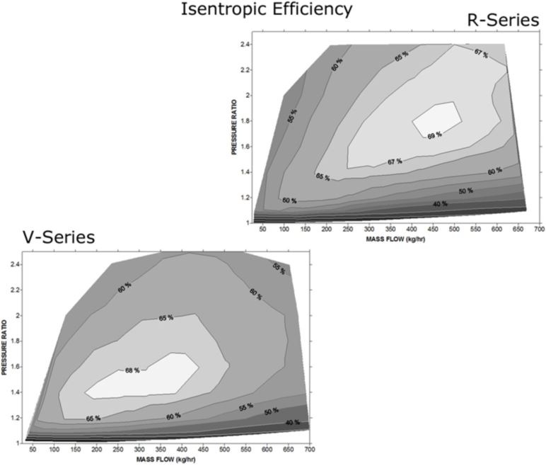

It would be nice to get some details on the rotor pack they are using in this unit. I've seen conflicting info if it is a true TVS rotor pack or not. What is the twist angle and how many lobes? I've seen mp90 listed for the old 1gr kit but not sure if that is just the size as I remember that model being around for a long time with the old 60* lobes. Seems like they went to cc based number for all the TVS units.
It’s a TVS 1320. Same rotor size and type as used in the Eaton supercharger for the Audi V6. TVS is 4 lobe, high efficiency with 160° degrees of twist. Yes the TVS units are all called out in cc’s. A TVS 1320 is 1320 cc per revolution or 1.32 liters per revolution.
Another techy tidbit: they also using the large charge air cooler from the Tundra kit. That is the heat exchanger inside the supercharger, not the one mounted in front of the truck.
Hope this helps. More coming down in the coming days.
Great. TVS is a much improved design. Wonder if it is a R or V series pack...
For those interested in the tech bits... Here is the Isentropic Efficiency maps for the two different TVS rotor packs.
Looks like the V series would be a bit more efficient for this application. I think we would mainly be in the 1.4 pressure ratio and max flow around 400 kg/hr.. Pressure ratio is map in bar... pretty sure 1.4 pressure ratio = ~6psi at sea level...
From Eaton...
R-Series
4 Lobes
High pressure ratio capability of 2.5
Highest efficiency at higher pressure and high speed
Aimed for single boosting device where a lot of flow is needed
V-Series
3 Lobes
Highest efficiency at low pressure and low speed
Aimed for single boosted engines with low end torque need and twin boosted systems to power the low engine speed map
