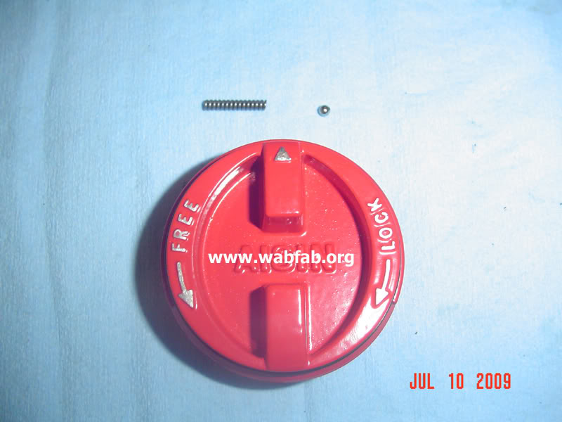

so i was re greasing my hubs and wanted to paint them to look nicer well when i took the center dial out besides the orings being dry rotted the little ball and spring things dissappeard well how important are they and where can i find new ones

Important!
That keeps the dial in the locked or free position.
When you lock your hubs in, that click you hear is that ball sitting where it needs to keep the dial in place.
That way it doesn't unlock by itself. If it unlocks under load, you could destroy the cog gear in the hub.
that makes sense my hubs are really hard to turn as it is right now i think it just needs to be worked in a bit any other ideas or guess on cost for them i need both sides

Like Kid said wabfab.org has them for $12 per side.
damn thats 50 bucks for both sides and the o-rings but i guess right now i need to get my new motor together and in before i think about going wheeling with it

Couple years ago (Must have been 4th grade) I was rebuilding my hubs and also lost the spring and ball, we were all going out that afternoon, and with no way to get a replacement, I threw it back together and hoped for the best. Ive been ball less (HAHA!) in my left hub all this time with no issues.

Hey, OP? I don't know how much hubs go for at the wrecker, but if you're already spending 50 bucks that's something to think about, and then you'd have a spare or two to boot.
