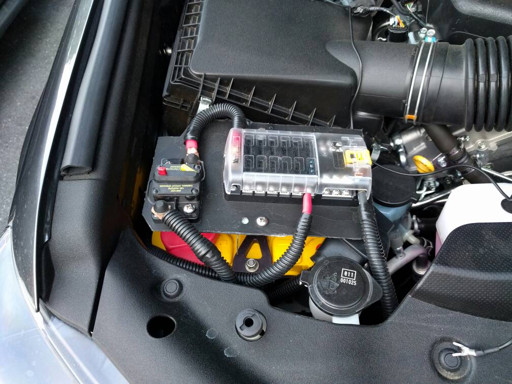

One other option, if you're not dead set on the spod, is to fab up a bracket to mount your secondary power distribution in the space over your second battery. This will keep your firewall/driver's side area open for your compression w/ the Slee mount.
I just used two pieces of 2" angle aluminum bolted together to make a C-bracket. Then bolted my fuse block and breaker onto a platform made out of a thick plastic tray. Bolted the combined part to the C-bracket and slipped the C bracket under the battery hold down before tightening it down. Total cost was ~$20.

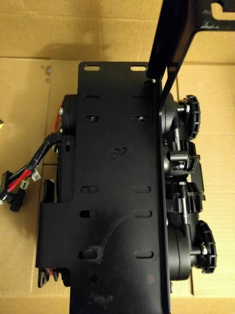

As timing would have it, my 2016 variant Slee compressor mount arrived this evening. Excellent quality and finish, though I did have to drill two extra holes to get my ARB twin closer to the DS fender. Drill markers faintly visible in the bottom of this pic.
I ran out of time on the installation this evening due to the minor bracket mod, but should have it in by tomorrow or Wednesday. Will post pics to my build thread once my post count is high enough.

I have a '12 mind you, but this works great for me
20150703_221450_zpsspvpohhm.jpg~original
-group 31 optima in a pelfrybilt cage in the back
-BIG air zenith ob2 and manifold in the front
-blue sea power distribution on the stock fuse box cover
-relays and blue sea mega fuse holders where ever I could fit them

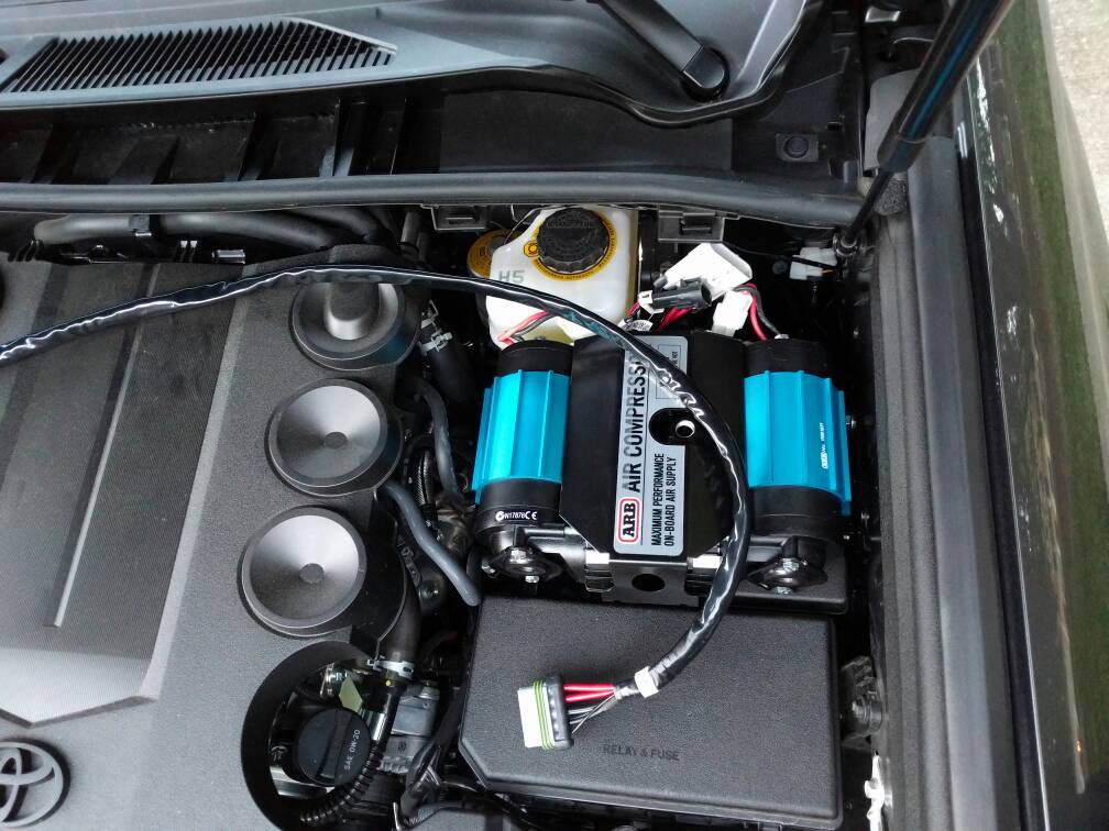

Quick follow-up here to report back:
The compressor fit like a glove in the space the bracket was designed for - excellent build quality and tolerances on Slee's part.
I had to/chose to drill two holes in the bracket that would allow me to mount the compressor closer to the DS fender to provide a little extra room to avoid rubbing on a pair of hoses (see obligatory pic below).

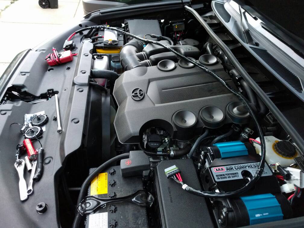

That looks good. I'm really curious to see how you deal with the ginormous ARB wiring harness by the master cylinder.
Thanks [MENTION=68685]Ducmonsta[/MENTION]. That's high praise coming from you. I've been stalking your build thread for some time now.
You're right, the connections at the rear of the compressor were *very tight* tight due to the size of the plastic disconnects and the lack of slack cabling on the compressor-side of the connections. I slipped in a couple of small lengths of wire conduit to protect the wires from the master cylinder and bracket rear as best as possible and routed the connectors into the dead space over the firewall grommet on the DS.
The worst part with that harness, at least in my under-hood setup, was the giant 40amp fuse bumps that I had to squeeze into my already cramped secondary power area up front/PS.
I was already rushing due to losing daylight and ended up routing the harness twice. First starting at the battery, foolishly thinking that I'd have plenty of length on the connector end. Then second, starting with the connection made at the compressor and routing towards the battery. Didn't have an inch to spare once all was cable-tied into place.

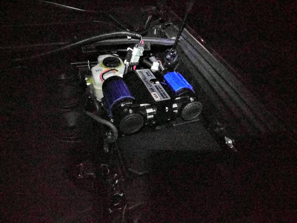

I ran out of daylight at the end of the install tonight, so poor picture quality below. I basically rotated the connector (at 12 o'clock in the below pic) into the 3 o'clock position once the wire conduit was in place. I'll try to remember to grab a daylight pic or two of the harness routing and add them here in a follow -up post.
Alright. Quick follow-up to my follow-up:
As promised, I grabbed some daytime pics of the install and harness routing this afternoon. Pics attached below in no specific order.

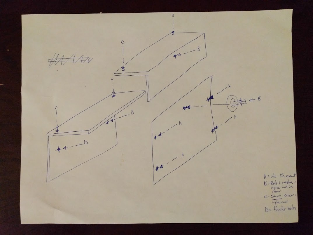

On to your question regarding the Intelligent Solenoid (IS) mount:
I, of course, threw out all of my mock-ups and measurements so the below is an off the top of my head, but should get you pretty close along w/ the attached (admittedly half-assed) diagram:
1) Head to your local Lowes
2) Locate a bar of 2in angle aluminum (could only find one in a 6 or 8ft length), but it's cheap
3) Locate a flat sheet electrical box cover in the electrical section ( here's an example -- http://www.lowes.com/pd/Raco-2-Gang-Square-Metal-Electrical-Box-Cover/
4) Measure the width of the two rearward PS fender bolt holes + ~1in (to allow for a half inch overhang on either side)
- This part is going to sit very snugly above a factory white plastic bracket holding several wires/harness
5) Cut two equal lengths of aluminum to the above width to make a C-bracket
- Drill two holes in position D for the fender bolts (see diagram below)
6) Cut the flat plate to accommodate the footprint of the NL IS + 0.25-0.5in greater length
7) Spray paint or plastidip the plate and angle aluminum sections
8) Drill holes A, B, and C (indicated in the diagram) to accommodate the various bolts you've selected
- Do a test assembly to ensure that your bolt lengths will not bump into each other when fully assembled
- More importantly, ensure that your bolts will not rub on the white plastic wiring bracket and/or wiring harness *AT ALL*
9) Crack a cold one and begin assembly of the each of the 4 parts:
- Connect two of your parts by installing bolt B
- Attach your NL IS onto this assembly via bolts A
- Mount the remaining unused bracket component onto your fender at holes D
- Complete the assembly by installing bolts in position C
- Verify that your factory harness is clear of all tolerances
- Connect up your primary and house power
- Verify charging of both batteries after 5min IS delay
- High fives all around and grab another brewski
I'll get this into my build thread in greater detail and some pics once I reach my minimum post count... soon hopefully.
