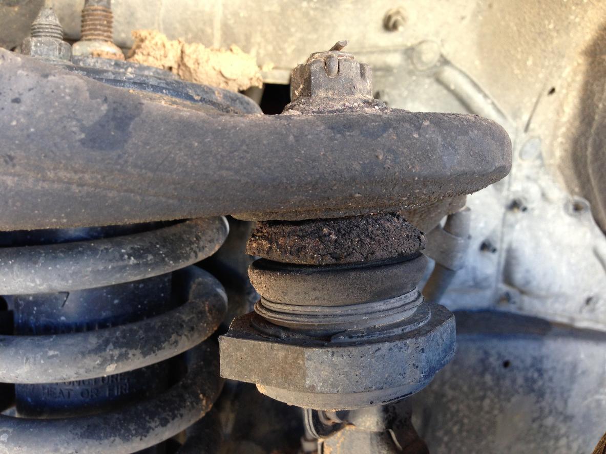

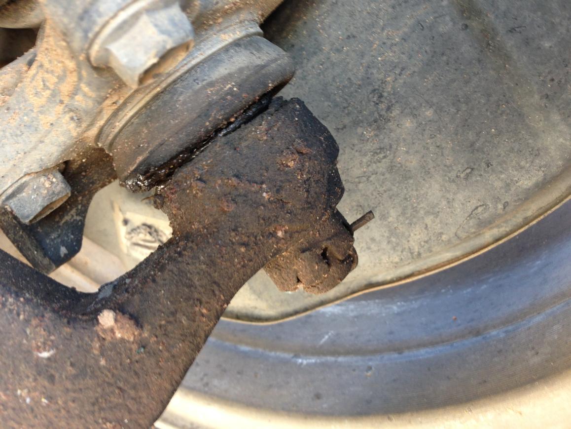

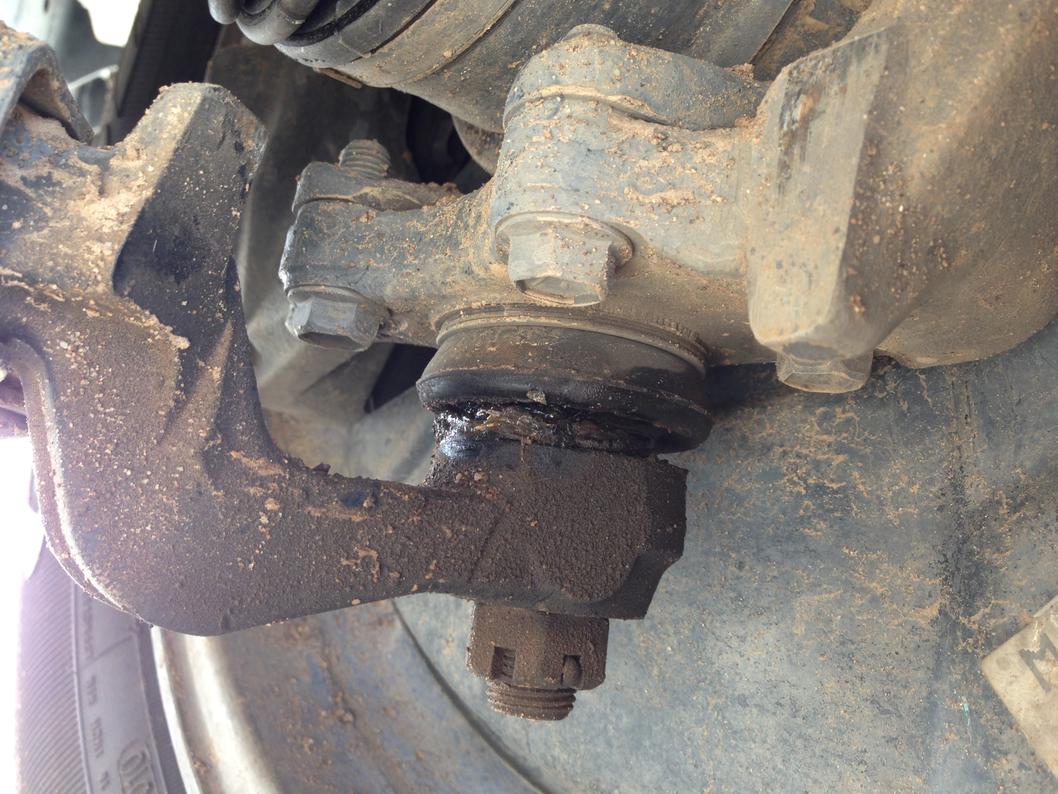

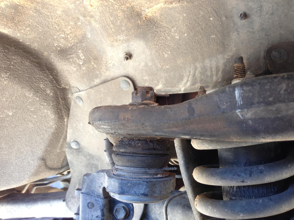

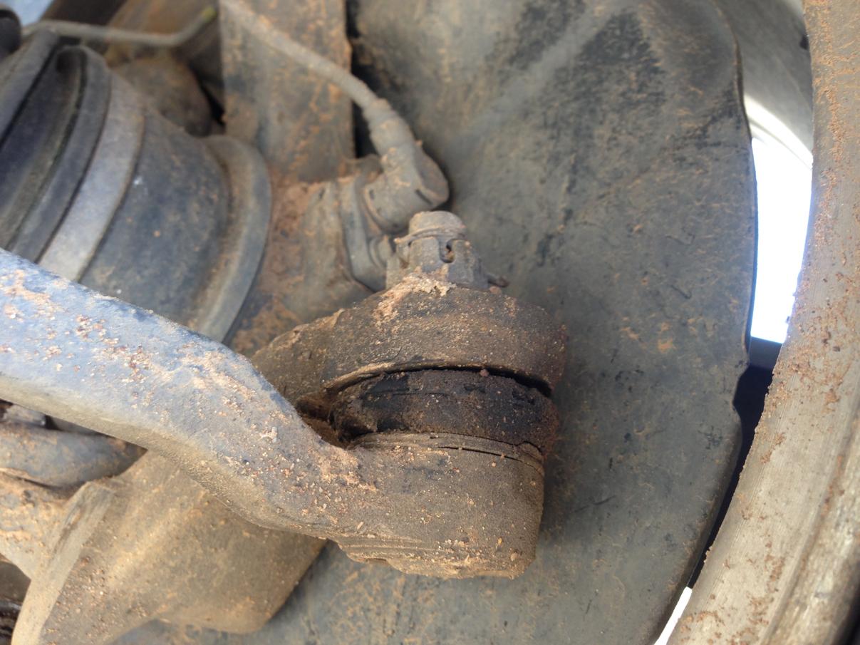

thought id add a few pics of my ball joints and tie rods, don't know if they should have so much grease around them? im still new to 4runners and Toyotas in general and any advice would be greatly appreciated. found this on ebay, are these reputable parts or just crap?

All the advice I've read says go with Toyota parts. I buy the lesser items locally and generally get a 15% ish discount because it is a common practice and I ask nicely.

LBJ Went with the Napa Brand. Got U-Joint the precision ones at O'relilys. They have zerk fittings, so it's nice to be able to grease everything. And for inner and outer tie rods went with the tacoma ones at Napa.
Alot of guys will say go OEM, but I feel like Napa has comparable quality and is cheaper, which for a college student makes the world of difference.

Man, I'd stay away from Ebay parts on my suspension. I don't have faith in China made parts. And im not sure on the greasing part. Mine are all sealed so there isn't much I can do (2wd :( )
I have a few pictures from my install and there is a great youtube video of them doing it online to a tacoma. If you have any questions feel free to PM me.
Most members here would recommend only using OEM parts, myself included. Get new OEM bolts with the LBJ's and apply some Blue Loctite, if peace of mind is what you seek! Also consider a trans cooler, B&M 70624 is the most used here. I have the 70268 but experience high temps when driving at slow speeds in 4hi.
