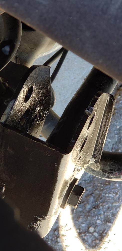

But it's cool that someone is trying it. I have a problem with bending my rear link already (the fixed side looks like a banana) so dropping it another inch or two would make it more of a problem in the rocks. The front would be a problem with skid plate interference. And the front would be easier to put a spacer plate on the KDSS mount on the control arm to raise that point an inch or so.

Yeah the front is no go really and the piston is in the exact same spot with my 2” of lift because the hard link on passenger side doesn’t allow the sway bar to go lower. Well maybe a tad bit with bushing flex. The sway bar just pivots down with the lift. Only issue i see is the bushing prematurely wearing because it’s kinda binded at ride height and then you introduce more droop with an extended travel coilover.
As for the rear , at full bump , the sway bar is still sitting higher then the full cell so I don’t see it being an issue but I totally know what you mean about rock crawling and full compress , it has a higher chance of getting hung up but I don’t think it will.

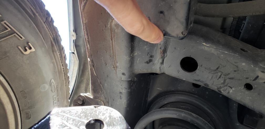

As for the correction bracket you mention, I like the idea but same time the one that eimkeith makes is cool but I don’t like that I limits the up travel. I am doing some r&d on my own bracket. I think it just doesn’t need to be that high. Or I’d go up one bolt hole then cut off the rest. You can see bellow that it will contact the frame cross member trying to achieve full Oem bump location. Which my setup allows.
