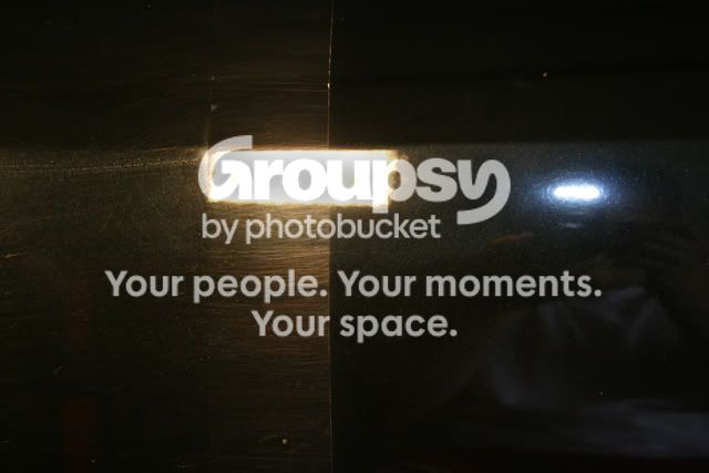

Heres a 50/50 of my ex gf's paint after one pass:

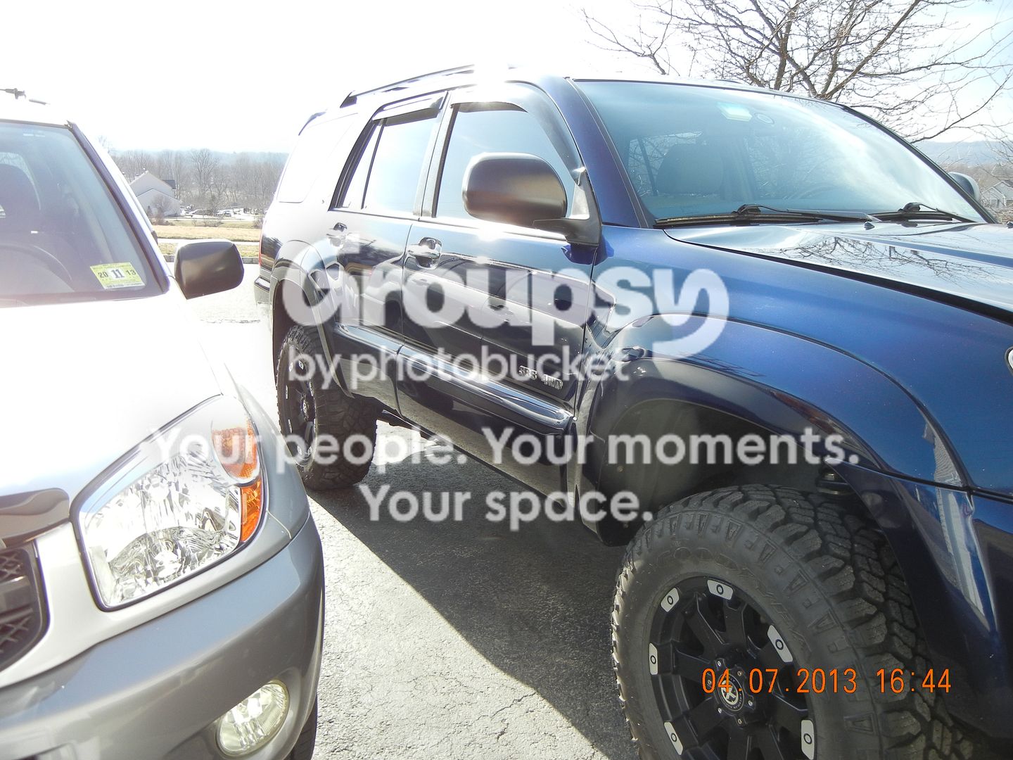

My Land Cruiser when I first bought it:
After

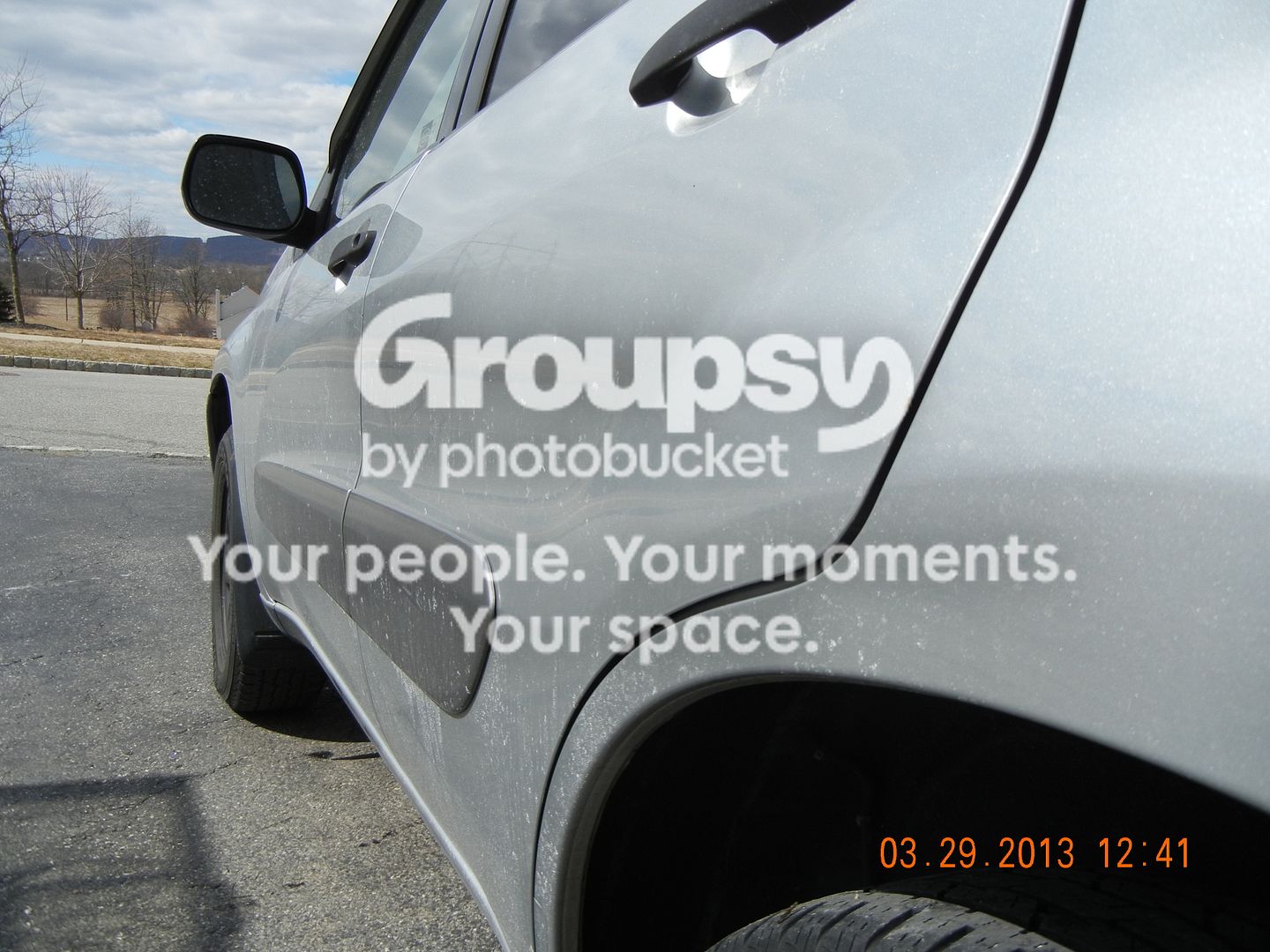

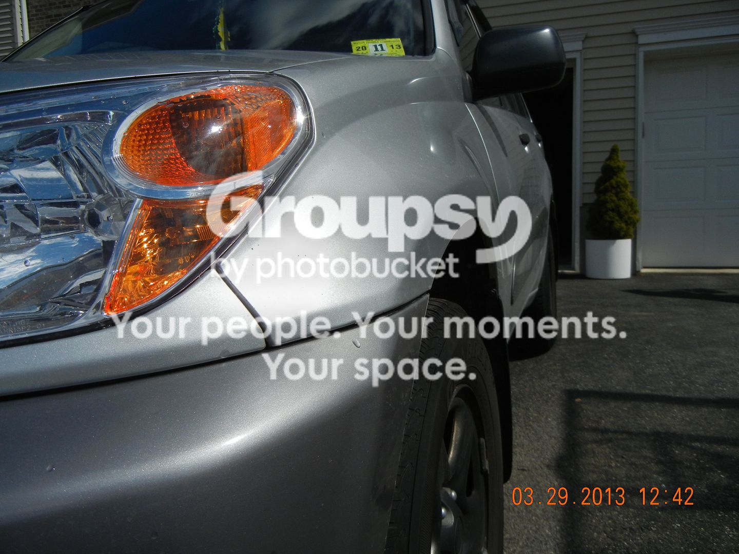

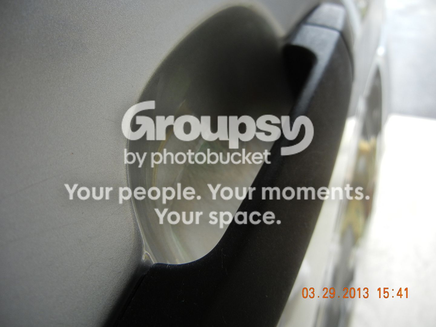

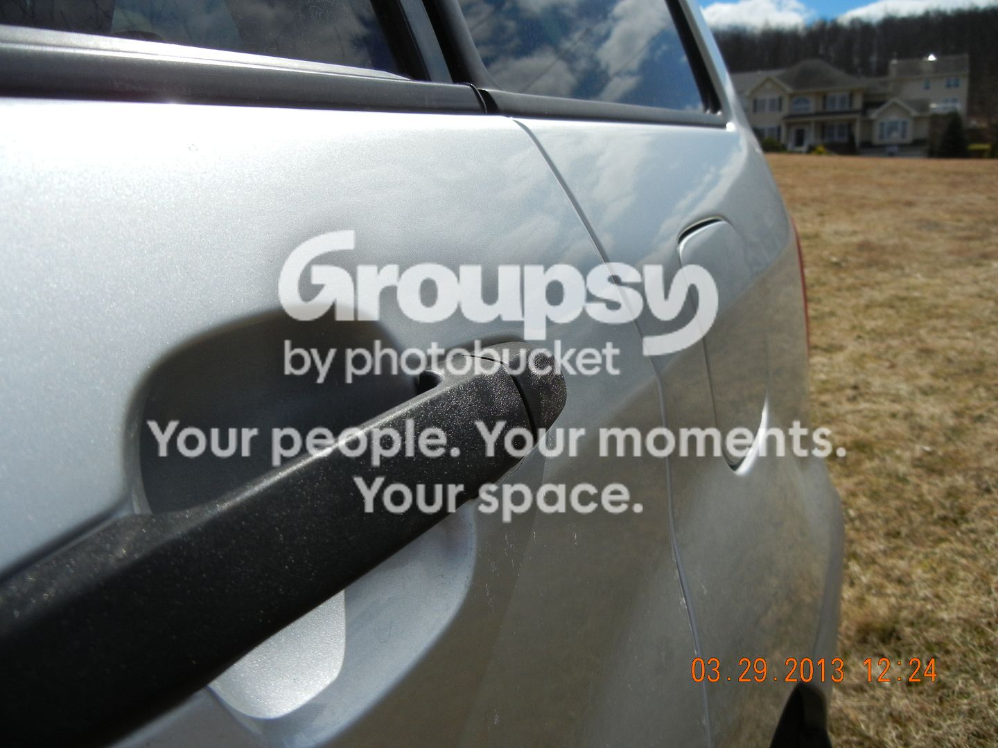

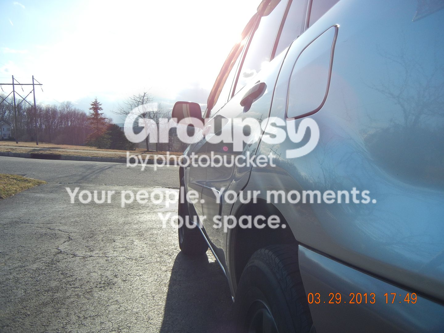

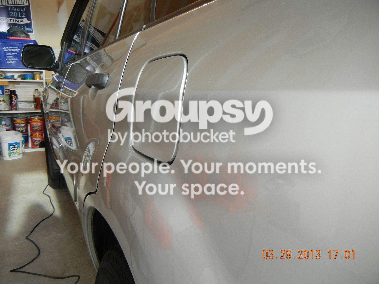

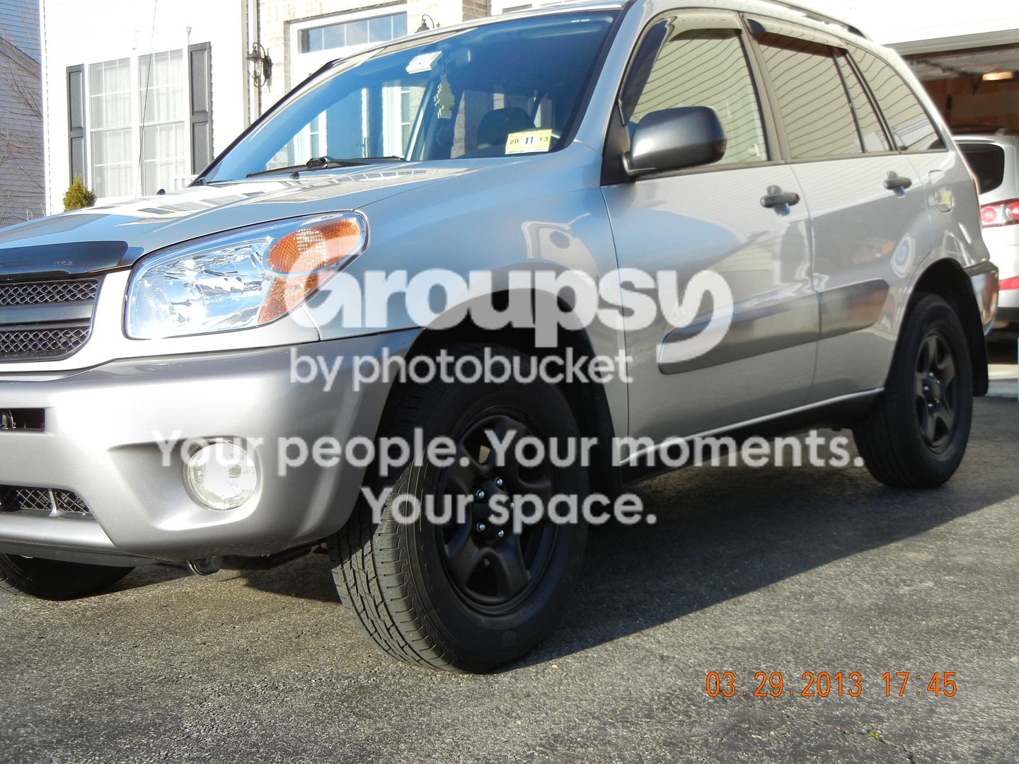

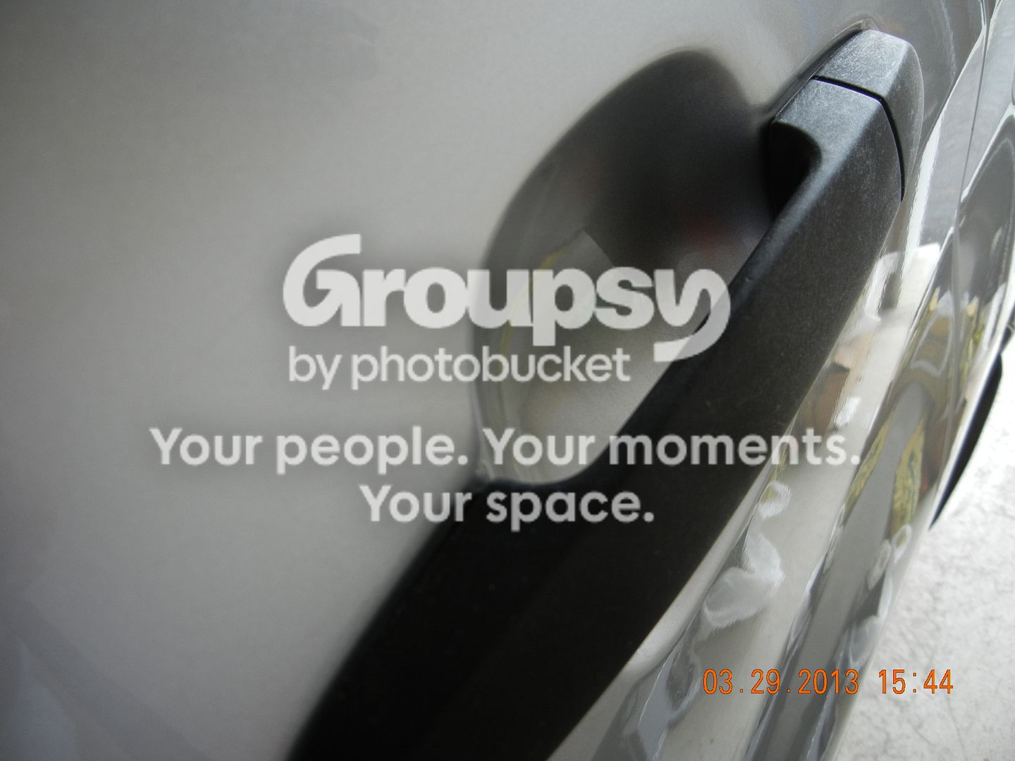

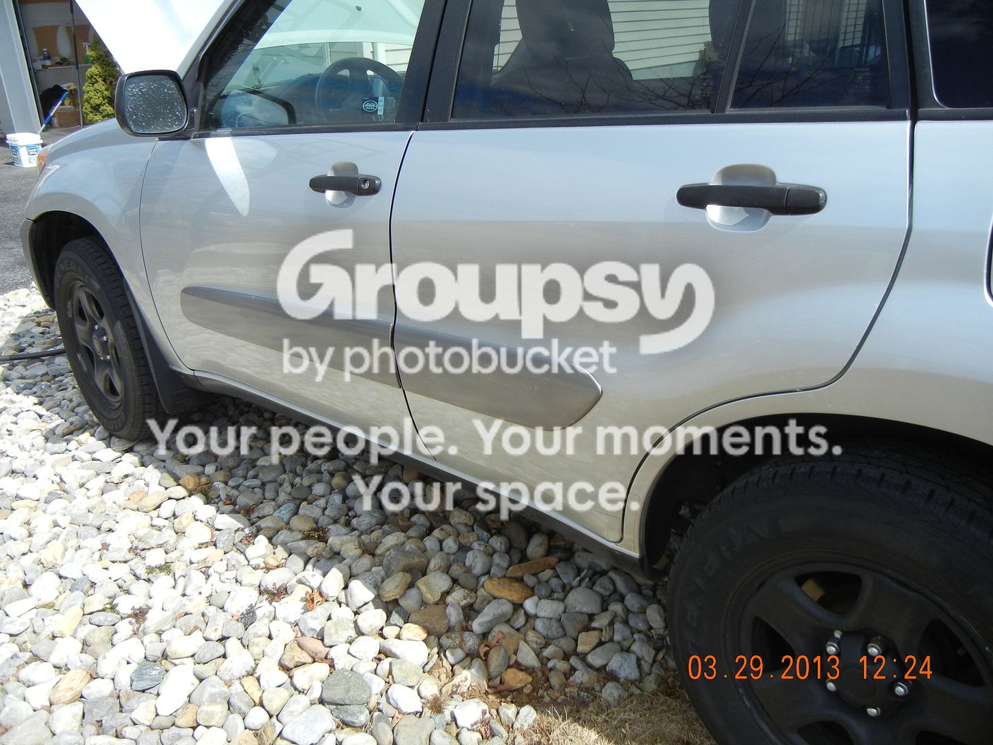

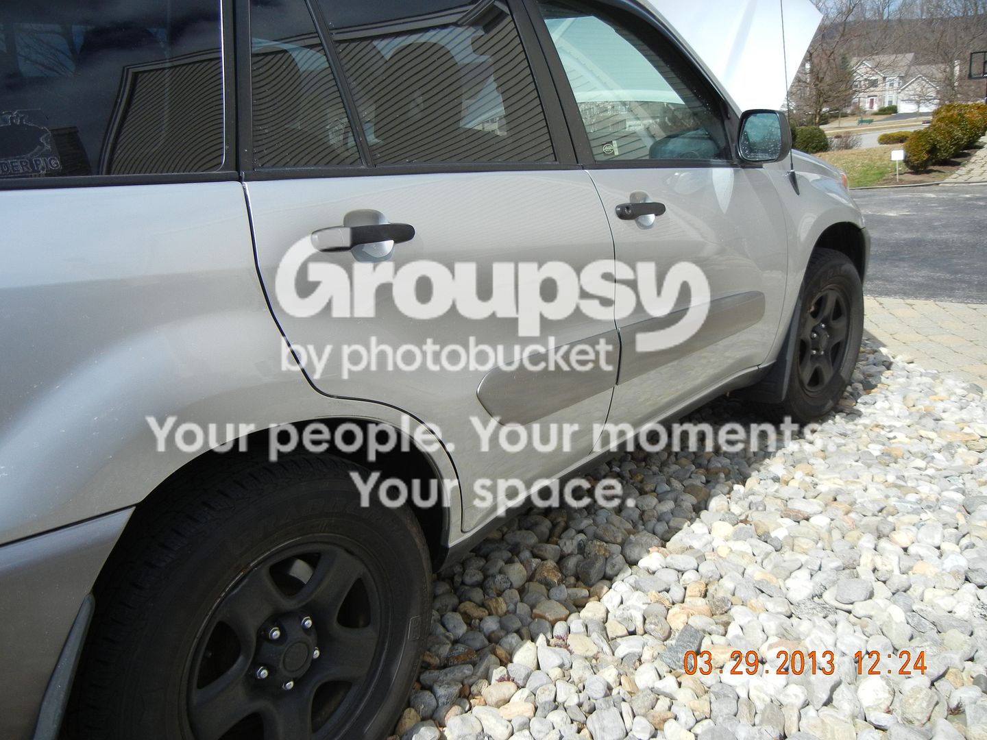

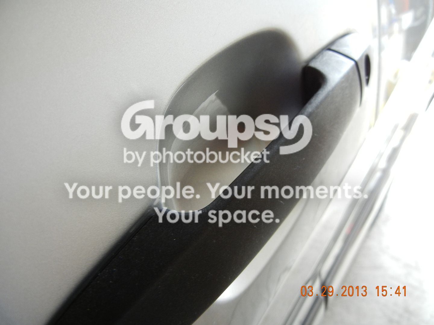

I detailed my sisters car this weekend to practice before doing my 4Runner, hopefully next weekend. I skipped M105 and went with M205. I washed and dried it, clayed it, M205 with my Griot's Garage DA Polisher, and hand waxed with Meguiar's Gold Class Liquid Wax. It's a silver car so you can only get so much reflection out of it, but I think it came out pretty good. Looking forward to doing my truck. I will do M105 on the 4Runner.
Before:
DSCN1393_zpsede3a601.jpg~original
After:
DSCN1407_zpsf41792c4.jpg~original
Mike,
The little RAV 4 turned out well. Silver, next to white, can be the hardest color to have "pop" out at you.
I hope you are enjoying the Griots DA. For the price and lifetime warranty, it cannot be beat for getting the job done. Once you get the hang of it, buy a 5 inch backing plate and some 5.5 pads. They will work even better than the 6.5 pads. Just never lose the little washers for the backing plates.

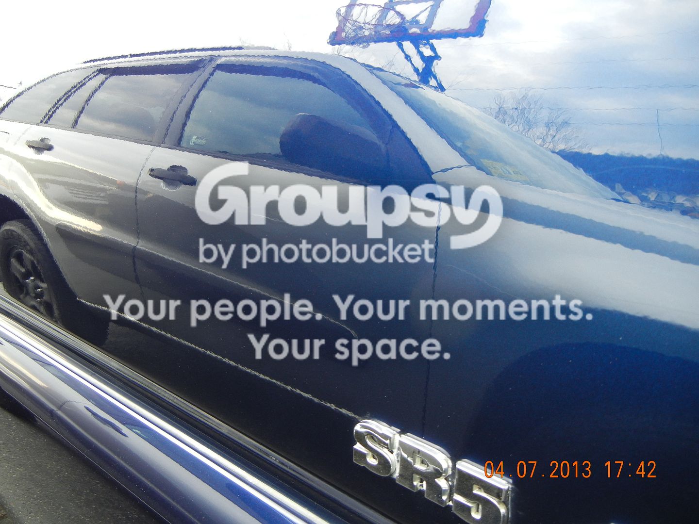

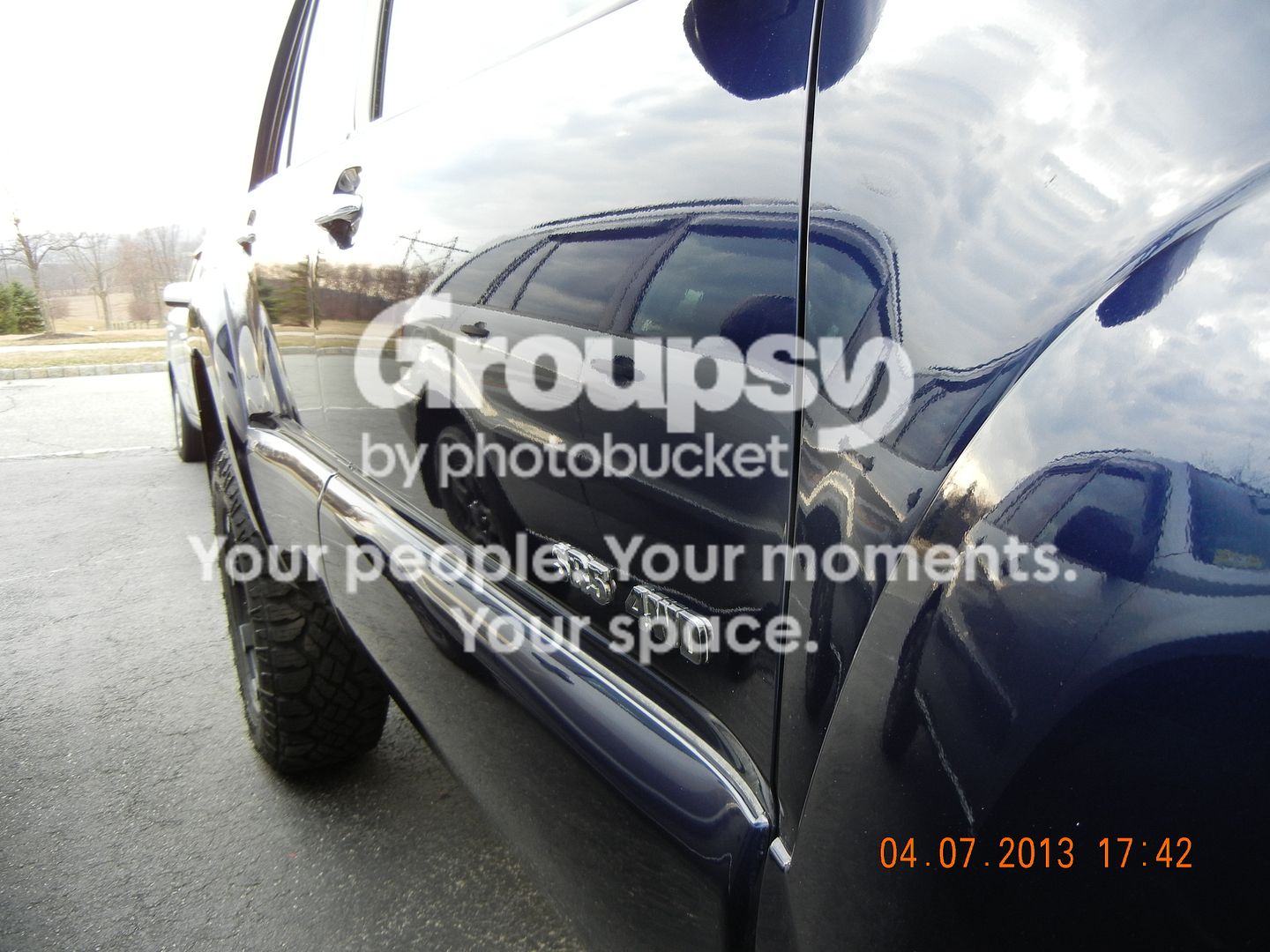

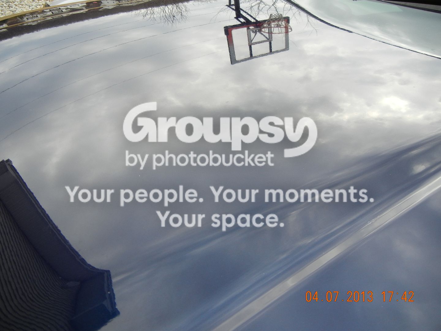

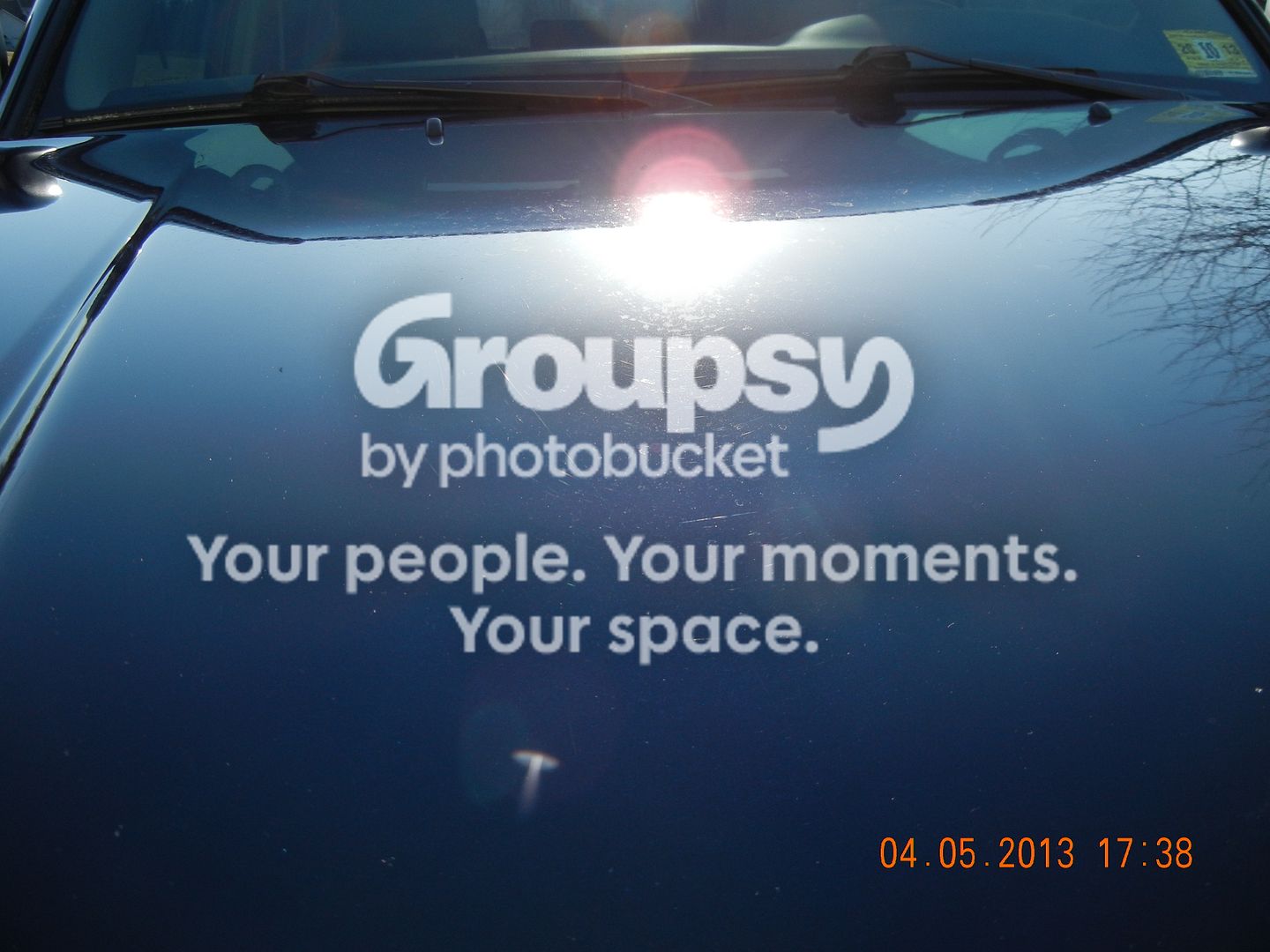

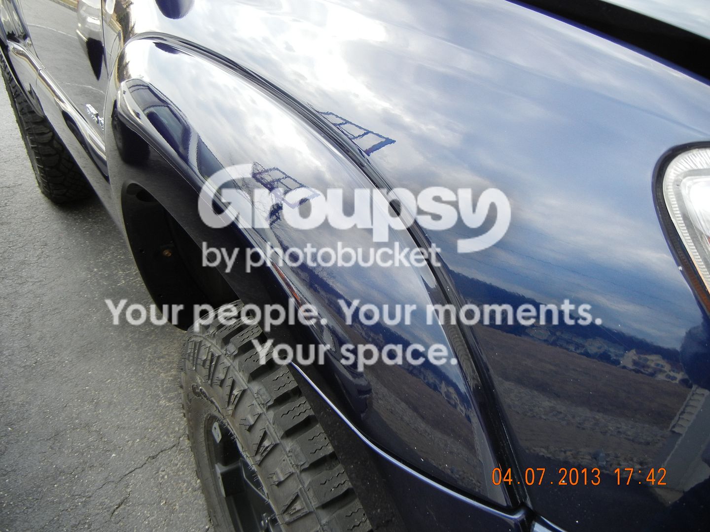

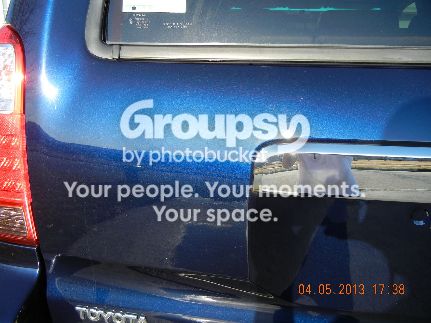

Got my 4Runner ready to go tonight. Washed and clayed it. Ready for polish and wax tomorrow.

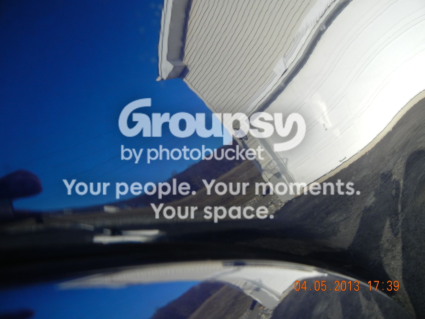

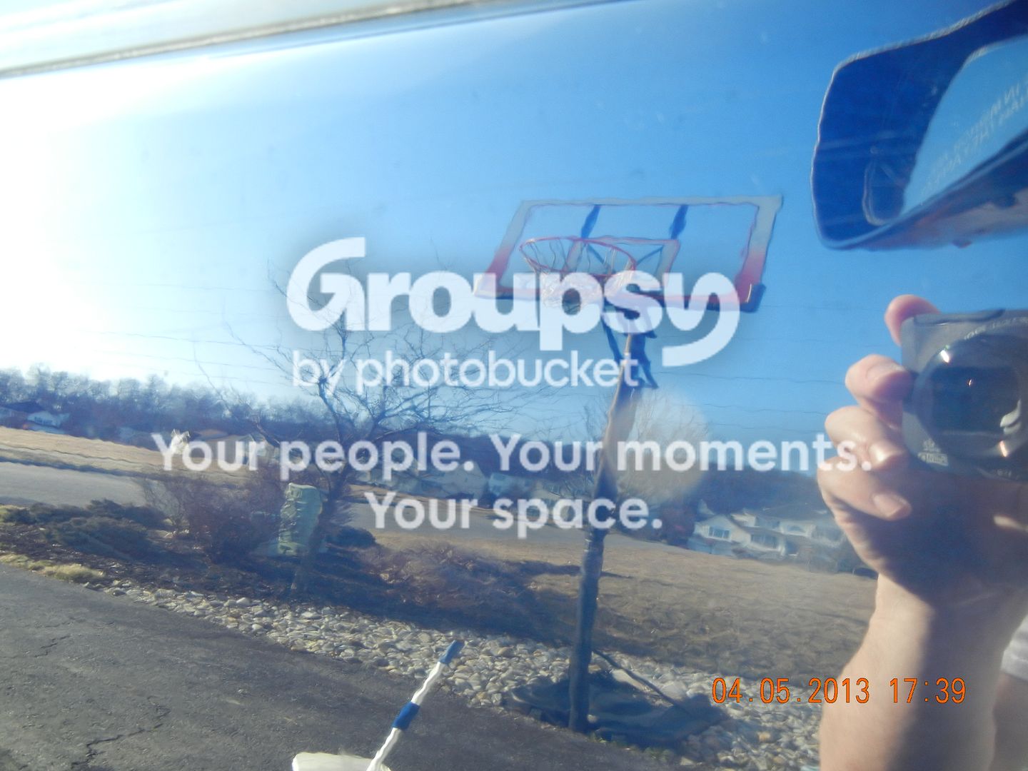

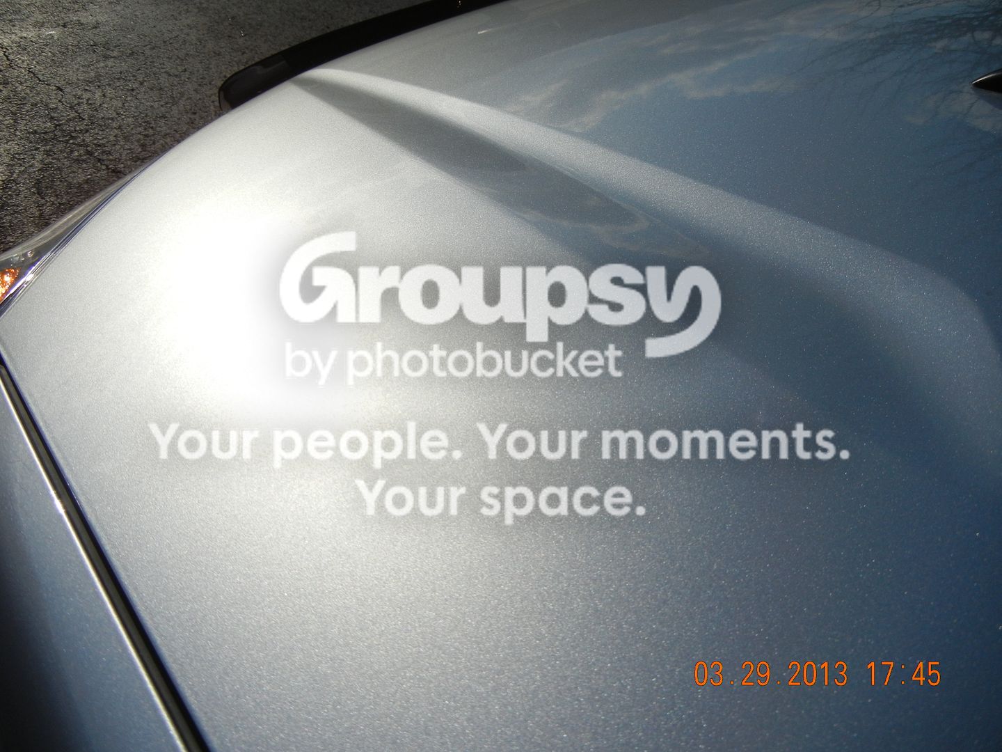

So I did it, and it was exhausting. M105 was a pain to work with. A lot of elbow grease was required to buff the residue off and tons of dusting was experienced, even with the spray bottle handy (which did help somewhat).
M205 was such a refreshing experience afterwards because of how easy it is to buff off. All in all, I got the results I was looking for. It did not remove the etched acid rain marks like I had hoped, but it did significantly decrease them, and it removed all my trail scratches too.
Well, enough blabbering, here are the pics:
Before (taken after it has been washed and dried):
DSCN1428_zps255ed830.jpg~original
DSCN1427_zps82b93659.jpg~original
DSCN1421_zps90147347.jpg~original
After:
DSCN1435_zps8662ebec.jpg~original
~original[/IMG]
DSCN1429_zps9bb2dcef.jpg~original
DSCN1431_zpsbc187f45.jpg~original
Please don't take any of this the wrong way but it appears you could have worked the M205 a longer to help get rid of that micro-marring. You can see it in the photo of the hood and in the shot of the tailgate where the sun is directly reflecting. …..good photos by the way which help show the true condition of the finish (which in turn can help folks with the advice they give). Shots in the shade or without a direct point of light are fine for showing some reflectivity, shine, etc. but not for highlighting blemishes (or for showing how blemish-free a finish is).
The shot of the hood also shows a couple of RIDS (random isolated deep scratches) that appear (in this case) as long, straight scratches. Those I wouldn’t worry about too much and will likely take more work with M105 or a different compound. However, all of those short, swirl-like scratches could probably be eliminated with more passes of the M205 and possibly a more aggressive pad depending on what you were using. Some or even most of that more minor marring is likely the by-product of the M105.
If you like M205 and want to try something more aggressive with the same ease of use, I would pick up some Meguiars Ultimate Compound. It finishes quite well for a compound IMO when applied via DA. ….so well that some won’t even follow up with a finishing polish (I do however). If you get some time, do a test spot like I described earlier on the hood (masking a small area) so you can see if it will be worth your time re-doing the whole vehicle. I get the feeling the M105 perhaps got the better of you and you were not able to devote the time/effort you needed with the M205 to get the most from it. M105 is not as easy to work with IMO/IME as some folks may suggest. There are those like you on the various detailing forums who have expressed similar concerns. I too find it a little finicky.
I hope you find some of this helpful.

I was looking at the hood and tailgate shots in the sun and for some reason thought those were “after” photos. ….sorry about that.
As for the pads loading up, they make spurs you can use that may be more effective but I usually use a balled-up towel with the pad in motion (probably similar to what you were doing). It helps give me a little more time with a pad but to be honest, I usually just swap it out with a fresh one once it gets too saturated. I have quite a few of the each type of pad that I commonly use (Lake Country orange, white and black/gray). I’ll go through several in a full correction and simply wash them at the end. …..tossing soiled/saturated ones in a bucket as I go (I keep one on the side which I usually fill with a cleaning solution so they can soak).
Another option might be to stop and clean the pad on the spot. You might be able to spin-dry it on the DA but it will still be a little damp. My typical suggestion is just to buy more pads if possible. ….at least enough to get you through the session. It’s much faster and easier IMO/IME.
