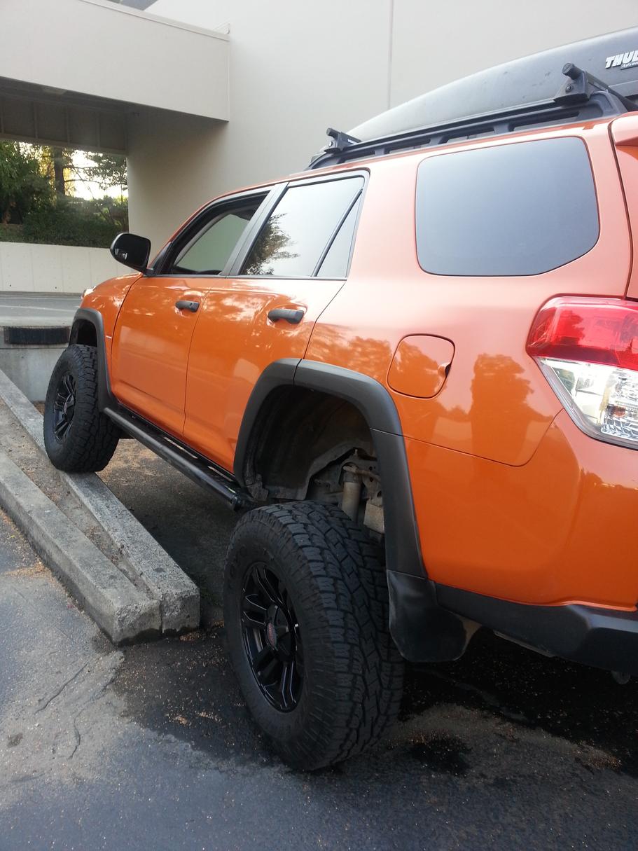

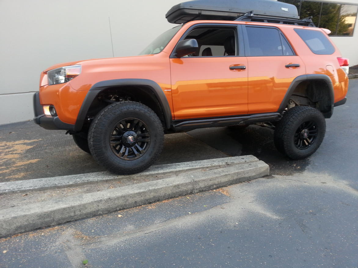

I'm sure metaltech has this on their 5th gen. Try giving them a ring and see what they have to say. They've been more then helpful everytime I've spoke with them.
Why yes, yes they did... until I acquired it:naughty::naughty:. It works great, no problems on the highway or around town and it worked flawlessly in Moab.
