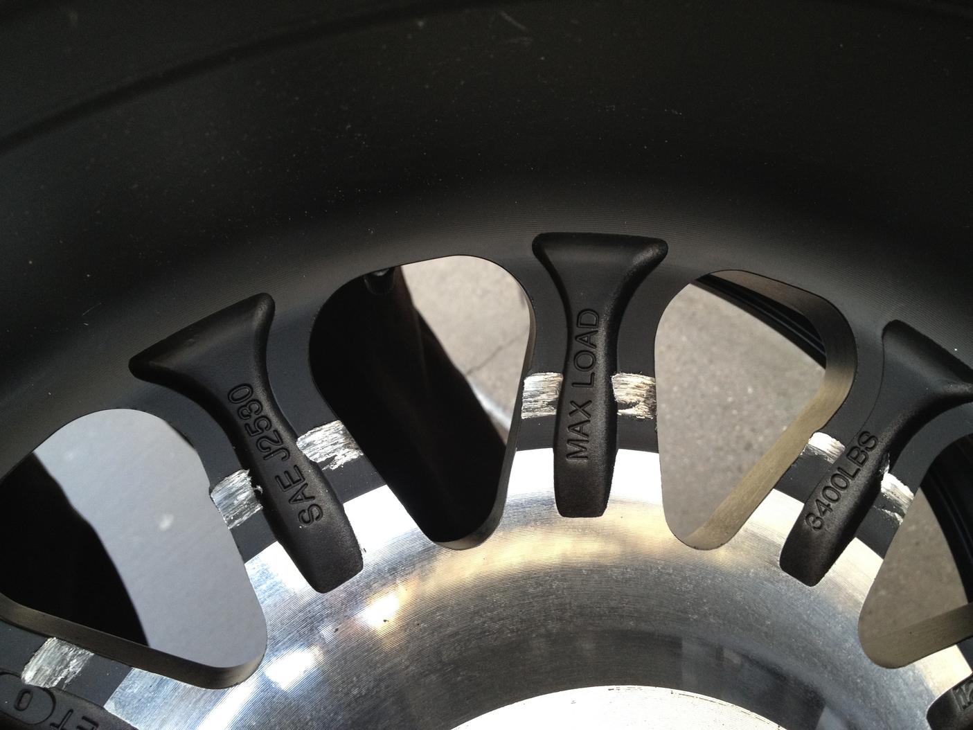

:roadkill:Just a word of warning for anybody installing Method Double Standard wheels. I went to install mine yesterday when problems arose. When installing the rims(post lift install) I failed to spin the wheels to check for clearance. I didn't think I needed to with the rims spec's at 17 x 8.5 6 lug 0mm offset 4.75" backspacing. I made it about 2 feet before realizing something was tragically wrong. So I returned the wheels to Discount Tire. They where very apologetic telling me they should fit. So he called an Method and they said "They should fit BUT we had a problem with a batch of rims. The spokes where manufactured too thick." They'll send out new ones promptly. So just a word of warning if you are installing Method Double Standard rims.

I'd insist on a new caliper if yours is at all damaged. Sadly, most wheel manufacturers nowadays sacrifice quality for cheap labor- tolerances are 3-4mm off of spec before they get rejected.
UPDATE: Second batch of method dbl standards didn't fit. Same issue with brake rub. I'll put out updates when I hear back from method on Monday.

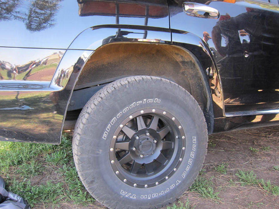

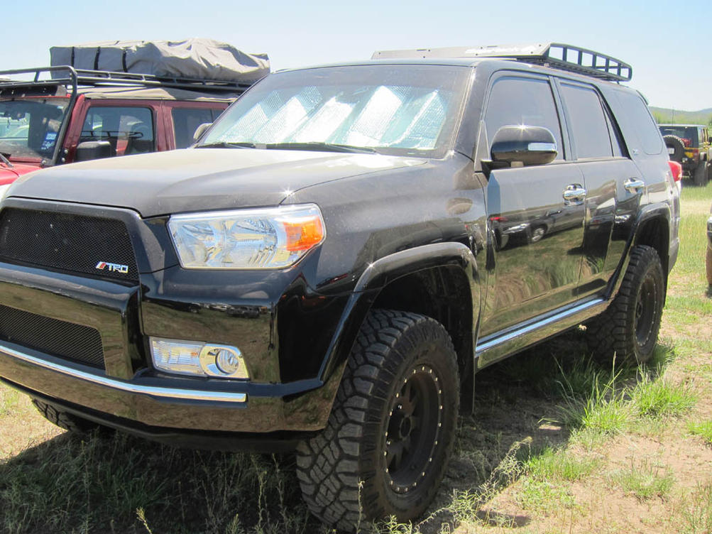

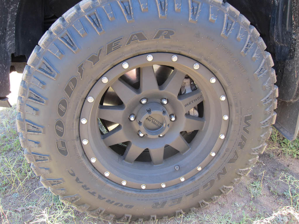

Crazy! There were two current gen's at Overland Expo today running the Methods and it certainly didn't appear that they had any issues. Wonder what's going on!?!??!?!?
I don't know if this does the poster any good or not, but I thought I would post pictures of the aforementioned Methods spotted this Saturday at OX.
I really hope this gets worked out as the Methods are my own #1 option right now!

**update**
Those mother f*^kers hit on the brake caliper. Manufacture date on them is 6/25/2012. Now to figure out what to do.....
:dammit: :ybrick:
Run spacers, move liner, body mount chop if you still rub.
