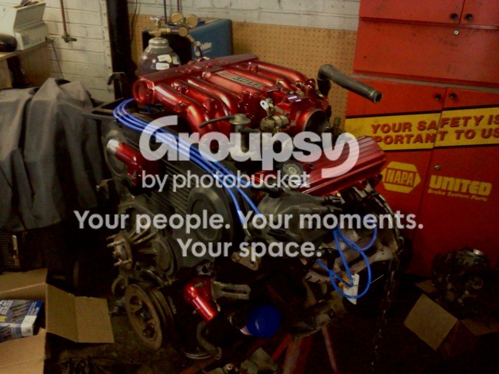

also why not, might as well repaint it right? here's mine just after rebuilding.
