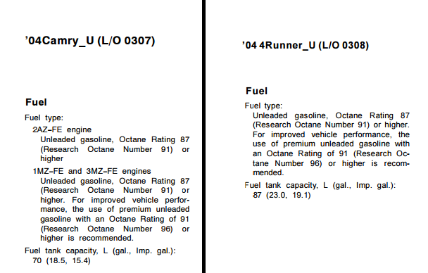

Only when it applies to the engine in question:
These are two selected sections from an '04 Camry & '04 4Runner Owner's Manual under "Specifications-Fuel". As you can see they both do state "For improved vehicle performance use 91 octane", But only for the V6 options in the Camry; for the 2.4L I4 it simply states "87 Octane or Higher" which indicates that you won't see any real gains in the I4 with Premium, but it won't hurt to use it anyways.
Most engines made in the last 10 years or so are designed for premium fuel, they just throttle back the tuning when lower grade fuel is detected (usually by the knock sensor).

Others have already mentioned certain cars. My wife had a Volkswagen passout... i mean Passat.
It did not prefer....It HAD to have 93 and said it on the gas cap. The compression in the engine HAD to have it. When we lived in Arizona they only had 91 and it damaged the engine. The engine would even sputter. My Neighbor had an M3 BMW and he experienced the same thing.
I had to spend over 1k a year later having the engine fixed. I remember being madder than 10 Sons of Biches at the dealership when paying that bill. The mechanic actually asked me if we were running the recommended octane. I got rid of that POS soon after that.
If i could find it, I would run the 104 octane.

I have owned two vehicles that needed 93, one of them was a turbo charged motor and the other was an LS2. I understand that some motors require it, the 4.7 is not one of them.
But I'll never convince anybody here they are throwing money down the drain putting 93 in their 4.7, if you can afford it than whatever more power to you. It isn't hurting anything.
