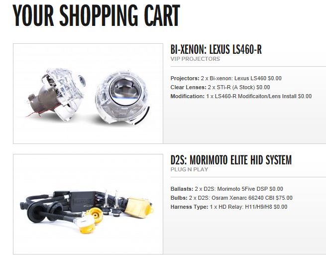

looks good, i gave up on the white output of the cbi, even though it gave a intense cutoff, the light washes out on wet pavement. now with the svs its alot of light on all types of pavement, i think the new ones are called nightbreaker.
Roger that. My new ones are done and headed my way.
Congrats! Light output is insanely good on the LS projectors. I almost got those.

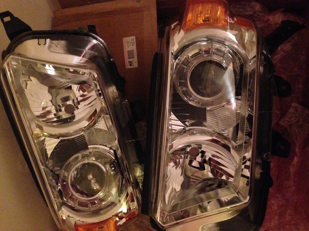

Wow... where to start? Well I did install them, last week. But I had to put the FXRs back in. Due to choosing the "LS460 specialist" from TRS, this project has been the absolute worst C-F imaginable. His lousy packaging led to broken headlights in shipping, which he then repaired. Then, after I installed them the projectors were mounted so high, the adjusting screw couldn't bring them down far enough. That's the very short version.
I am sooooo very sorry I didn't listen to that little voice and use Lightwerkz. They have done two perfect retrofits for me. Stupid, stupid, stupid.
Oh, the LS460s are phenominal lights, sadly they are useless as is. I have no idea what I'm doing from here. I want to hold the retrofitter's feet to the fire, but I have no power, plus I want nothing further to do with him. Ugh.
