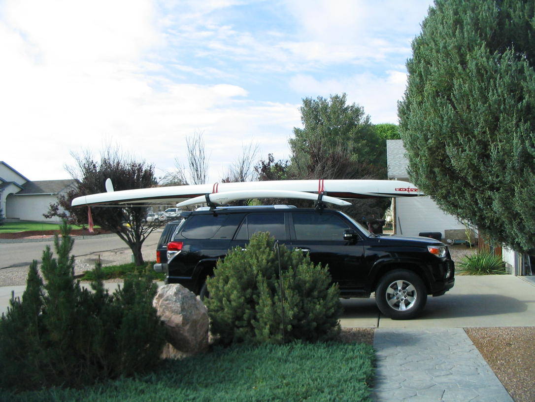

Although Yakima does not list an application on their website, I have found that the setup used to mount a crossbar over the front doors of my 3rd gen works fairly well on the 5th gen. I carry 20+ foot outrigger canoes on my rig using this setup over long distances (greater than 1000 miles). The bar is not an exact fit and has only presented an issue when driving in heavy head or cross winds (35-50 mph) at interstate speeds.

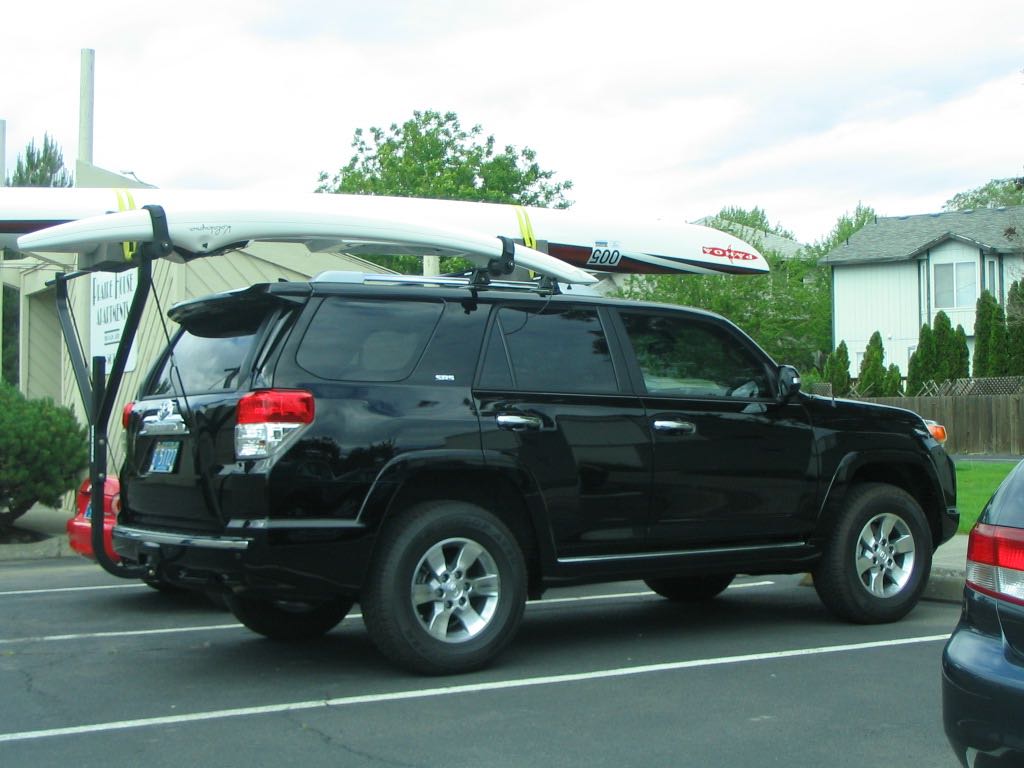

[Edit] I have also used this set up with a Yakima drydock hooked up to the hitch that works well. These are not cheap solutions by any means, but have met my needs.
Desertred, would you please clarify your setup? how did you attach the front mounting spot on your 4runner. It is not on the roof rails, I am still trying to figure out a stable long term solution.
I'll try. The front crossbar is held in place by a set of Yakima Q-Towers. The Q-Towers are held to the roofline with a set of clips (model Q62) that are specific to the 3rd ten 4Runners. The clips attach to the Q-Tower and clamp the tower to the roof using the edge of the door frame. See the video in this link for a good explanation of the setup and use of Q-Towers. Again, since the set up is specific to the 3rd gen 4Runner, the fit of the Q-Towers is not an exact fit - the towers may slide a half inch in high winds. However, they have worked in supporting my fiber carbon canoes.
The Yakima Drydock system is a hitch attachment that basically mounts a crossbar behind the vehicle, extending the length between crossbars. However, this may also shift the length of the load rewards as well. You will not be able to open the hatch with the Drydock, but that is where the roll down window comes in handy. You would not need the front crossbar with the Drydock. Pic of the Drydock below.

mine is a gen 5 and it has a channel. I was thinking Thule, but will go and see if I can find a set of Yakima Q's that will fit.
The Q-Towers are generic and should fit any vehicle with a naked roof. It is the clips that attach to the Q-Towers that are vehicle specific. Yakima does not provide clips for the 5th gen, as they do not provide an application for the 5th gen other than the factory roof rack. The crossbar that I use was left over from my 3rd gen when I purchased my current T4R. I think I had to adjust the distance between the towers to apply it to the 5th gen, but I can't recall. Price wise, I would guess that the Yakima and Thule setups ay be similar.
