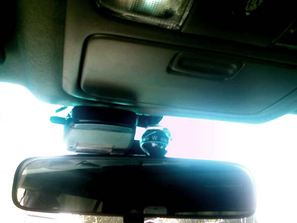

I tapped into the inner and outer wires of the map light to run hard wired power to my Fuzzbuster also. You can barely see the wire coming out of the front of the headliner at the windshield. It worked great and now theres no wires and the Radar Detector is up and out of site near my rear view! :biggrin2:
I ended up centering it above the mirror and moved that compass to the upper left corner of the windshield. It looks better and I can fit my custom sun shield without taking it down.
