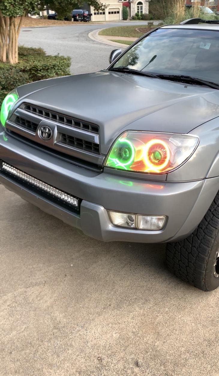

I know this is an old thread, but I have a question. I have morimoto halos with a bluetooth controller that I turn on with my phone. They always work with the turn signals on or not, but I am wanting them to automatically come on when I start my car. Any tips? Keep in mind my 4runner doesn’t have daytime running lights.
You would have to find the acc circuit under the hood and wire it as the trigger in a relay. It would also be wise to install a switch either in the dash or under the hood on the acc line so if you did not want to have them on for whatever reason you could shut them off.
