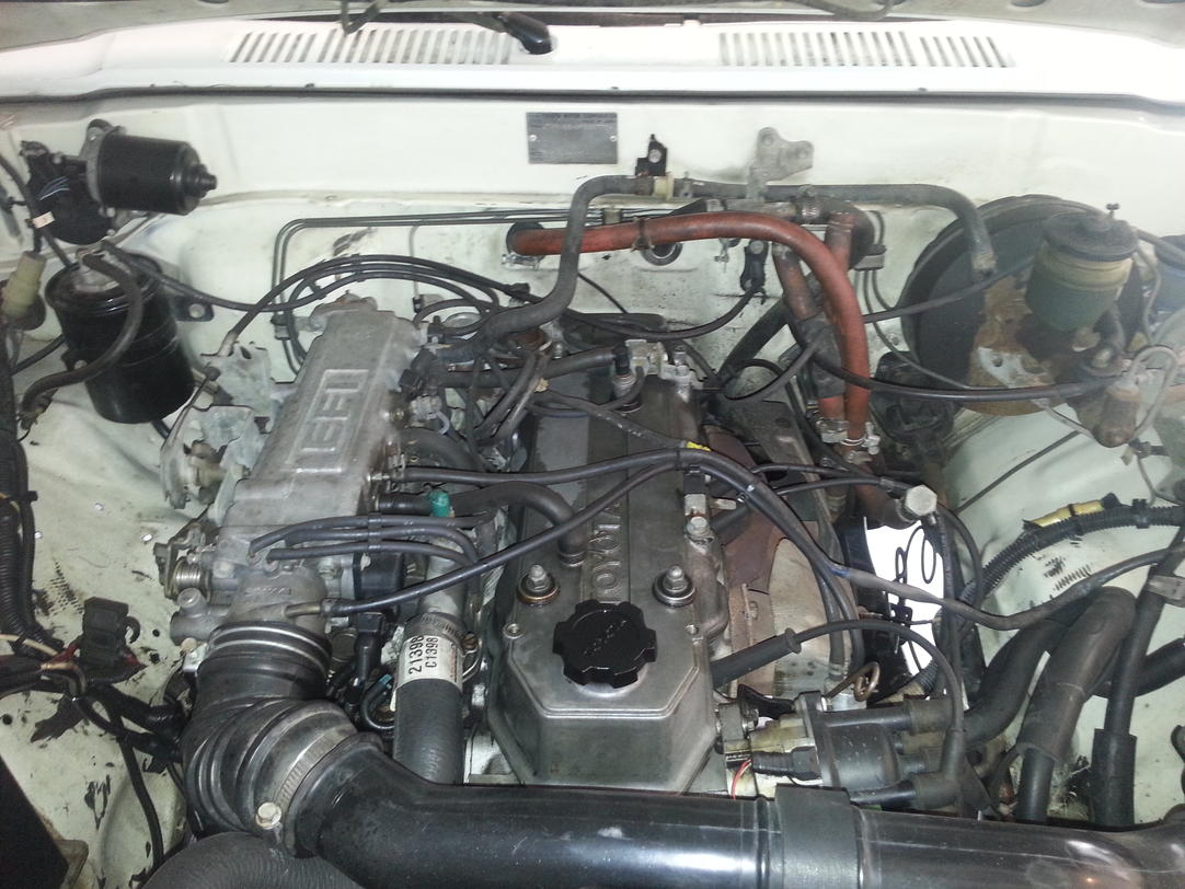

Just finished the swap and final tuning last night. Runs perfect, oil pressure is spot on and no cooling issues after a 30 mile drive today in 85° heat today. A crap ton of hours, blood, sweat and toil went into her but nothing worthwhile is easily gained or ever truly done.
Spec's: Raptor performance 22re
Turbo clutch and flywheel
LCE injectors
Trailgear motor mounts
Performance 22re complete sensor package, filters, t-stat, exhaust studs
LCE tune up kit
And some other odds and ends that I am sure I am forgetting.
Next step under the hood is performance exhaust, intake, and ignition and than I'll be happy for awhile with the engine and move on to other areas.

The awesome looking rebuilds I've seen and all the aftermarket support parts make me sort of wish I had a 22 in my truck instead of the 5vz. :)
Looks really great.

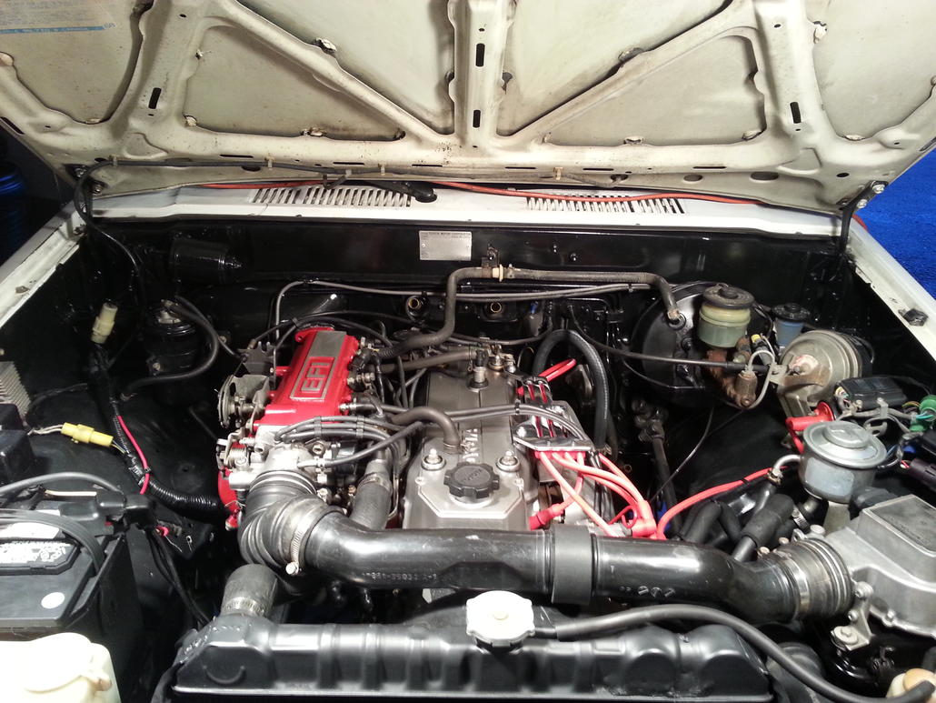

Here's my engine:

Specs:
22re block, bored .030 and deck milled (.017-.020 quench)
Street RV head from engnbldr with a 268 cam
New LCE fuel injectors
LCE Header w/ cat delete
LCE lightweight underdrive pulley
A/C Delete
All new sensors
All EGR and un-needed vacuum lines deleted
With all the stuff above I have been told from LCE and Engnbldr that I am probably somewhere around the 150hp range. It pulls my 4runner with a 3-4" lift, 35" tires and 4.88 gears pretty good at 6000-7000 ft in Colorado. It has done pretty good at 12,000+ feet in the mountains as well. Overall it's a decent engine but with all the money spent I would have been better off spending a little less and doing a 5vz swap and getting more power.
I understand the 5vz is just fine but the 22re all fixed up sure looks purdy. :)
