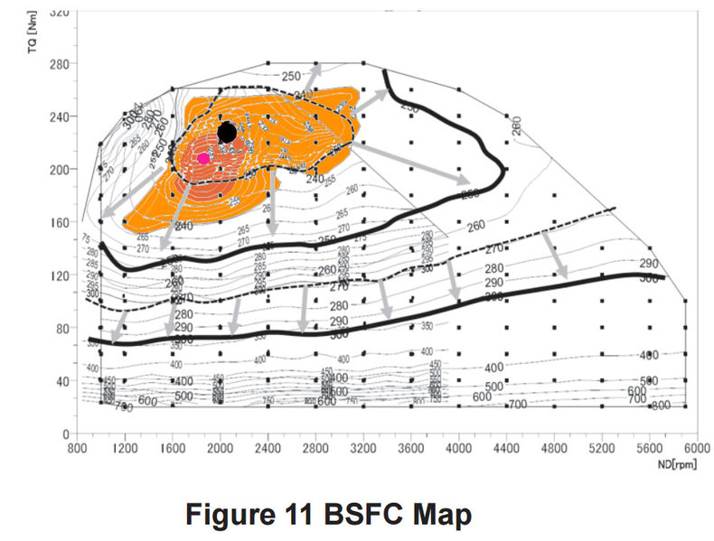

I have never seen a BSFC map for the 1GR. I think I've seen one somewhere at some point for the 2GR, but I can't find it.
This is the closest I can come up with that might be kinda close to the 1GR. I suspect the 1GR peak efficiency is lower in the RPM range than the 2GR due to the longer stroke and port injection only. My experience in general is that the 1GR thermal efficiency drops fast after 3k rpms. And the transmission losses also go up quickly once the torque converter unlocks. So it's hard to imagine a scenario on the highway that you'd get an MPG benefit from anything that causes you to drop out of 5th gear with the torque converter locked.
I would also say that the 1GR is remarkably fuel efficient at idle and on trail duty. In side by side trips with mostly Land Cruiser 80 series, the 5th gen 4R uses something like half of the fuel on low speed trails and probably even less than half at idle.
This is the same concept broken into two graphs that show the same information in a little more digestible way for folks who might not be familiar with reading a BSFC map. This is I think supposed to be 2GR vs 3VZ, but I'd just use it as a general reference for mid size v6 engines.
I think this is supposed to represent 2gr vs 2gr-FKS (the atkinson cycle simulation) overlaid. You can see that the peak efficiency window is pretty small for the non FKS 2GR. And probably even smaller for the 1GR. And it's peaking in efficiency at high load around 1800rpms.
