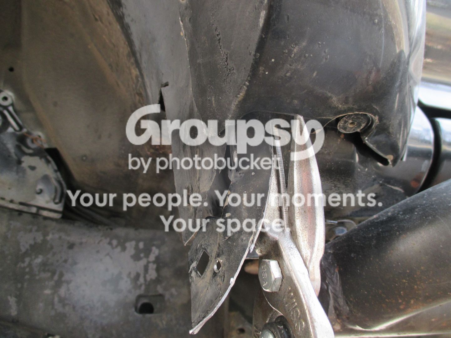

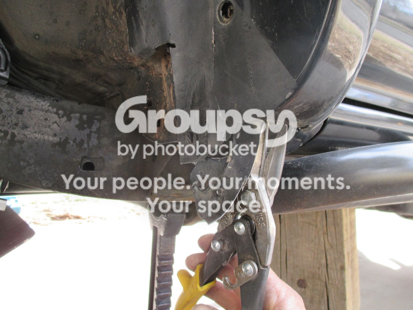

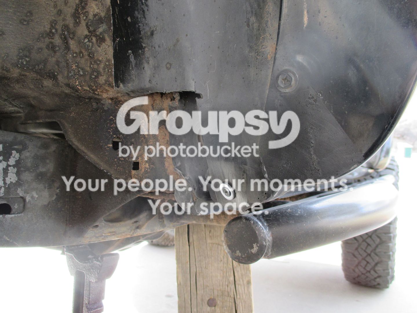

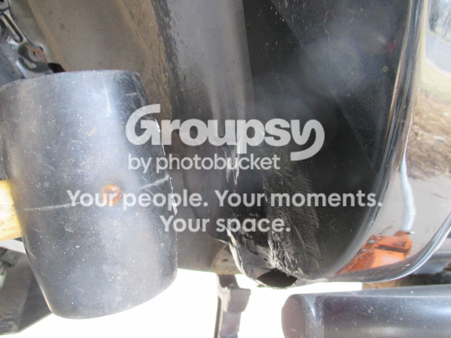

Pinch weld mod and Fender roll
I love my alignment and have my caster set a 4. I believe that means my wheel sits a little back in the wheel well. Also I decided I like the look of the spacers for now until I get different wheels. With that in mind I get a little scrubbing in the rear of my front fenders. I had previously cut out a section of inner liner to access the pinch weld to modify it. This worked with the 265 hankooks for clearance but not the 285 dura's. So out comes this pile of tools and I get after it. Passenger side wasn't as clean so following pics from are driver side.
IMG_0146.jpg~original
The previous pinch meld modification. I had cut the metal part of the fender and folded it in then used a small screw and washer to tuck it up.
IMG_0151.jpg~original
In this pic you can see where I remove the screw to gain access to the fender metal. also can see where I had grinded down the plastic part of fender and spray painted it grey. OK what I did was take those sheers and cut the metal up into the fender. I then used the blue wire cutters in pic to grab the remaining metal up inside and twisted it in. Further grinded down the pinch weld and fender metal.
IMG_0153.jpg~original
IMG_0154.jpg~original
if you feel with your fingers up in the flare there is a metal frame of sort. It is what was preventing me from pushing the inner portion of the fender out of the way. with that moved back I could flex the plastic in. ENter the heat gun. I melted and shaped the fender plastic back as far is possible. It begins too distort, melt and shrink so there is a limit to what I could do. The passenger side looked like a beaver chewed on it and the driver came out like this. I was heating it and mashing with the back of mallet to form. then sprayed it. sorry bad pic.
IMG_0157.jpg~original
There is an open cavity there which I was trying to avoid. I will have a solution to that this week. After recent adventure I'm considering removing the flares anyhow. So 285/70r17's on tundra's with 1.25' spidertrax and this work for me through some serious stuff yesterday.

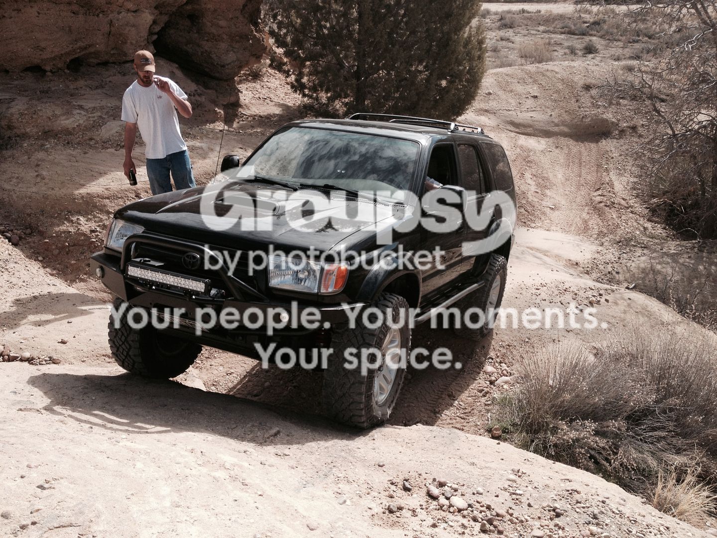

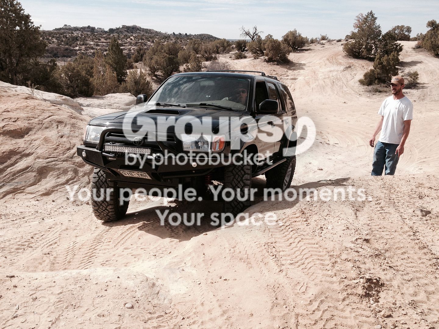

First time airing down
I've been aching to do some real wheeling and put some of these things to the test. So I made a few calls one the led to another and the guy that repaired my driveshaft told me who to call. Here we are getting ready at the entrance to ..I was pretty excited and didn't realize how good it was about to get.
IMG_0162.jpg~original
After a quick meet and greet we started airing down. This was getting real real fast, we start talking and some buggies pull up. they said "you got a newbie huh, well you're taking him to the water fall and gladiatior first right?" At that point I was starting to get a little nervous especially seeing the clearance issues my rig had comparatively speaking. My truck was looking a little clean and scar free also...this is what I'd been waiting for...or was it.:shocked:

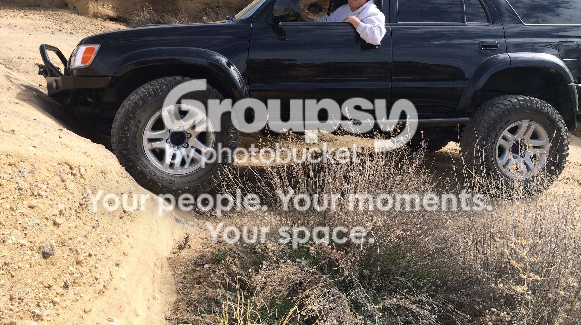

We started by going in the bottom of the lower playground area..very first climb was more serious than anything I had done in 20 years and it was now very real as my nose was pointed into the sky. Initially an unnerving feeling somewhat changed when the grippy duratracs took hold and easily bit into the rock and I eased up.
IMG_3203.jpg~original
this is going to get good

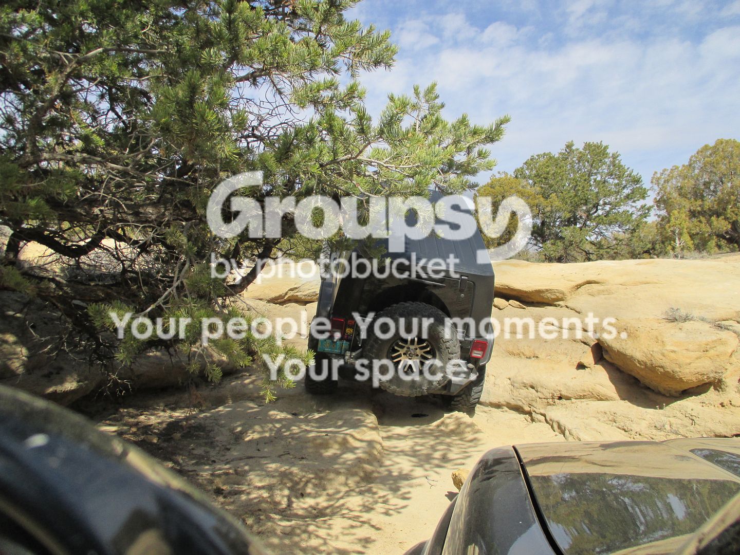

On up and around the corner...I quickly learned the importance of a good spotter. Not only did the great spotting give me the right line, it gave me confidence. Bear in mind this was very new to me and I kept expecting the sound of breaking parts and rubbing driveshaft or skid plate using the sliders. So I do have a stupid look on my face in some photos, I,ll have to work on that.
IMG_32051.jpg~original

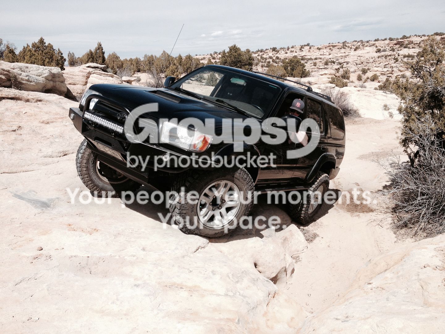

First test for the AOR bumper approach.. this was pretty damn good. It felt like my feet were on the rock.
image-78.jpg~original
Didn't scratch the bumper or the skid plate.. I drug the hitch and spare which was to be expected. I was now thinking it might be a handicap but my guides were confident it wouldn't matter.

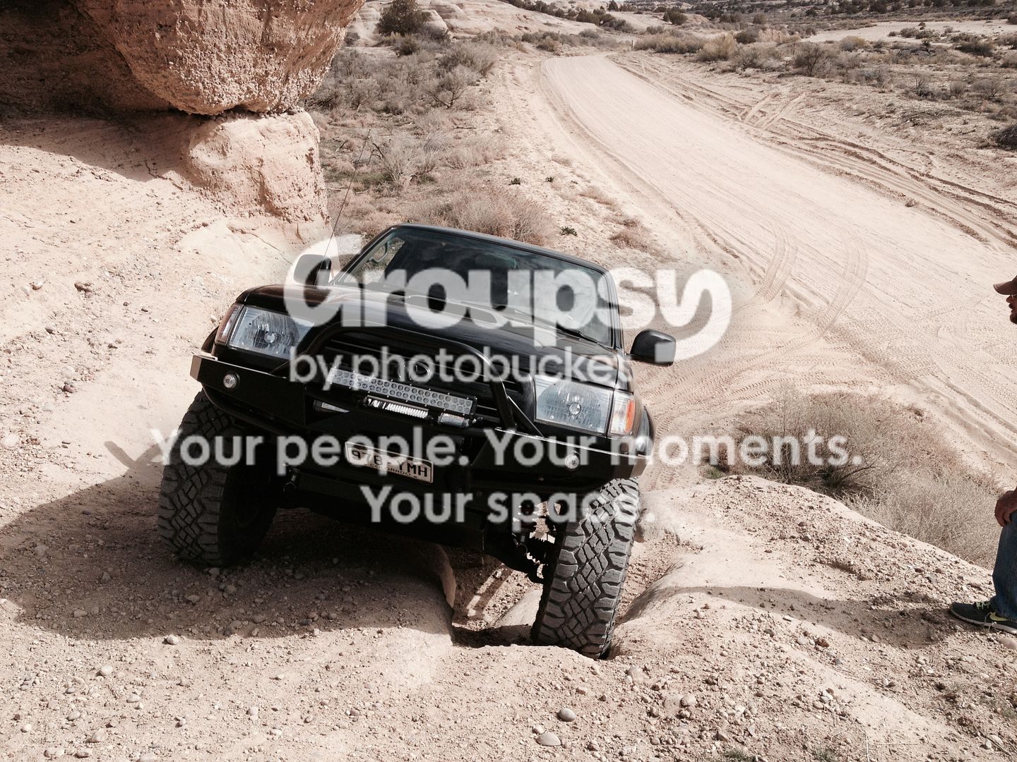

We pulled up to this wall and the jeep nudged and strategically bounced twice right up it. My heart sank and I gripped the wheel
IMG_0188.jpg~original
Than Cody said you can go here if you want..
IMG_0193.jpg~original
IMG_3212.jpg~original
Then I learned to bump and roll. It took me 3 attempts but I made it. When I say attempt meaning I stopped as soon as I lost traction. The key was to get the front up and ease into it at 1/3 gas through the back tires making contact. I kept giving it gas after the rear bounced which made it break free. When I was able to do what was being suggested it went right up.

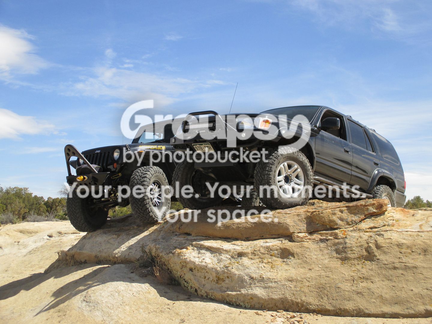

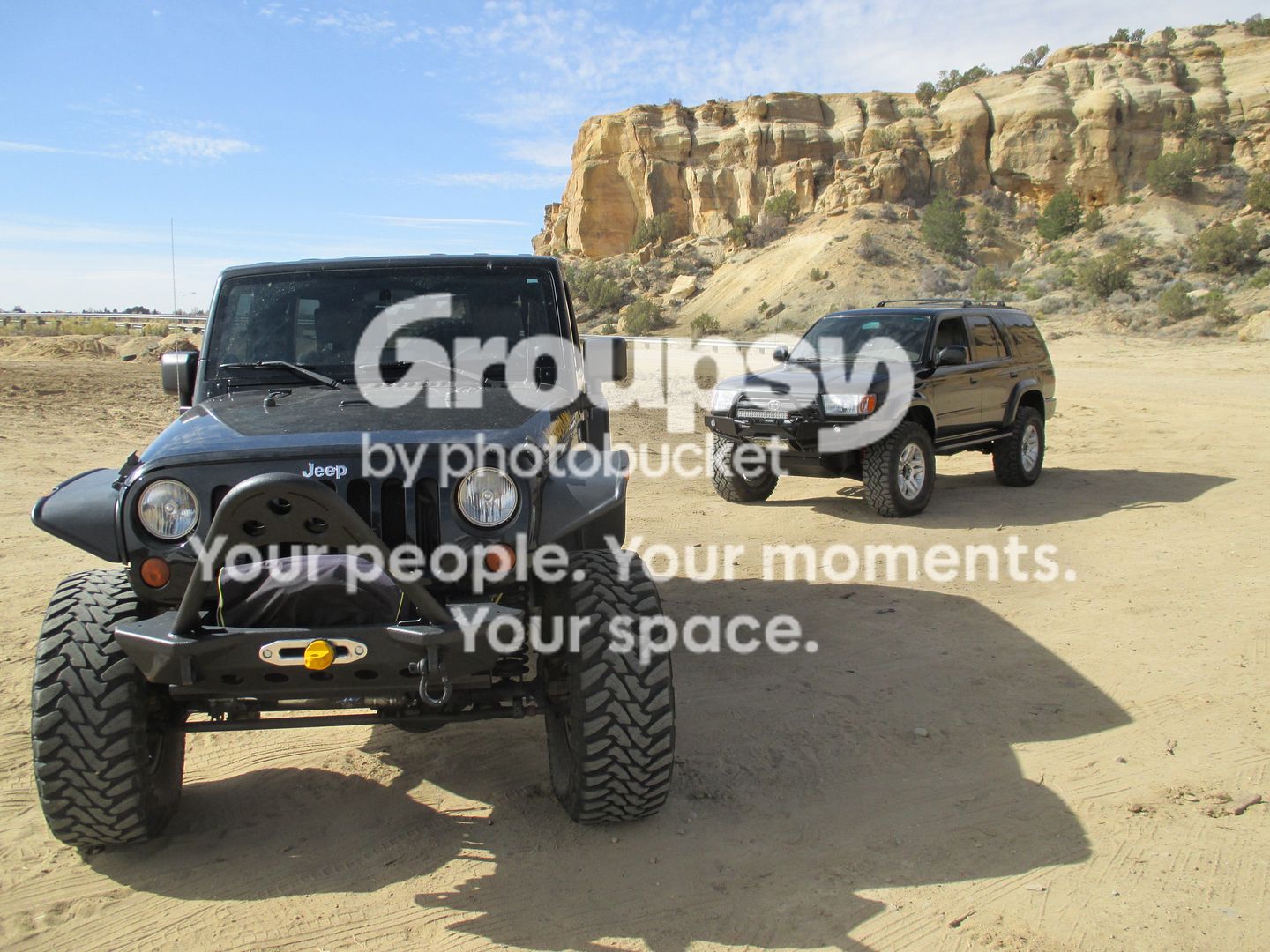

Man this is a great build you've got going! It would be excellent if we could hit some trails this fall, I'll be keeping an eye out to see how things progress this summer.
Regarding your alignment and caster amount. If you are at +4 your tire is pushed about as far forward in the wheel well as possible. You are lucky you can get that much even after lifting, no doubt because of the LR arms.

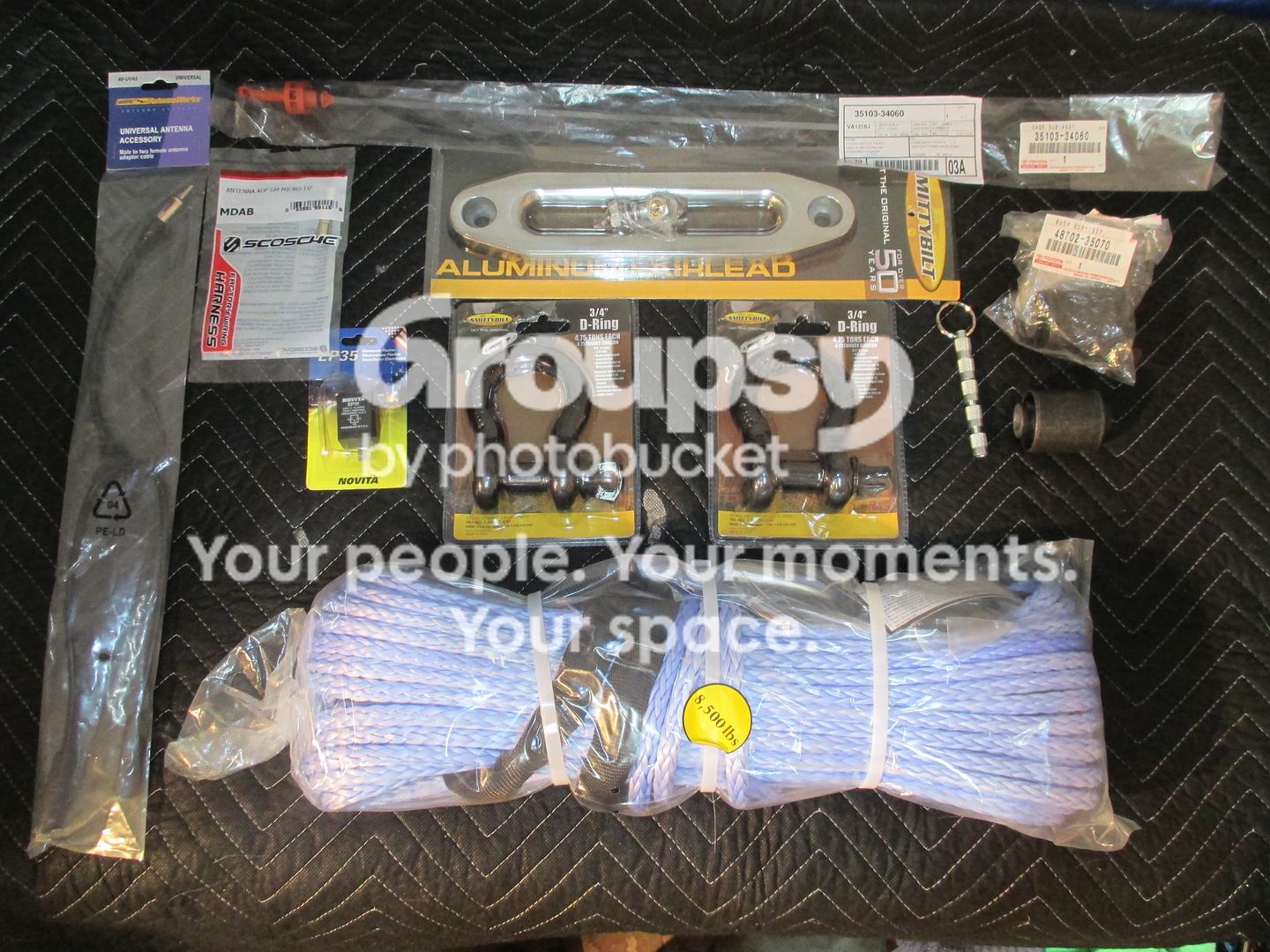

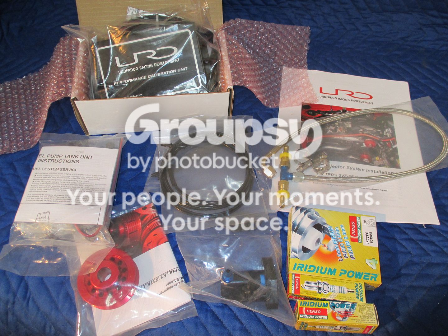

Some more things came in so the 4R is getting some love. There wasn't much of an install to any of it except the 7th injector which is pretty well documented so I don't have a write up. More just an update to my build and where I'm at.
URD 7th and 2.2 pulley...For me it was a PITA to install. I thought I could solder and this wasn't the project to put that to the test. I burnt the crap out of my fingers and was not fun. It took me longer than I'd like to admit but it started without problem when finished.
IMG_0336.jpg~original
The next day all this came in
Smittybuilt fairlead
Smittybuilt shackles
Rugged Ridge synthetic winch line(got a sweet deal)
EP35 flasher
Speed airbleeders
3 of 4 OEM rear control arm bushings
OEM tranny fluid dipstick
couple parts for stereo install
New Sonoran Steel adjustable panhard bar

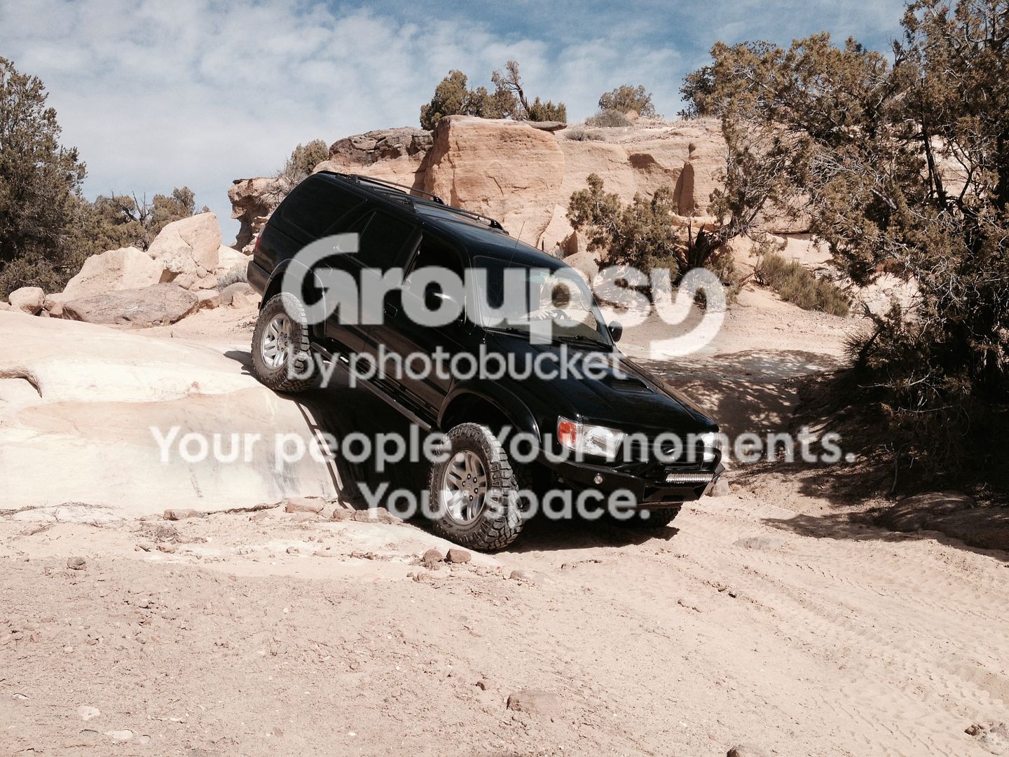

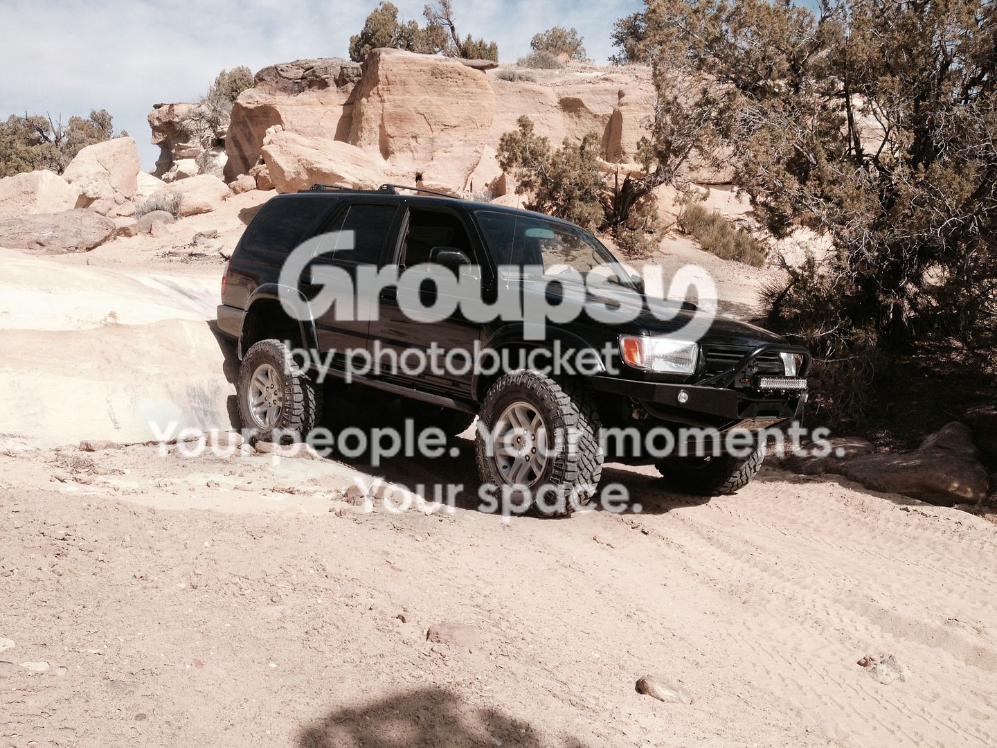

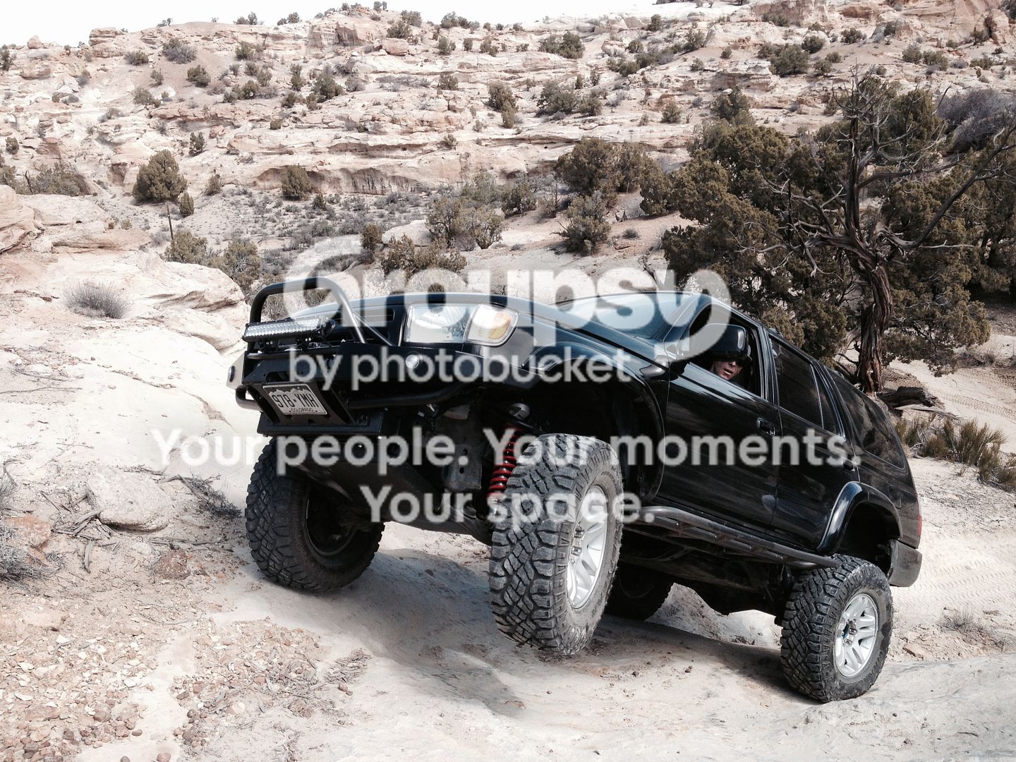

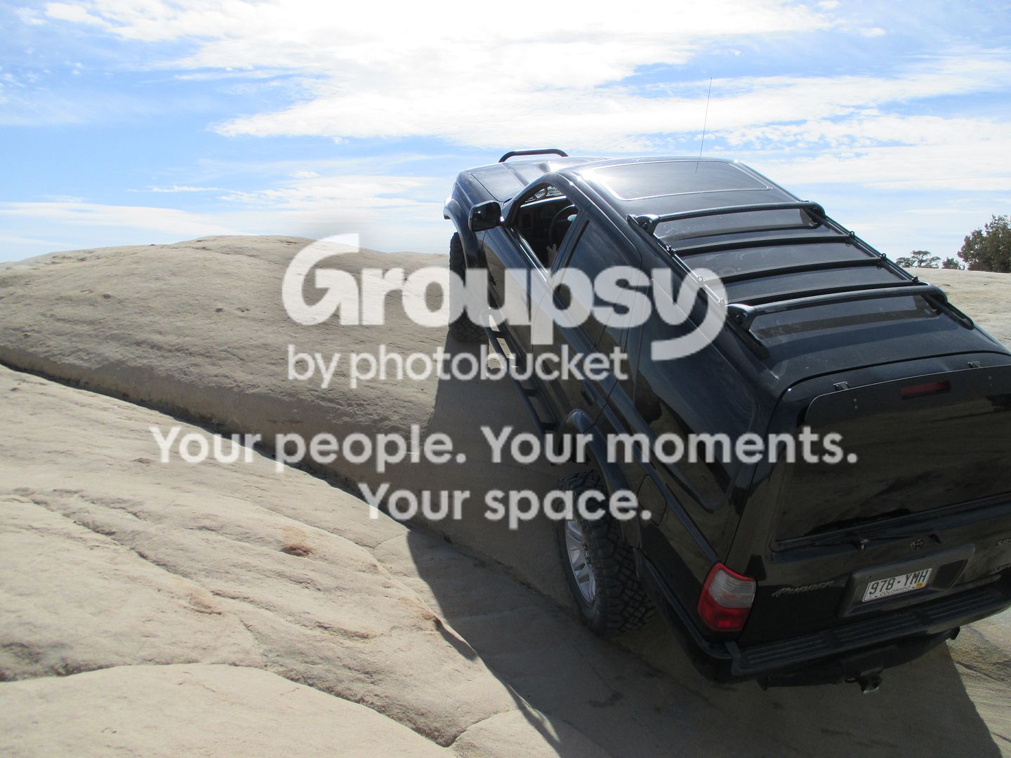

Been putting in some miles and still have a laundry list of things to do...Gaining confidence in the rigs dependability though. Lots of road trips coming up, hope to run into some of you...Some vids and pics

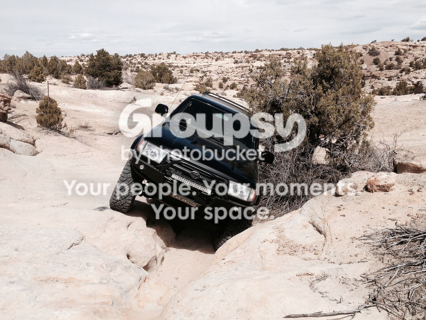

Next similar climb my line was a little off...
image-79.jpg~original
But I made it..:reddance:
