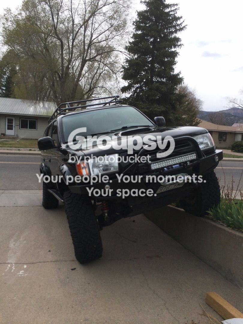

Small obstacle at the top of second playground

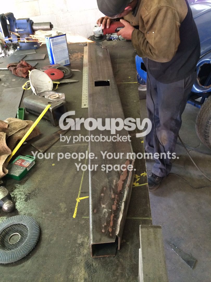

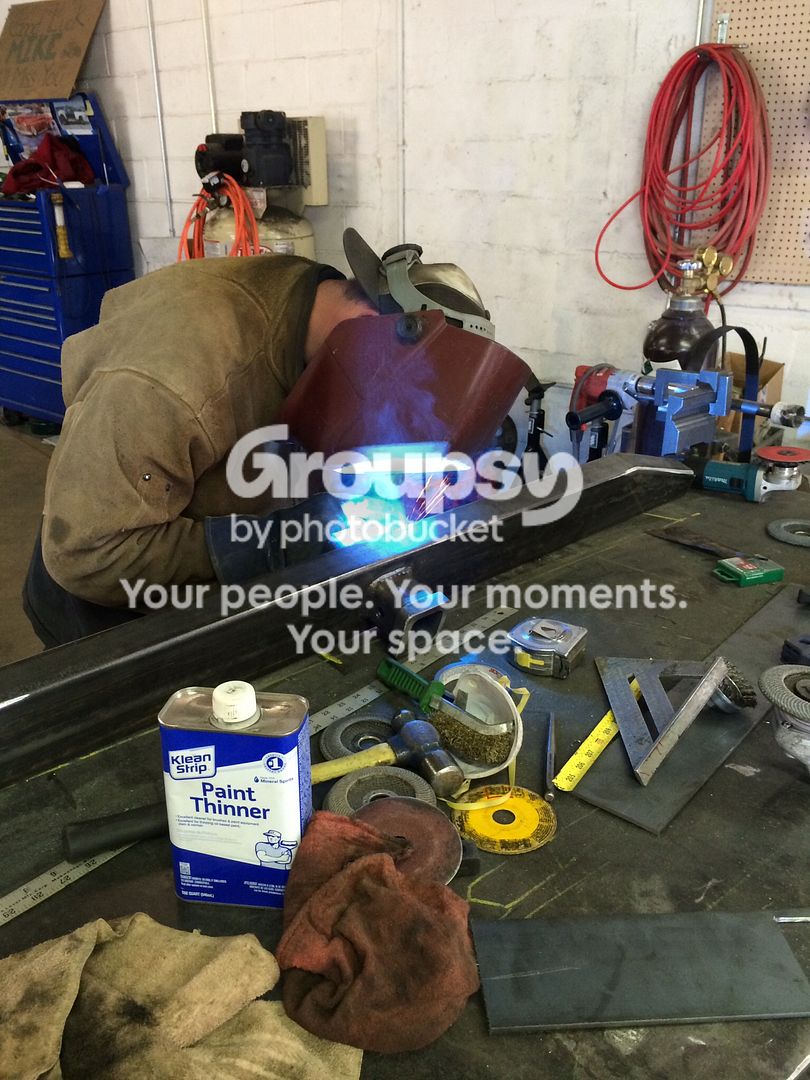

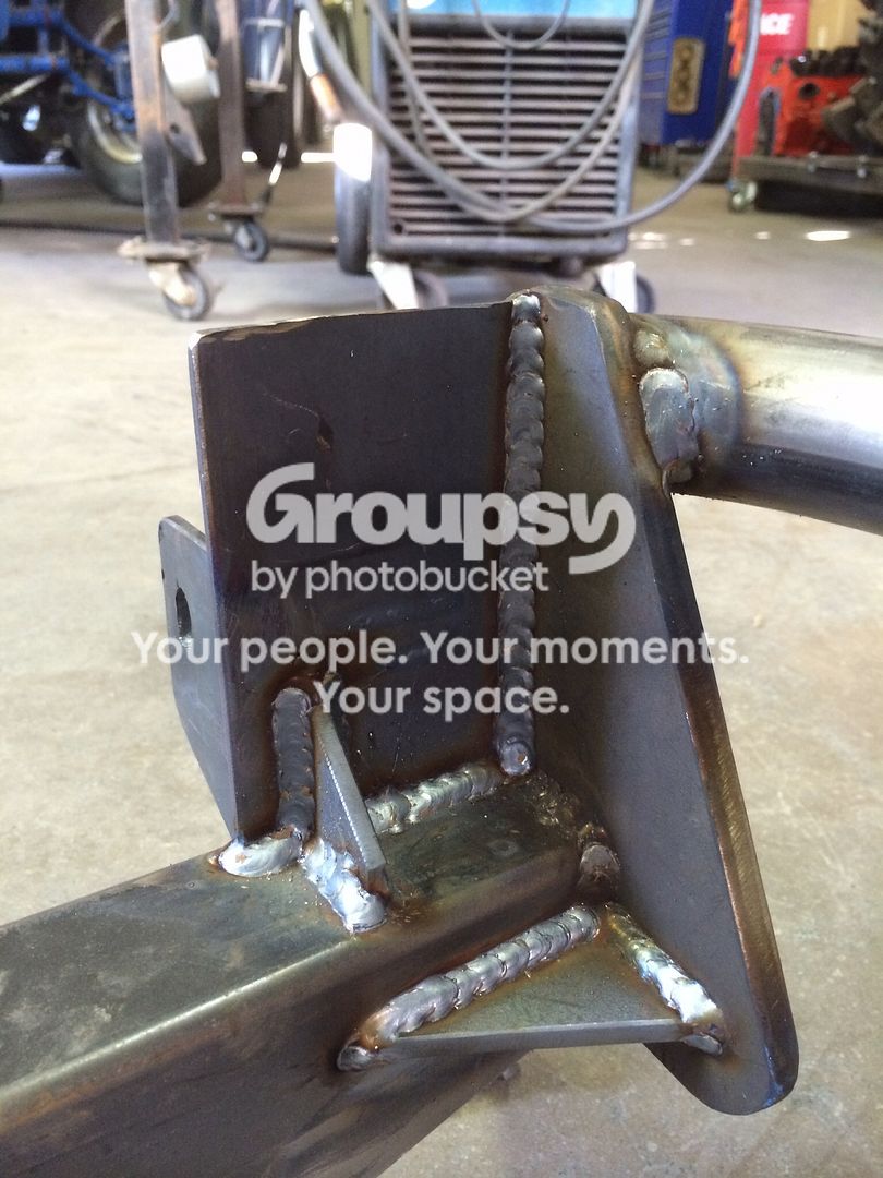

I could do that although I'm sure you could build you're own. I don't really drink at all and I did pay $100 for his welding. I gladly tipped him $100 so, don't want you to think its free free. Outside of a welder all we used was a hydraulic bender, a notcher, a grinder and drill. I would even be willing to help you if u had those tools being as I 100% helped, measured and cut everything. He made pretty short work of the welding and laying it out to make it square. Building it in a jig really helped. It was a lot of fun and I'm going back for more on Monday...need something to weight down these new 861's

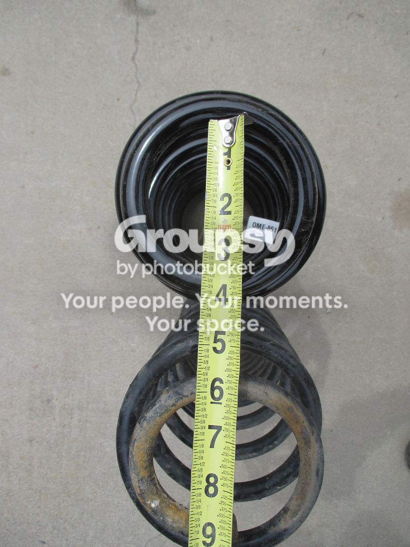

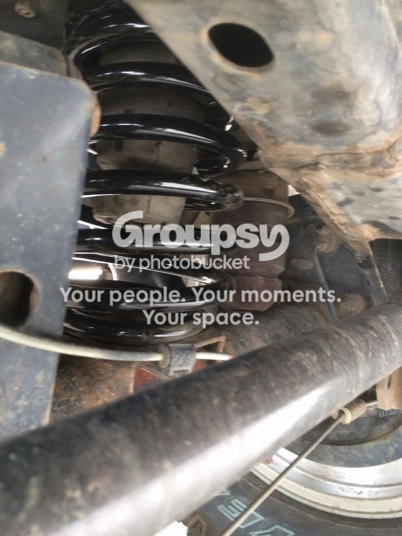

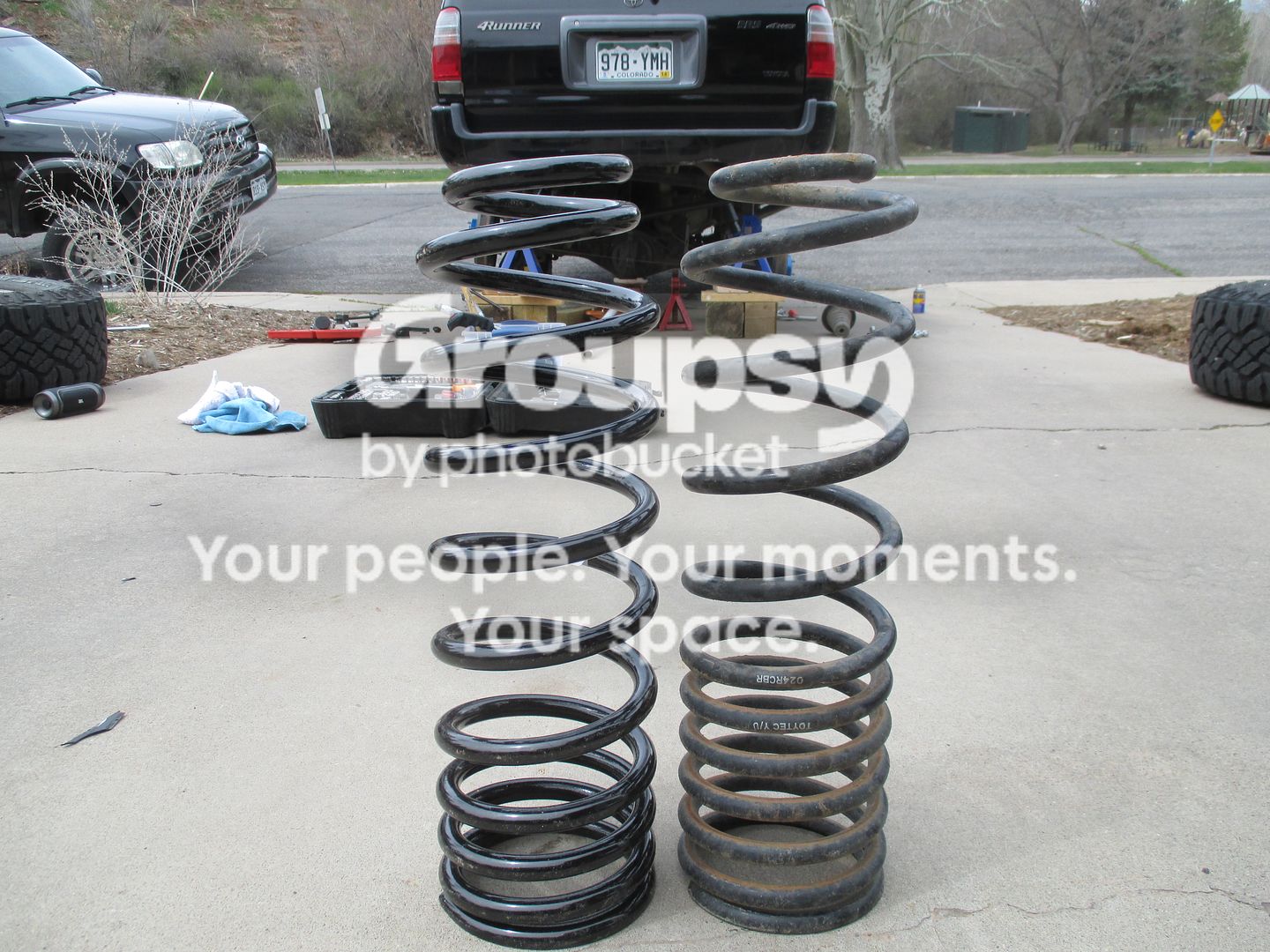

What do you guys think of this? The new OME 861's I ordered came in and after pulling the Superflexes for a comparison before install I see this. Side by side as for height they are basically the same. The diameter of the wraps is the same along the body.
IMG_0464.jpg~original
However where the coil sits on the axle the Superflexes are 2.75" across and the OME is 3.50". So the OME doesn't sit in the cup quite as snug.
IMG_0466.jpg~original

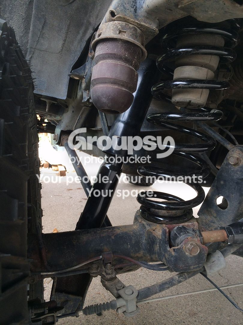

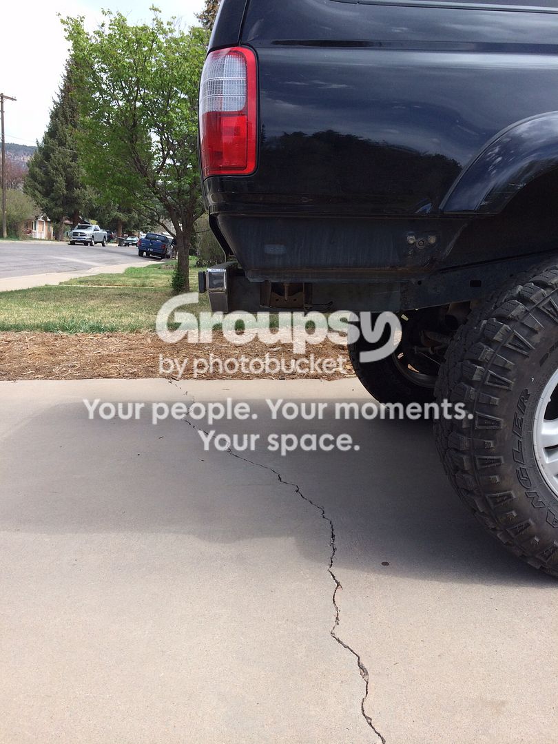

After looking all over to see id there was a difference in models then calling the supplier, reassured it was ok I installed them. Man these things are very tall brand new and I had no weight for the moment. Measurements went from 39.25" ground to fender with zero weight(no hitch, tools or receiver) to 44".
I threw 180 lbs of sand in there and went and got another 180lbs. It settled a little and came down to 42" and the front was still at 38.5". I cranked up the front to 39"(thought I went further) and took it for a flex. Yes major stinkbug look but there will be weight back there soon and I don't DD it. Also I didn't go ut to push it just to try and settle the springs a little, knowing the suspension was still out of tune.

Glad I stopped where I did the shocks were at the end.
imagejpg5.jpg~original
Looks like I may need to extend the bumps but maybe not after I get the back loaded down.

I was thinking about switching to the toytec superflex. What are the differences between the 861 and toytecs? Also, where do you get the 861?

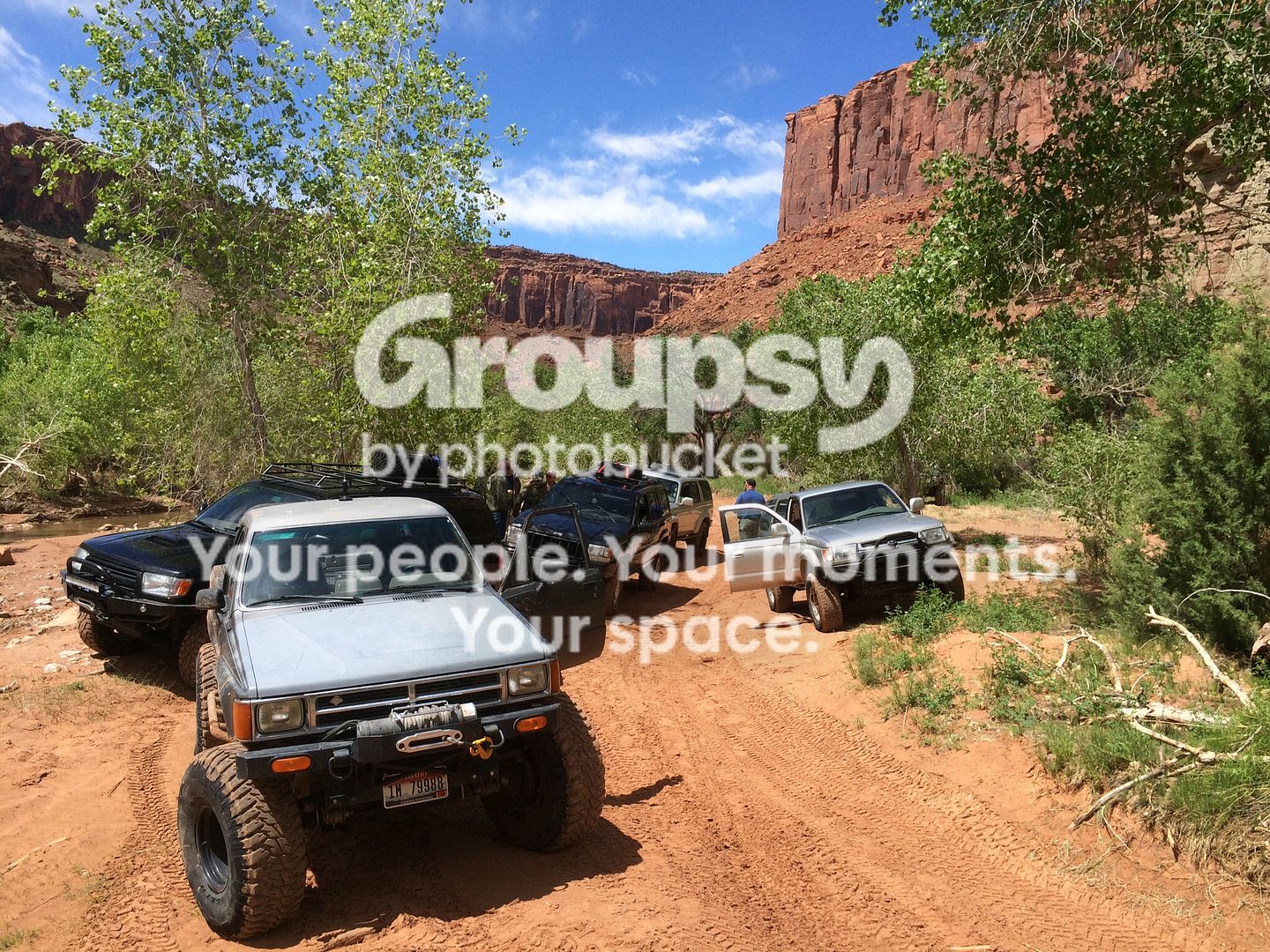

Here's some pics and vids of the Moab trip.
Group Line up on Seven Mile

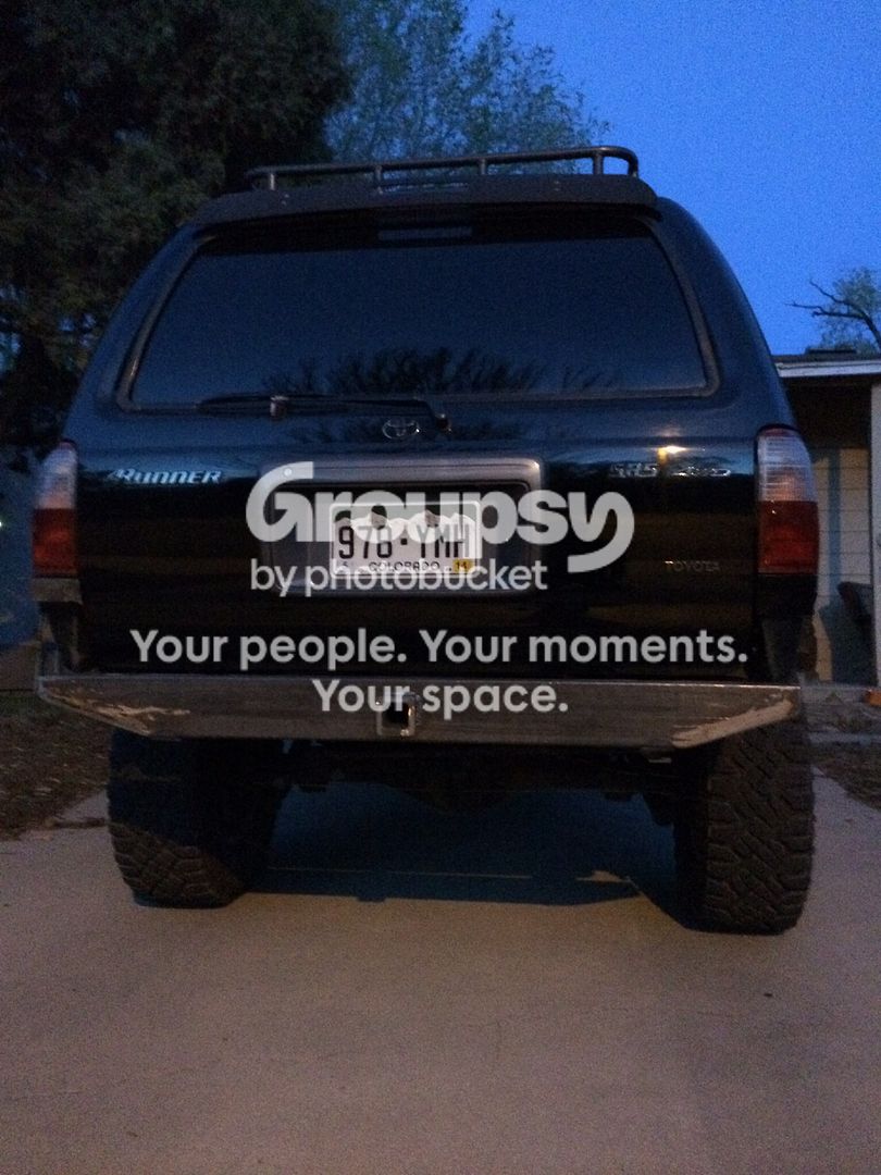

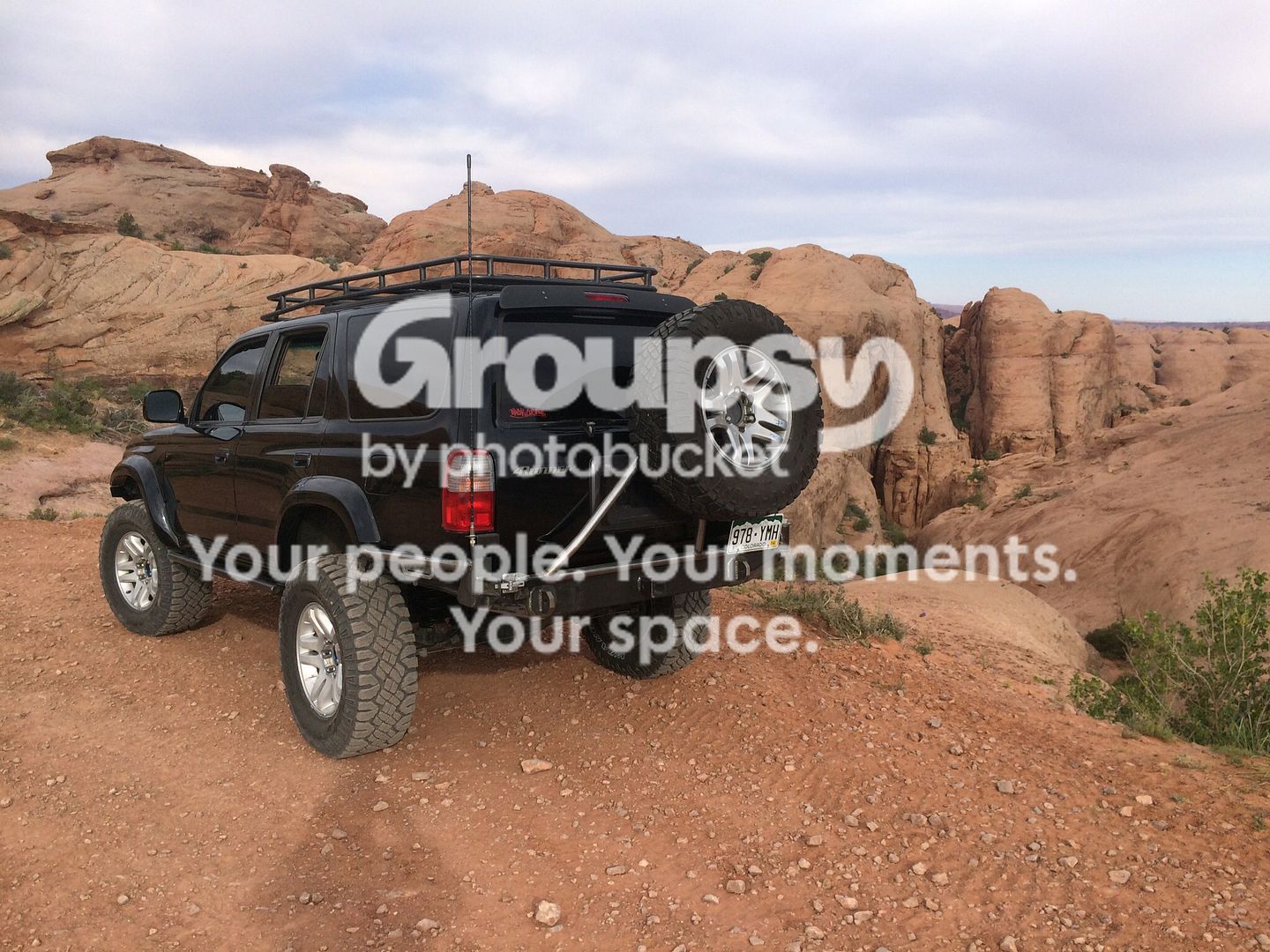

My HYbrid rear bumper
Wanting a high clearance bumper of a design that I didn't see out there. My buddy mike and I embarked on the custom design that follows. It slightly mimics two other brands but has several features I couldn't find. Also I didn't want to buy one. We came up with a plan and $120 in steel later got to work. The first afternoon got us through the initial frame.

You are going to need to post some more photos of that rear bumper! Clean and functional! Next time hopefully ill be part of the group, looks like a great time!

I have plate for the sides that has been cut and ready for pickup. We'll be adding that adding building belly skid Thursday.

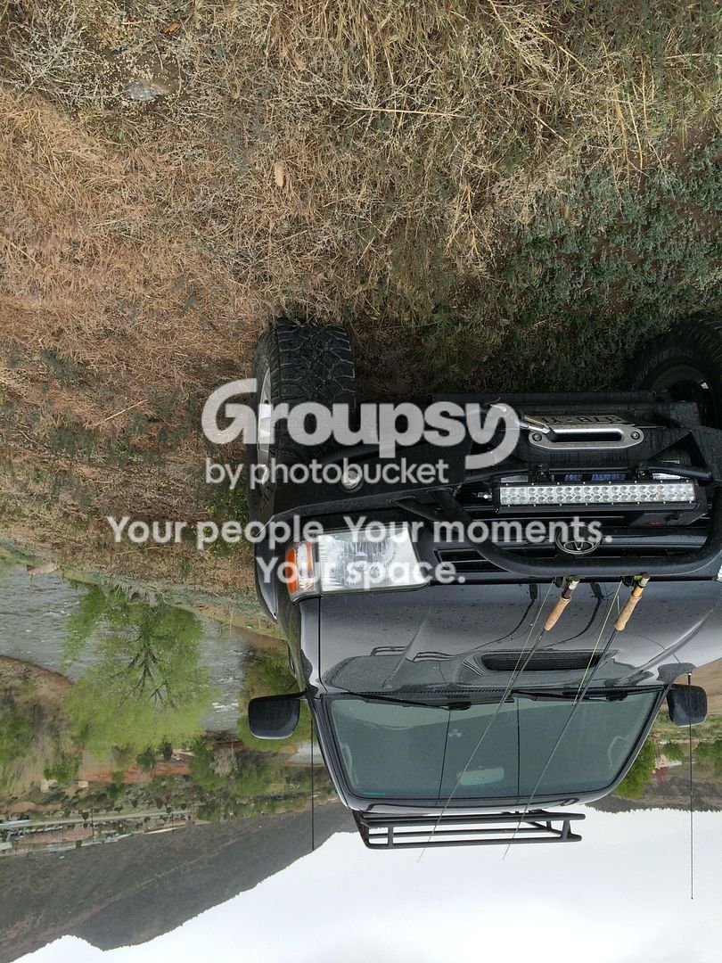

Today I went and ran around the river for a bit.. bumper and roof rack served a different purpose for a minute and gave me some ideas.. what about you fisherman out there. Pretty obvious what the natural progression would be now.

Nice brownie!!! Is the water coming down yet? That would definitely make a good spot to stash the rods, and it would be easy to come up with some mounts.

That is awesome. How long did it take to fabricate the bumper and did you use the original brackets or did you also make new ones??
