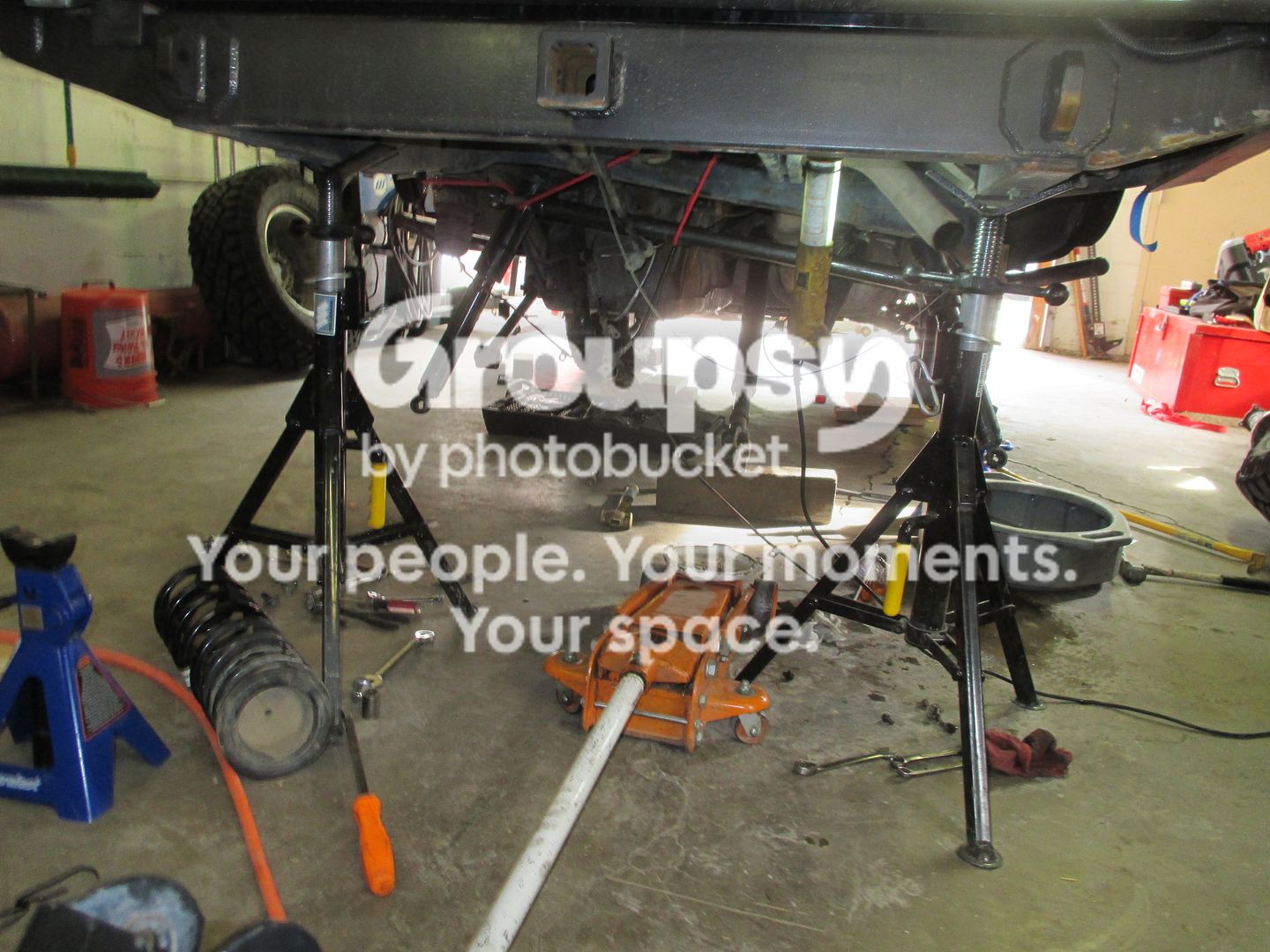

While it was accessible we relocated the shock mounts 1.25" up.
IMG_1026.jpg~original
After getting that situated we moved to the rear bumper and skid plate mods.
While taking the bumper off it fell and crushed my arm. I got very lucky that it didn't crush my head. That was inevitably a major hang up and still is not entirely healed.

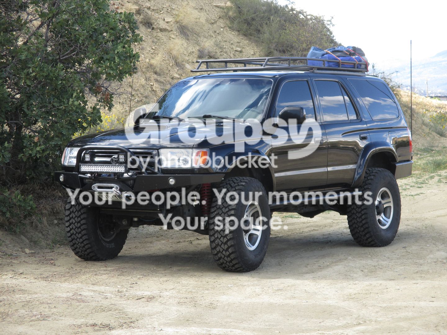

Again no pics when I rolled it out. At that point it was on 285/70's and my 3 mile trip home was awesome. The gears were noticeably more responsive than the 4.30's. I only drove it a back and forth to the shop the next day. Then I mounted the new tires and wheels
Hankook Dynapro RT03 295/75r16
LX 450 wheels

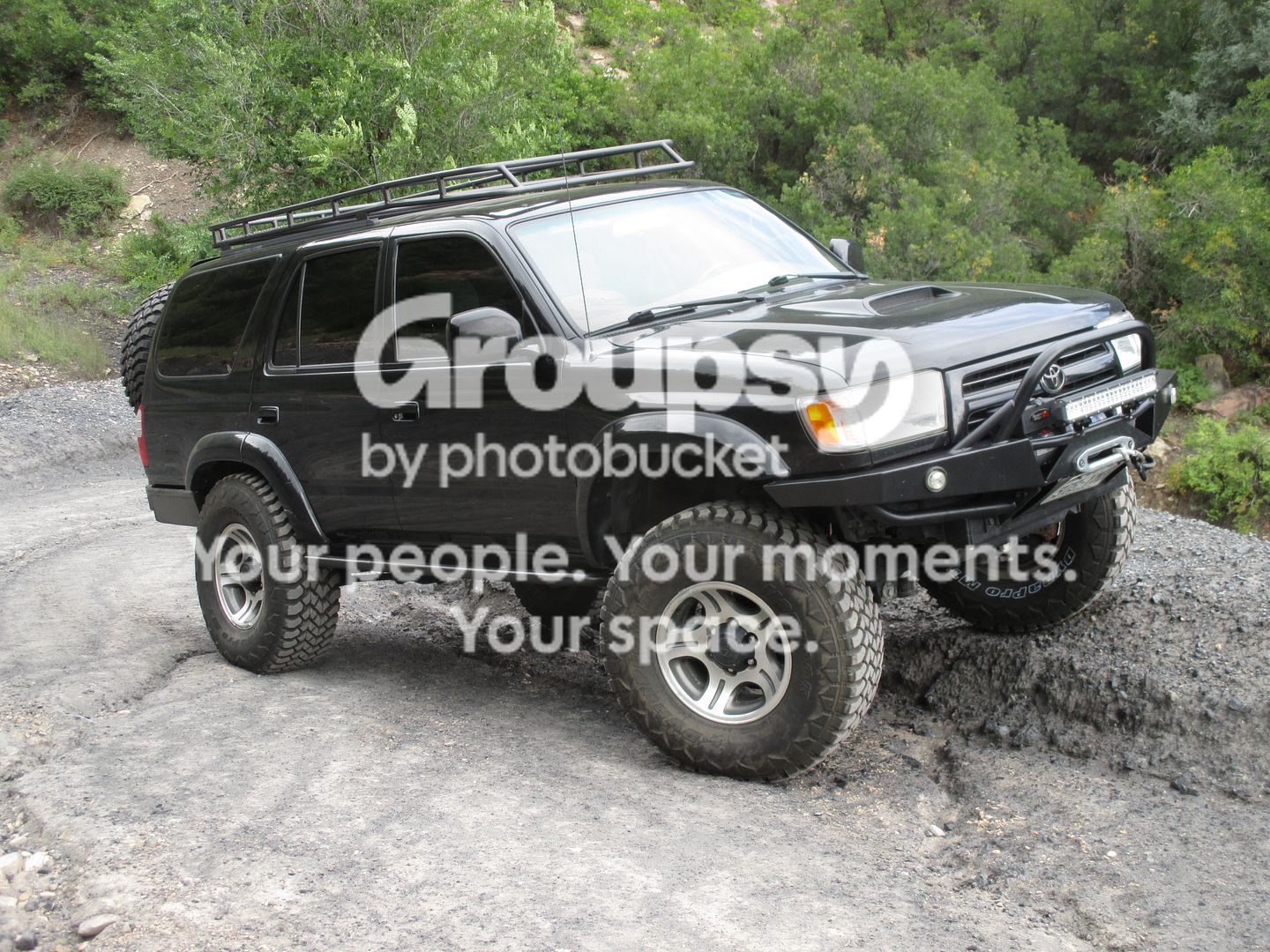

Looks bad ass with the Hankooks and LX wheels. I'm stoked to see what you get done with the front locked now!

Truck looks super good! Makes me want to gear my truck. Any pics of where your rear shocks mounts ended up?
Sucks about your arm man, but like you said it could have been worse….
Also those jack stands are ridiculous, I want a set.
Thanks, If only I didn't have to use the spacers I think it would look better. Front locker has only been tested not needed yet.

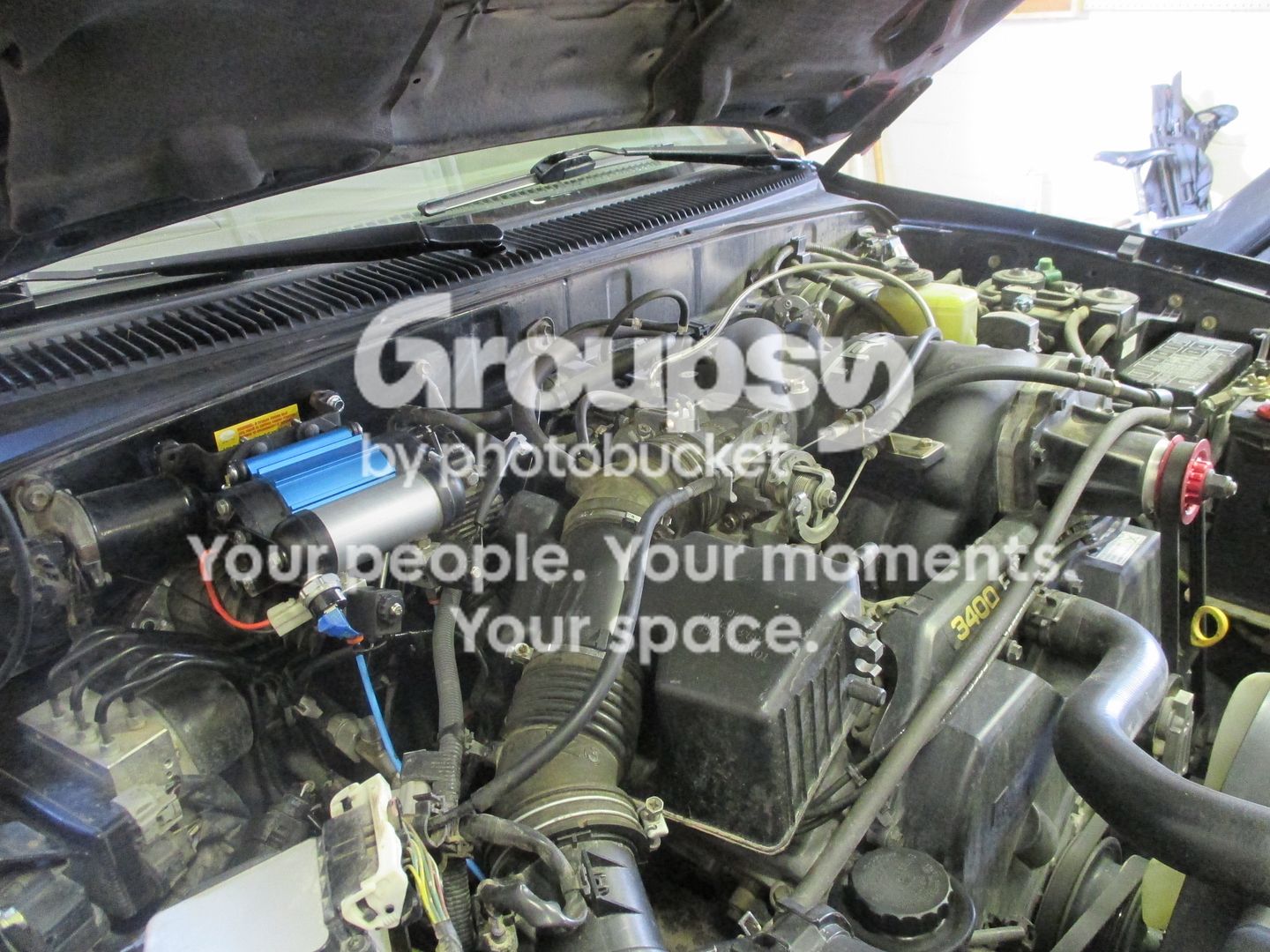

With the install of the ARB's came the compressor. I just put it in the same spot as the PO which is fine for now. it does make checking the tranny fluid even more of a pain but not impossible.
IMG_1045.jpg~original

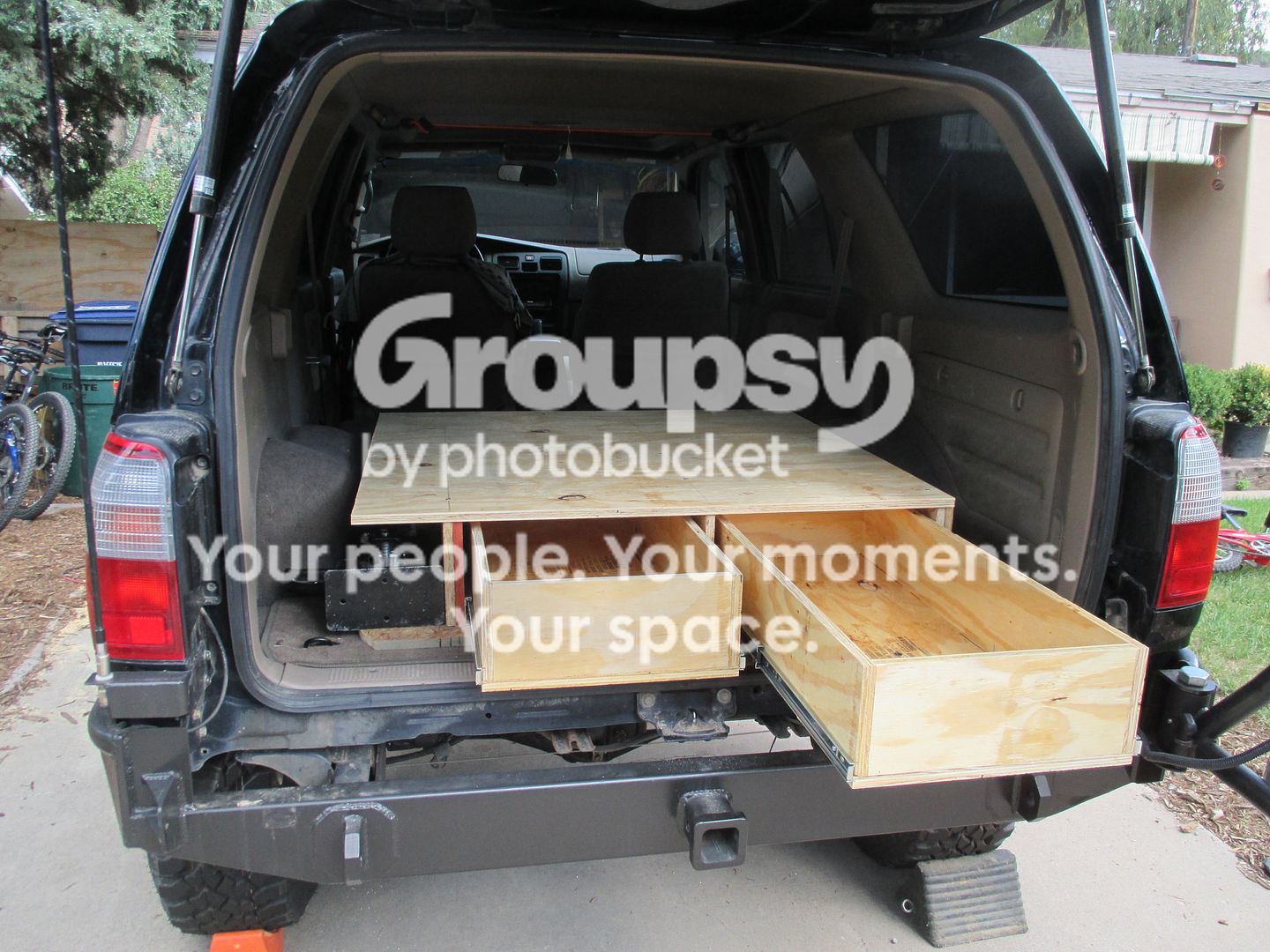

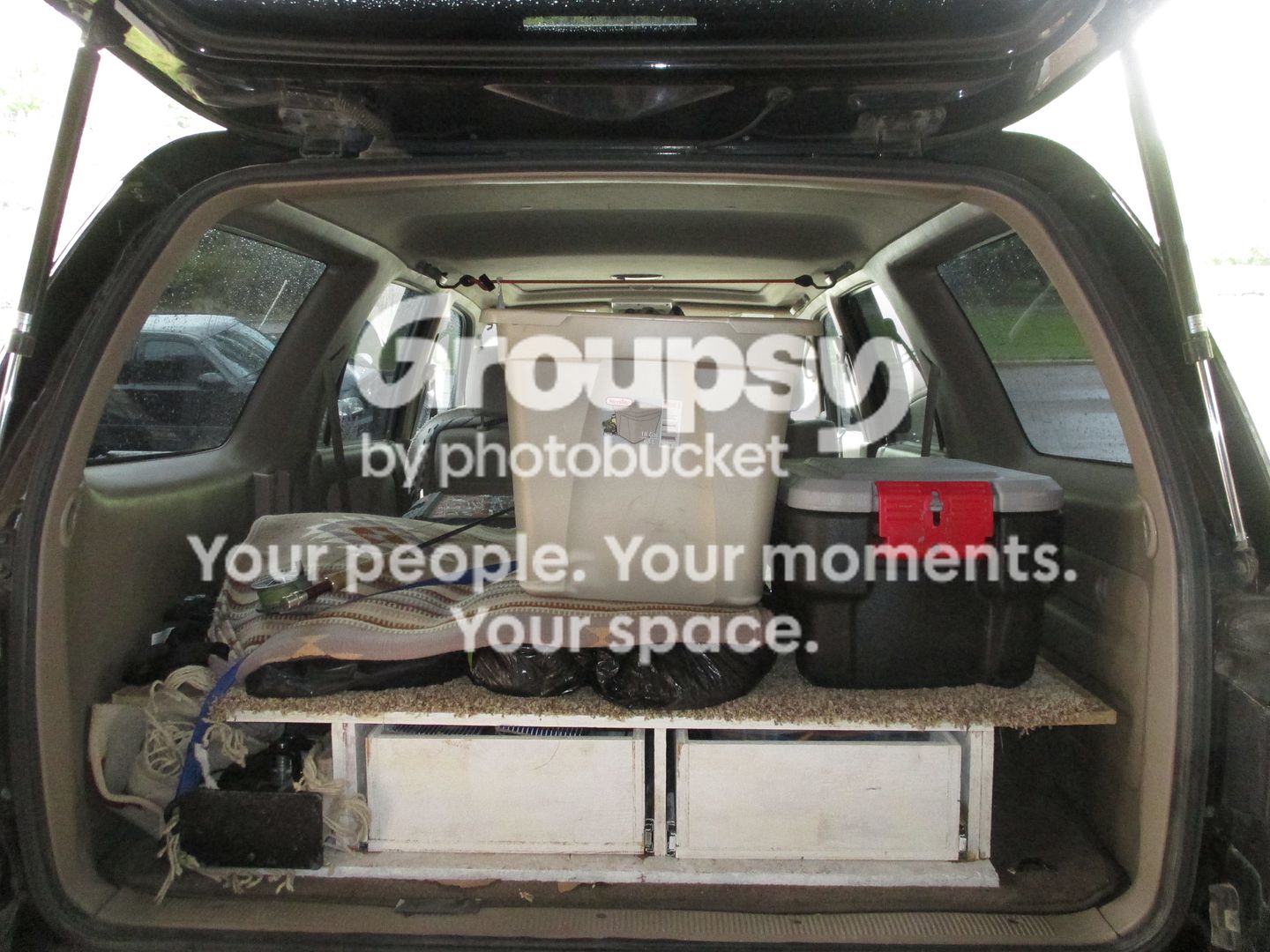

Reworked my sleeping platform with a little inspiration from patioburrito and Gerdo. Here's the beginning stage. I've got the jack there for two reasons. One it wont be a projectile if anything ever happens and two, I don't think I want the weight on my bumper. Right now it swings open very easily and operates great.

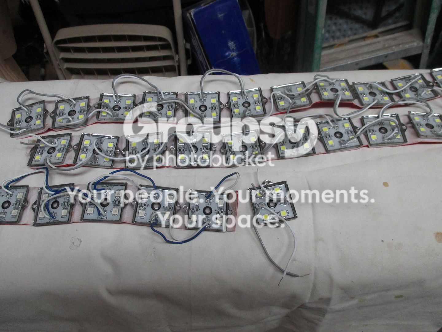

I've had these Underglow rocklights for a month now. They are very bright and I got either 5 or 10 extra bc it took them a week to ship. I've measured out and made a harness with them for each side. I also painted them black and hopefully can install soon.

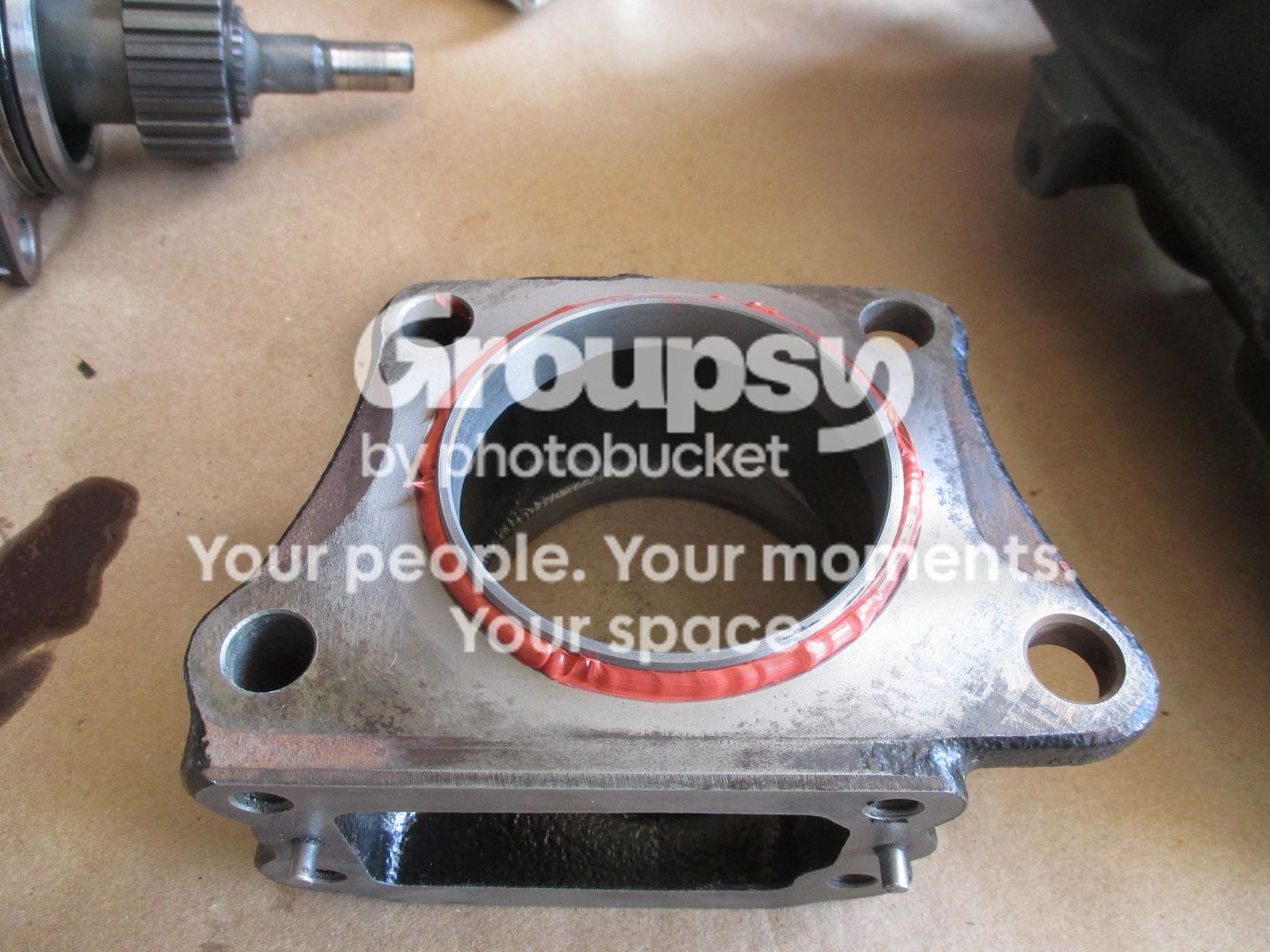

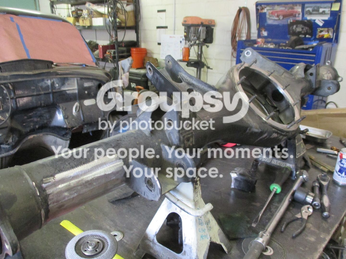

Round two with the front diff. When we installed the front diff, we made one HUGE mistake. initially when removing the broken 4.30 it was tight so we zipped off the pinion flange. when reinstalling the new diff we did the same thing. I didn't realize the importance of the setting of the crush sleeve in the pinion bearing and I was in a welding shop. Within 15 miles of driving the truck it became obvious something was wrong. After troubleshooting with some friends, it became painfully obvious that the pinion bearing was hosed. At that time my arm was messed up so the truck sat for a week before I could get the diff out and send to ECGS for service. A long 10 days later here it was, the serviced and still warrantied front. I went ahead and got new stoppers for the front diff mount and some Toyota sealant for this attempt.
IMG_1057.jpg~original

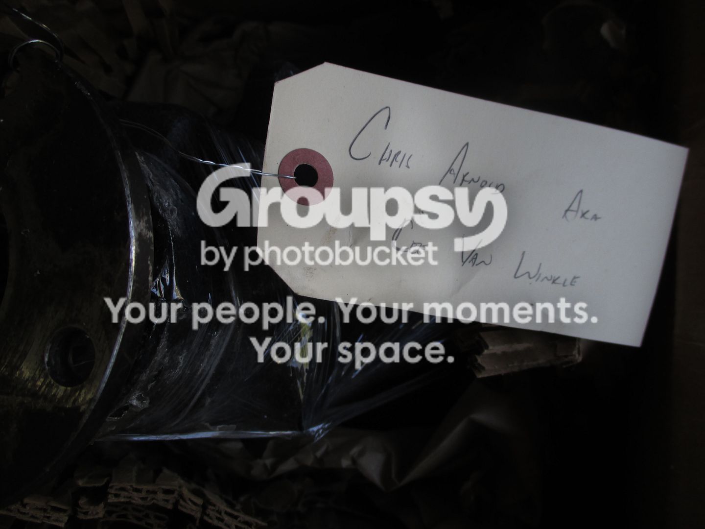

Guys at ECGS are great and were a lot of help...but the got my name wrong
IMG_1058.jpg~original
random pic of bead of sealant on actuator housing
IMG_1061.jpg~original

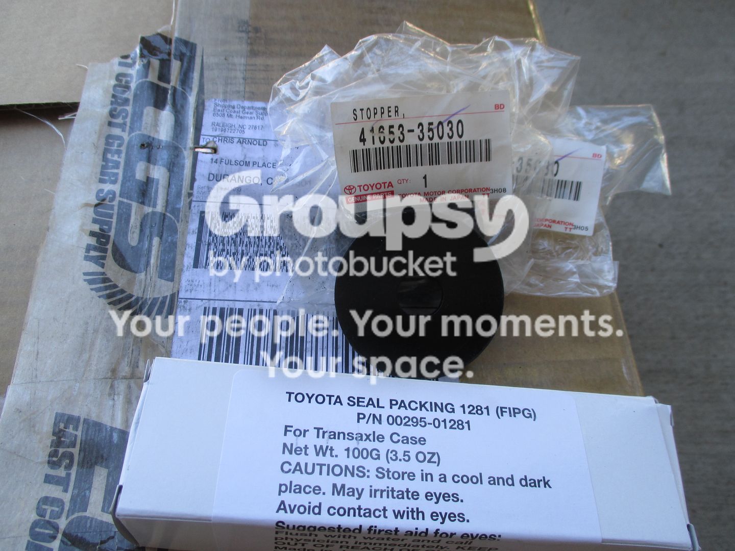

When I reinstalled the front diff I looked to many people and places for tips. J-money had some info but I called and talked to Chase at ECGs. after that I decided to just pull the rear bushing mount and it was incredibly easier and quicker. At that point the truck was back together and everything was buttoned up.

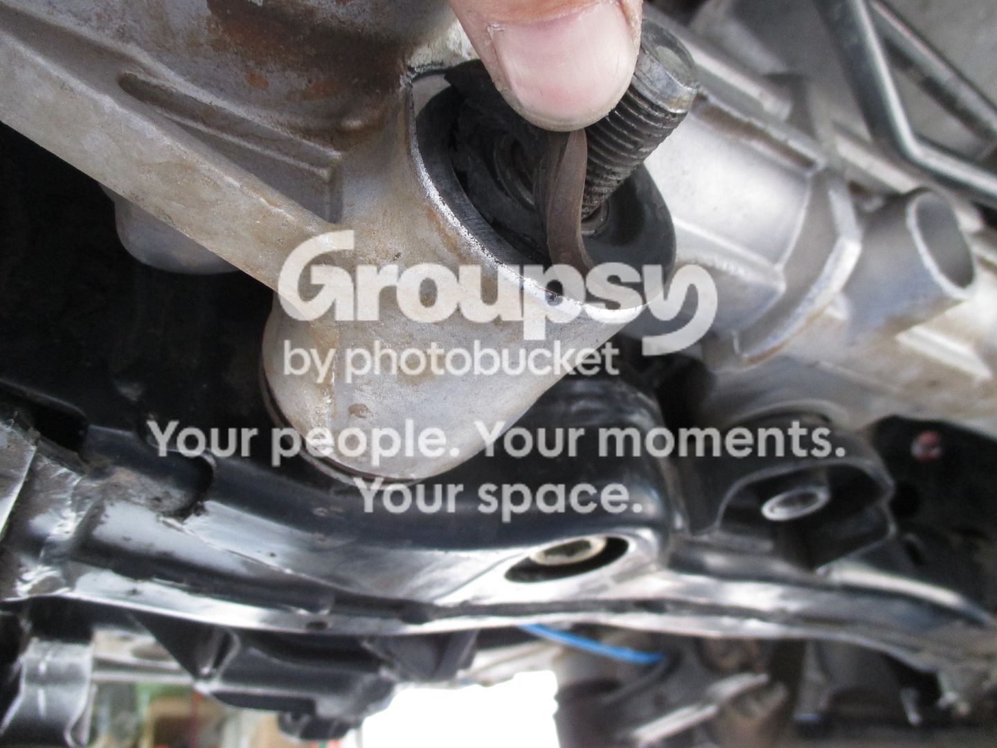

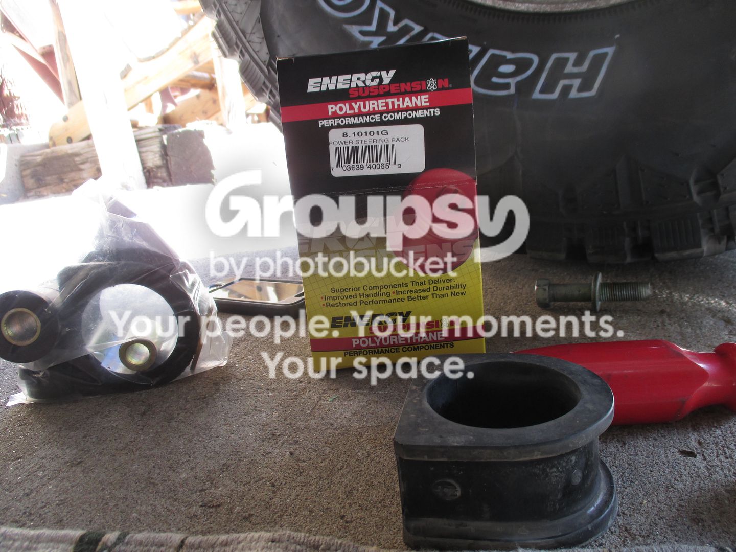

So I started addressing a couple other things. When I got my safari rack installed I just assumed they installed the energy suspension bushings. Well they didn't and the ones it came with were toast.
IMG_1068-1.jpg~original
IMG_1069-1.jpg~original
I found a very good 2nd use for my 35mm socket

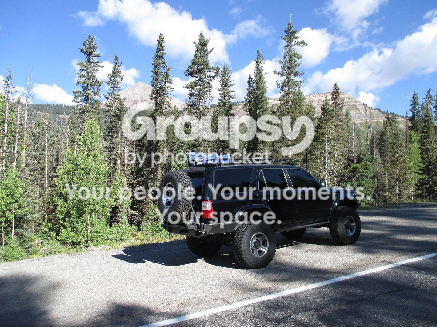

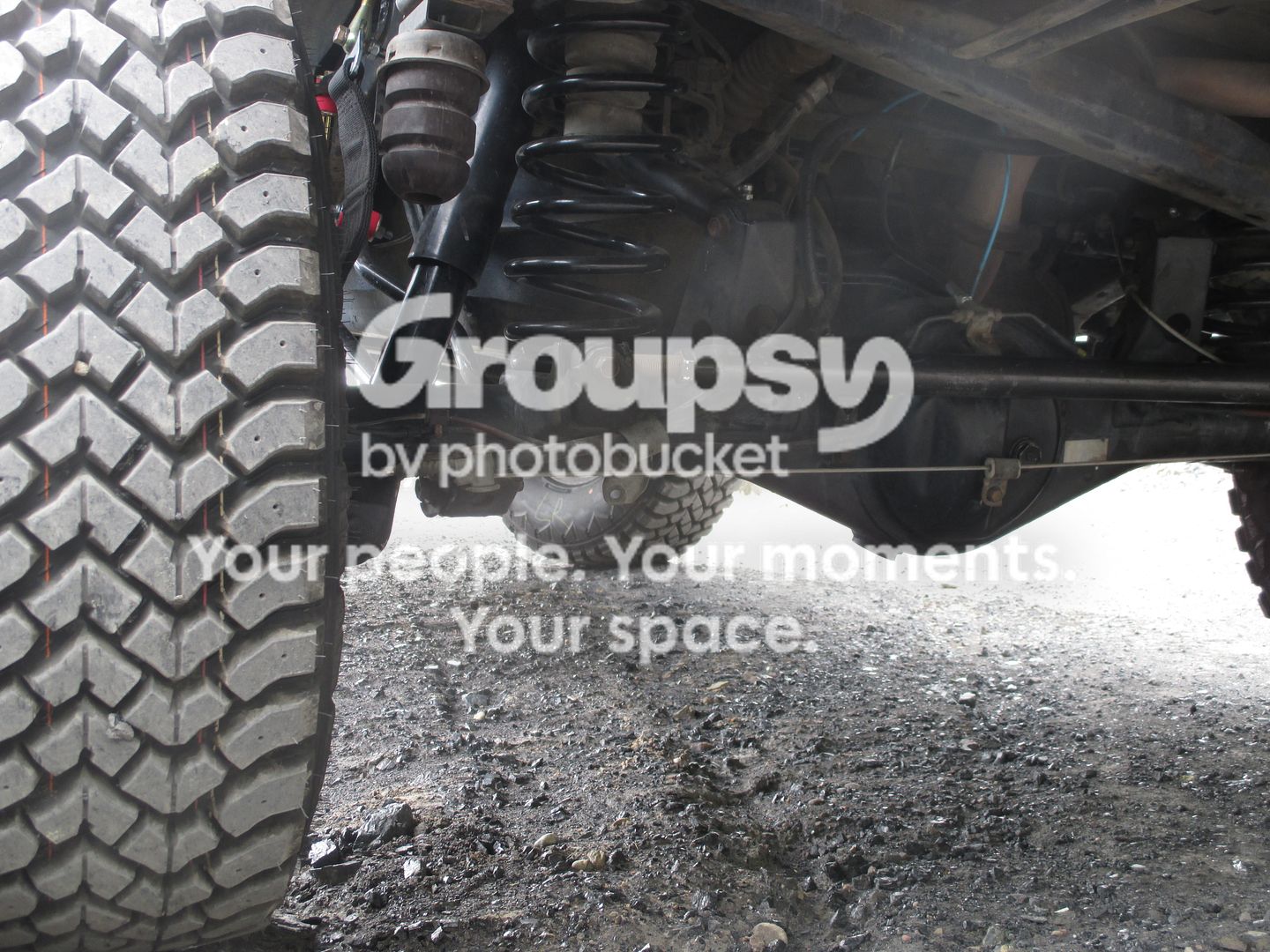

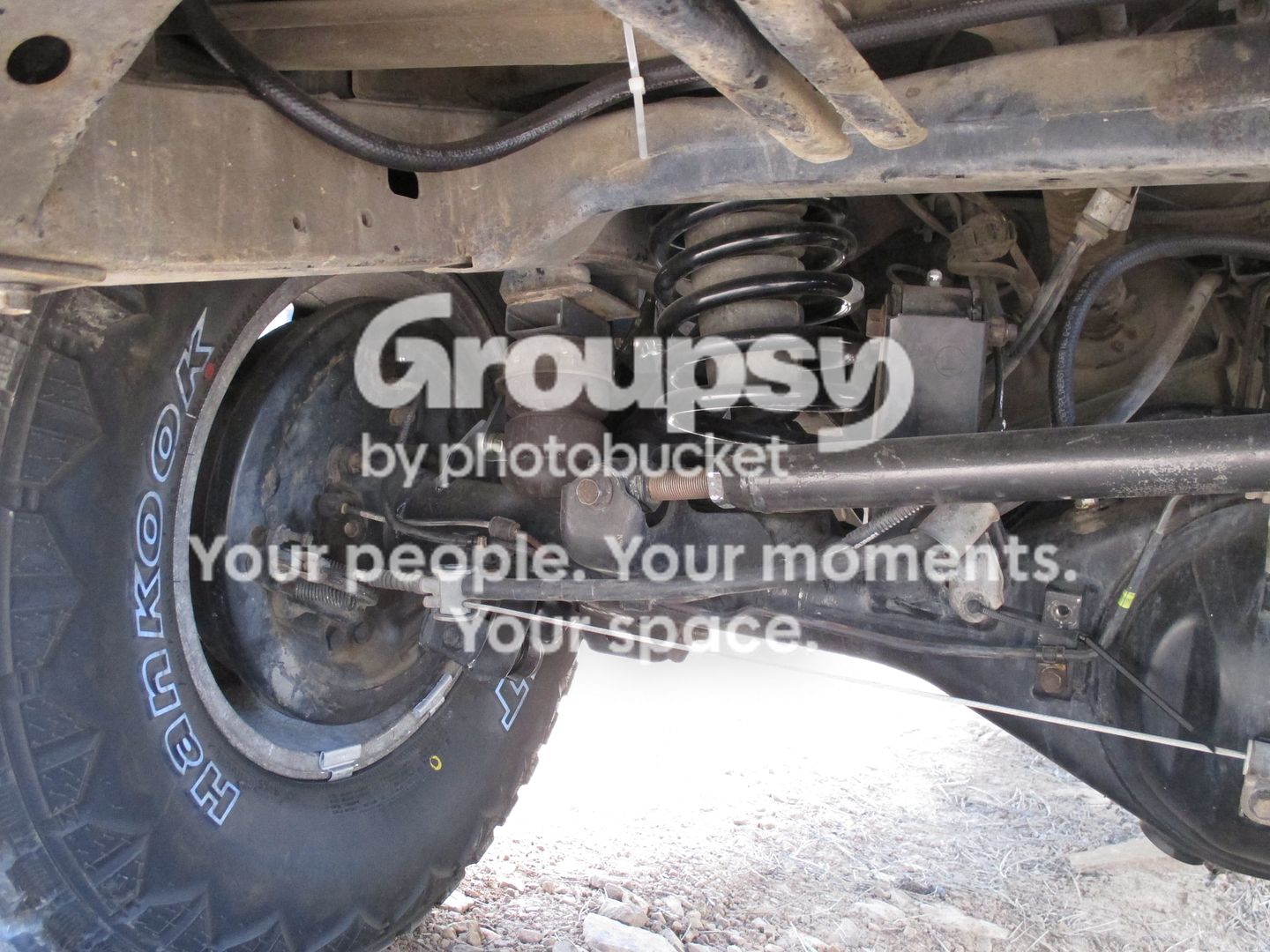

Best pic I have of where the shock mount ended up. you can barely see the limit strap in there too.

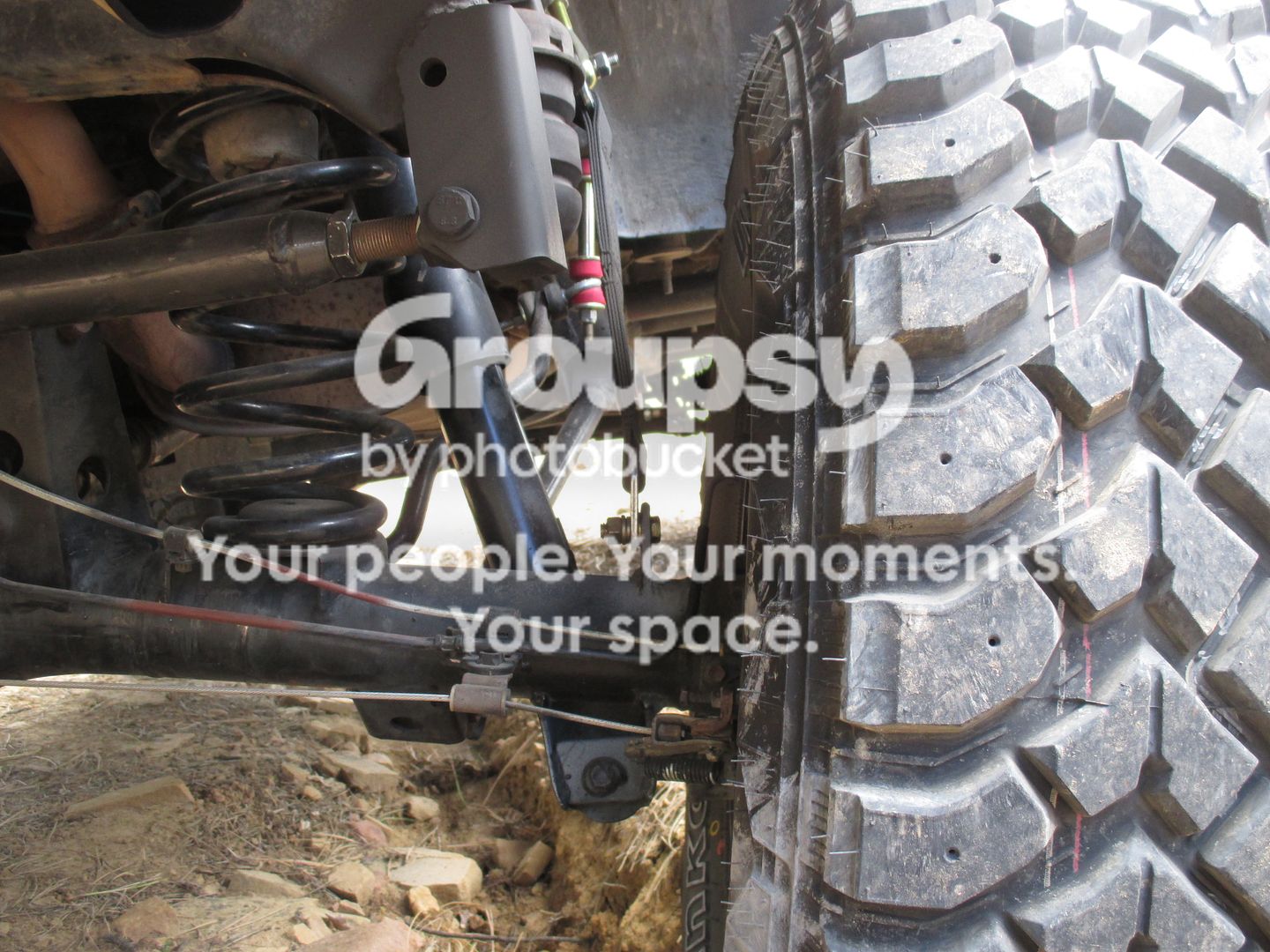

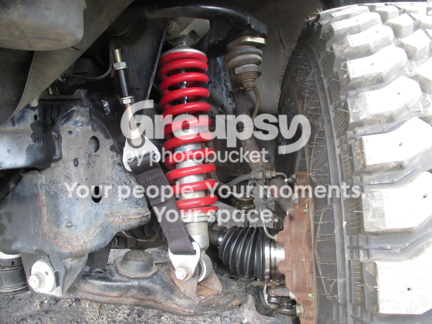

Following the lead of Dirtco and Bigfishallday I installed limit straps in the front too. Mostly so I would prevent over extending when three wheeling and also because I thought after being around Nick's truck that they looked beneficial when in need and use.

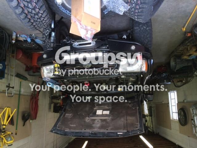

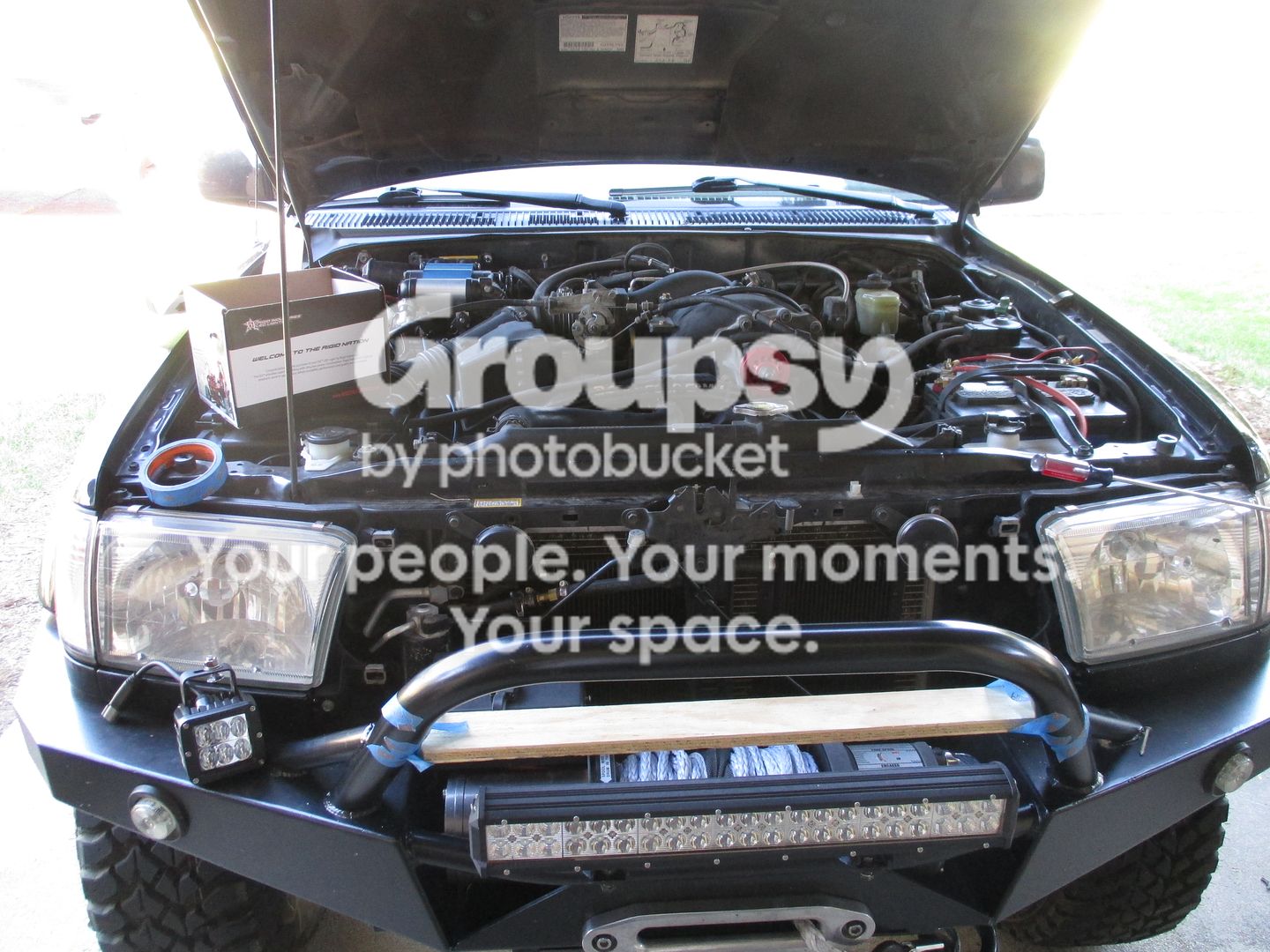

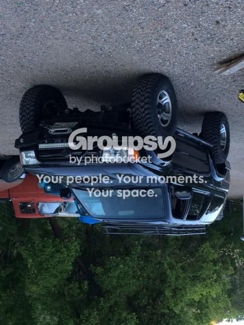

I found some Rigid D2 amber driving lights and wanted to start finding a spot for them. My initial plan was to put a bar where the wood is and set the led bar on it. The primary goal is to get the LED back out of harms way from rocks as I've almost crushed it several times. we installed the bar but when I put the light bar up there it revealed the winch which I didn't like. So it is how it is for now but eventually the led will be back 2.5" and I think the ambers will be. I cant wait to use these things in the snow, they should really do the trick. You can also see the dual 70264's in there.

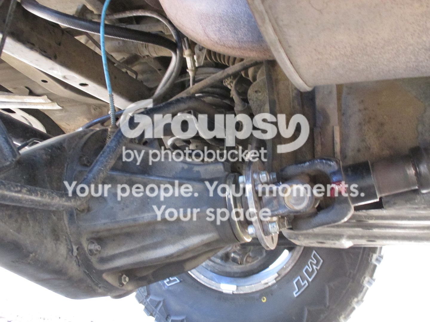

While looking underneath I noticed the grease shooting out around the zerk. Initially I thought I sheared it off again. Turns out it was just loose. Notice pinion angle and the gas tank skid that was chopped for clearance.

Platform is partially finished but functional. No that's not a dead body under the Mexican blanket, its 180 of sand helping to keep the rear end and 40.5". These 861'2 I have are very tall. I have what u see in there plus the drawers are stuffed including 2 cvs, ball joint, high lift, spare on bumper and a beast floor jack.

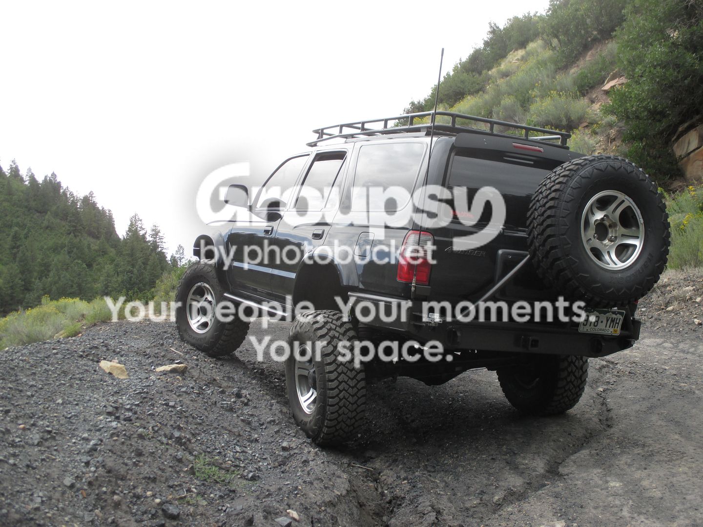

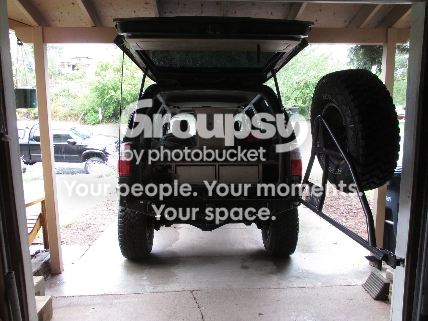

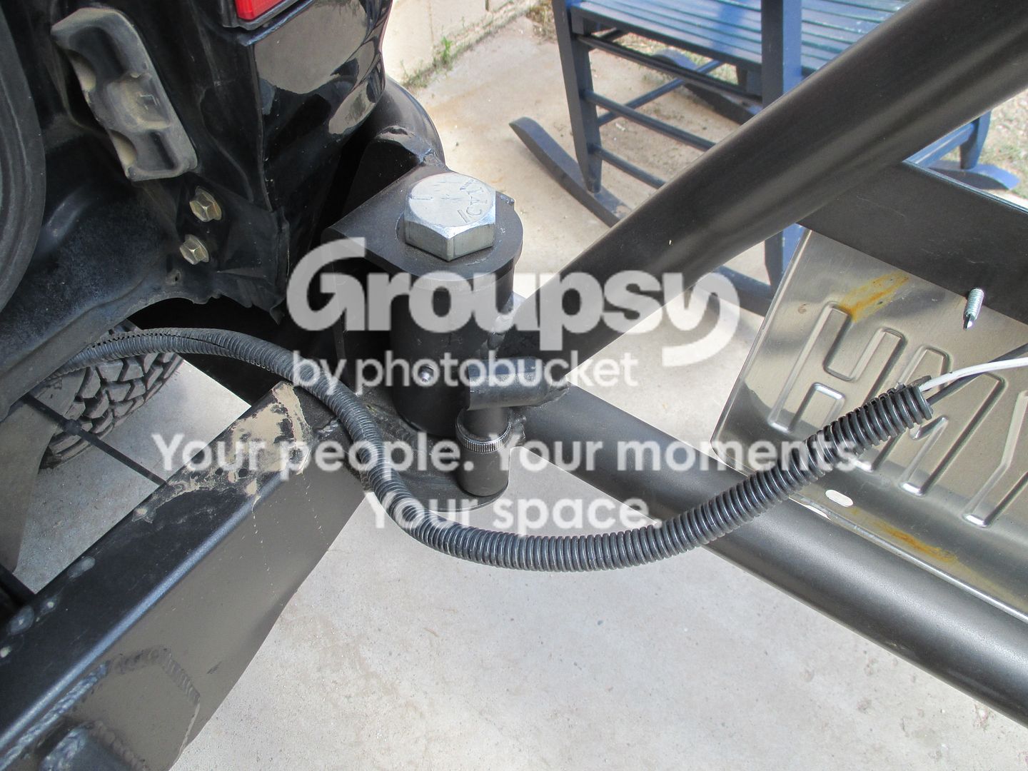

I really like home my rear bumper and tire carrier turned out. I can easily access the key to roll the window up/down allowing me to slide the goods in. Operate with one hand when necessary and looks pretty unique.

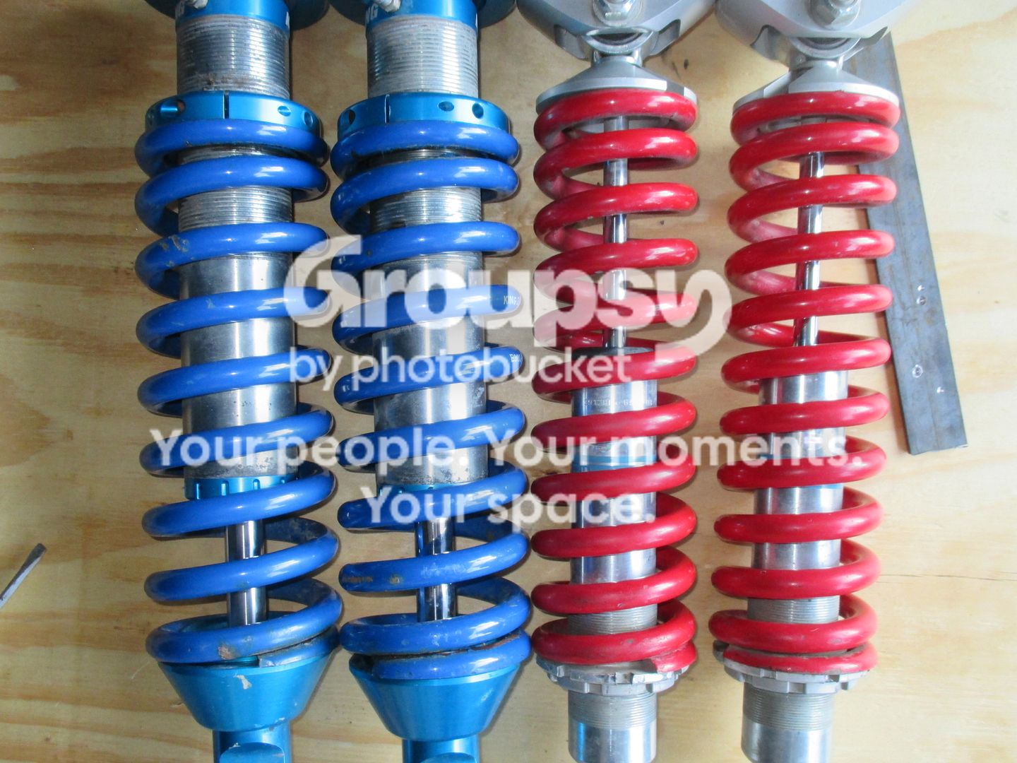

Sweet pics of CO!! Its gorgeous up there. How are you liking the kings compared to the toytecs?
Kings are much different than the toytecs at speed, on the road and normal driving conditions. I haven't rock crawled with them although I expect they'll act about the same there. They do feel like they float across uneven terrain and make you want to go faster. On washboard roads it is evident the faster you go the smoother they get however the back gets a bit OOC before too far. I could easily mash the pedal to 50 if I so wanted on the washboard. Speed bumps, the noticeable different is coming off the backside. The front doesn't buck up like before. I have to think that new rear shocks will make a better ride.

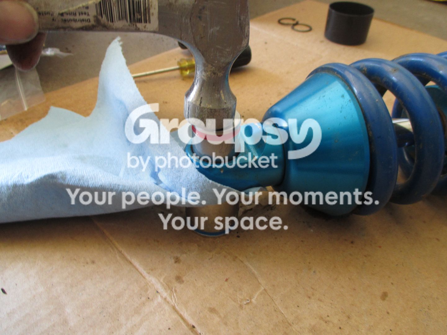

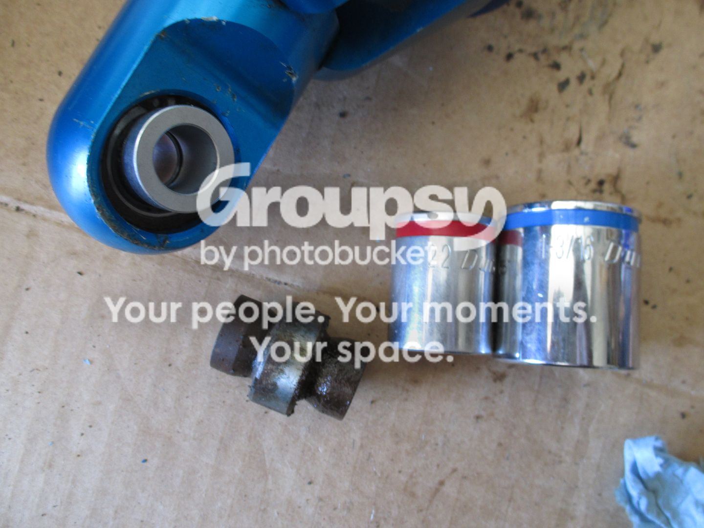

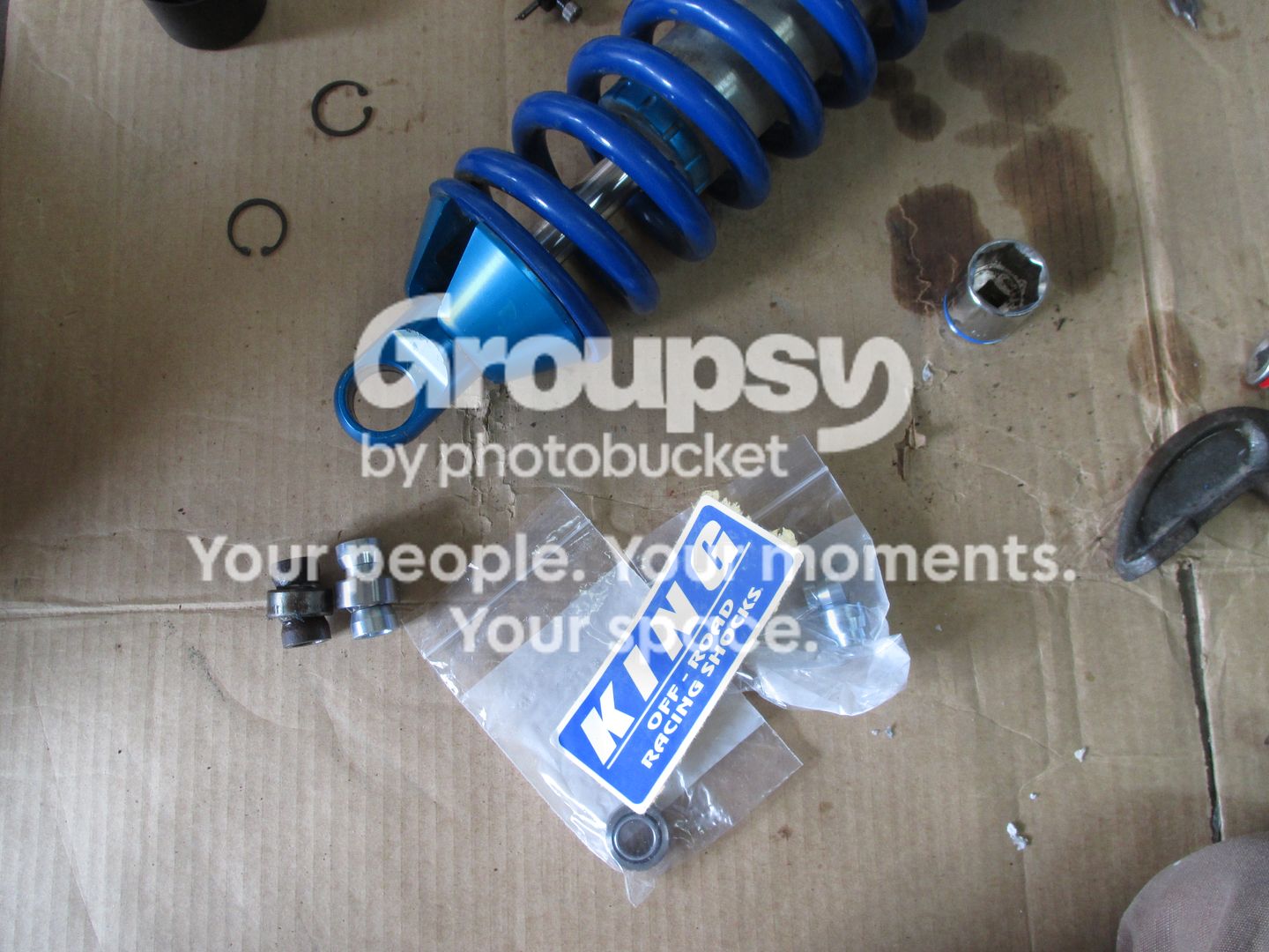

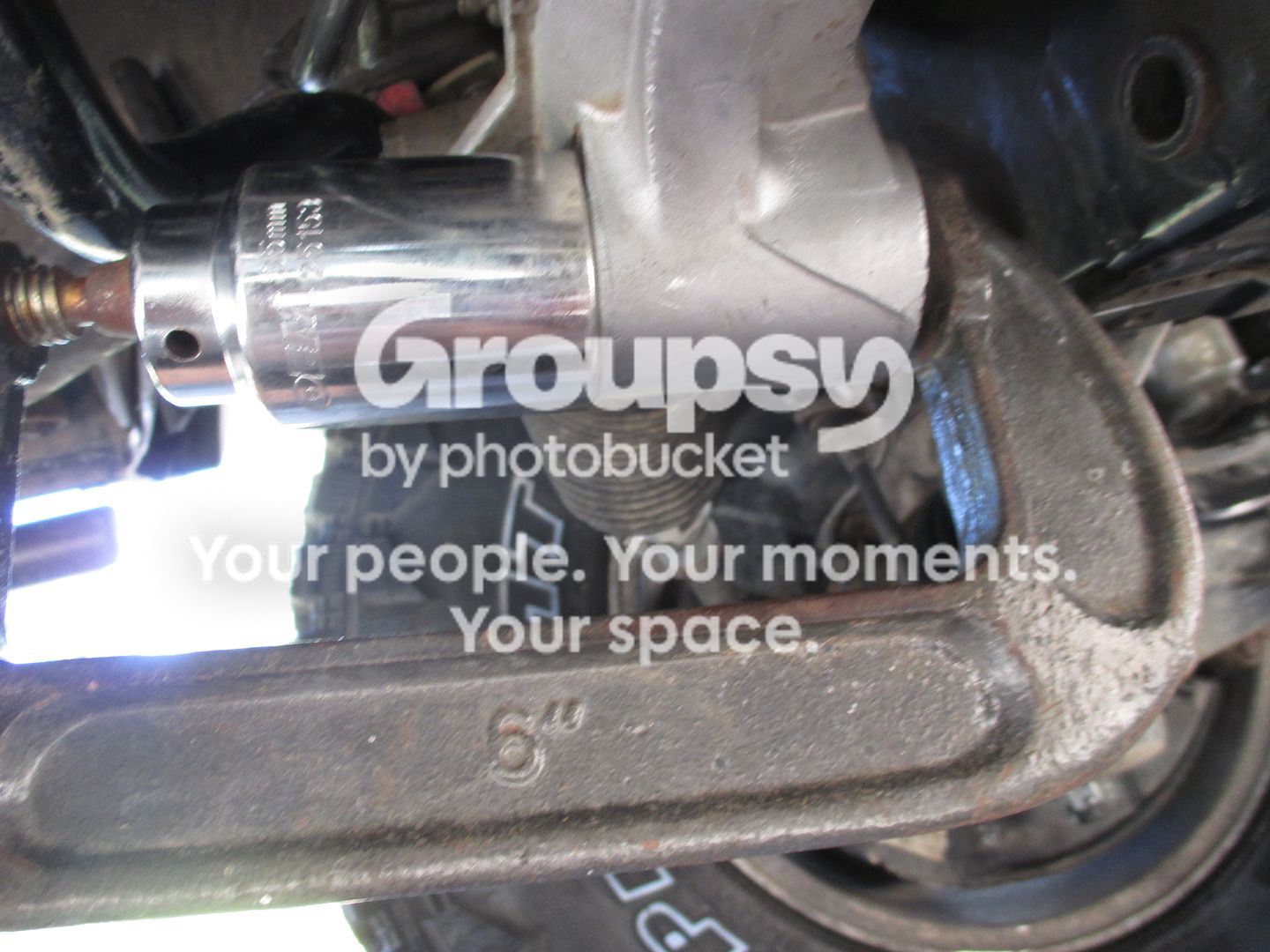

I recently bought some used kings. Like many things in my life I learn the hard way. Slightly blinded by shiny and blue and determined to get some when I found them I sprang at the first pair. Although the seller may not have misrepresented them it was obvious when I got them up close that we had different opinions of perfect working order. At minimum the lower bearing in each was rusted solid. I got on the phone with king and talked about what I was seeing and the coils, preload and rusted bearing. I ordered new bearings and put them in yesterday. The hardest part was getting the snap rings out because of the rust. I soaked them with some pb blaster and a little work eventually got hem out. I had to do it with the spacers on which made it more difficult.
I used a 24mm socket which fit the bearing perfectly. On the other side I used a 1 3/16 socket fit just outside of the bearing on the opposite side. I tried a 6" c clamp that bent and didn't work. I then tried my bench mounted vice like I watched I a video. I bent the handle on the vise. Then I tried this and I one light tap the bearing moved and back in the vise it went. The paper towel is to keep pb from splattering. The scratches on the bottom of coil r from po removing them and allowing them to drop onto the shock mount.

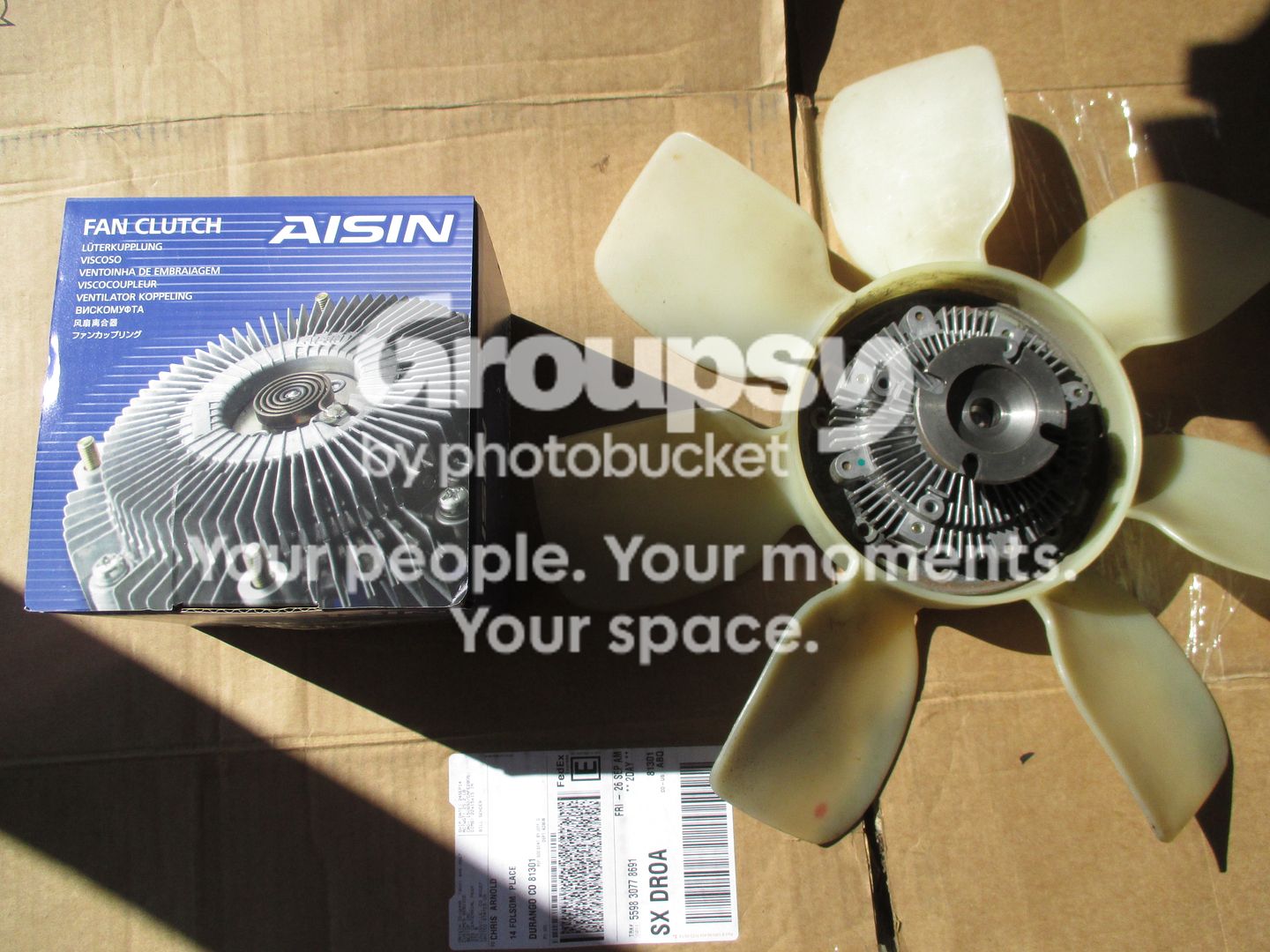

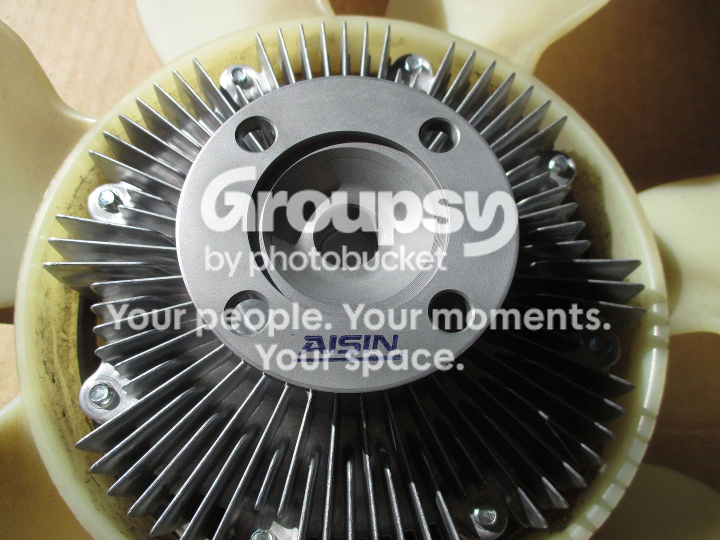

Then I pulled the duralast fan clutch I put in last week and replaced it with this
IMG_1242.jpg~original
IMG_1243.jpg~original
