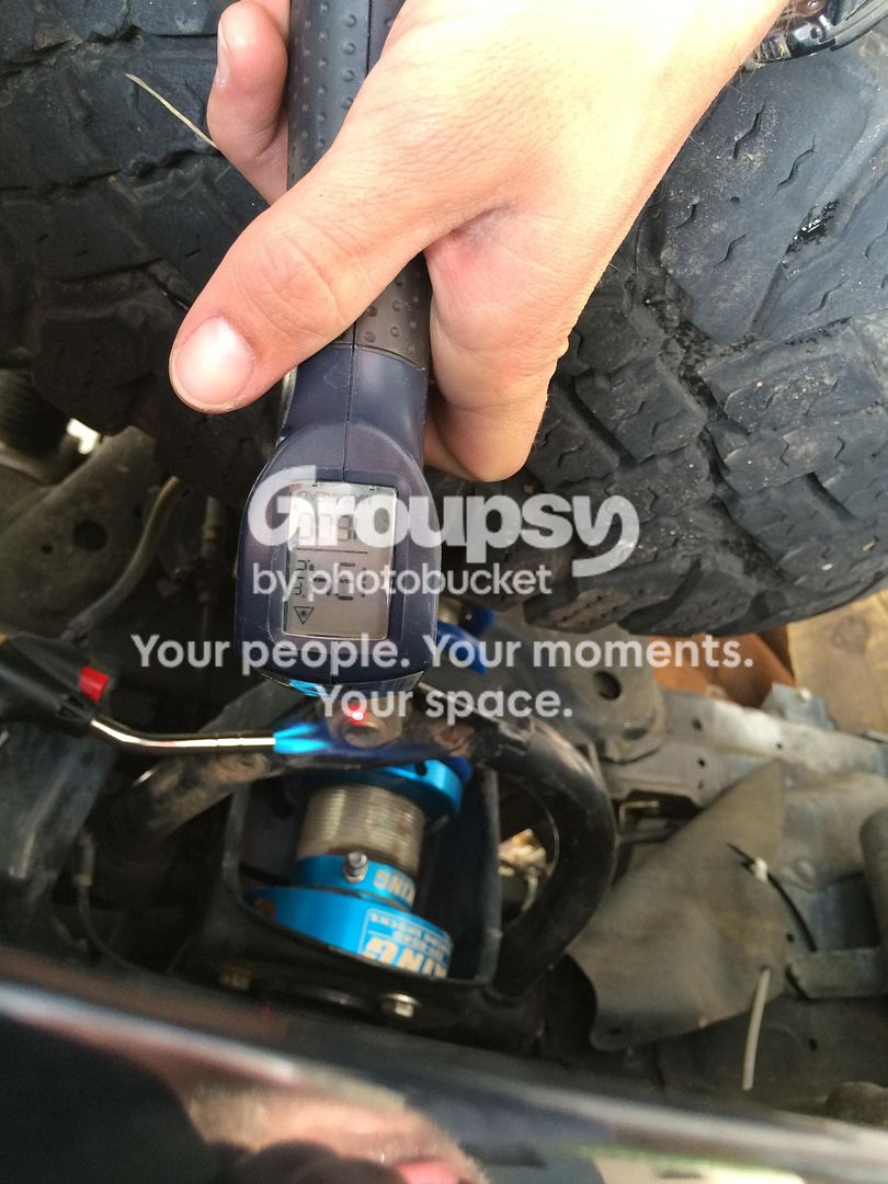

Everything worked great. Temps never went above 182 and 165. I do have a clunk in the front that I cant locaqte. thinking maybe my napa otre even thought hey don't feel bad and aligned fine. thinking mayb e those or the lower control arm bushings I've not replaced.

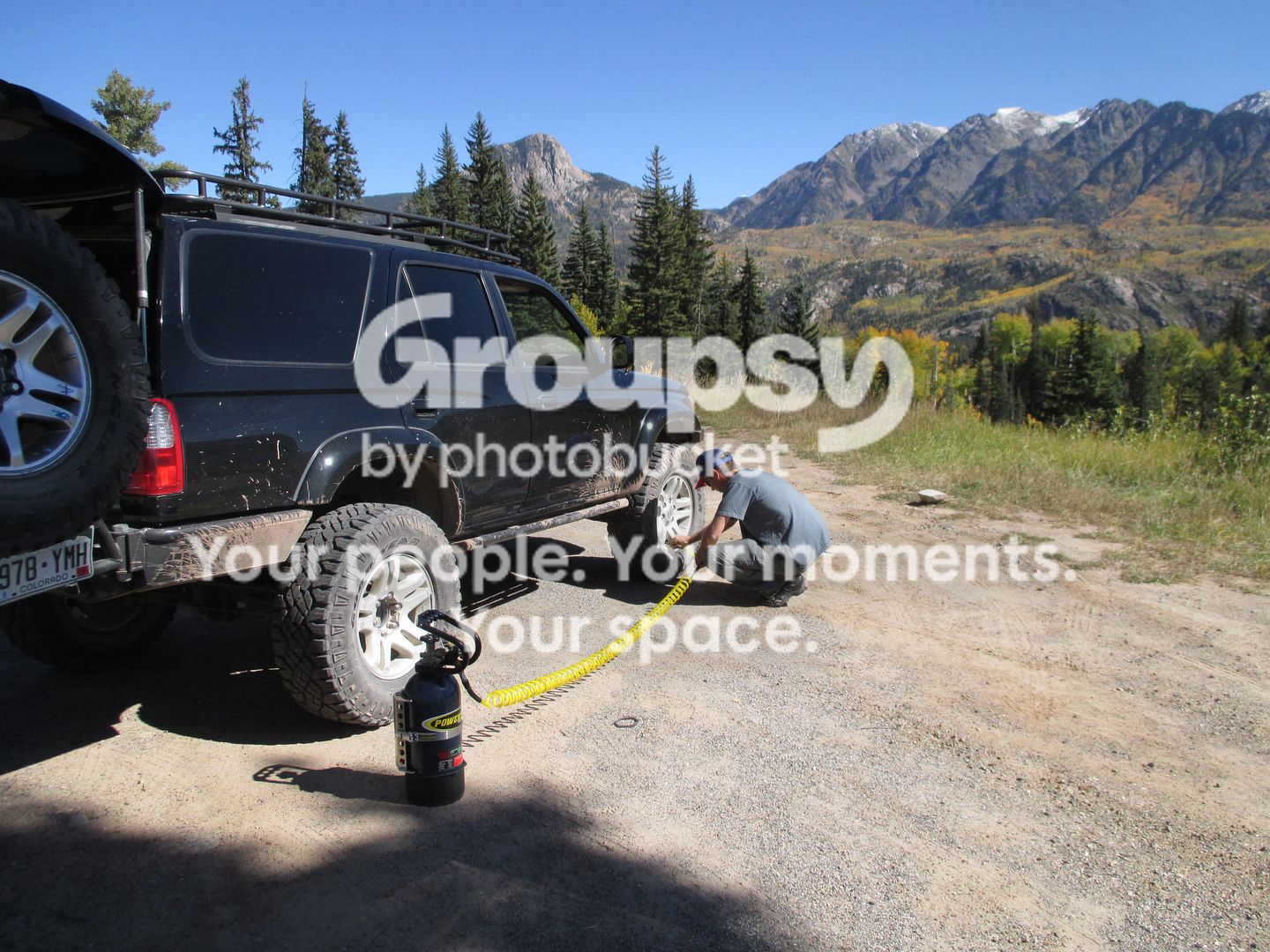

Then I used my craigslist powertank to quickly air back up.

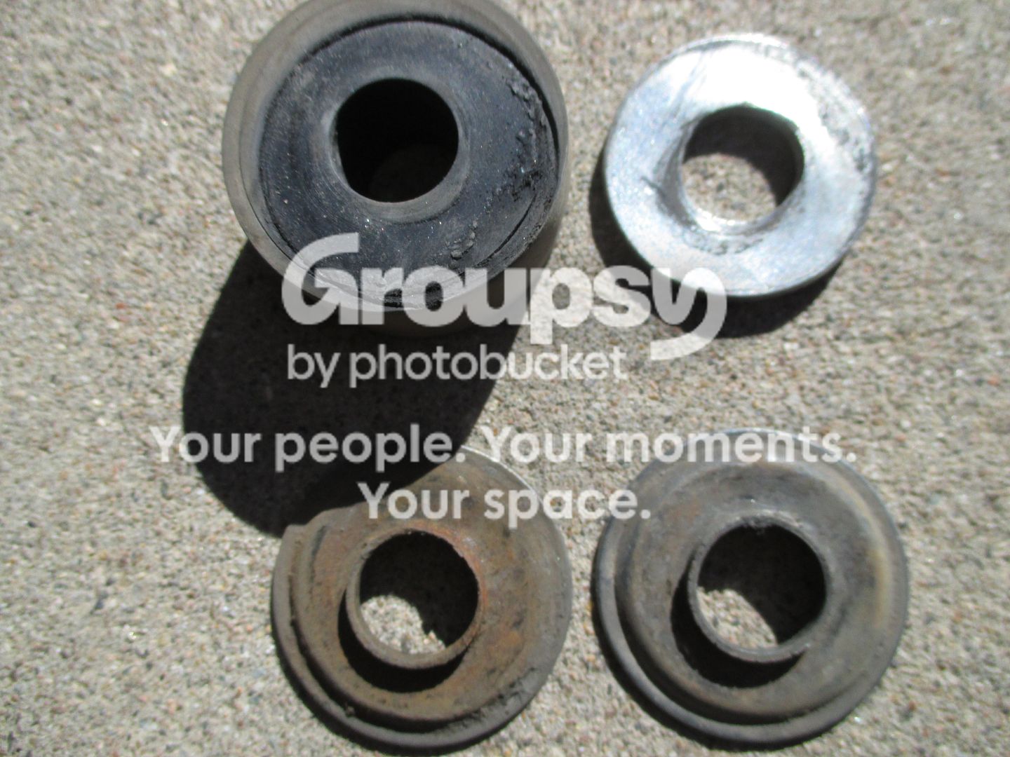

In my endless search to find the source of a rattle or clunk I came across this.
IMG_1263.jpg~original
The centering washers from each side on the LC 80 shocks has deteriorated and become sloppy in the frame mount. There is a noticeable sound at each shock post to frame mount that I believe is one of my sounds. The washer I was using on top of the bushing was too small and u can see the result. The washer is also quiet wallowed out how as well. I ordered some replacements and put it back together for now.

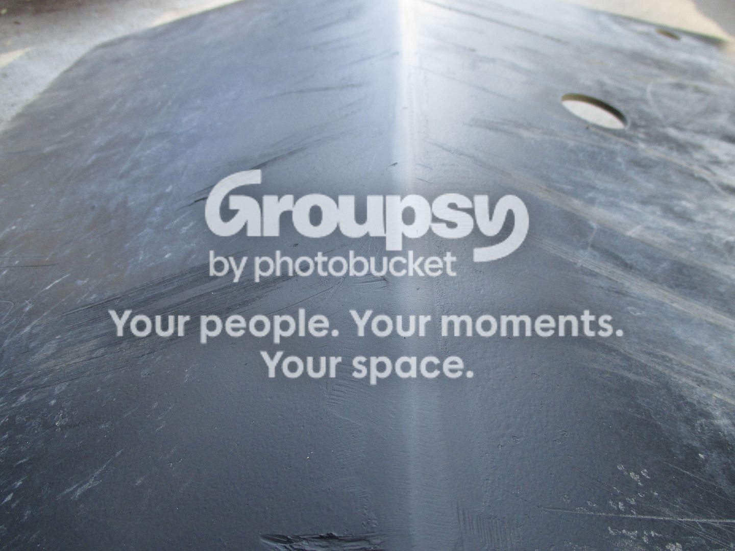

Didn't really want to work so I took care of a few odds and ends yesterday. First finding the shock clunk in previous post, then remounting the skid plate that got reworked so it would fit w/o washers or spacers.
IMG_1257.jpg~original

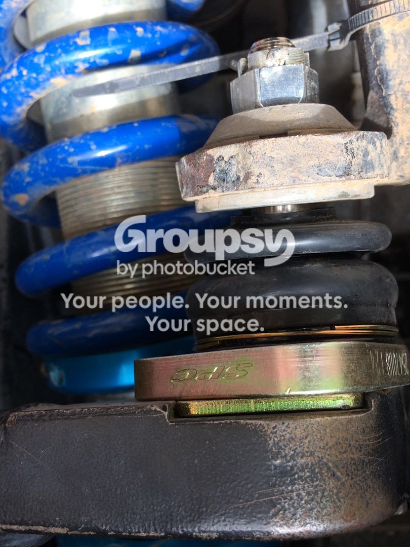

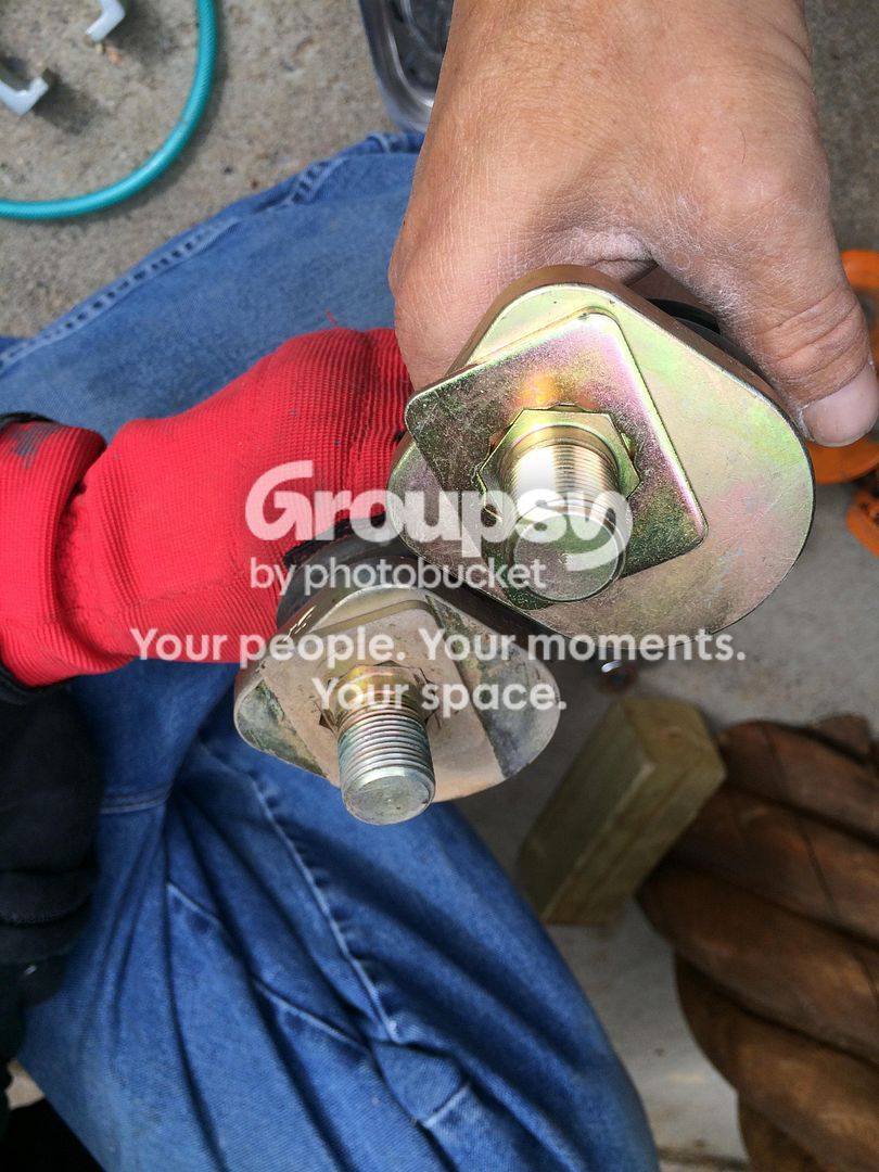

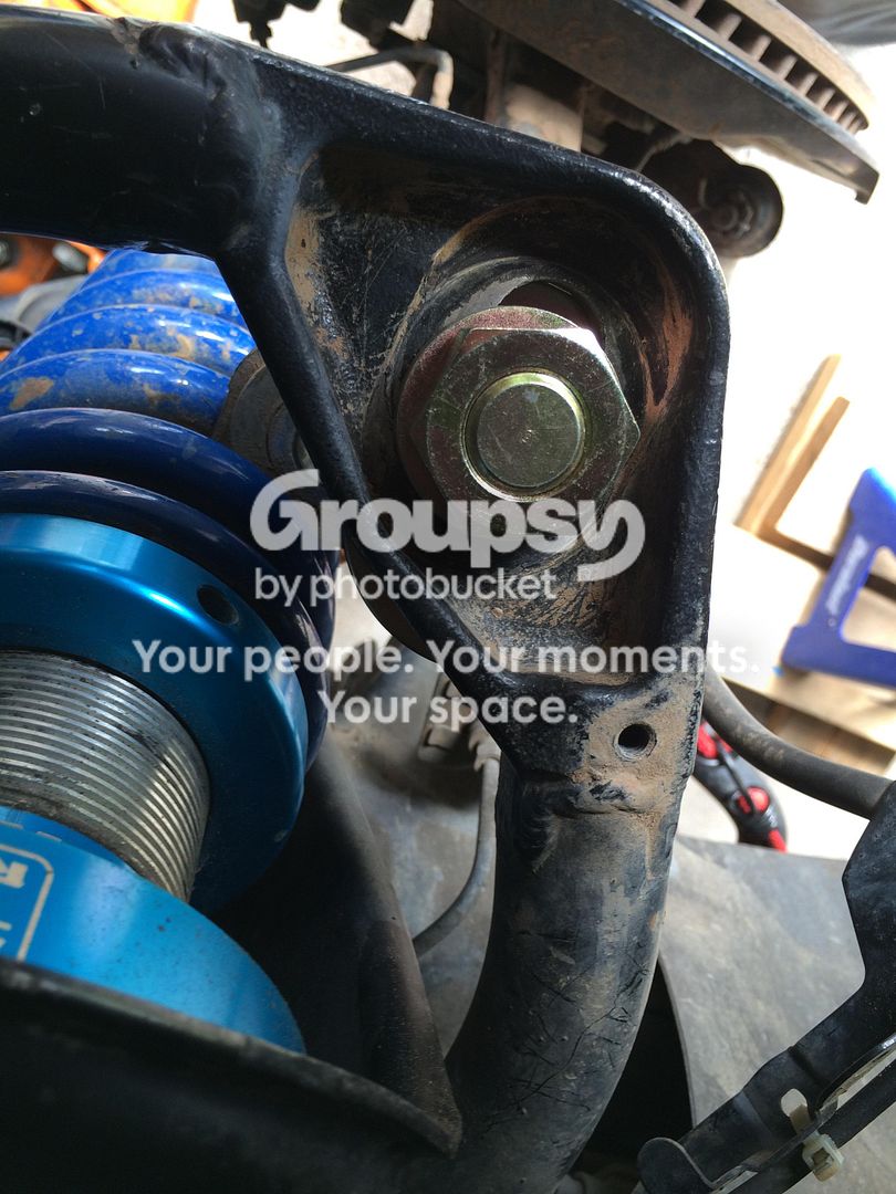

New UBJ's for the SPC's

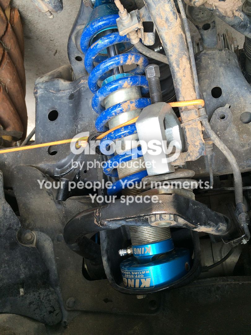

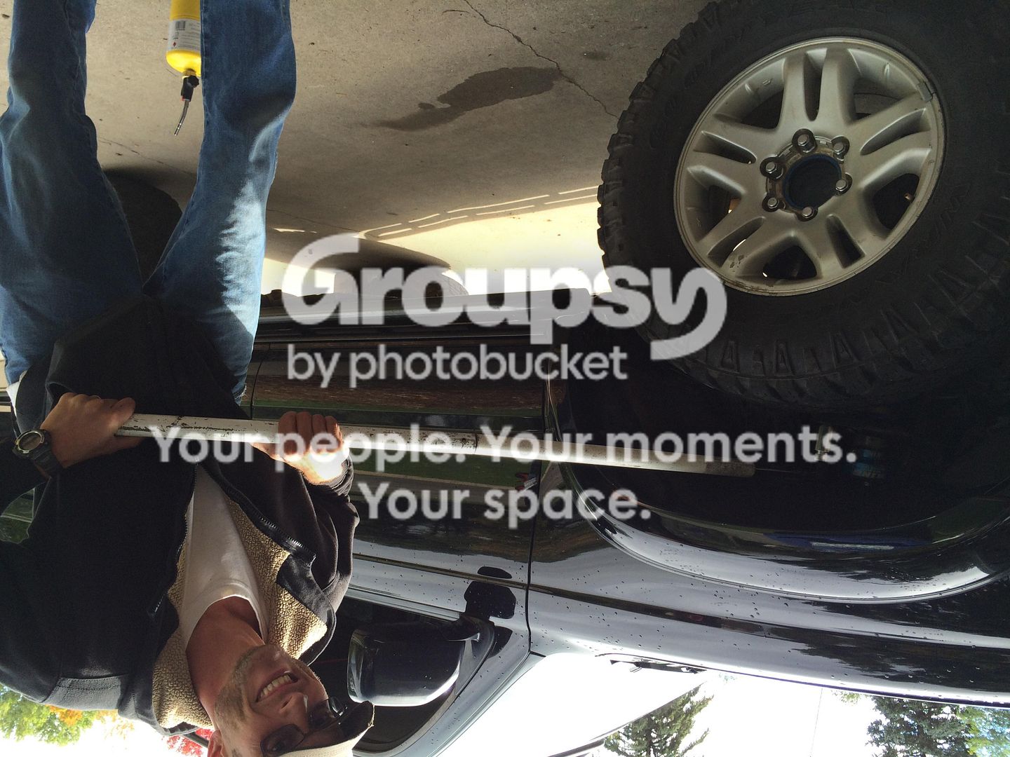

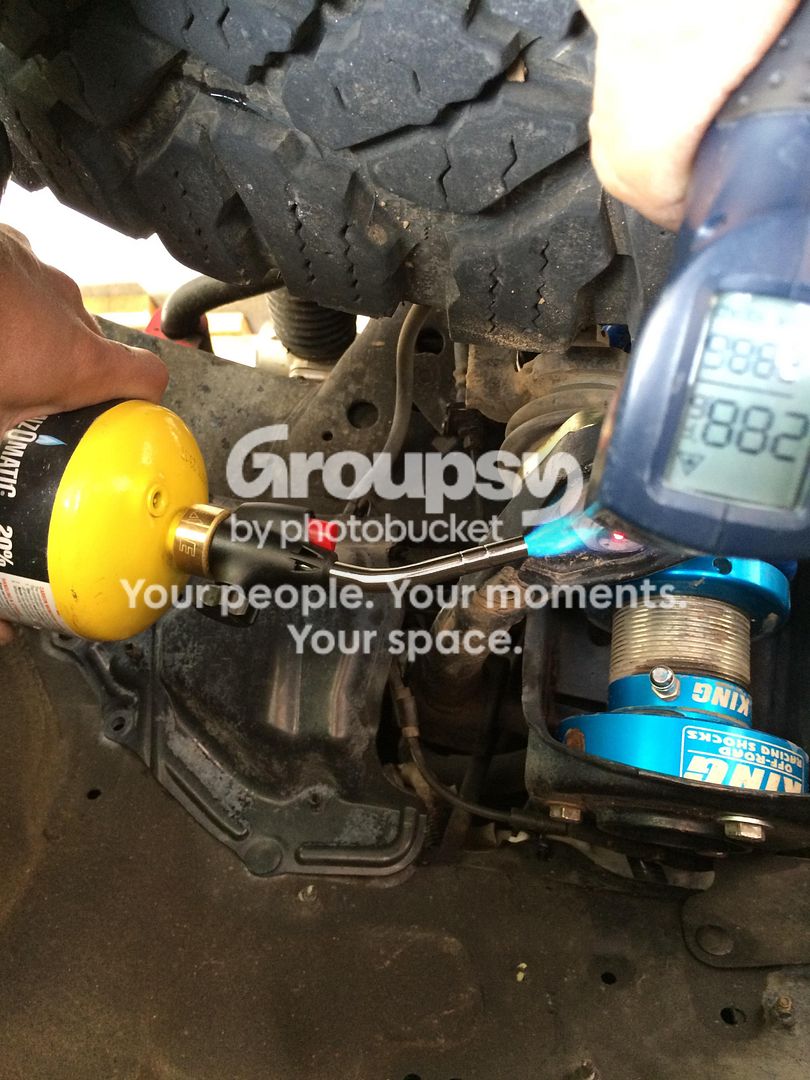

After realizing my ubj's were bad I immediately ordered replacements. I had the privilege of speaking with one of the designer/engineers prior to doing the job. No pics of new parts just got started right away. The top nut was not breaking free so I had to call a friend. We immediately snapped the breaker bar and ran for another and a propane torch.
This time we heated it up with some propane
image-75.jpg~original
then we switched to MAP
image-76.jpg~original
then put my floor jack handle over the breaker bar and both gave it hell. It turned this time
image-77.jpg~original
Then popped it out the spindle.
image-78.jpg~original
Lined up new plates the same
image-79.jpg~original
I had marked the location of the ball joint with a sharpie to help locate on install. Camber looked way off when we let it down. I pulled it back and forth and it settled out fine. I measured toe which is good but it may go in tomorrow for alignment.
image-80.jpg~original
The new ball joints don't seat as far as the others. I assumed they would go all the way to the boot but they easily torqued out before that. I was on the phone with the engineer and he stated there was no issue. At the appropriate torque the cotter pin hole
was perfectly visible.
image-81.jpg~original

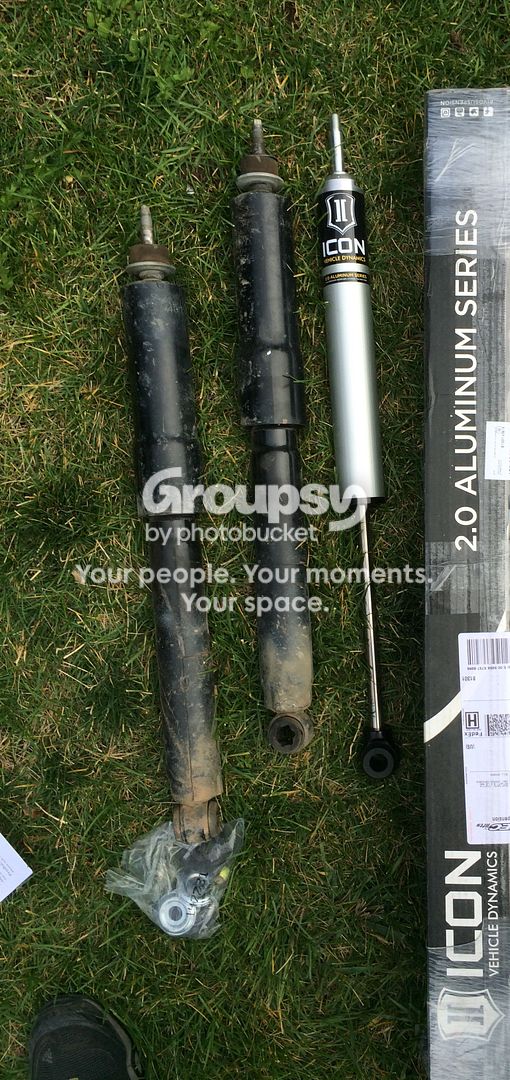

And installed new rear shocks that came with the bushings I ordered. At least that's what I told her.:nono:
image-82.jpg~original
