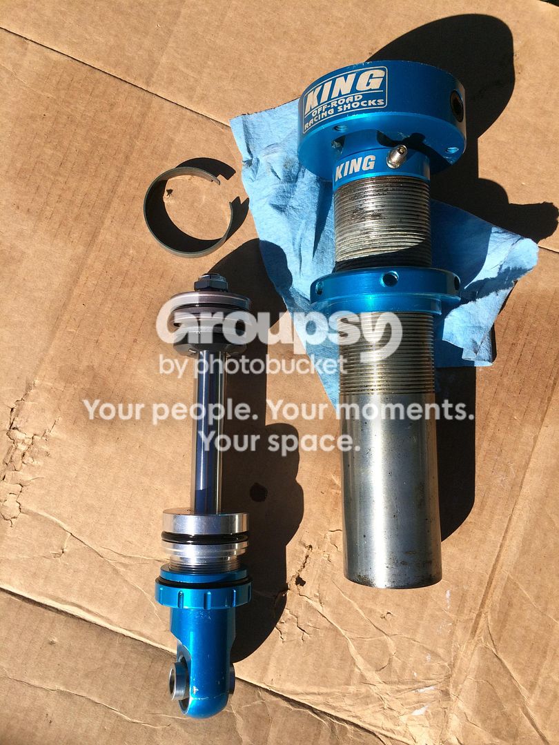

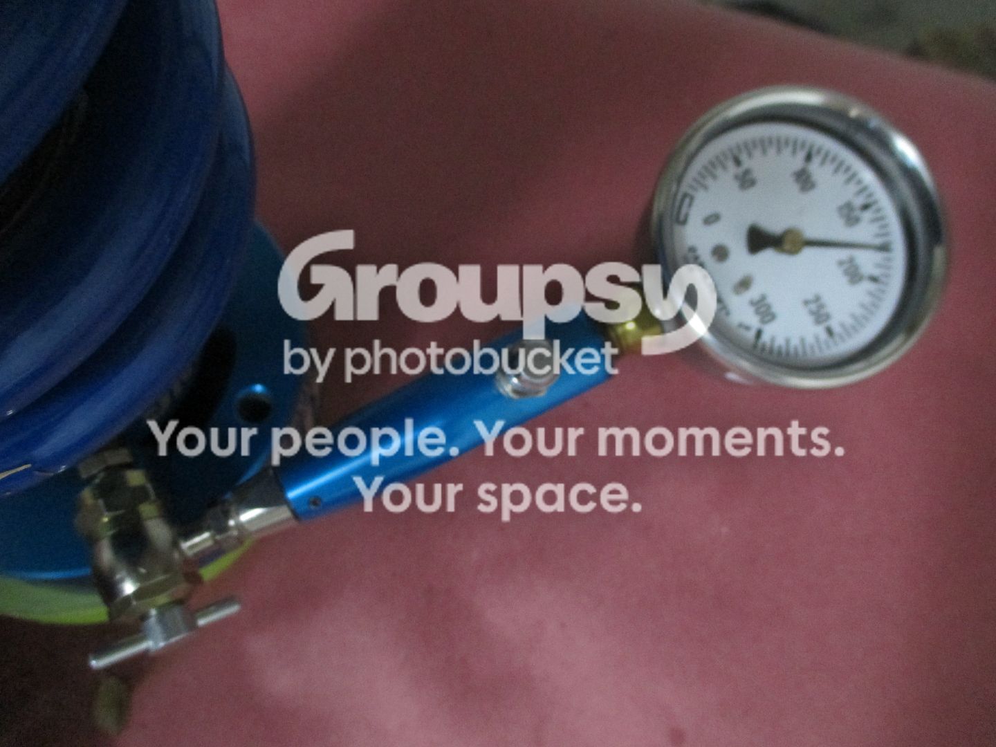

3)Rebuilt king coils with new seals, fluid and 650lb coils. The fluid was black and they didn't hold pressure at all.
4)Tightened and staked very loose ITRE
image-104.jpg~original
Charged to 175 psi. I now have them at 200 psi.

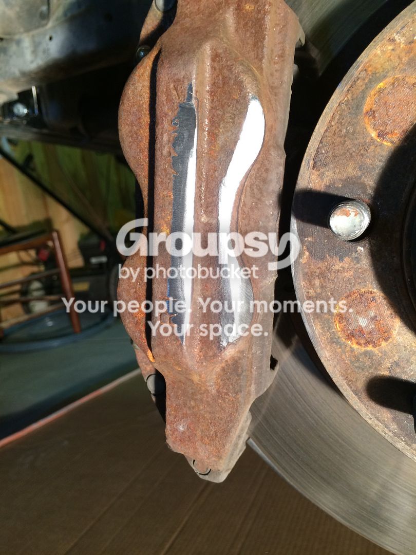

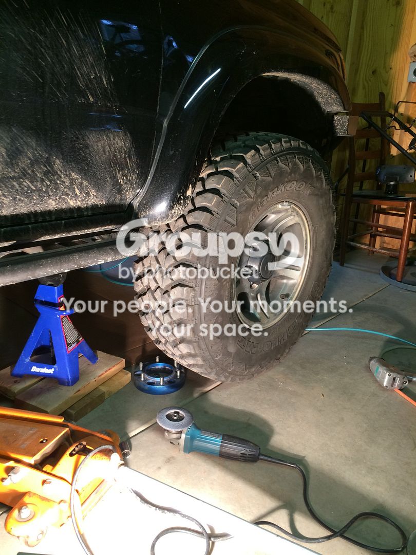

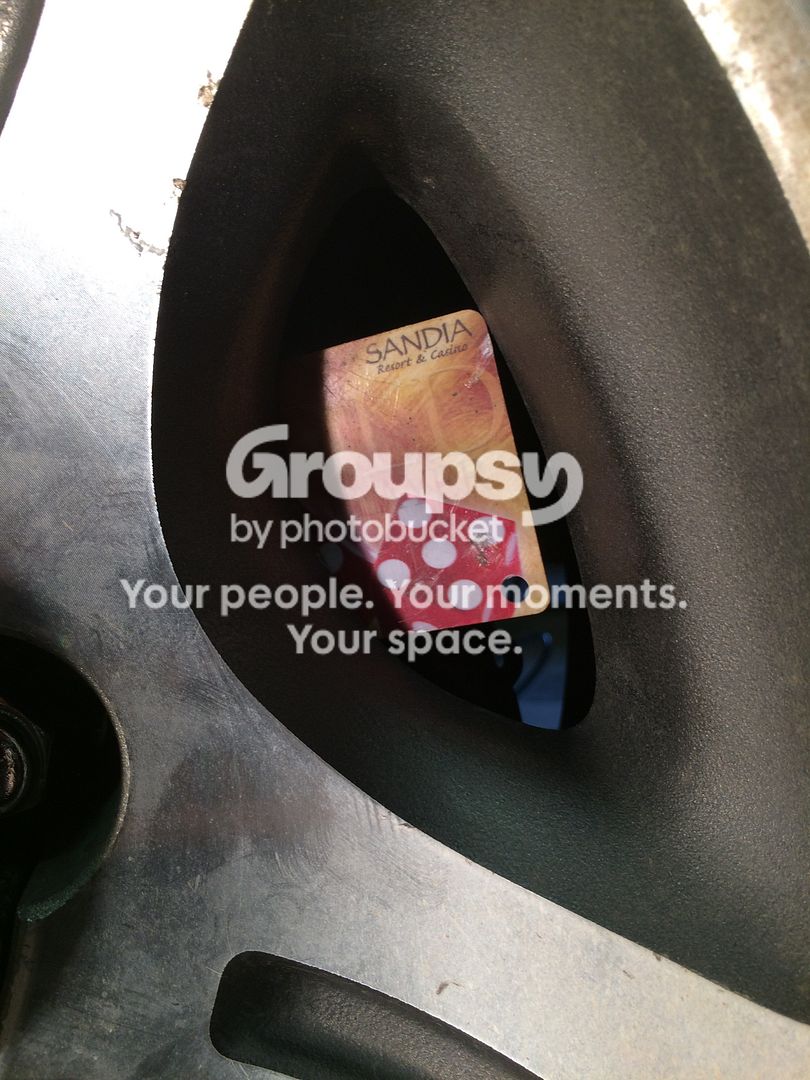

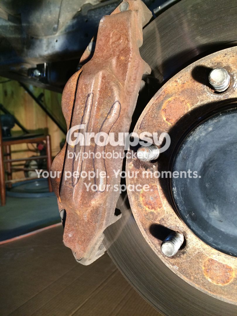

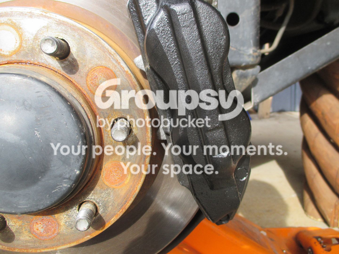

I'd been wanting to fit the LX450 w/o spacers and figured id grind the caliper. I'm using duralast calipers and I had already established that I could exchange them for new ones under warranty after the process, which I did. This is what I had to remove...
image_10.jpg~original
image_3.jpg~original
image_5.jpg~original
image_4.jpg~original
and painted
IMG_1478.jpg~original

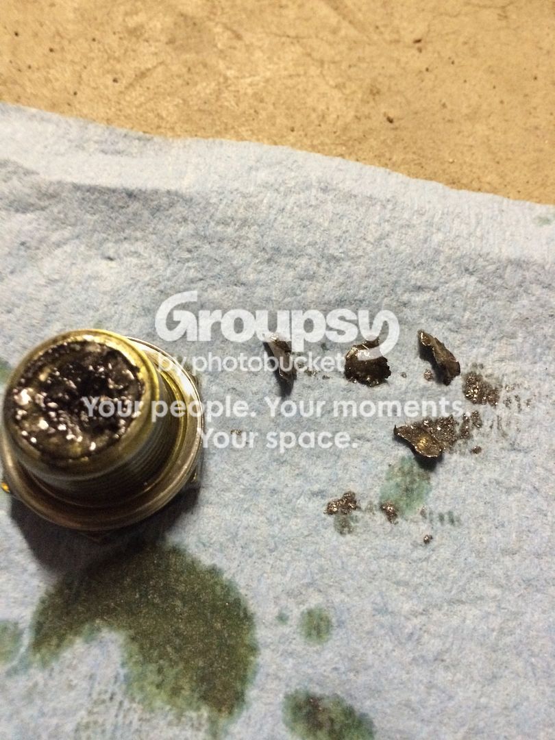

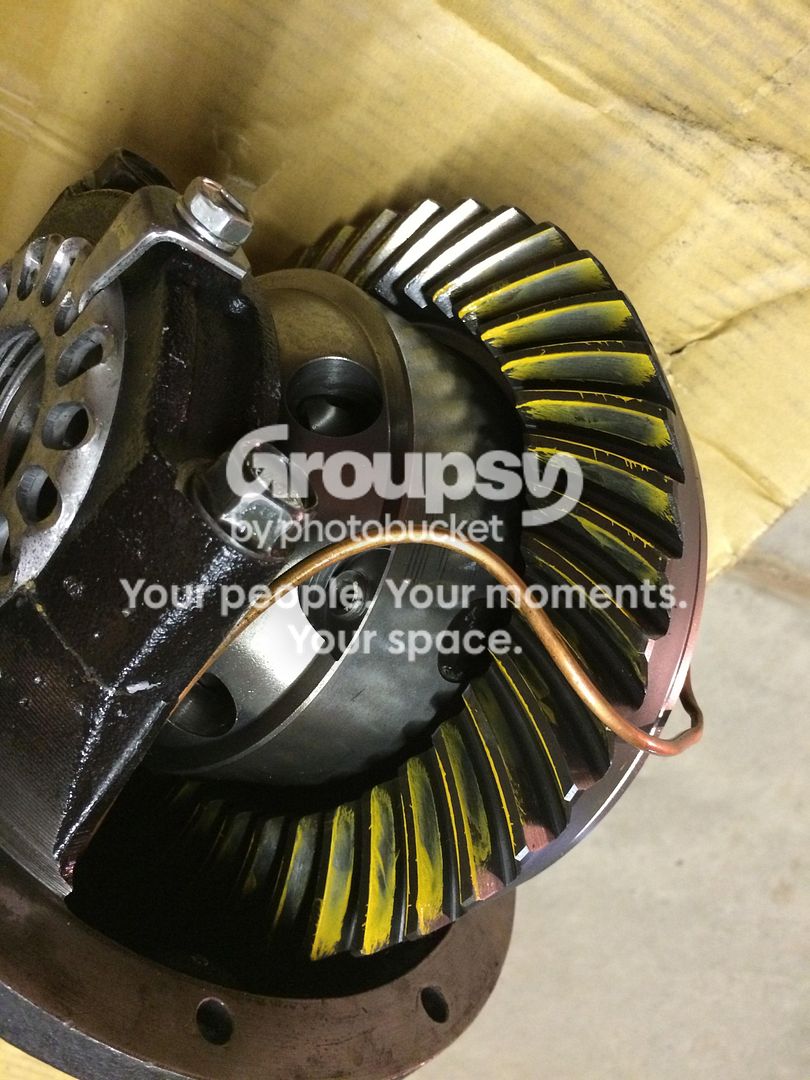

I decided to drain the rear diff and OMG not again!!
image_6.jpg~original
