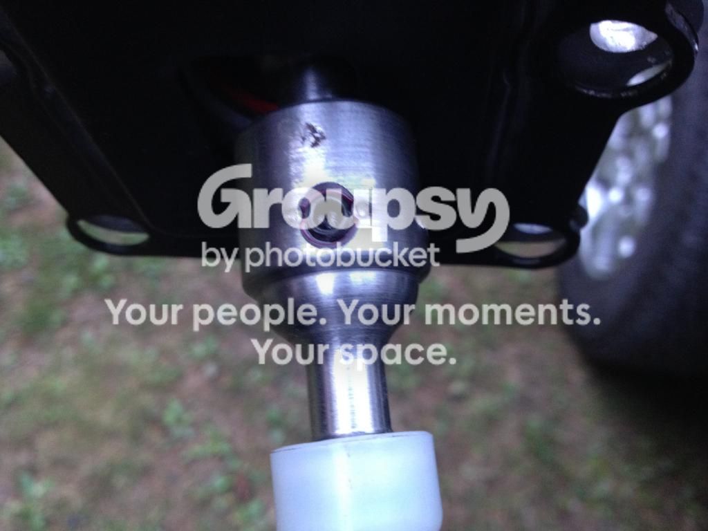

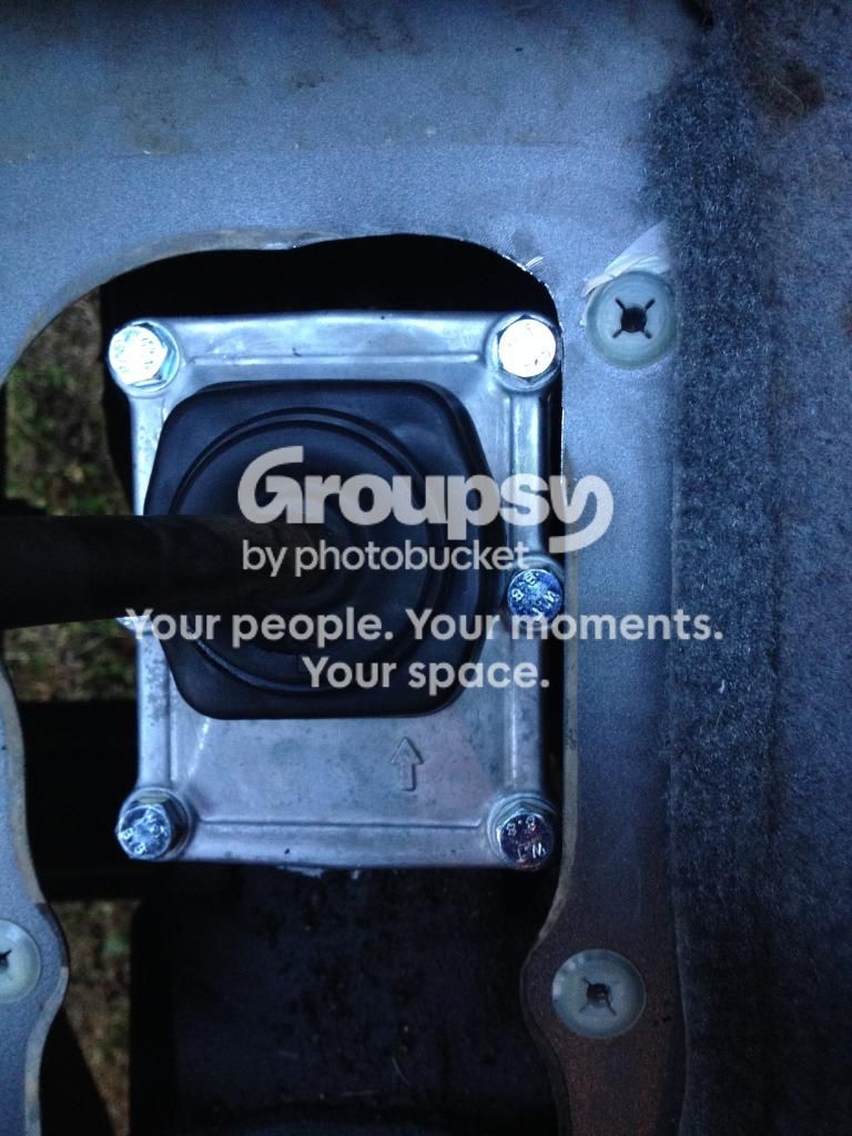

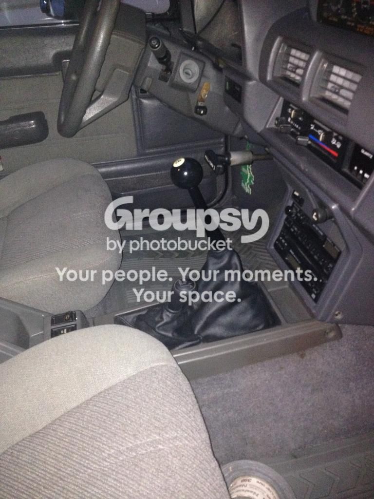

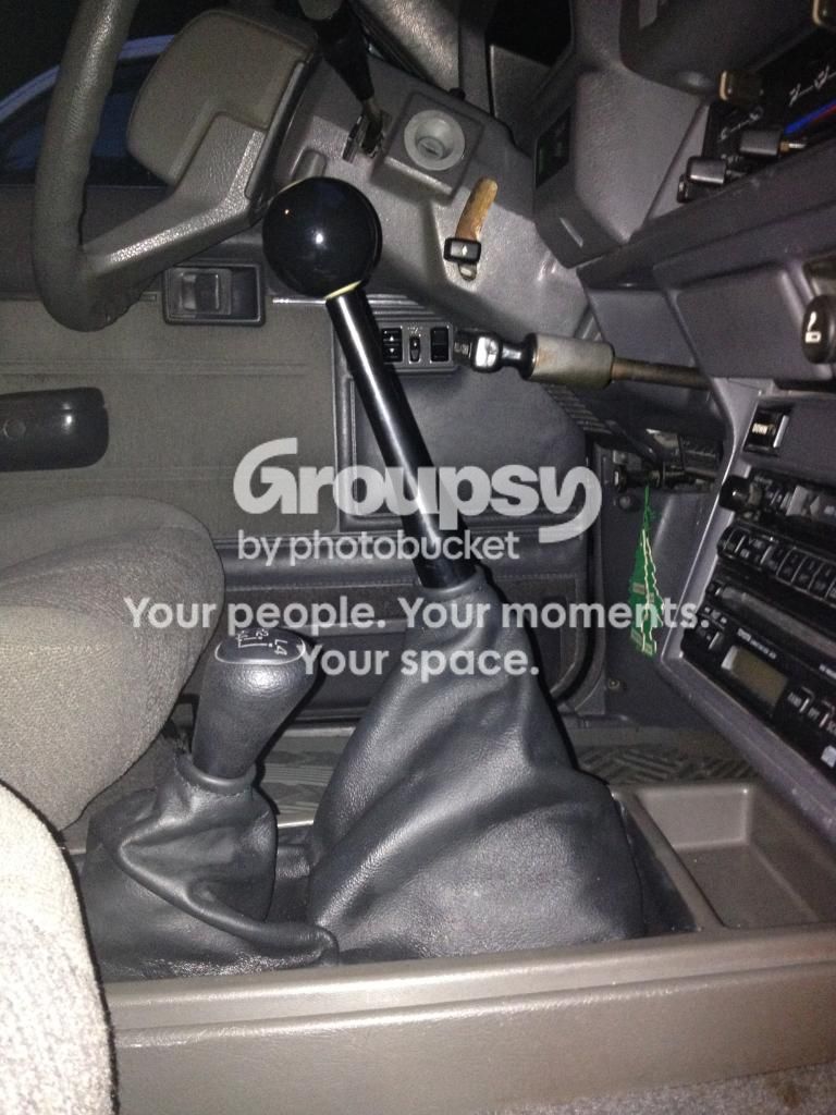

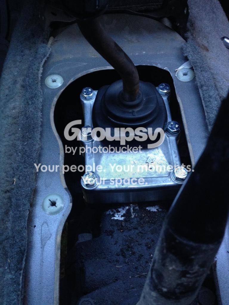

I installed the short shifter kit from LC tonight, was not a good thing to do while having an absent minded day. After taking everything apart and cleaning the top plate and all the broken plastic pieces of the old bushing out, I put the kit in and buttoned everything up. I was all happy with myself having finished the install in about an hour, only to look down and see the top plate gasket sitting on the passenger floor mat. I took it all apart again and put the gasket it, was almost ready to set the console back on and realized I failed to peen the set screws on the ball extension. So it all came apart then back together again. I had to trim a little bit to get to the corner bolt and because I don't have a body lift, the shifter is now 1" higher than before. I drove around the block and was amazed at the shift improvement! I'm sure a big part of that was the new bushings, but I'm very happy with the shorter shift throw too, much more positive feel. I might heat and bend the shift handle back a couple inches, but the added length actually works better for me with my seating position. For $125, this was well worth it.
Seems like doing a job on the 4runner more than once is my M.O.

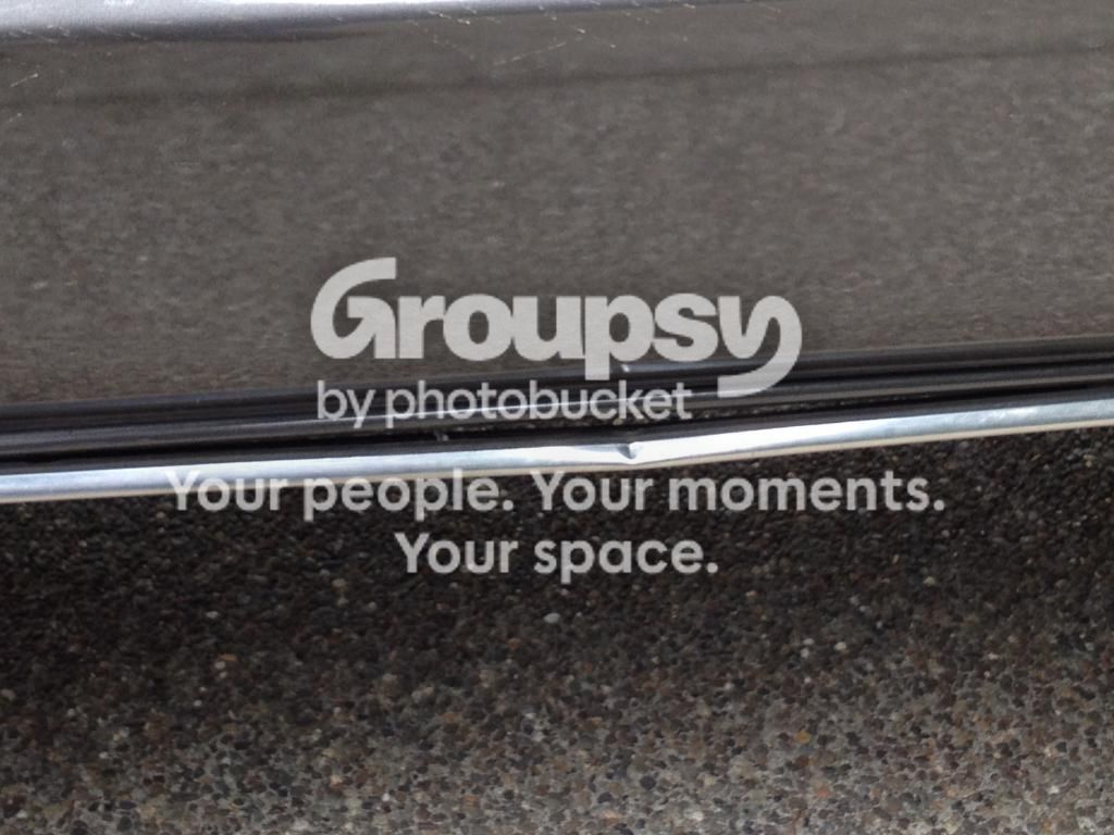

Of course, as my luck goes, the day wasn't without carnage. Some how I managed to step out of the truck and catch the rocker molding on my shoe lace. It broke a clip and bent the F out of it! I still don't get how it happened really, but now I need to find another one.
This is after I bent it back the best I could, damnit!
