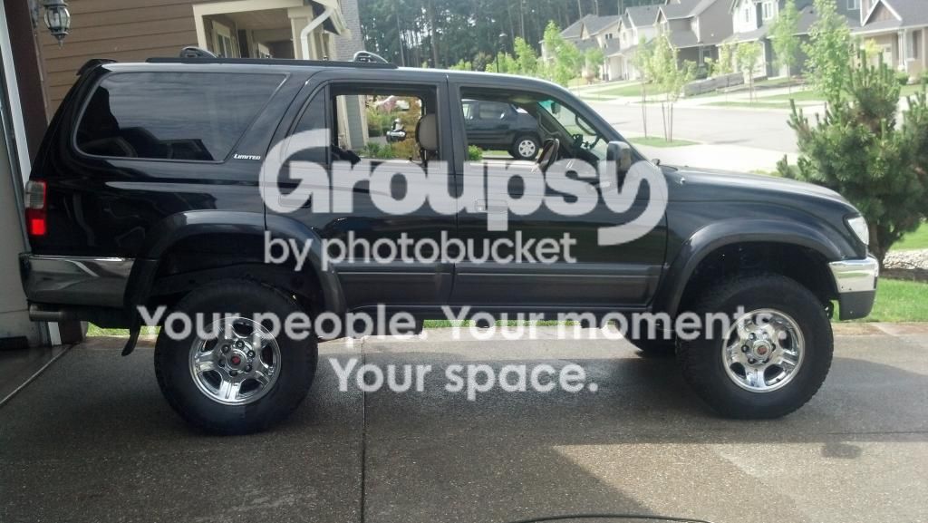

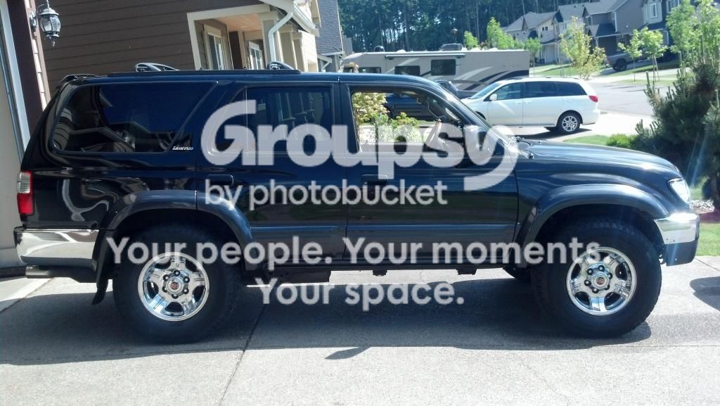

My 98 Limited

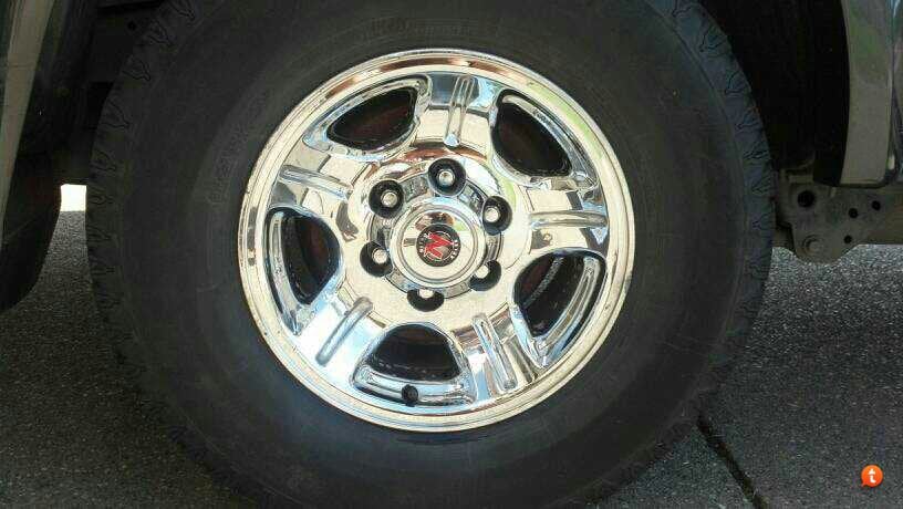

This is the rear rim. The rears were in good Shape, but the fronts had some bad pitting. When I do the lift I plan on power coating the 5 rims before the bigger tires go on.

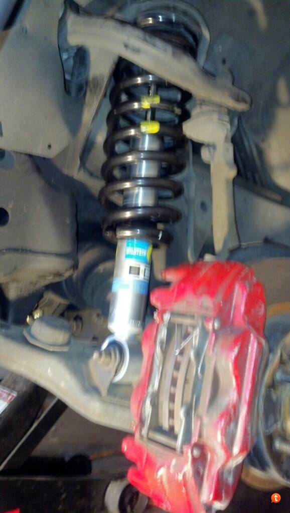

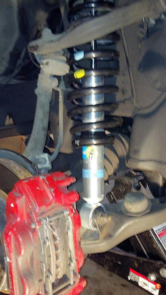

Here's the measurements from the center of hub to bottom of flares
LF 21 5/8
RF 21 3/4
LR 24 5/8
RR 24 3/4

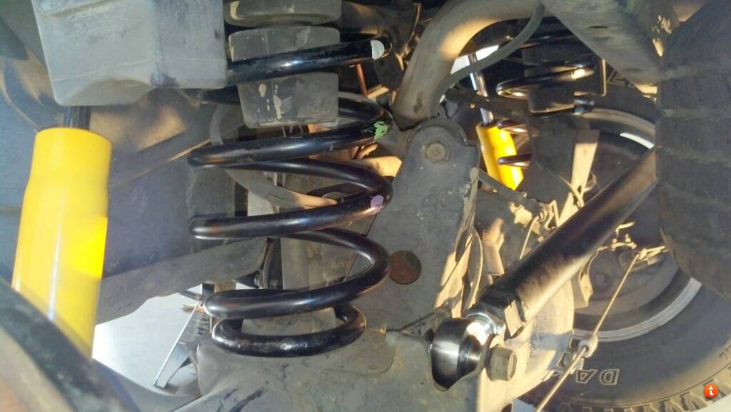

Front is set on the second notch from bottom. I set it that way because I'm not running a winch/bumper yet. When I do, I will be moving the notch 1 up when installing a winch bumper.
BEFORE
AFTER

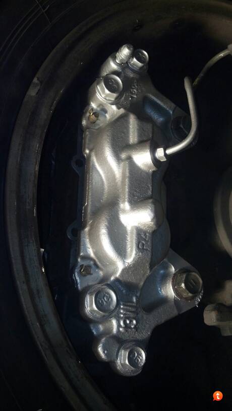

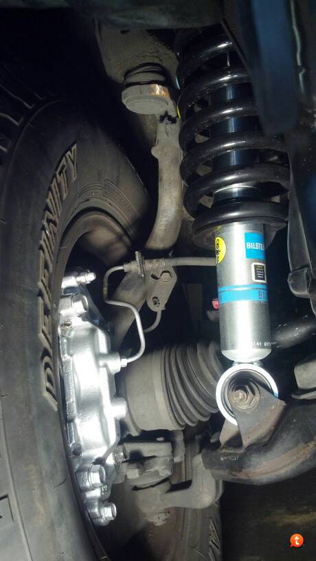

I just painted my calipers from red to silver. Matches the front 5100 Billies up front better. When removing the calipers, I noticed that my boots L/R are leaking from the upper shaft side of both Axles. Going to the store to buy some clamps to fix the problem.

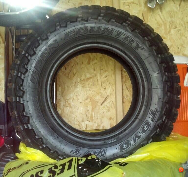

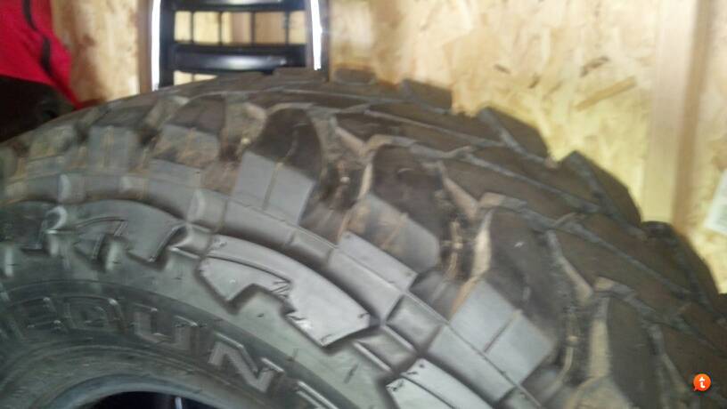

Traded my Daystar 3" lift front/rear for these 4 TOYO M/T 265/75R16s with half tread. Want to swap the A/Ts for the M/Ts, but I'll just wait till they go bald

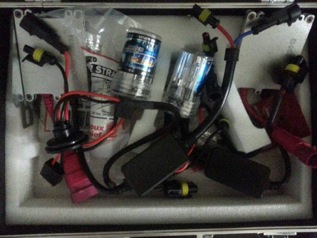

My cousin called me yesterday and asked me of I wanted a set of HIDs! I said yes of course. I installed it last night and what a difference. The brand is KENSUN. You don't even need a relay with this one. I'm carrying my stock PIAA bulbs just in case my HID bulb burns out
I'll get some night shots later.

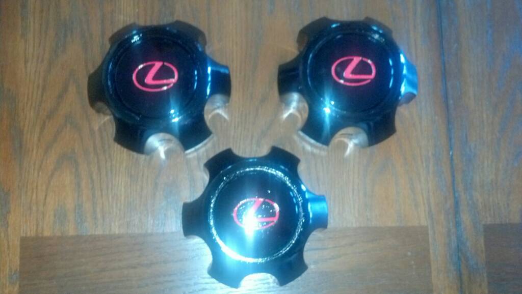

My 3 Lexus hub caps came in on the 10th and I just finished painting them last night. Now I just need to buy a #4 cap to complete the set.

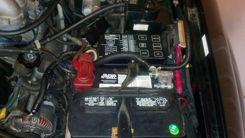

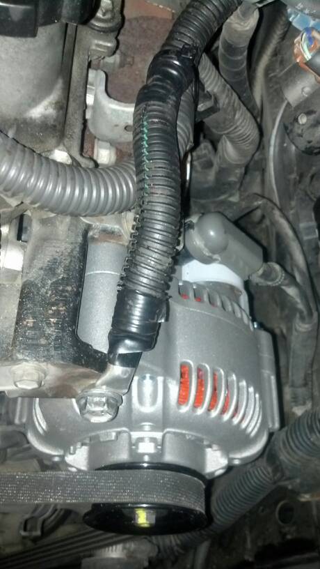

So my alt died this past Sat after wheeling in the WA mountain. I decided to do the Big 3 mod while in there. I have everything except the 120 amp breaker. So I installed the new alt and did the #6 and #7 wires upgrade. Tomorrow I'm running to Blue Seas and buying me that last part to complete my mod.
I used 2ga for the #6 & #7 wires.
I will be using 4ga on the #8 wire.

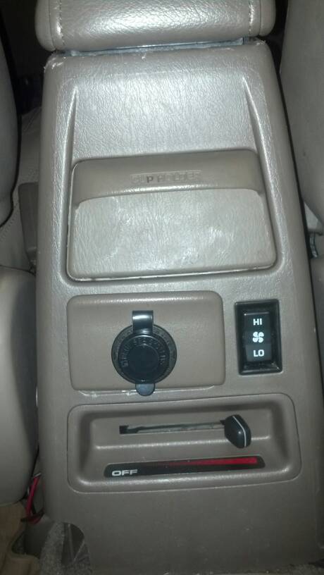

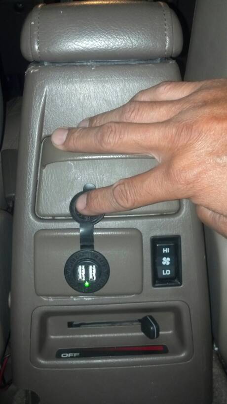

On Monday I installed another Blue Seas dual USB charger in the 2nd row ash tray. Nobody smokes, so I put it there. Now I have 1 USB charger in the front and 1 in the back.
Wanna say Mahalos to [MENTION=44220]BigFishAllDay[/MENTION] and [MENTION=65101]BrianSD_42[/MENTION] for the contribution for the Big 3 mod.
