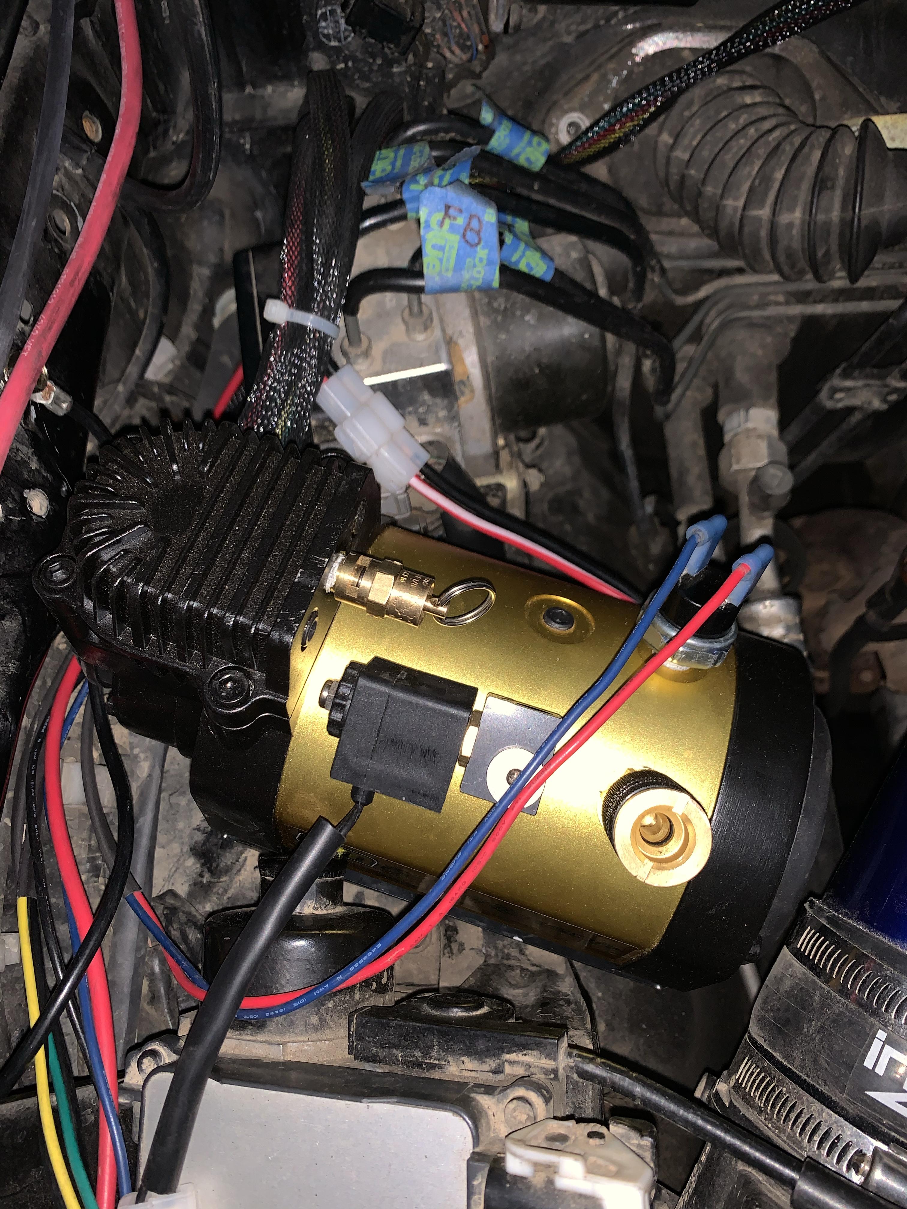

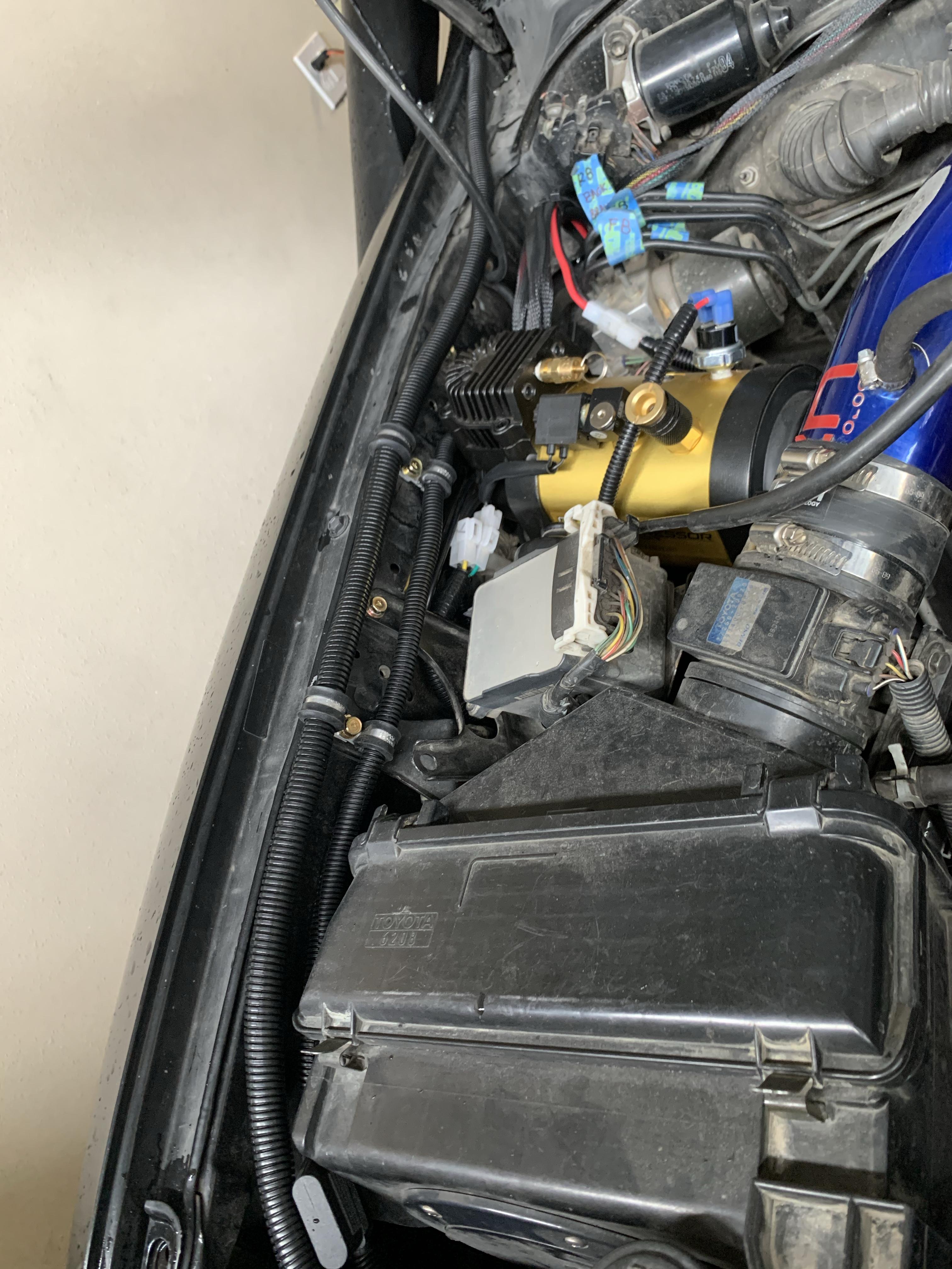

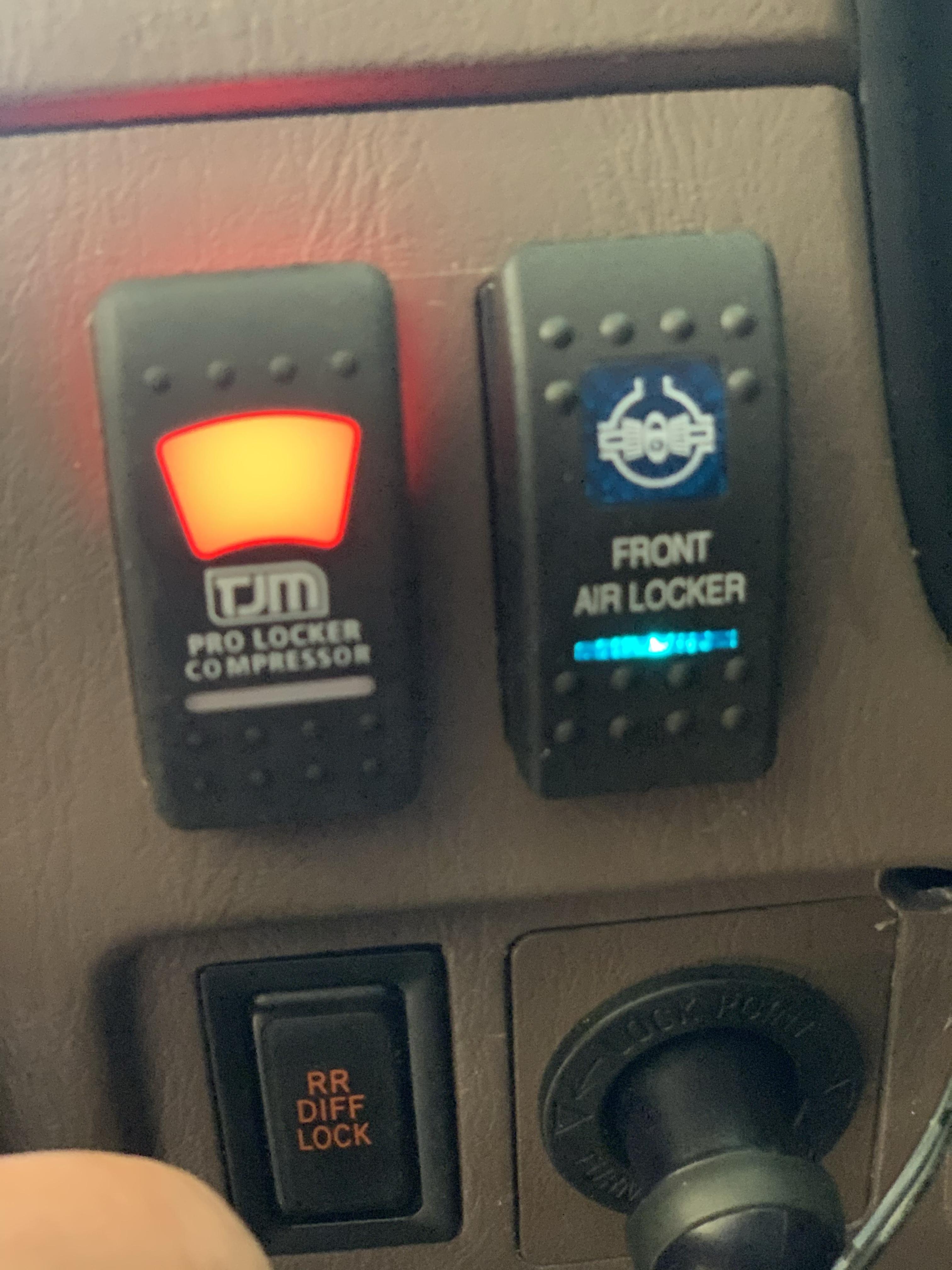

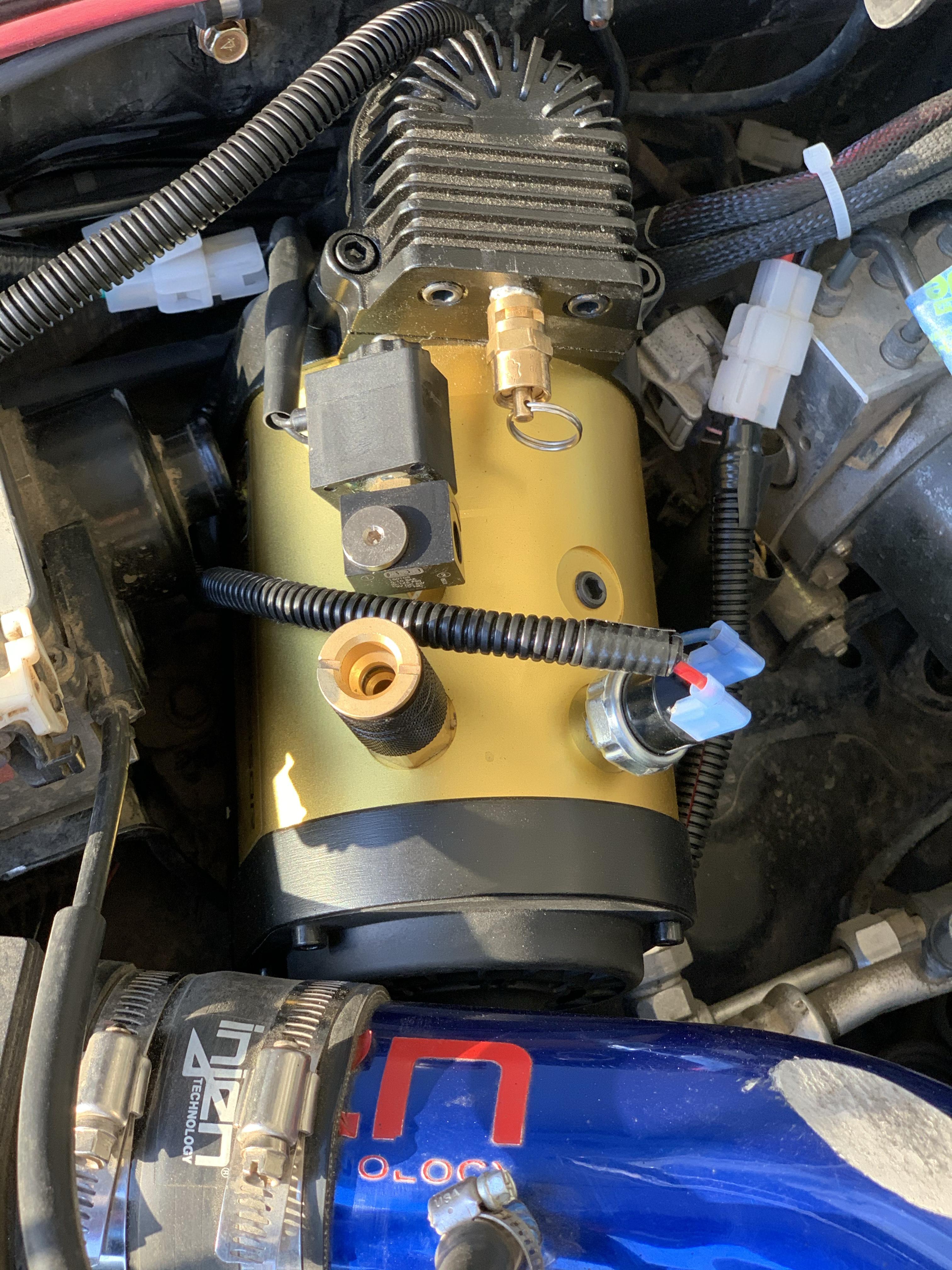

I wired in my TJM HD compressor and ARB front locker switch. Hardest part was to find a place to secure it in the engine bay. I move the cruise control thing down three inches too fit the compressor in.
This is how it looked when all the wires were not in order.

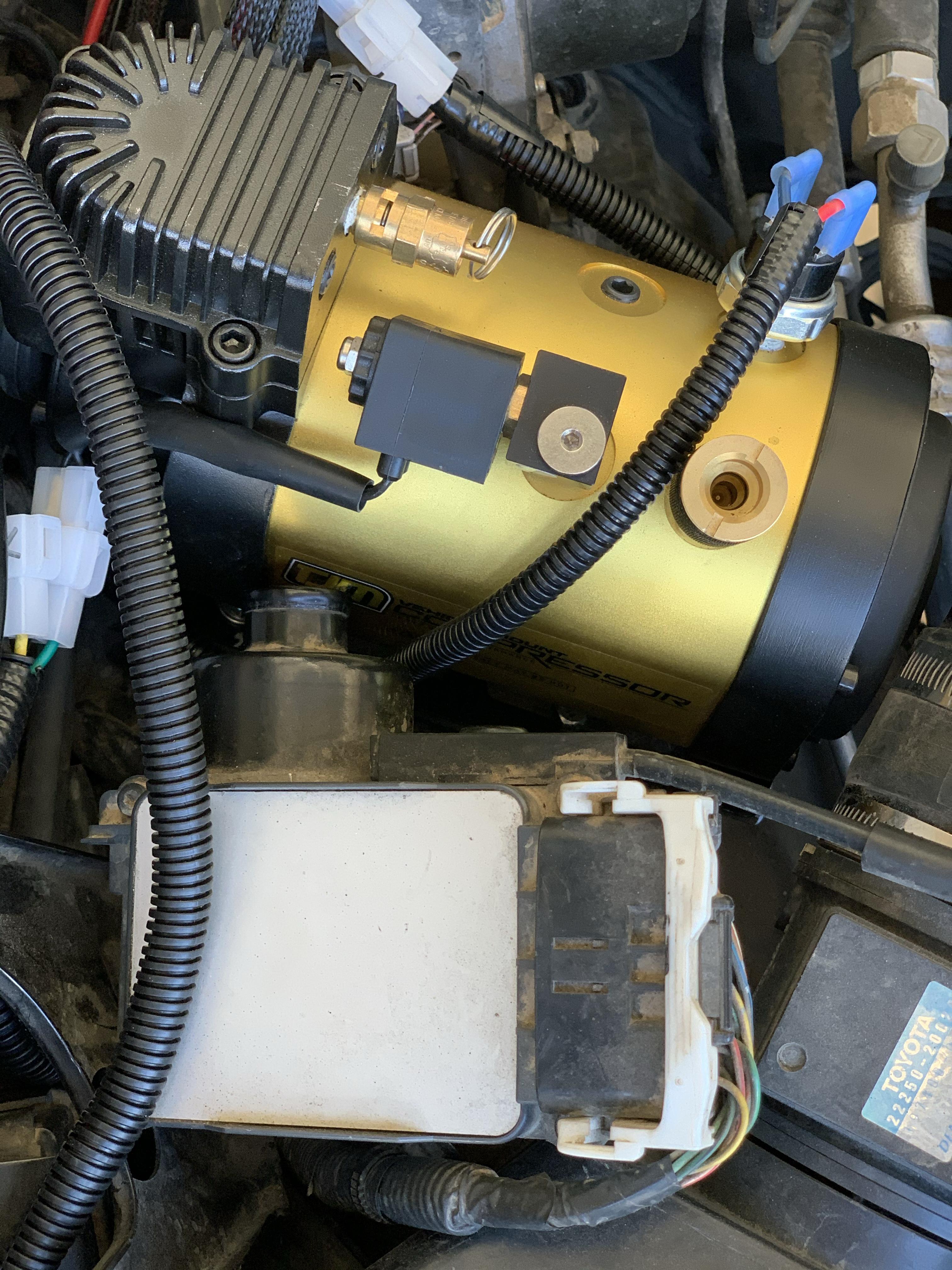

This is how it looks after making the wires pretty and covered with wire loom
Looking good.!Can't wait to see the dual case install. Chee! I installed my compressor in the same spot and ended up making everything fit...but not great. Igniter mount only secured with 1 bolt. Arb compressor secured with 3 bolts, and a ghetto rigged stabilizer arm to help keep cruise control in place. Idk if it'll work with the TJM compressor but I just installed Yota 1 prototype mount for this situation and it's a way cleaner setup. They are close to production I believe...maybe worth looking into if you want to clean it up a bit more. Text me if you like pics...
What is this mount you speak of? The compressor is mounted with 3 bolts. I used a 1/4”aluminum plate that I had from the shop and cut it the same size as the stock bracket that came with the compressor. Put 1/2” spacers toward the fender and 3/4” spacer towards the engine. My cruise control thingy is held with two bolts and not three.

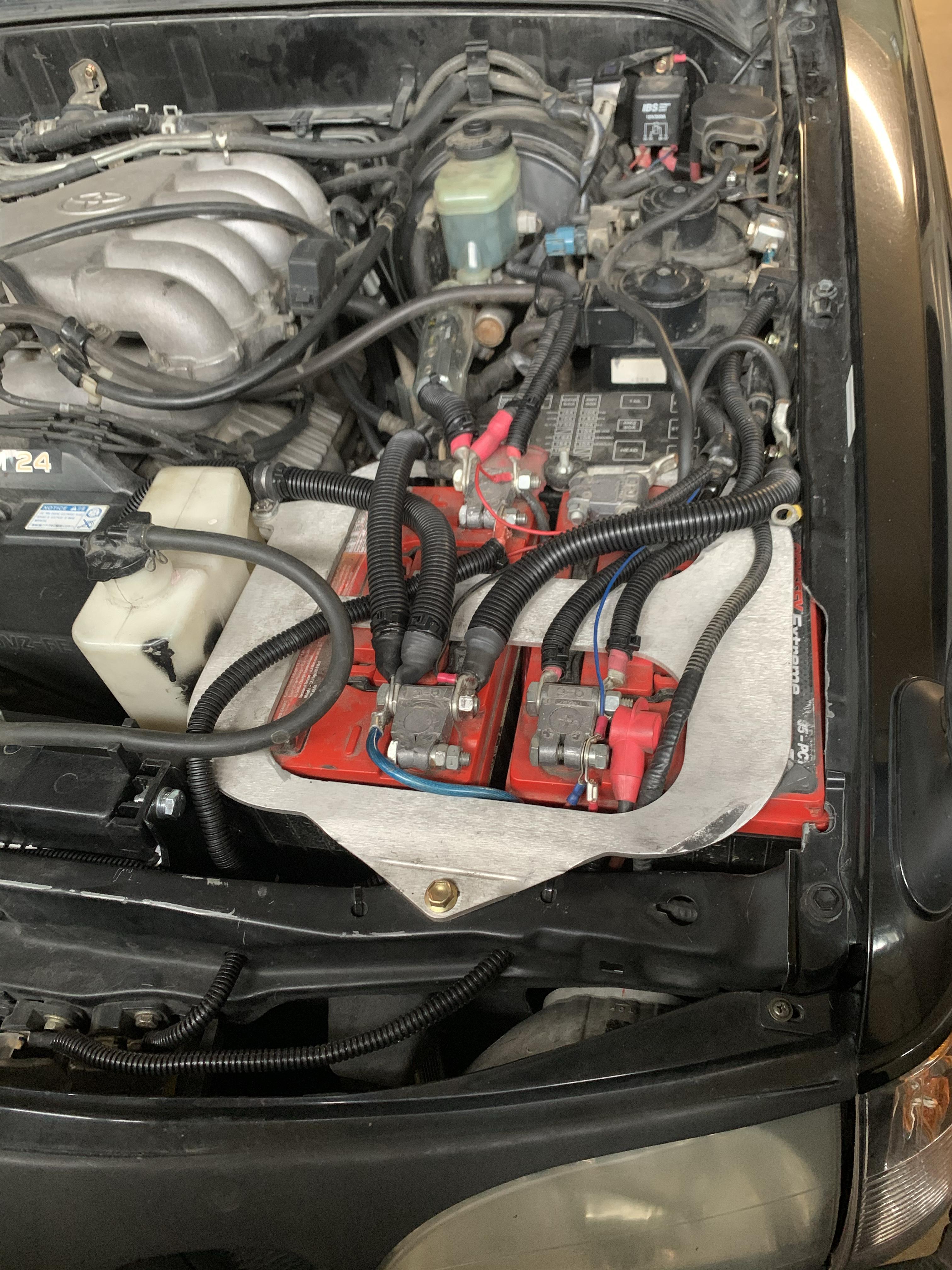

I cleaned up the wiring under my hood on the passenger side and did some on the drivers side until I ran out of loom

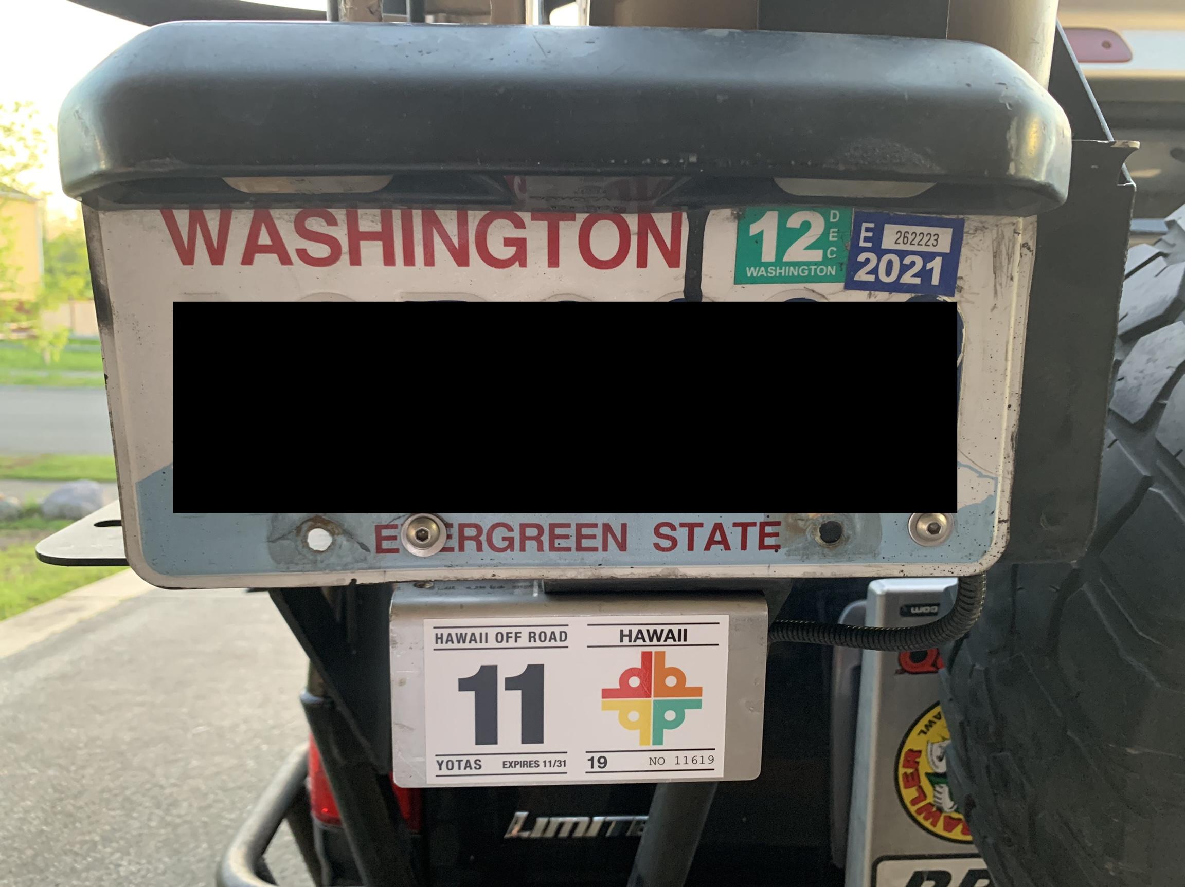

Yup it is! Funny, back in the islands I hated those stickers. And when station that puts it on runs the razor it used to anger me cause the tech slices that thin plastic sticker down to the bumper.
Now that I am here, far away, I smile when I come across 808 transplants here. And see those safety check stickers on the rear bumper.
Ha you got the special one too. Never saw those multi colored ones.
It’s not the real thing, but a duplicate copy of the brand that makes it. Hawaii Safety Check Sticker
– Hawaii Off Road Yotas

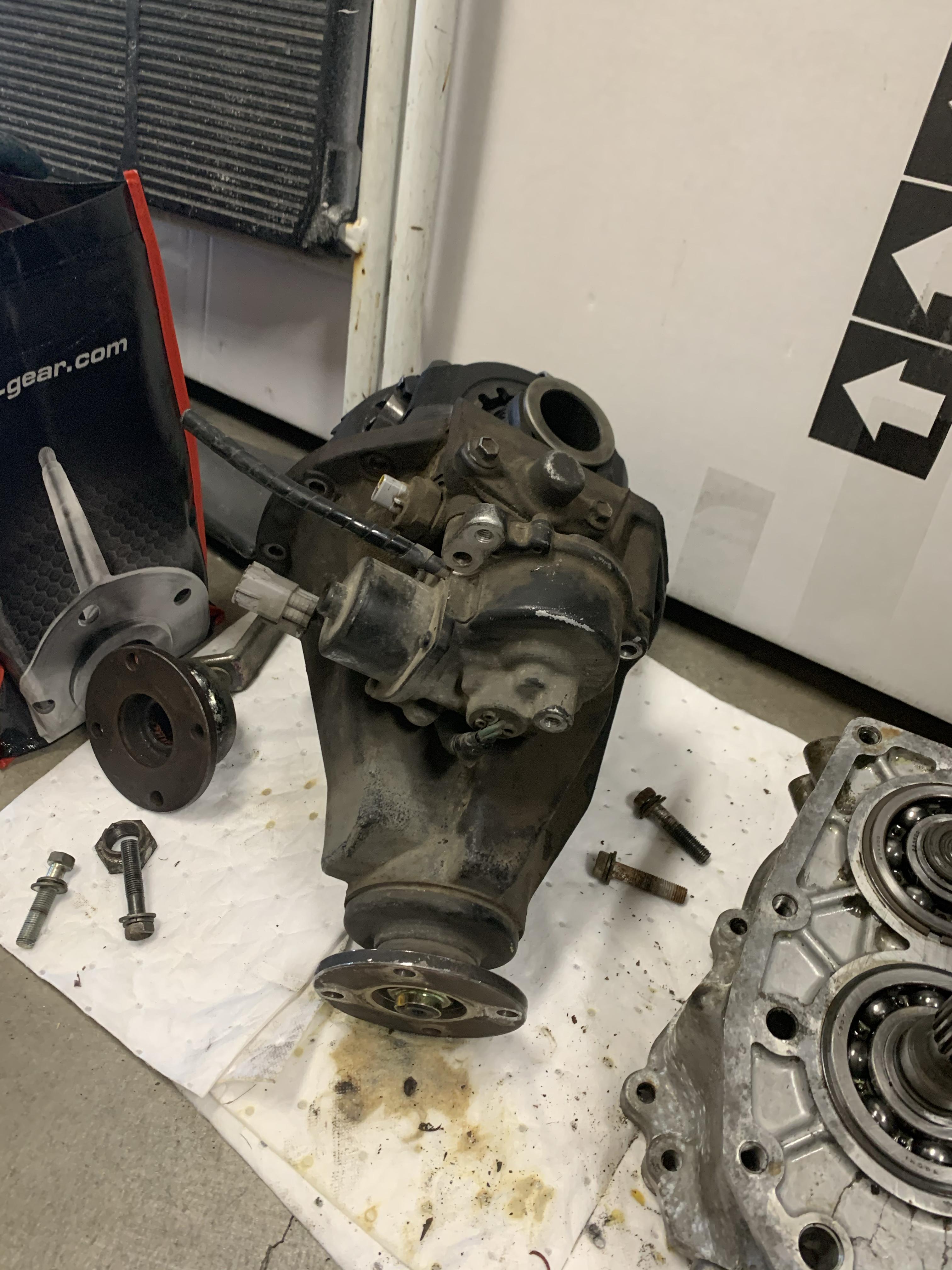

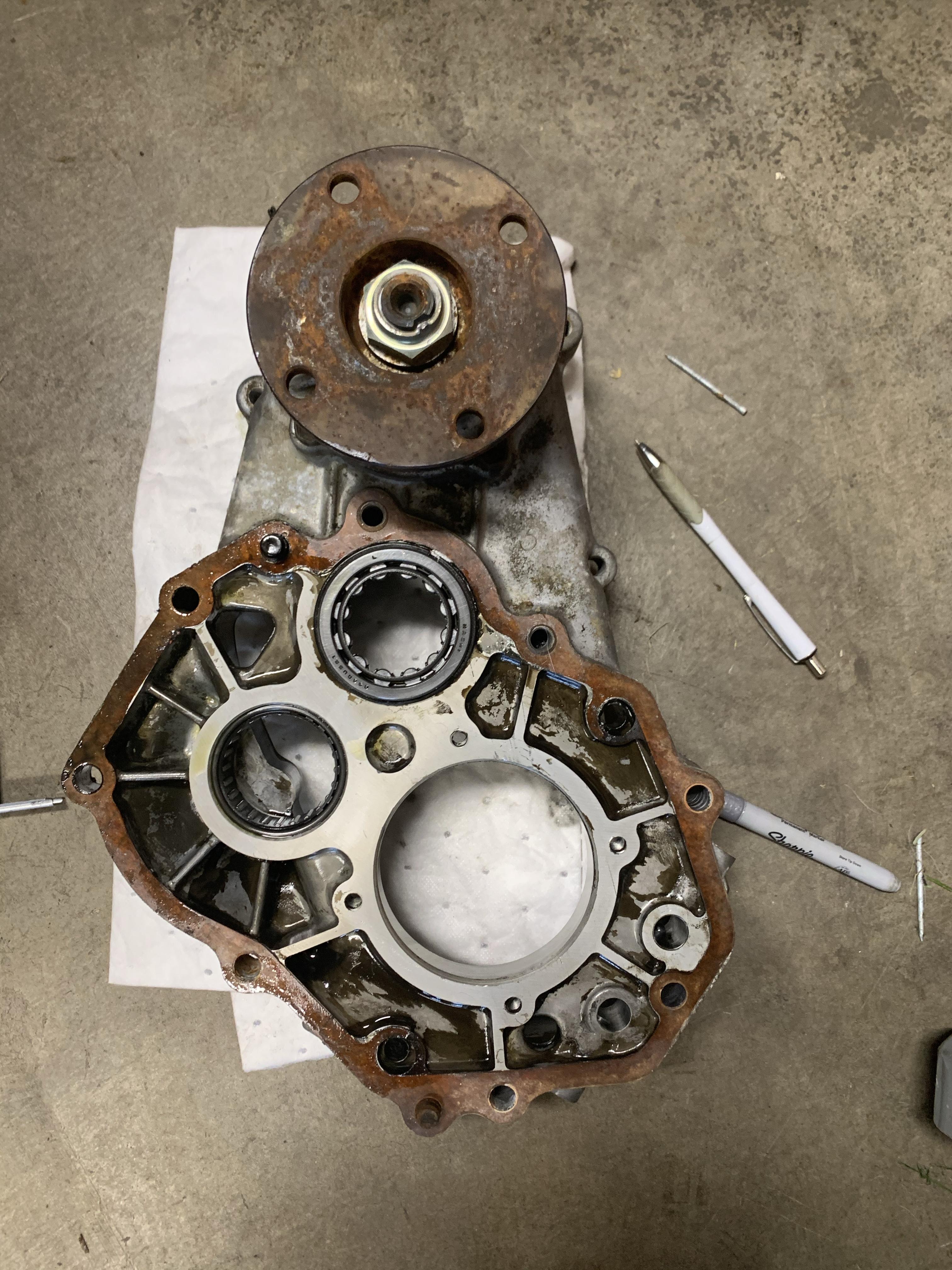

I also bought a elocked 3rd member with 4.30 gears yesterday, so I can do the gears and swap everything while the truck is down.

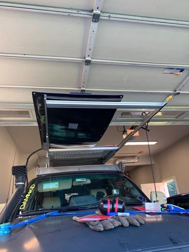

Extruded Aluminum on my rail slides for my solar panels. Not done yet, but you get the idea.
