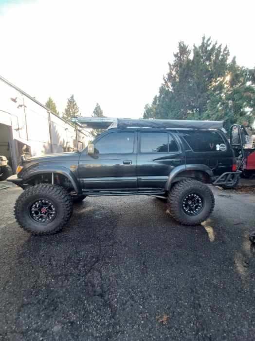

My 98 Limited

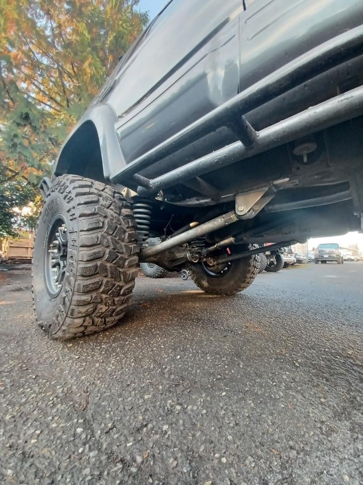

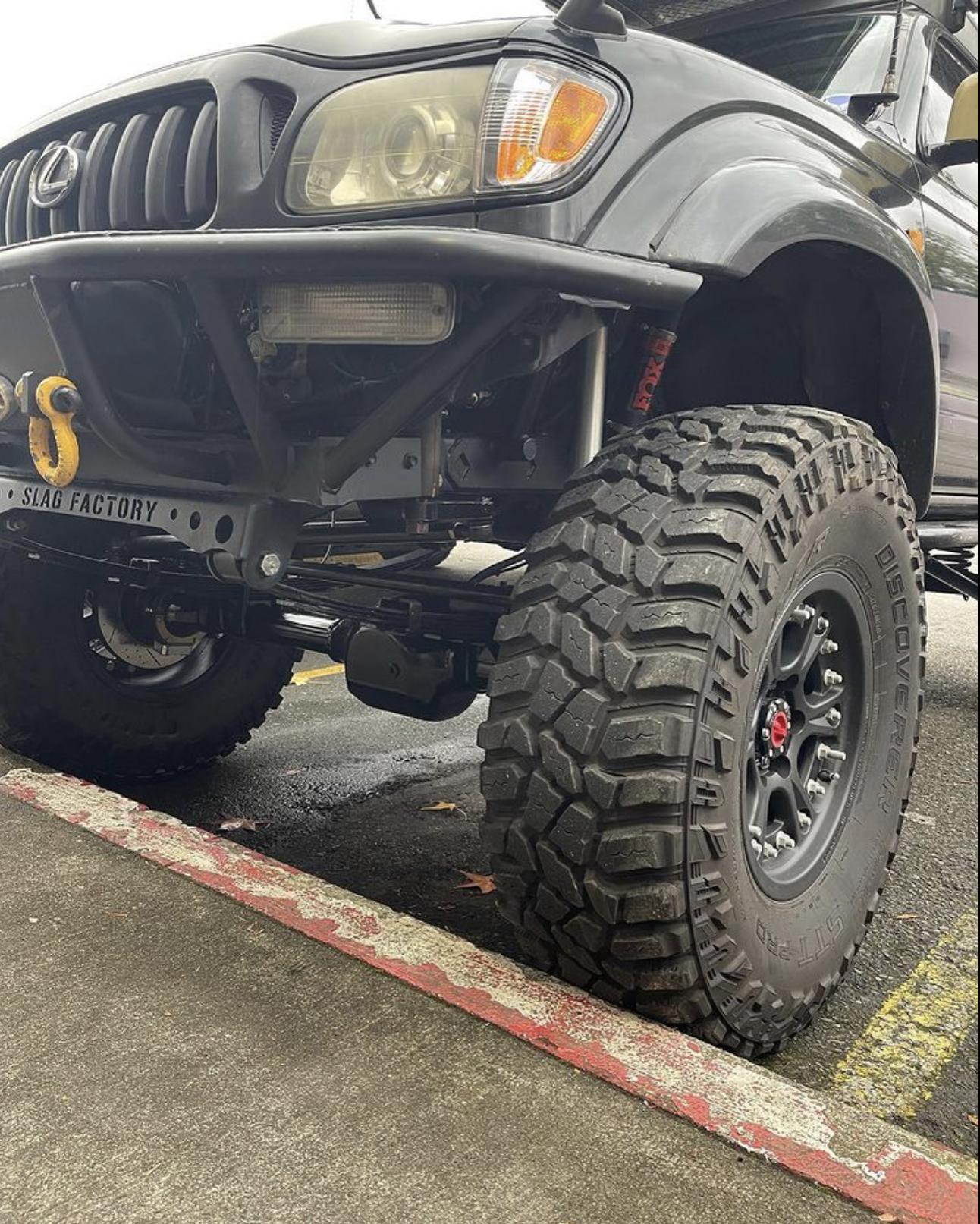

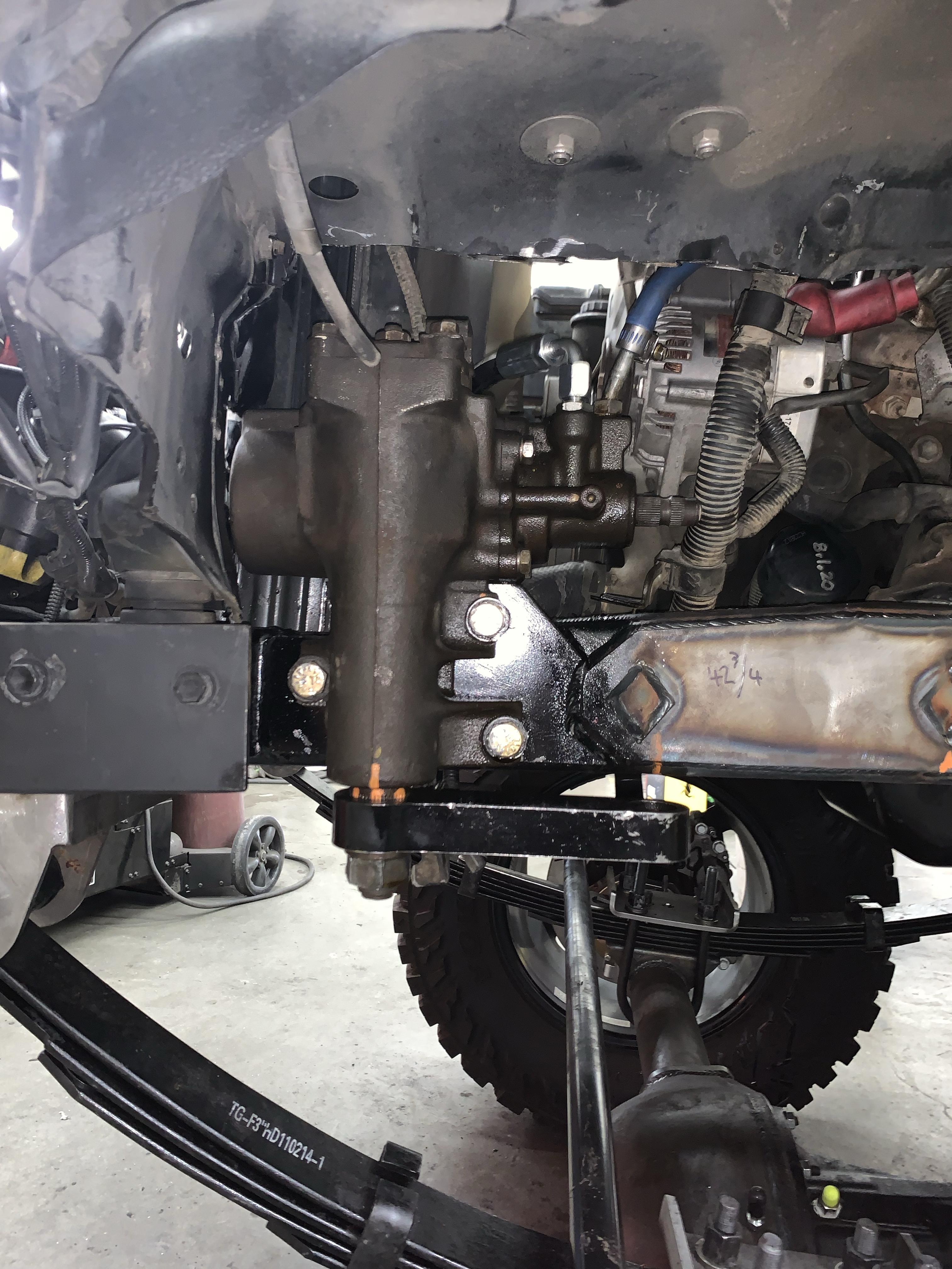

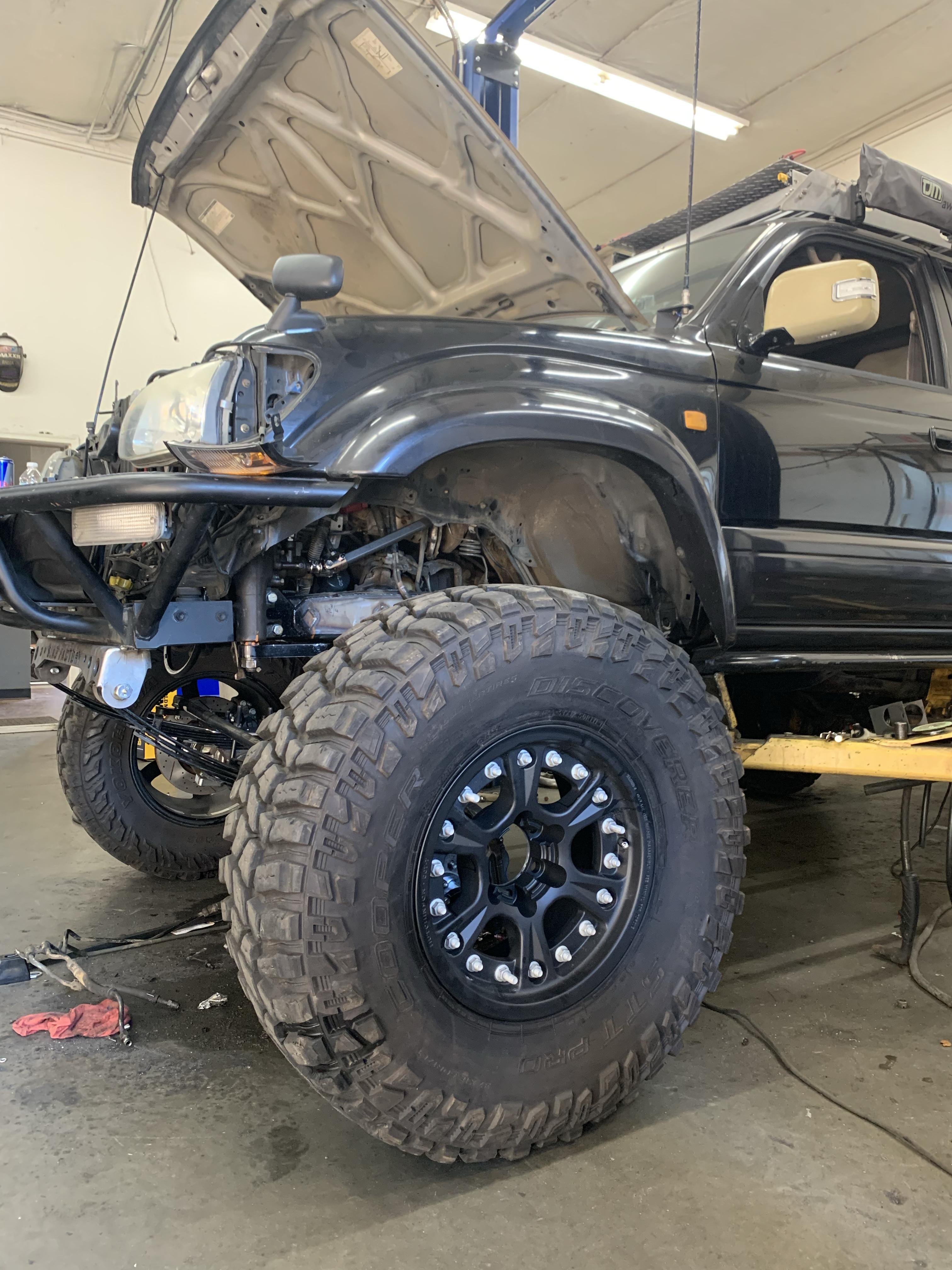

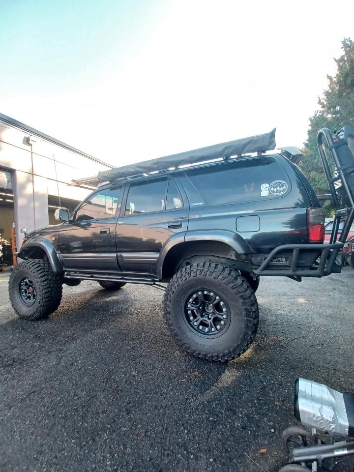

Moved the hanger forward 1/2” and mounted the box with steering links. I also built my HUTCHINSON DOT BEADLOCKS wrapped on 37” COOPER STT PROS.
The front is done. Just waiting on my 6 1.25” heim joints for my links and 2 7/8” heim joints for my pan hard bar.

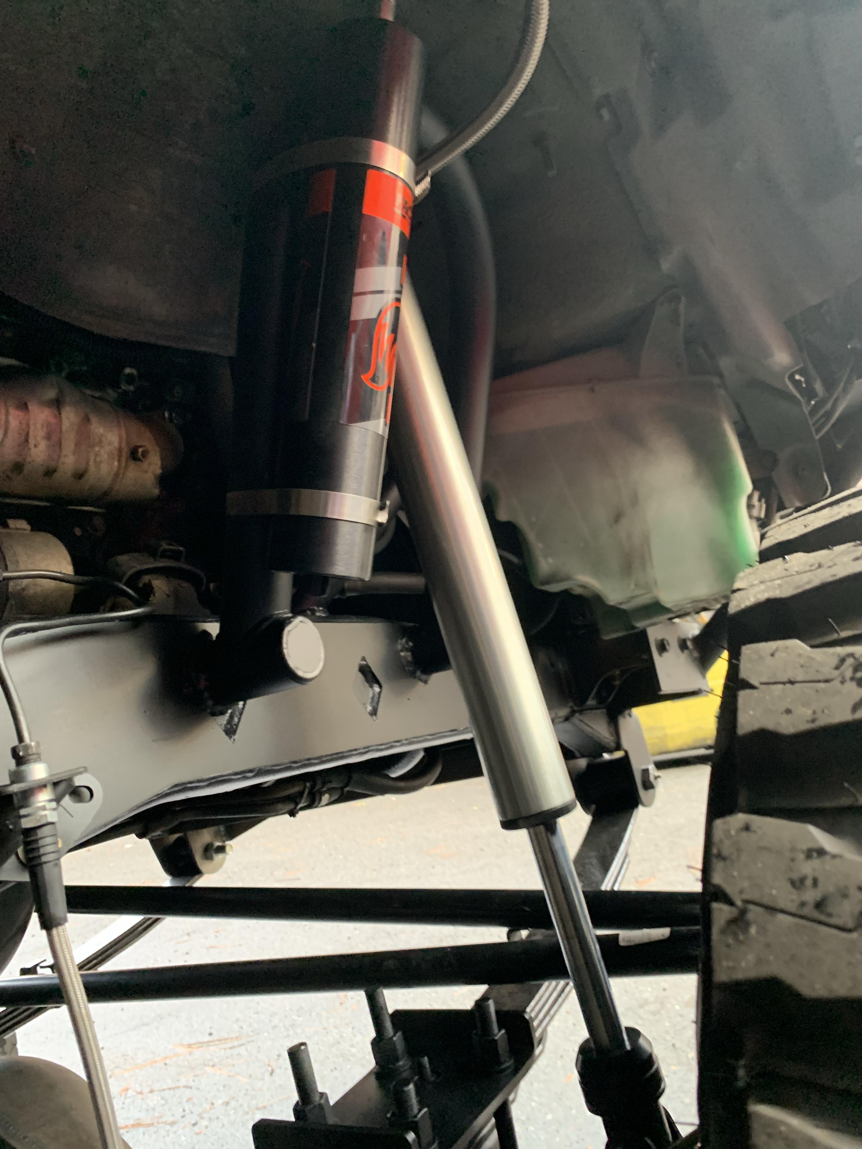

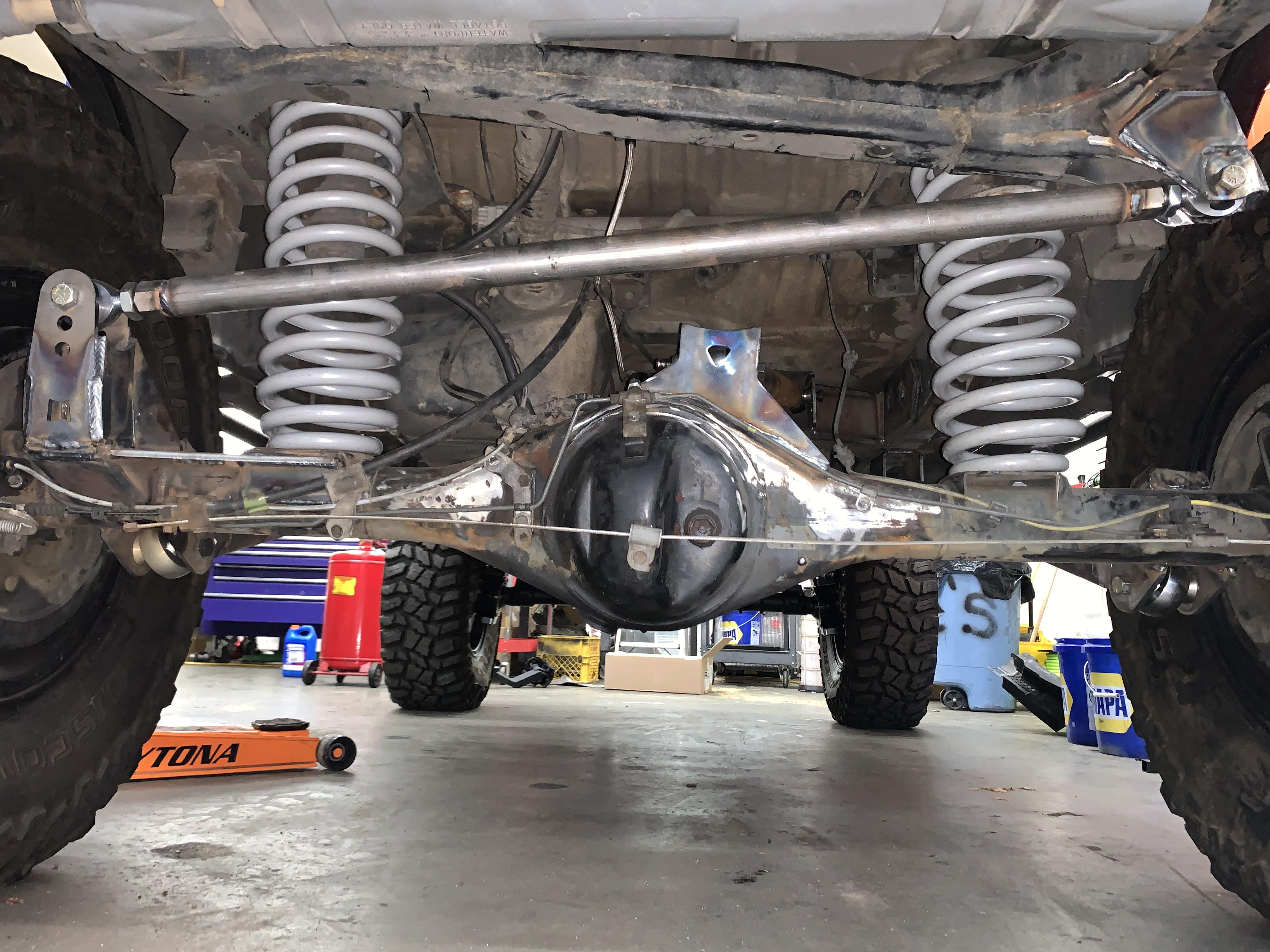

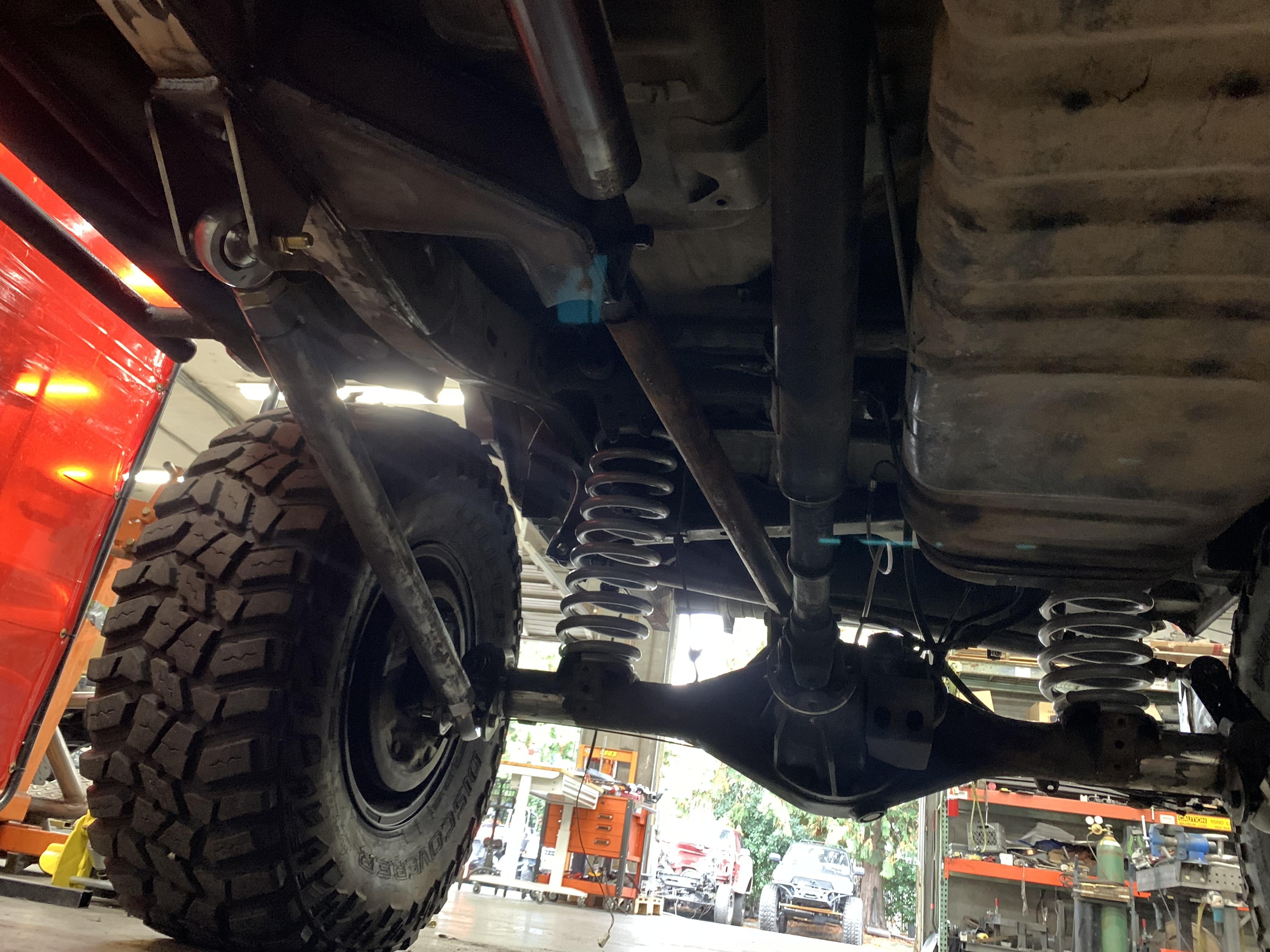

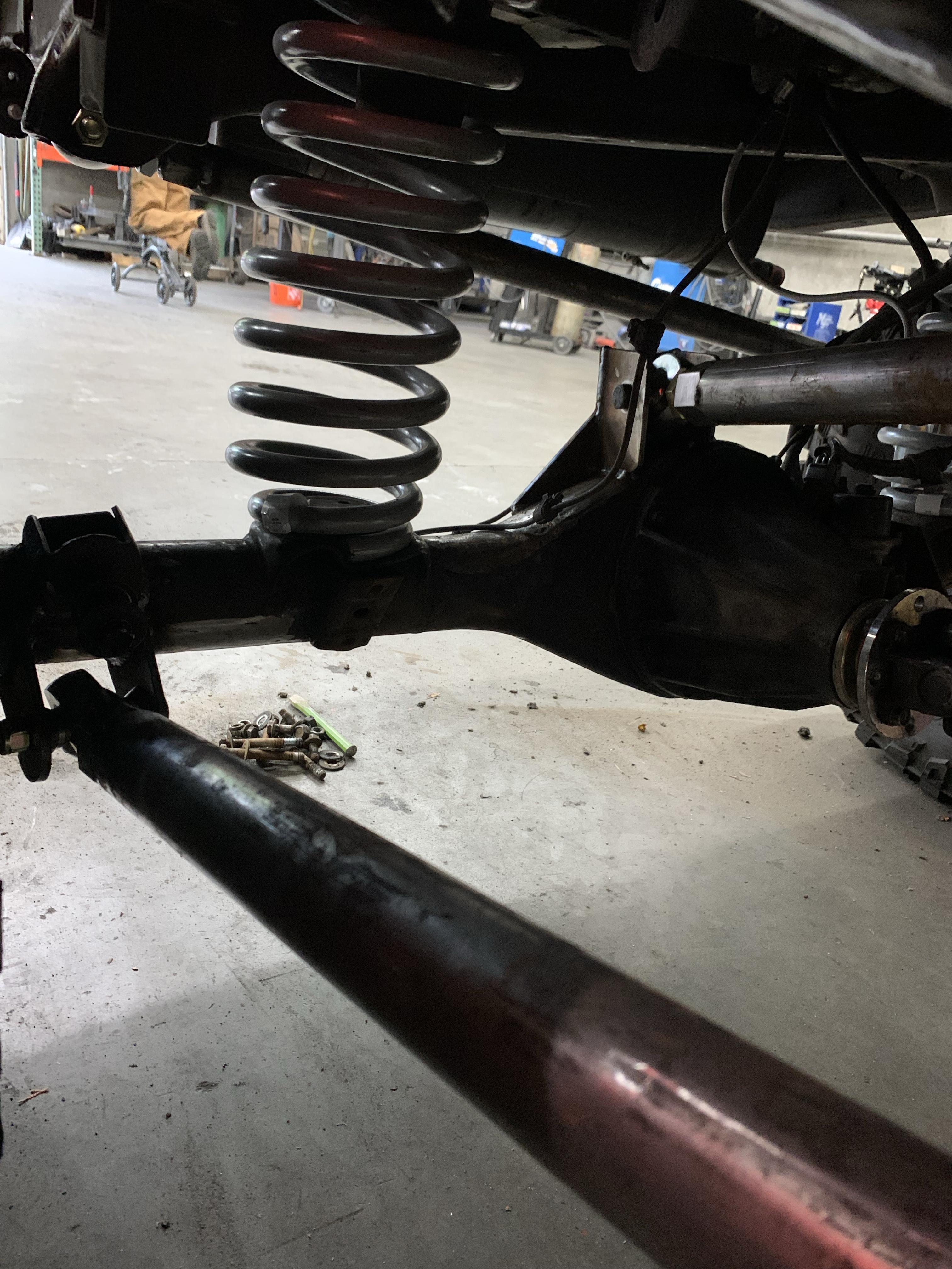

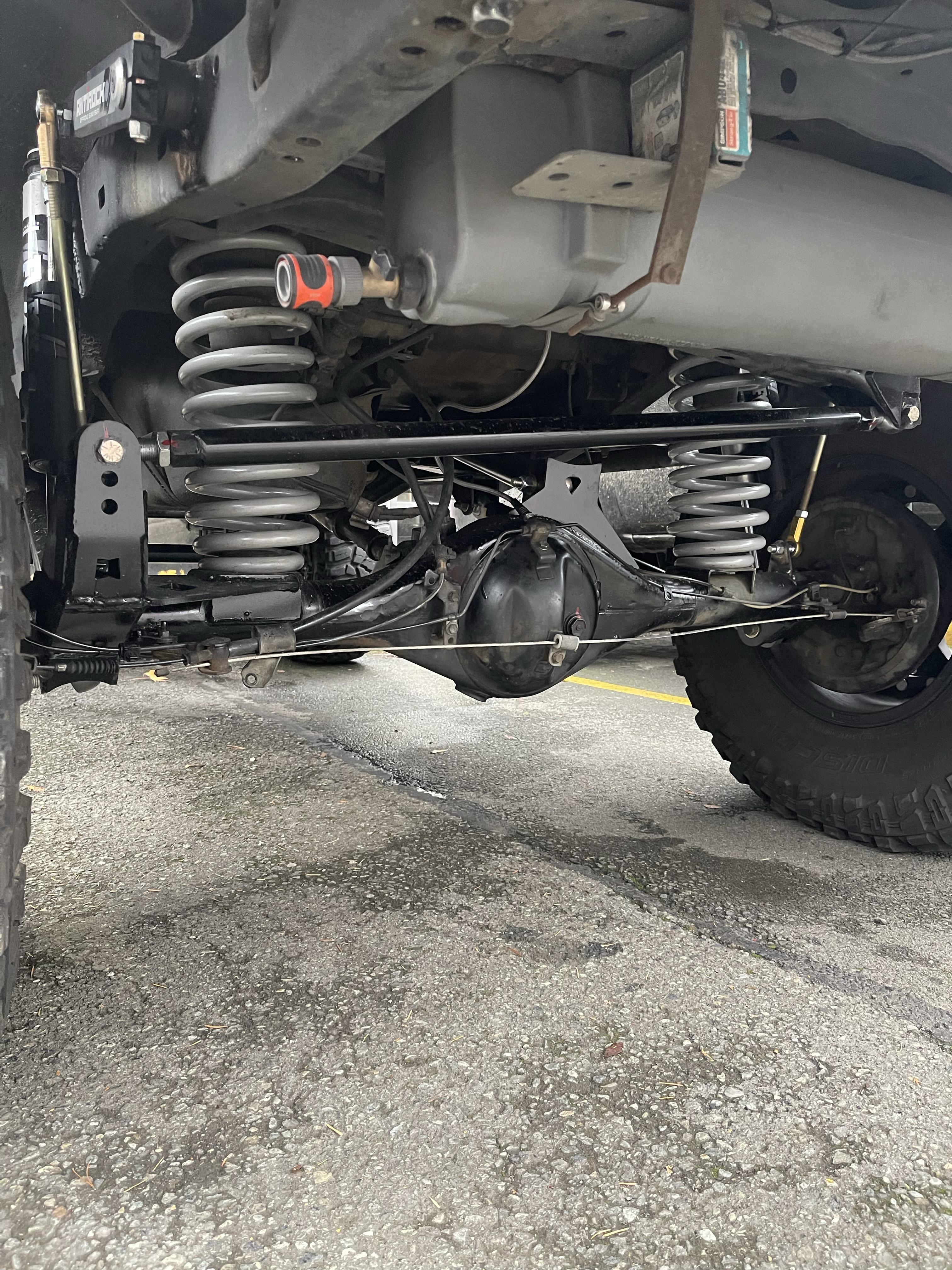

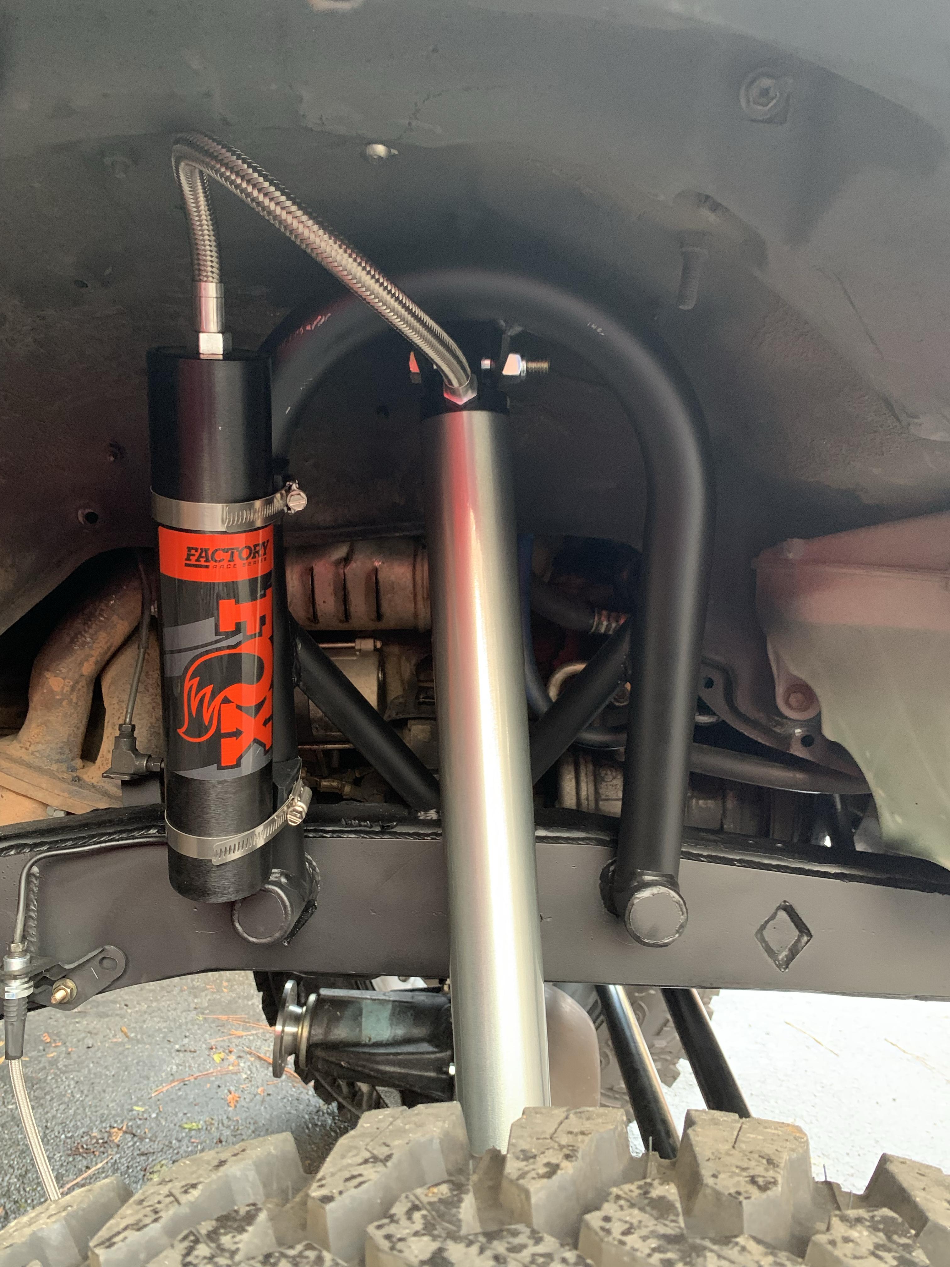

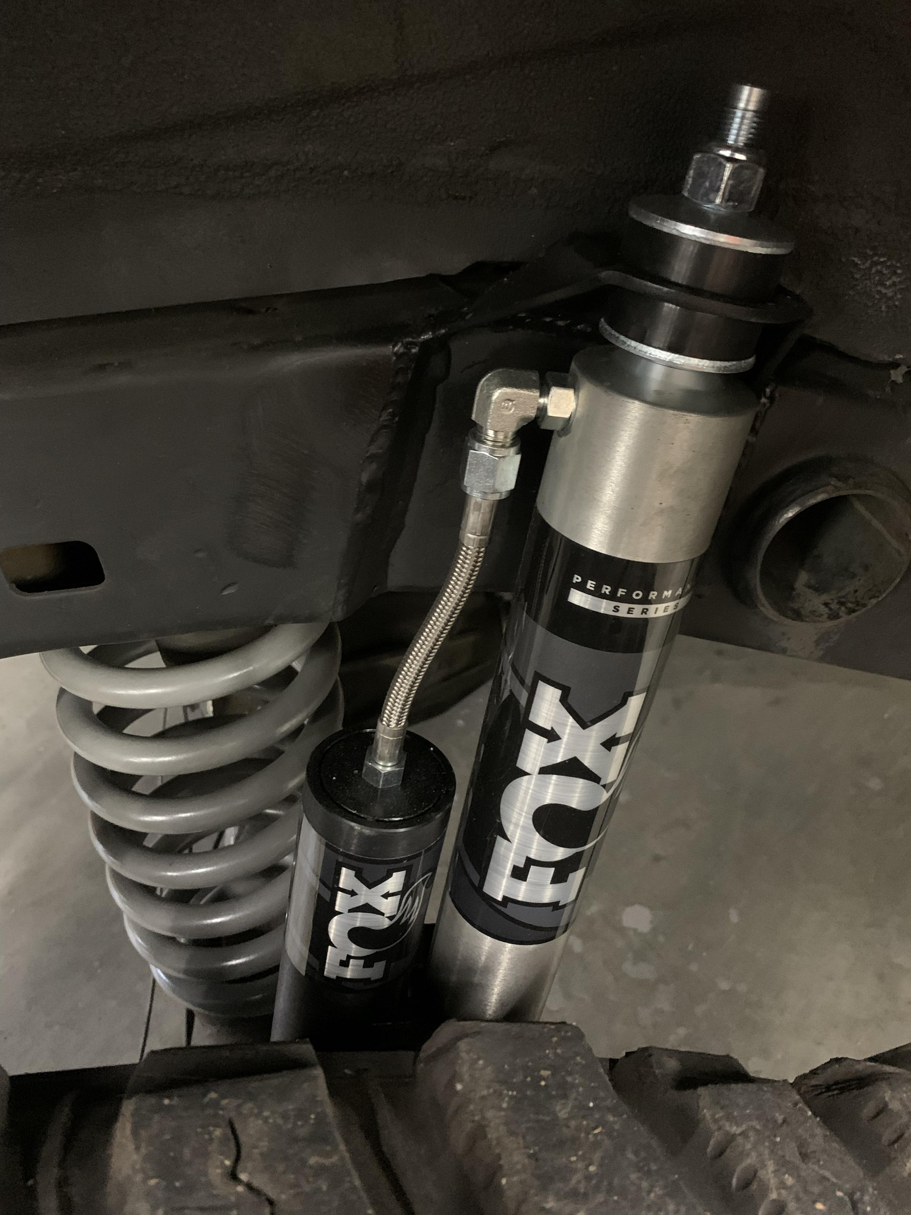

Well my rear 3link is done getting burnt in and waiting for rear FOX shocks to get shipped from California. I’m also in Cali on Vacation. I’m wanting to turn this vacation to a run errands for Dain’s truck, but I’m going to get cracks from my wife if I did that. Pictures are being sent shortly and I will be posting shortly.

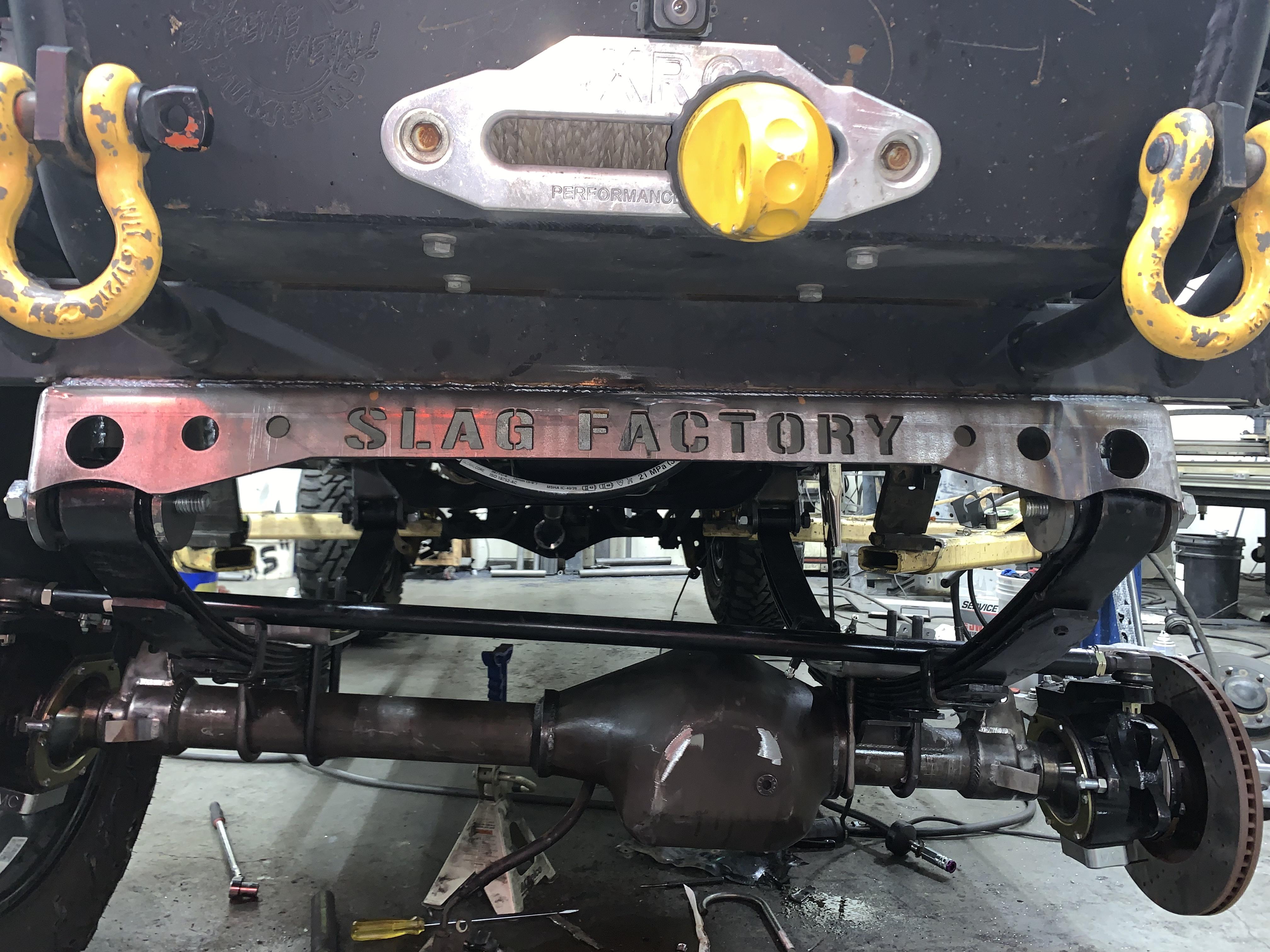

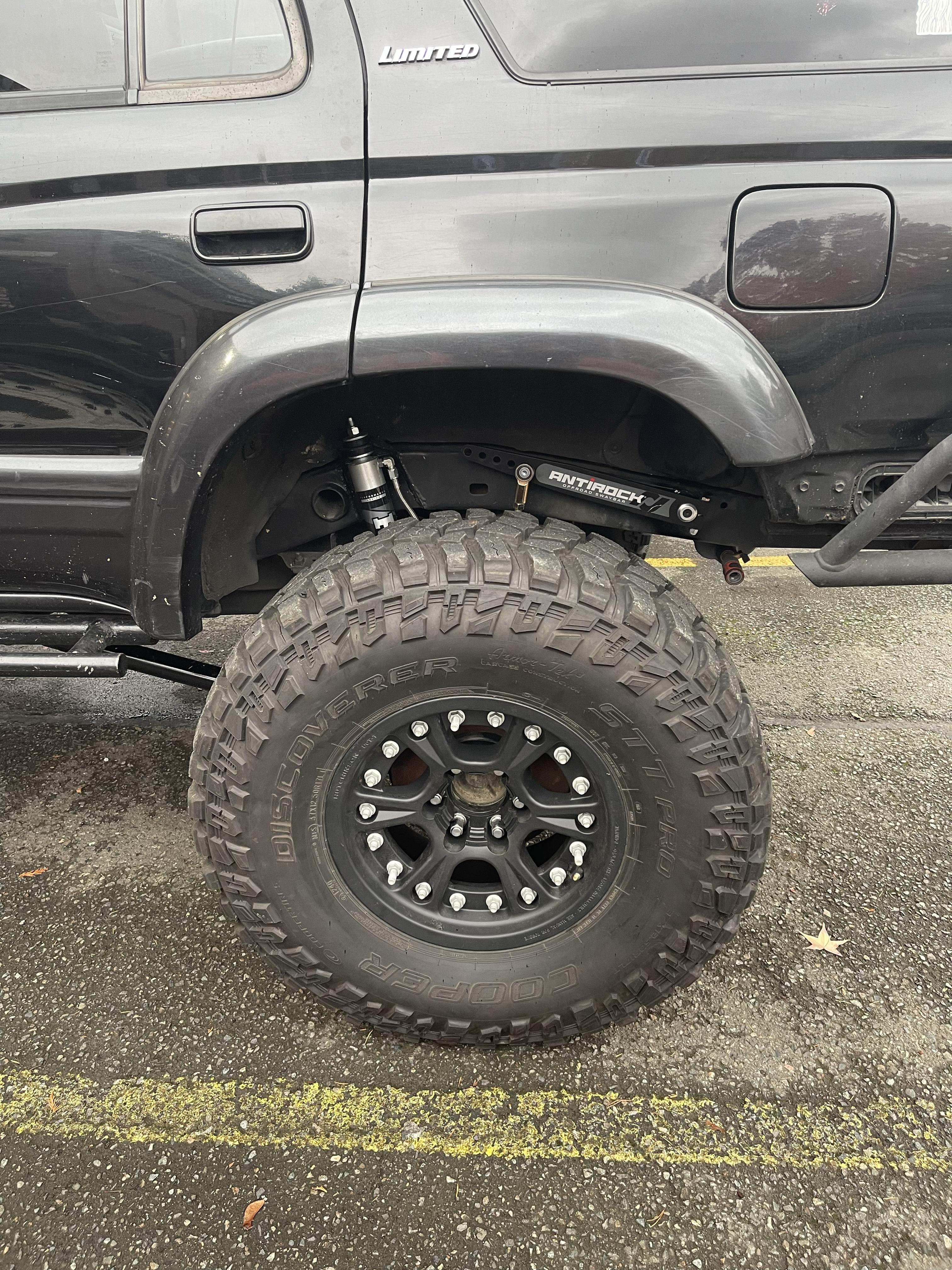

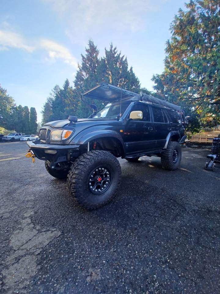

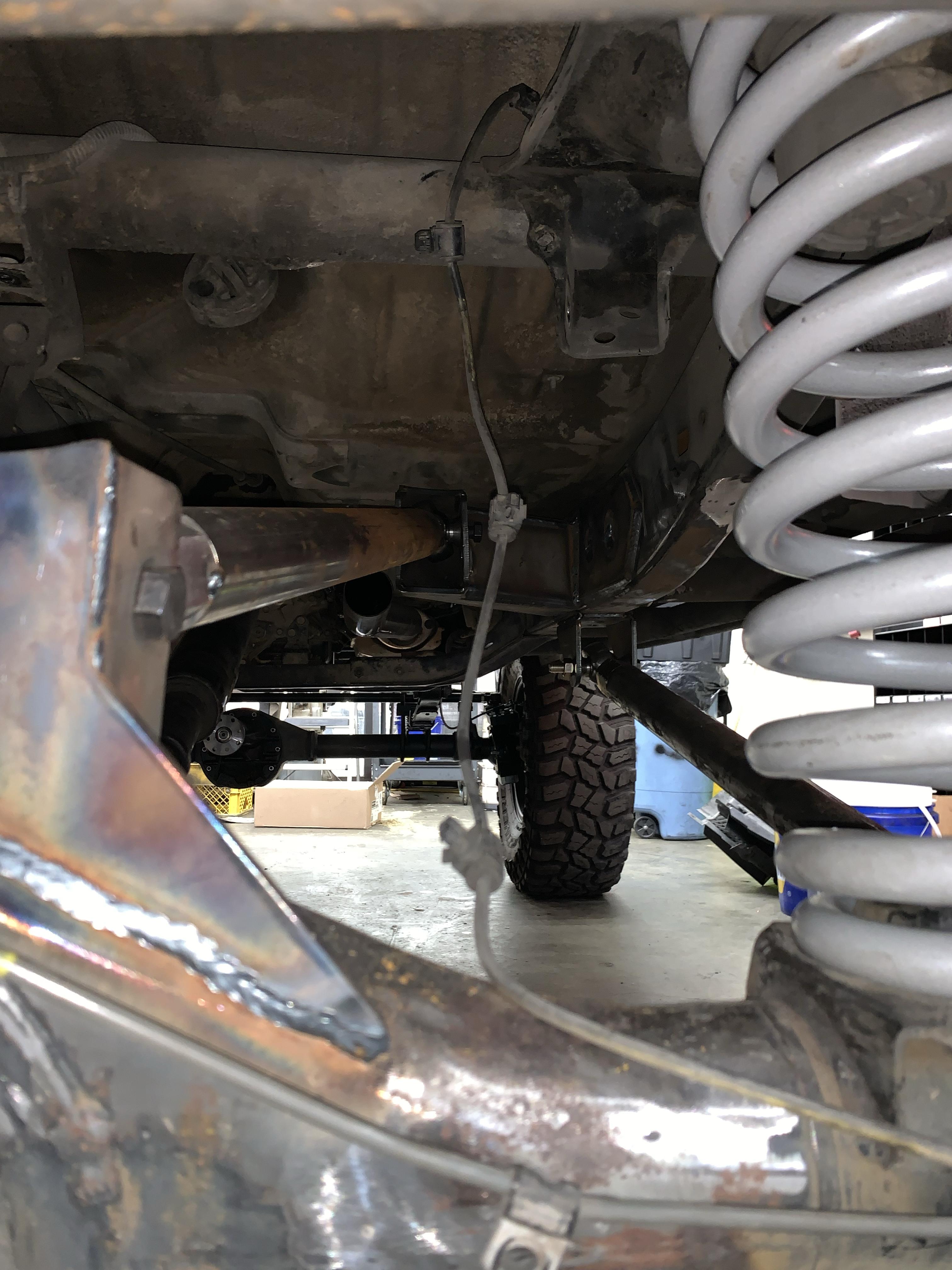

Some better shots of the SLEE 6” front FZJ80 coils and custom 3 link of my truck.

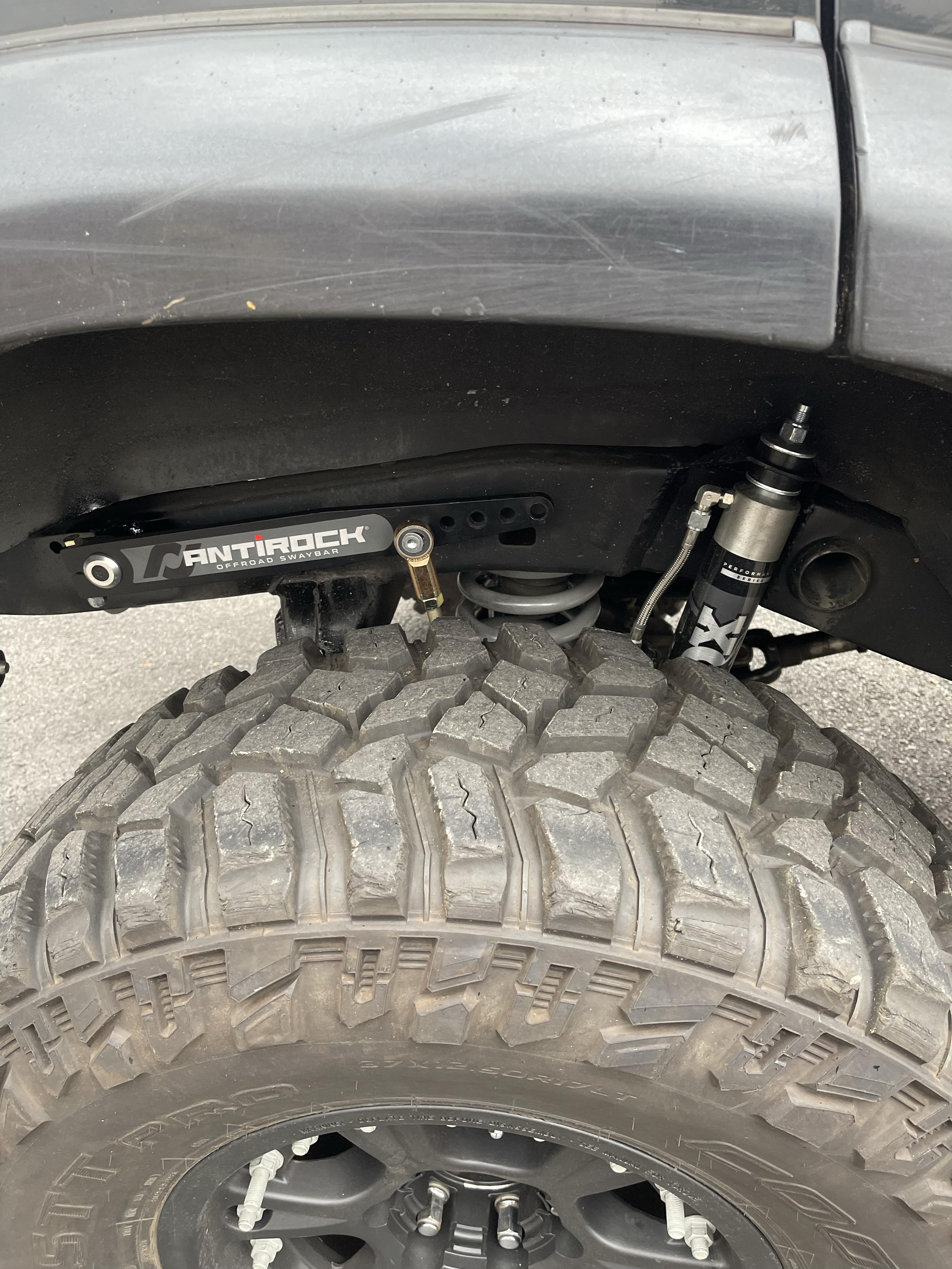

Curious as to why you didn't link front and rear?
More money and less money. When I decided to SAS the truck, I already bought the front axle and the whole front kit. when I brought it to the shop, all the 3rd gens were getting linked. Then after they finished the front, the rear was lower by 5”s. So I basically told them to match the rear. It was Chevy 63s or the 3 link. I told them to link it, cuz in the near future when I’m home in Hawaii, I might just link the front.

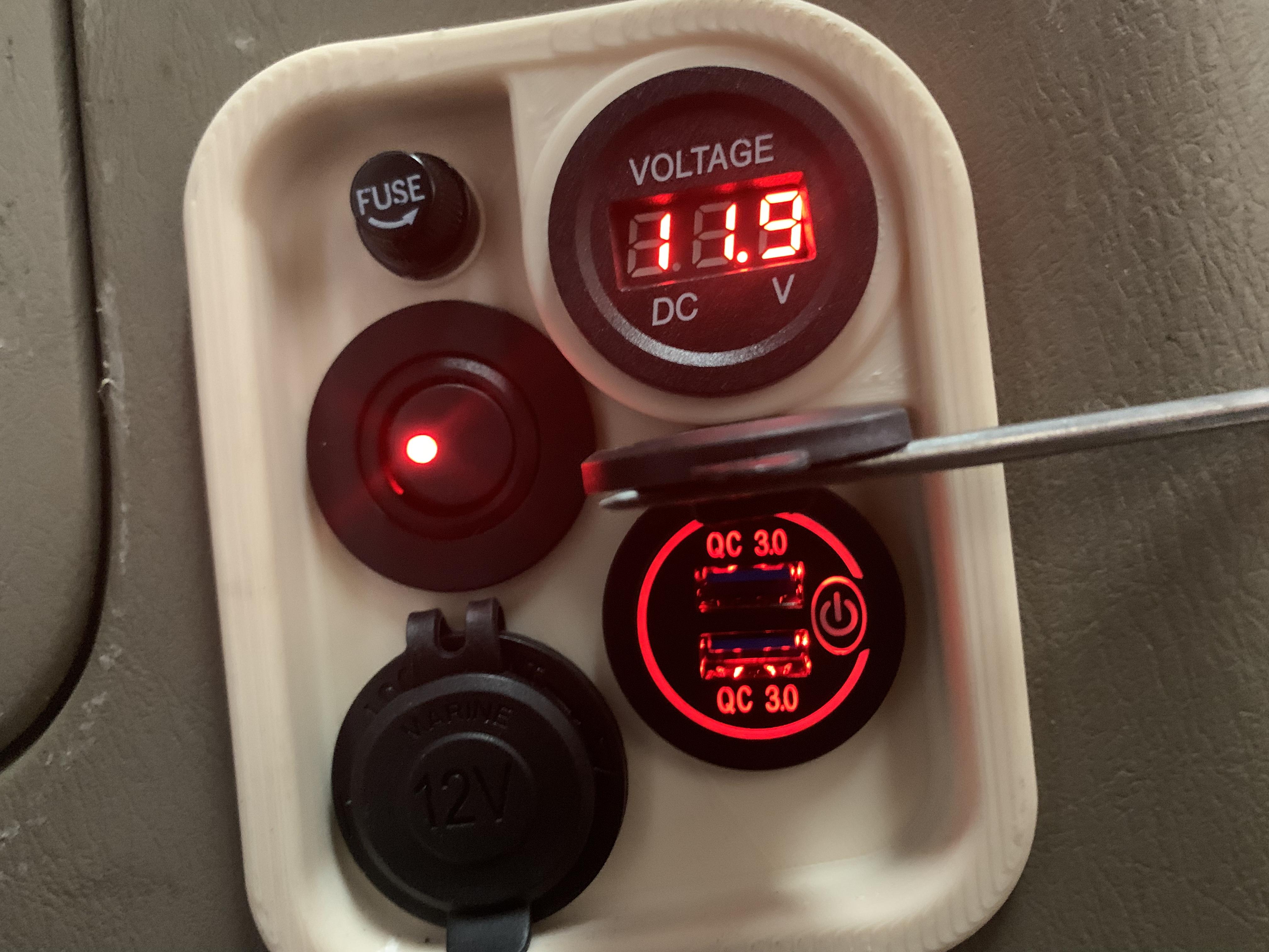

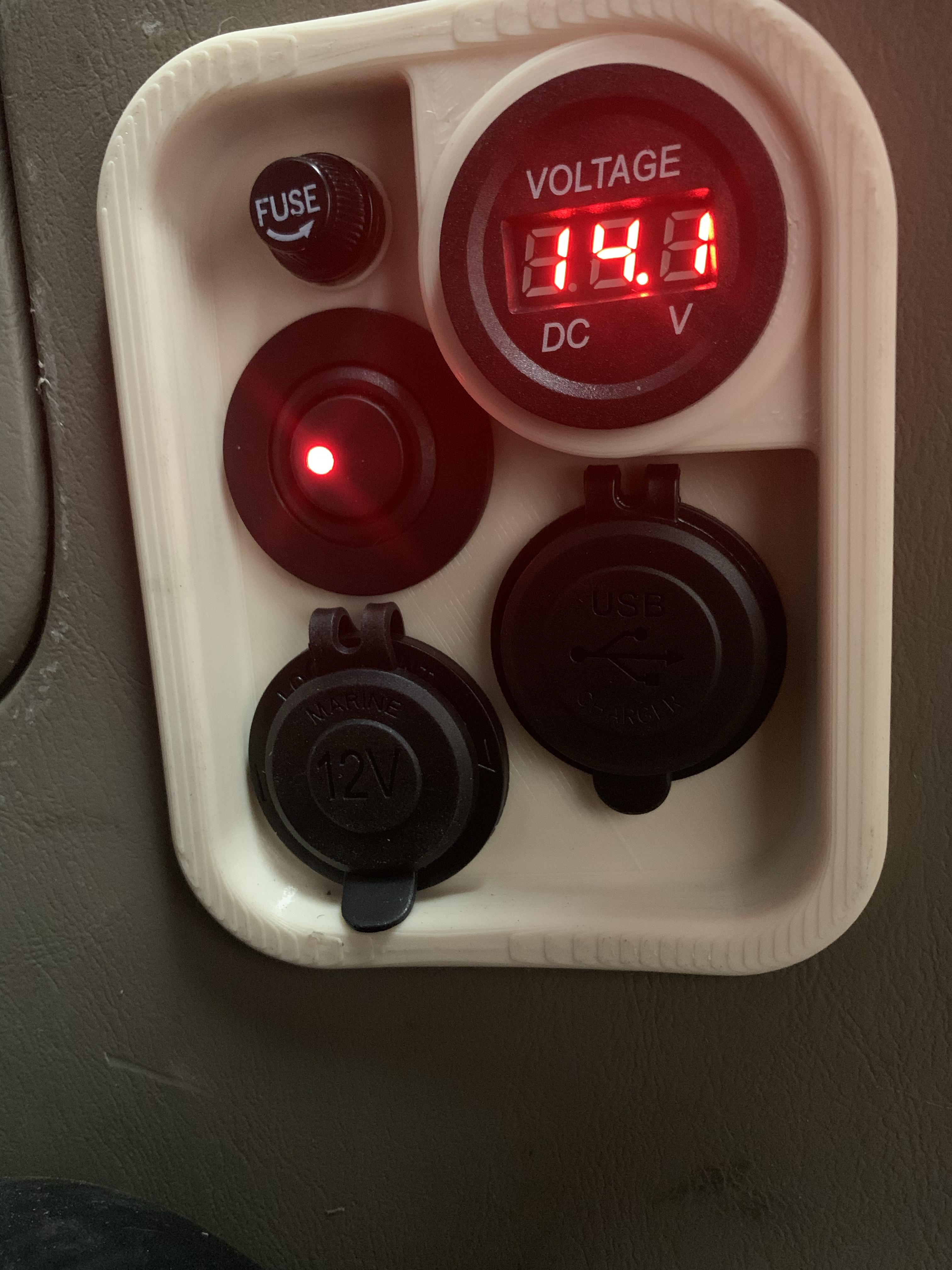

I bought this rear usb, cigarette lighter plug, volt thingy from shitbox customs. I just installed it yesterday. Fits like a glove.
