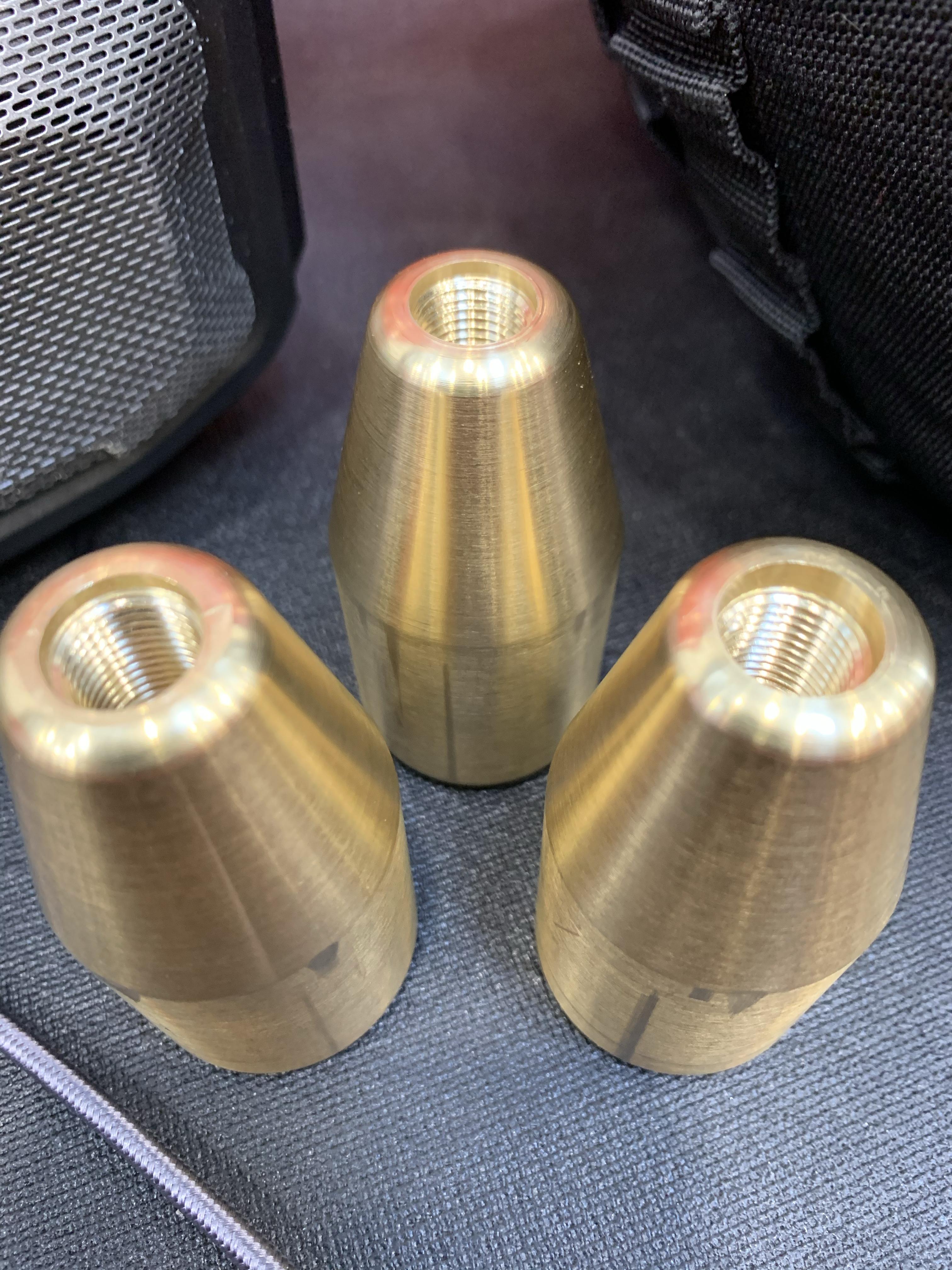

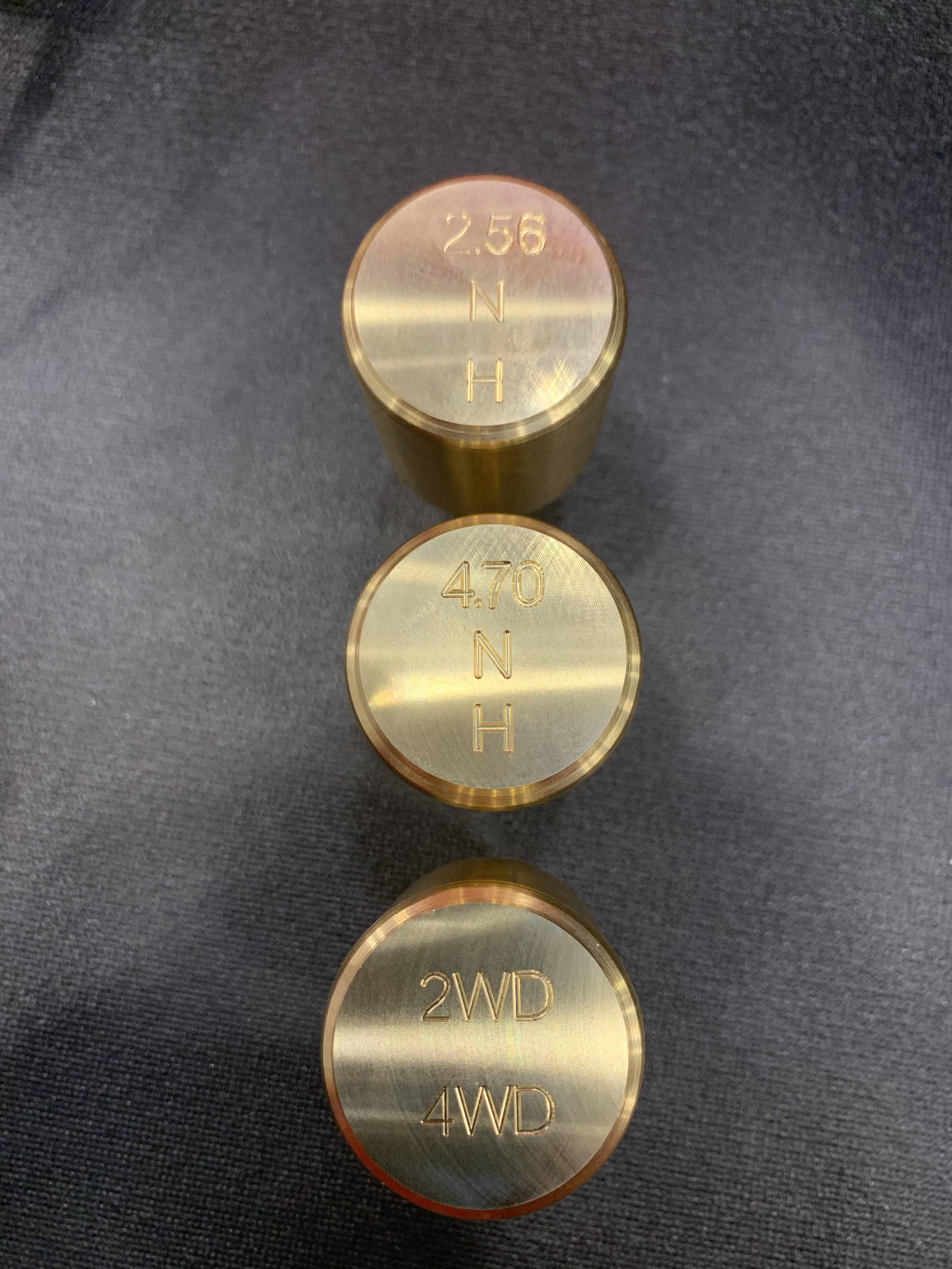

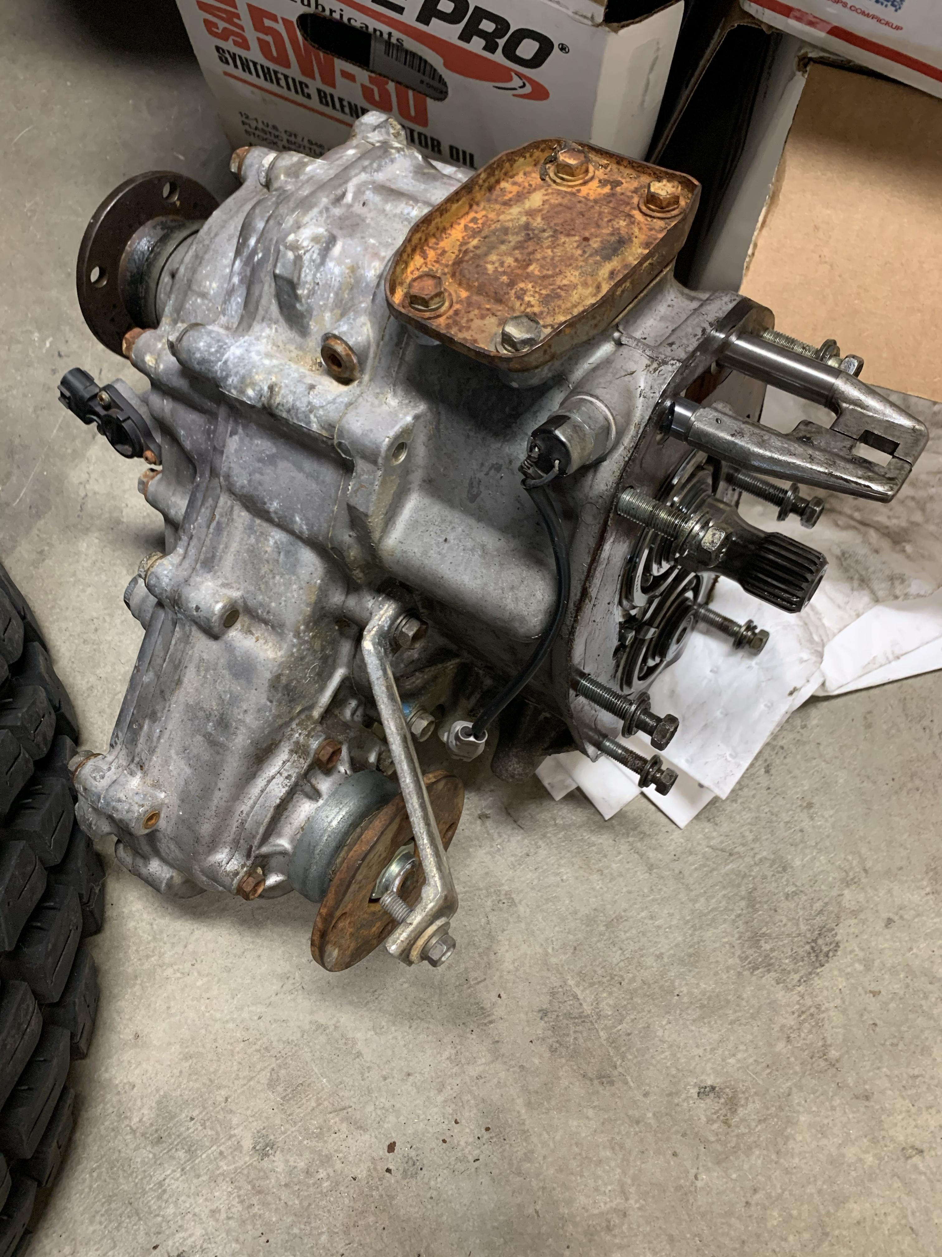

Am I crazy? I thought our tcases were 2.28? I know 4.70 for the dual case is normal. You got a 2.56 in your stock case?
2.28 came in gear driven t-cases. You can upgrade to the 4.70. Our trucks came with chain driven t-cases which is geared 2.56. From what I read anyway.
I turned the upper knob down .030 and lower knob .020. Also tapped all 3 holes
We share the same transfer case as tacoma's and fj cruiser's. 2.57 low range gear ratio.
EDIT: I've seen 2.56 and 2.57 about the same amount. Just depends on the source.
Just put 2.5X then you can't be wrong lol I've seen 2.56 and 2.57 about the same amount but for some reason my mind remembers it as 2.57
In Mechanical Engineering one thousand of an inch can make a big difference depending on tolerances, but dis iz just fo show

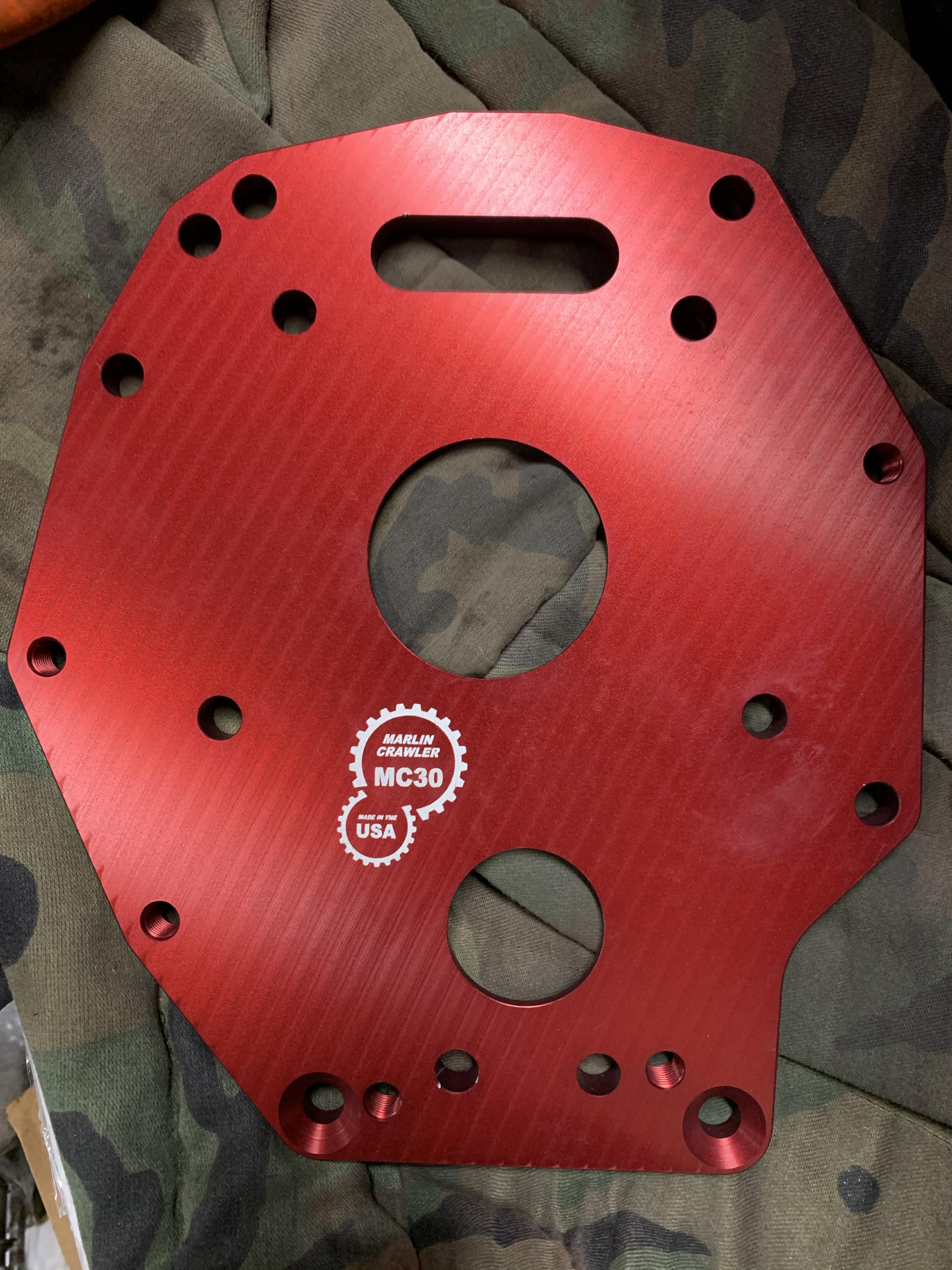

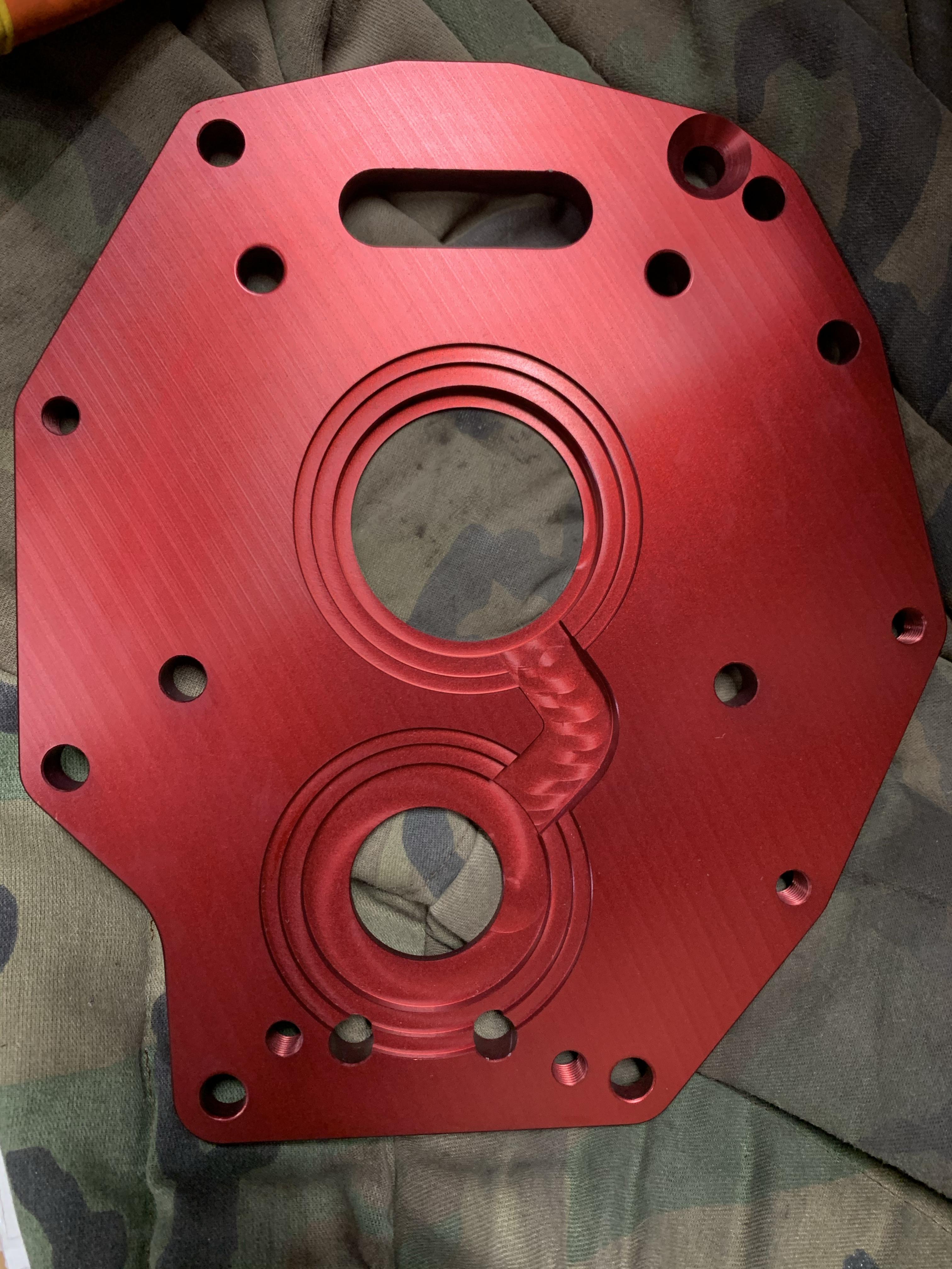

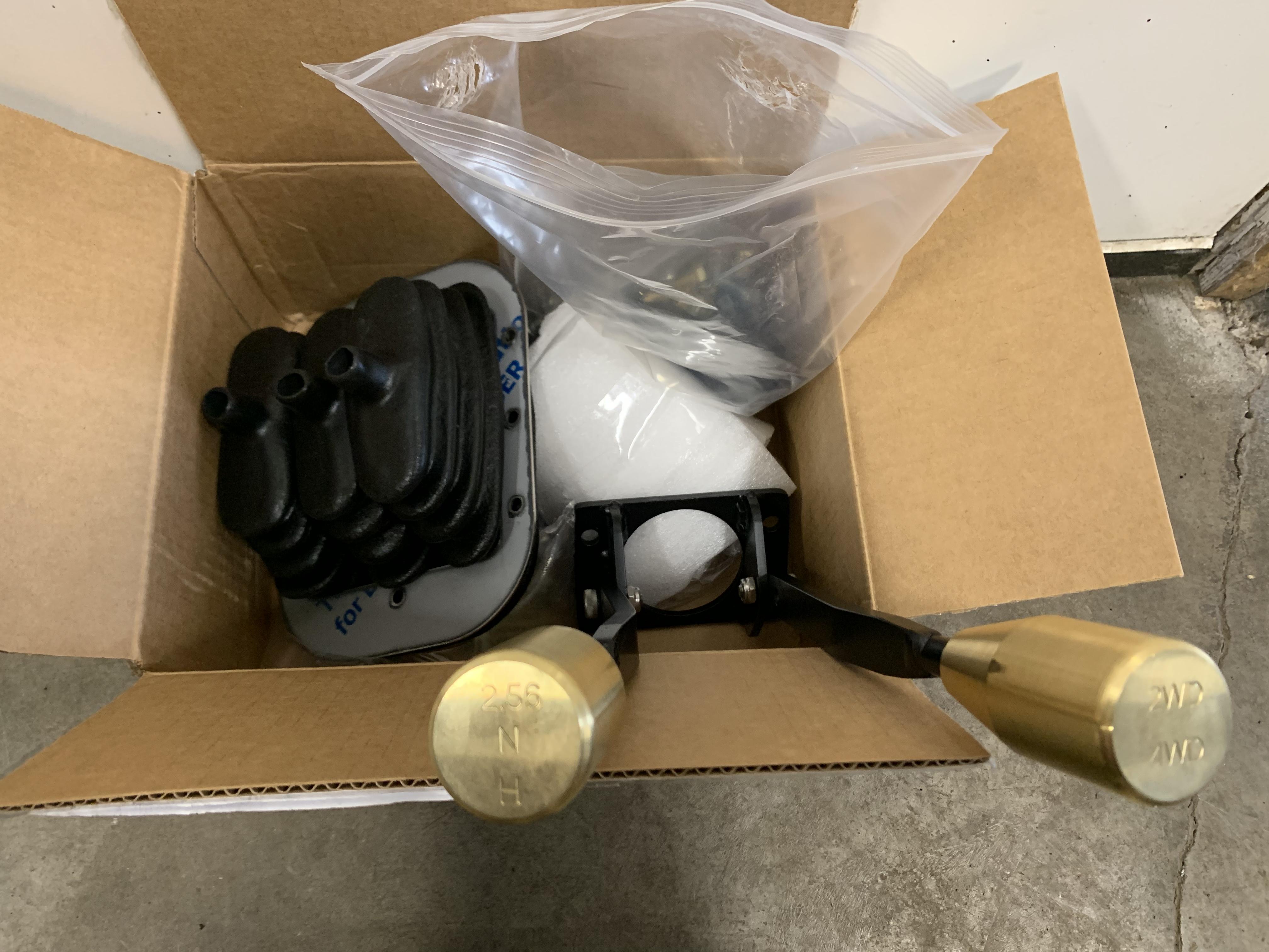

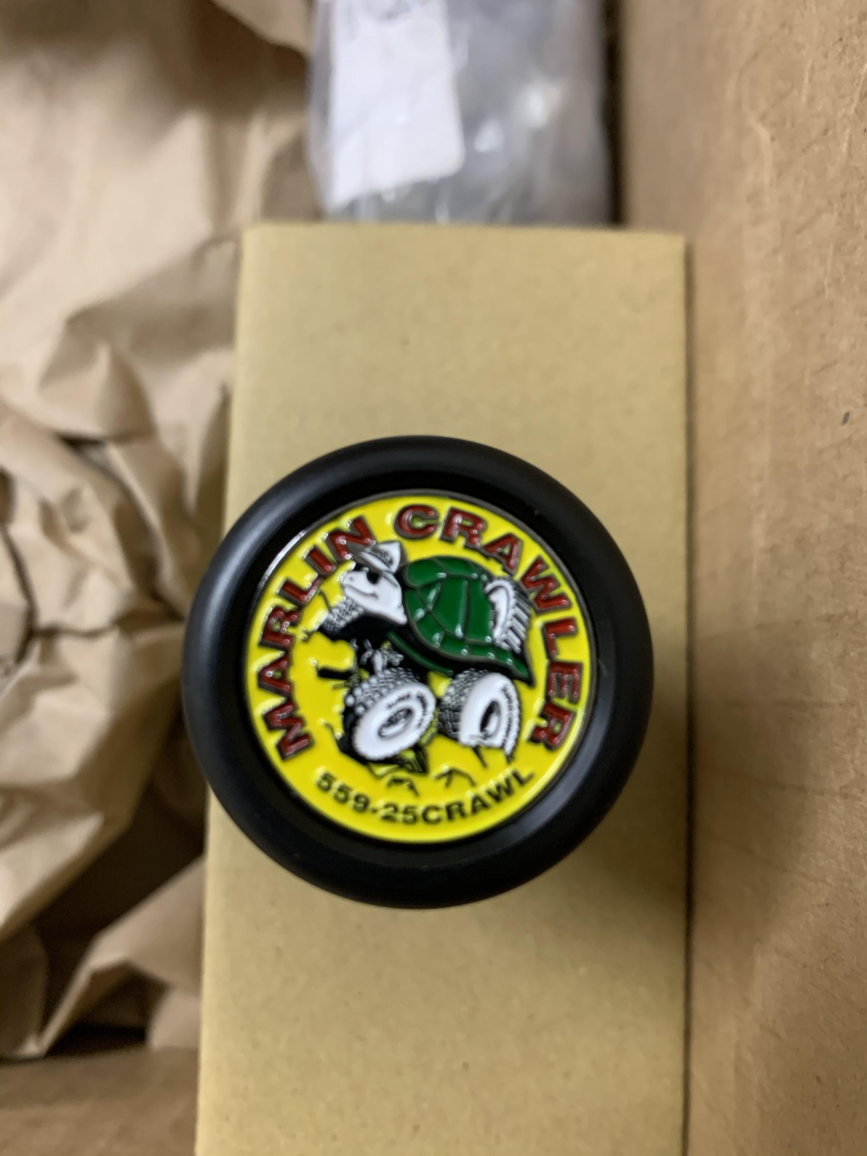

Brah took me a month jus to find a tcase foa my duals. Unreal! I called home in HI & they didn’t have and da people who had didn’t want to sell. Usually my friends call me from back home for parts, but I guess not no moa. I picked up a whole forward shift case for $300. I still have to convert it to top shift when my gears come in. I’m going wit da 4.7 Marlin Comp.
My gears came in. Now I’m just waiting on the rear adapter to complete the dual t-cases. I just wished Marlin didn’t stop making built cases. Now I just have to tear it apart and install

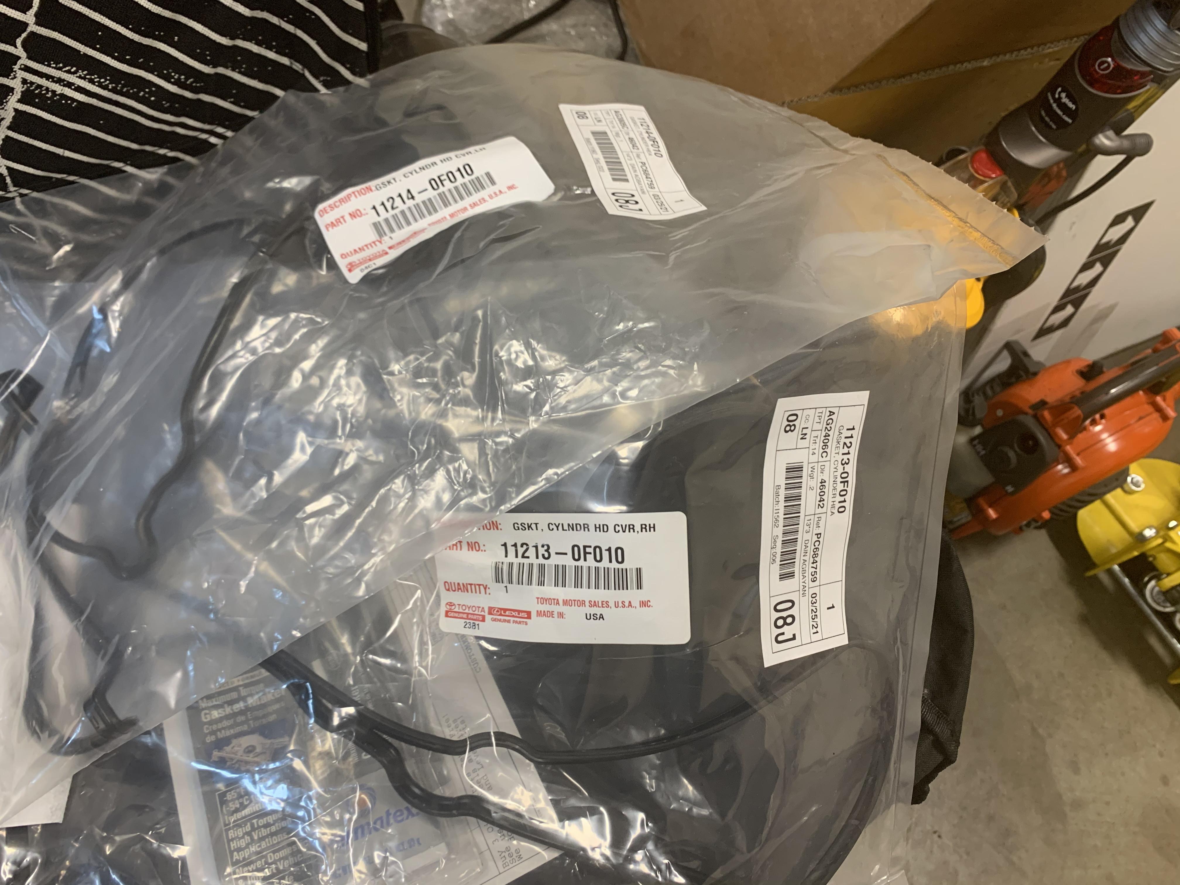

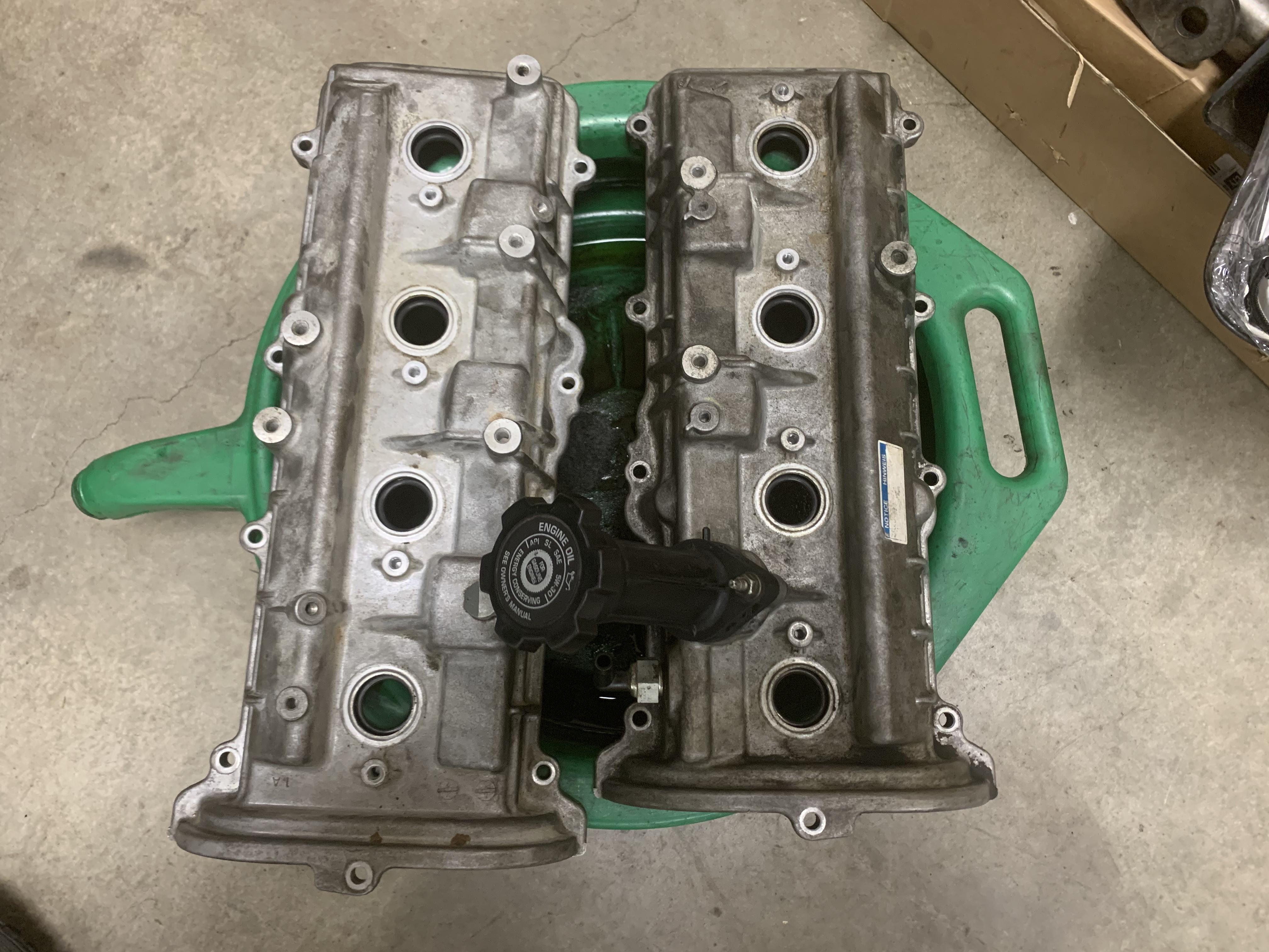

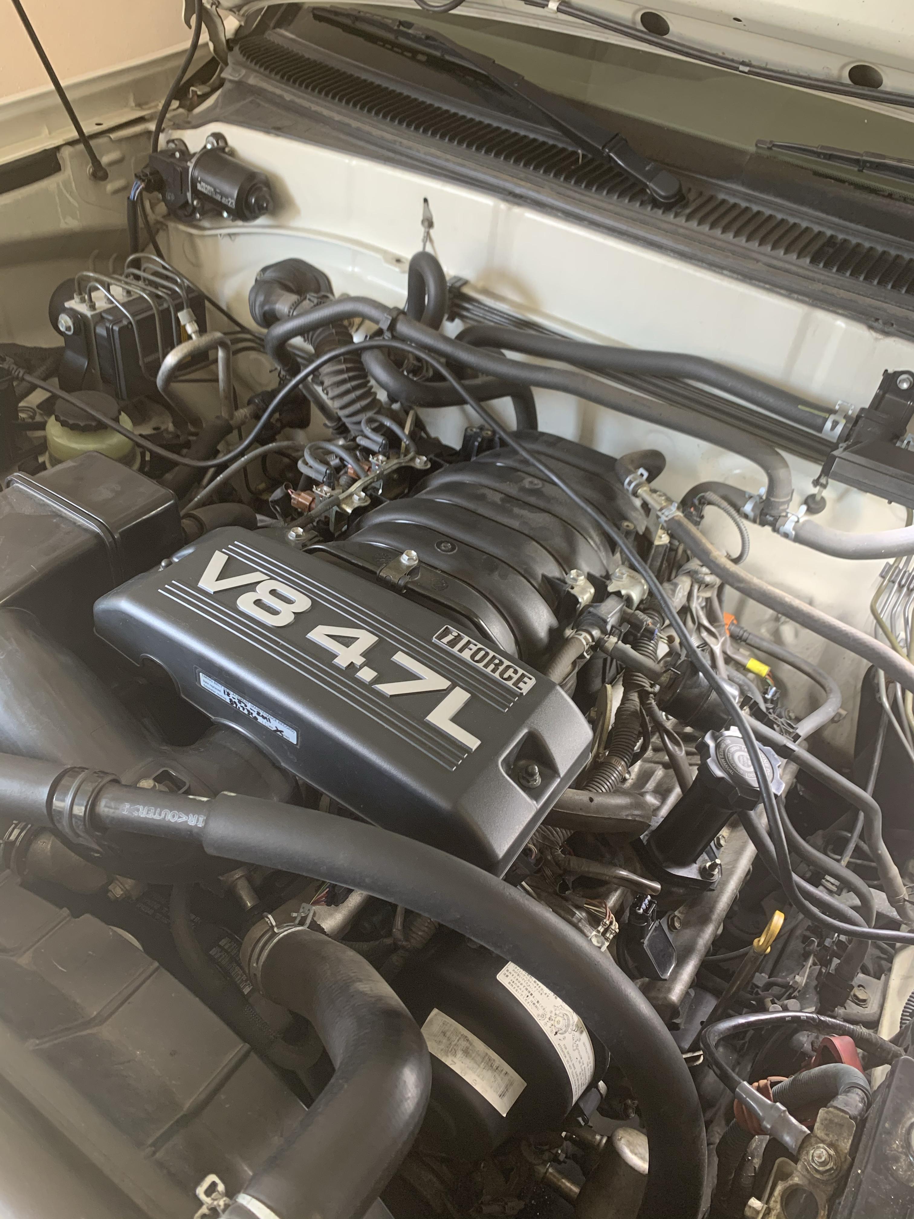

Been working on the wife’s truck lately,while I wait for parts to come in. Did her valve-cover gasket this past weekend. I am about to do mines soon as well. I love working on her motor, there is so much room.

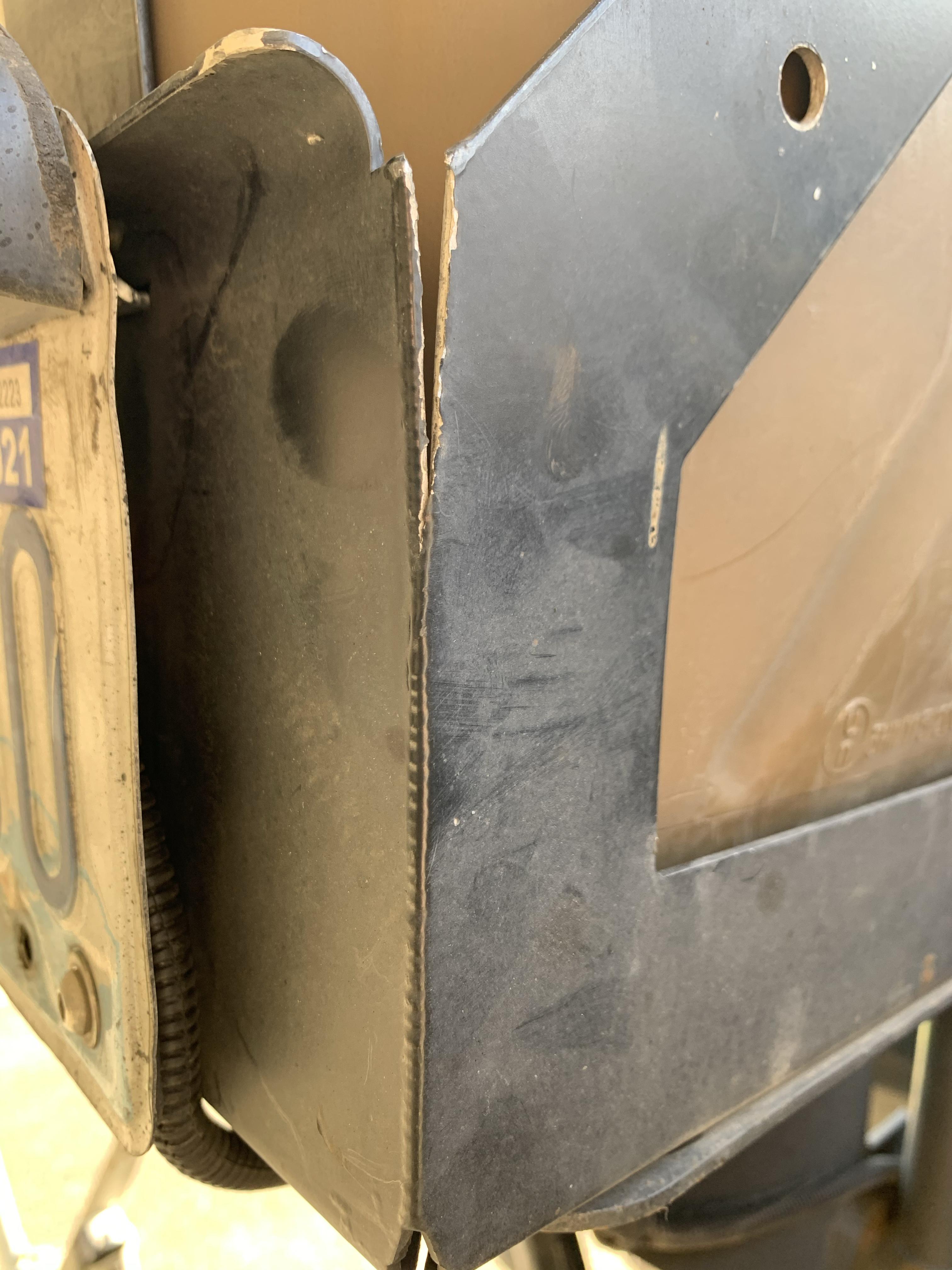

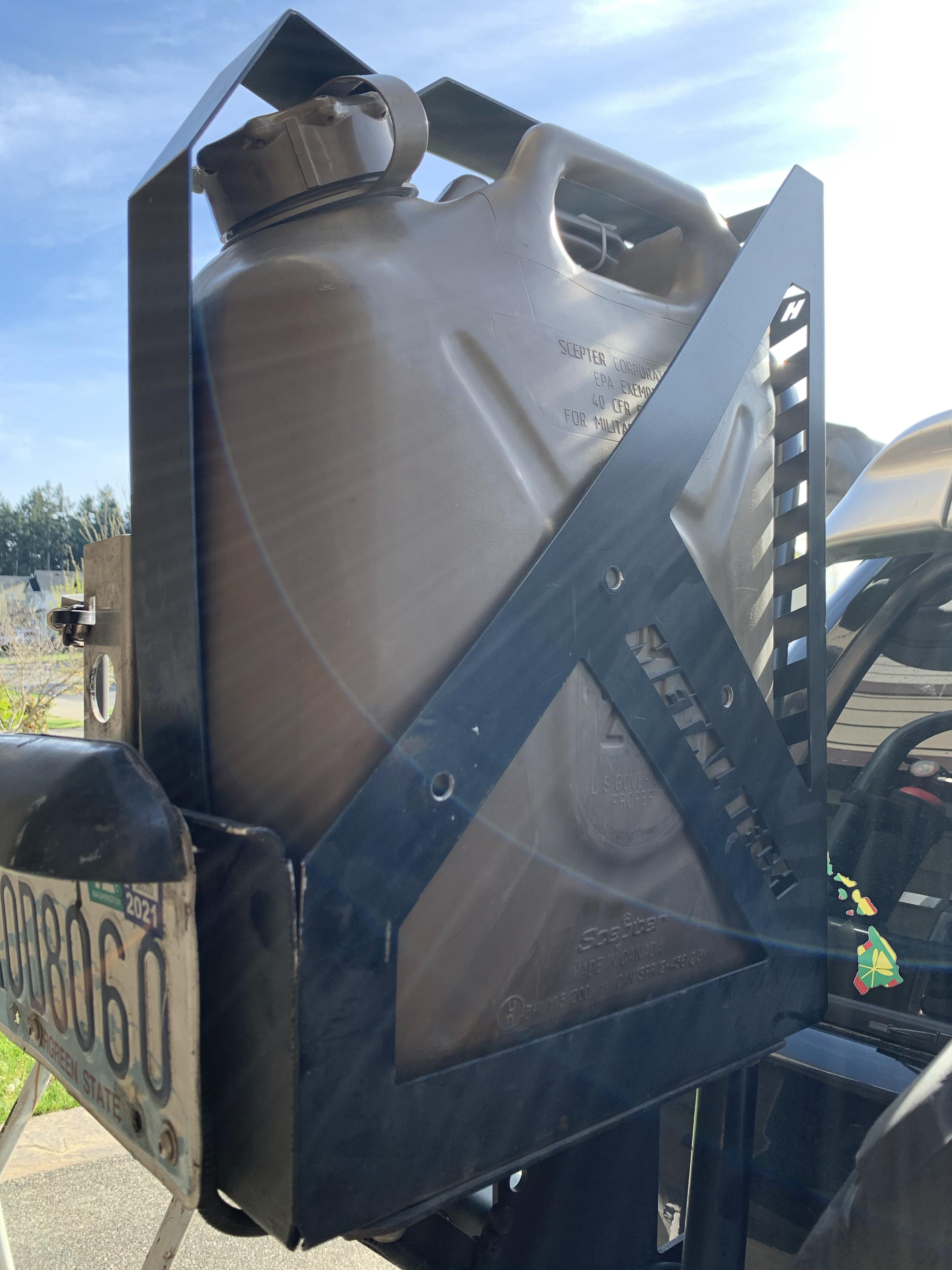

Noticed a crack in my Metal Tech Fuel Can Holder. It is cracking at the weld. Didn’t expect this from a reputable company.
