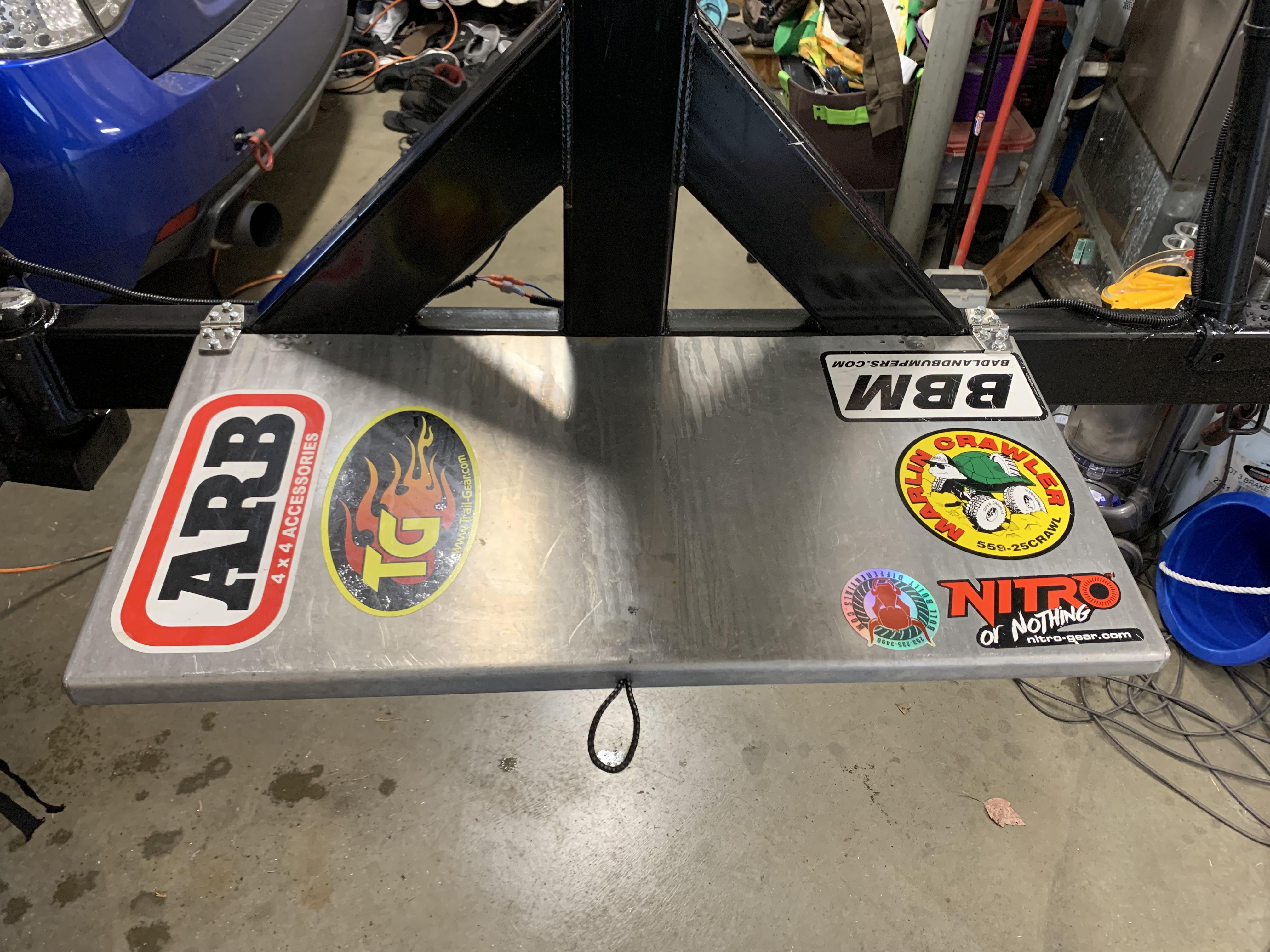

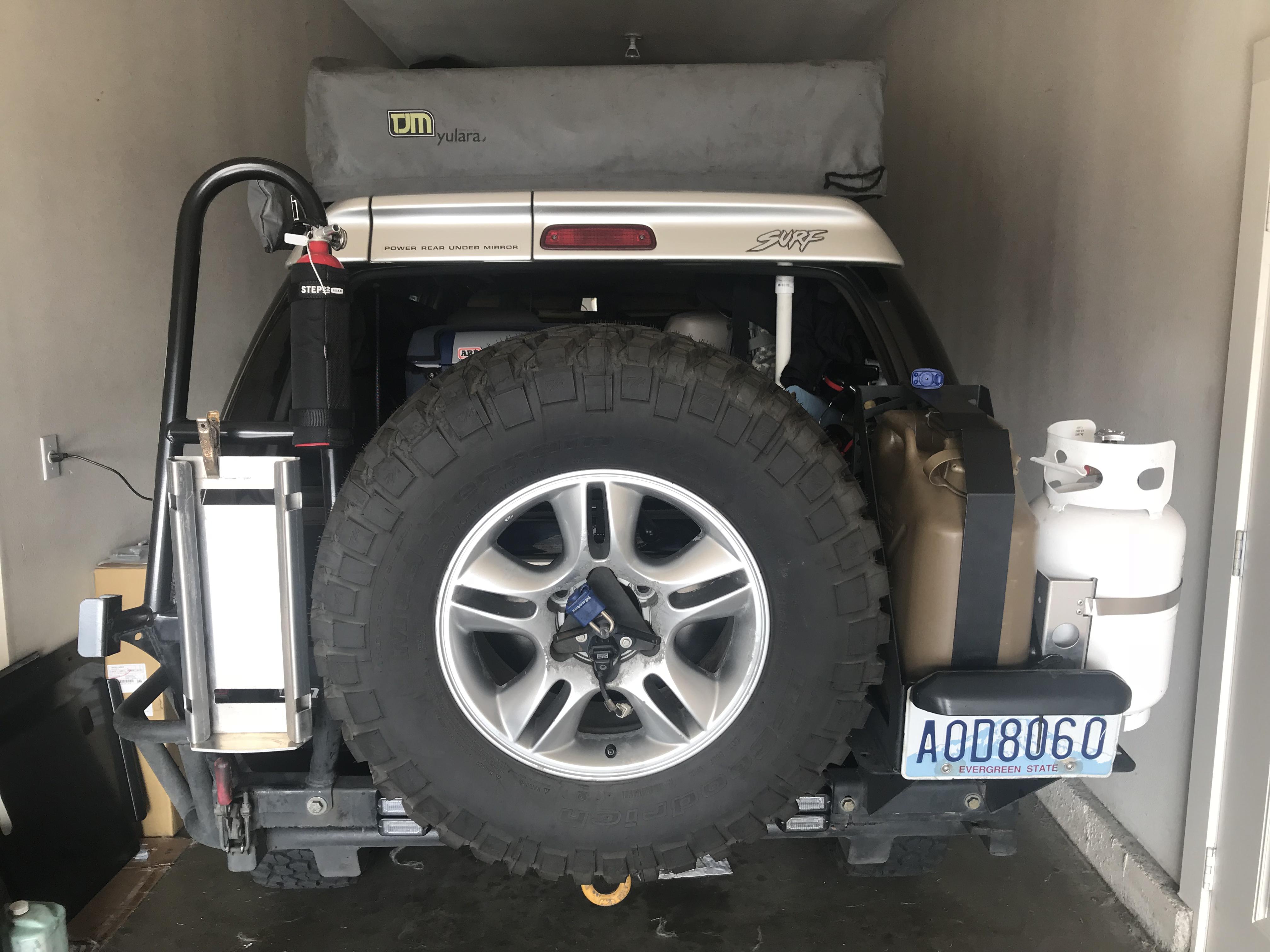

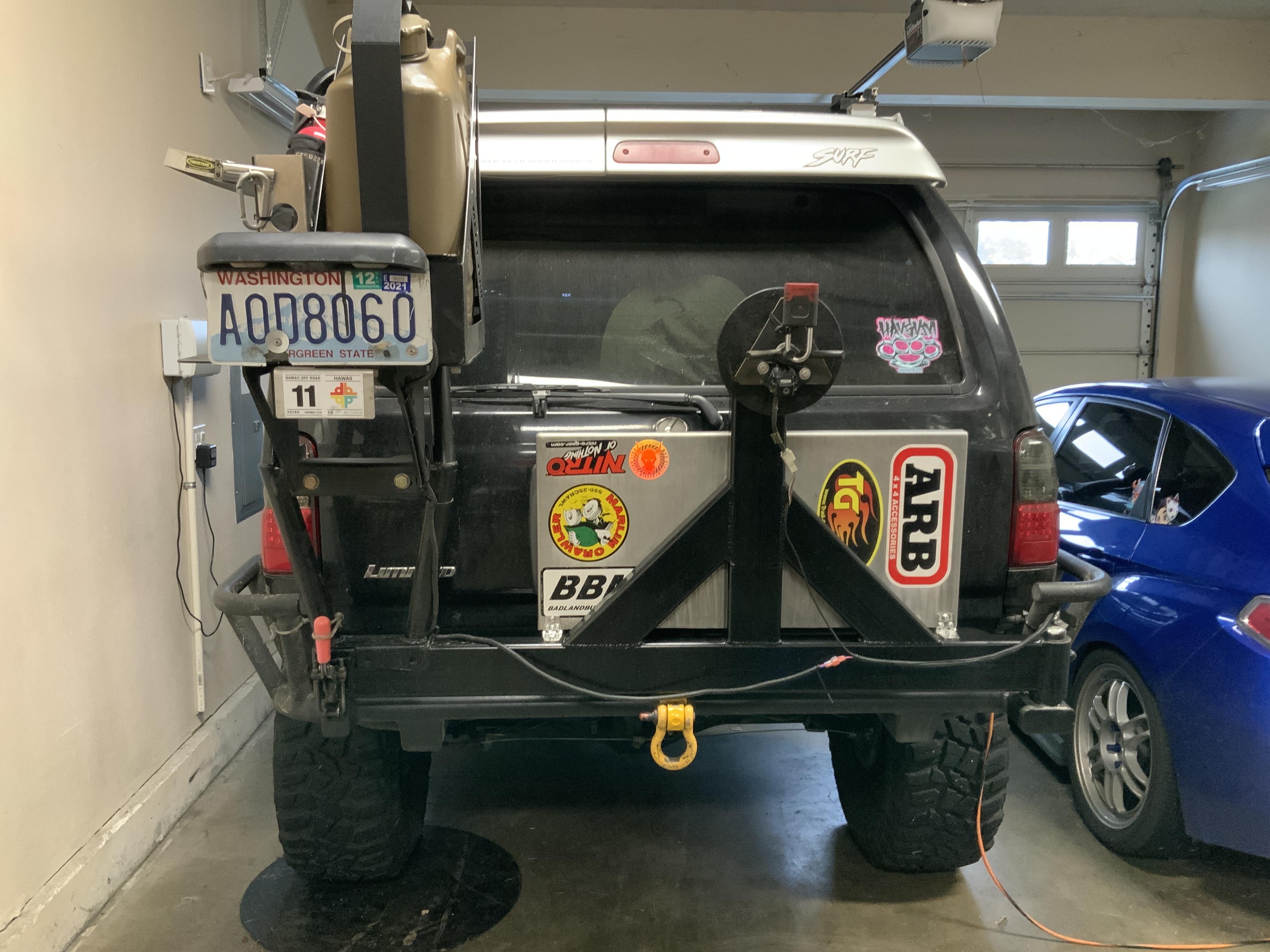

Installed my rear table on the new rear tire carrier. My old bumper was 2x3. When I ordered my metal, I thought it was 2x4. Well after I installed it and went to install it, I was wondering why the holes wasn’t lining up. Then the fabricator tells me the metal is 2x4. I told him that I knew that, then he tells me the original bumper was 2x3. I said, OH [emoji26]!

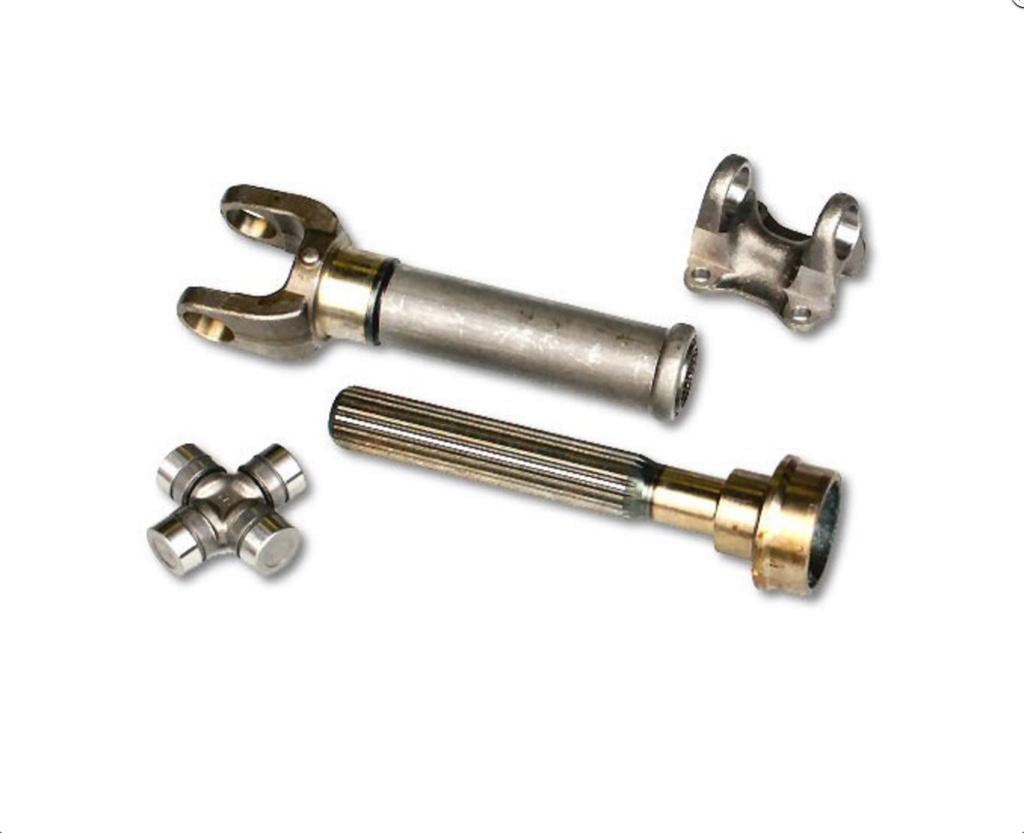

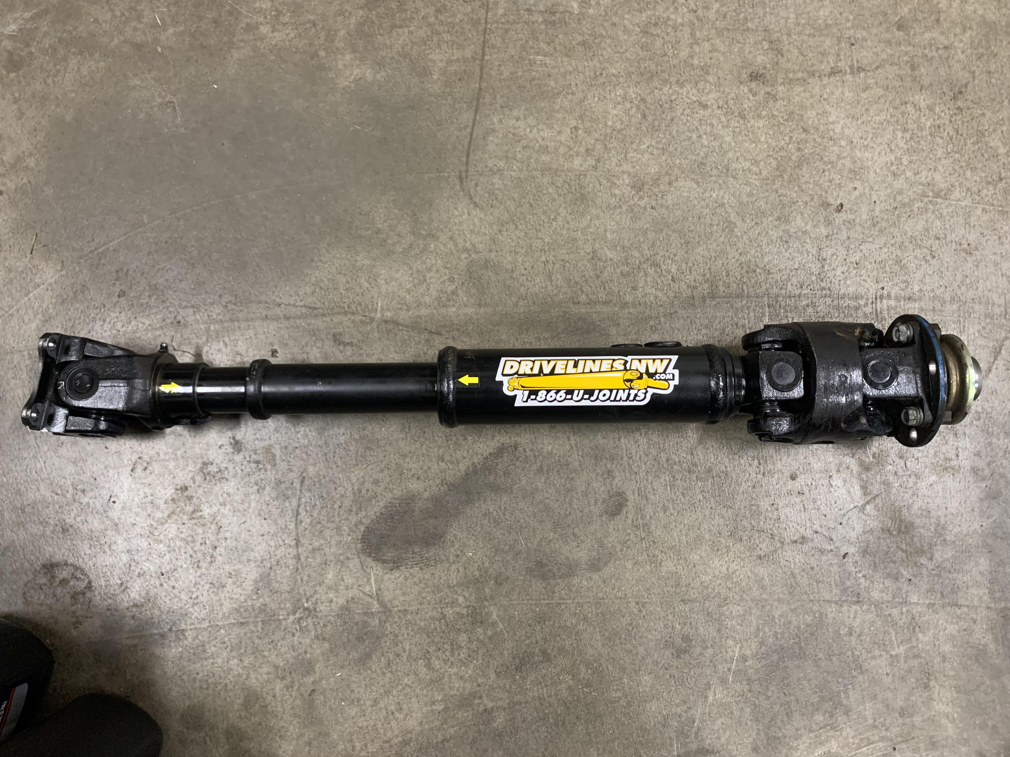

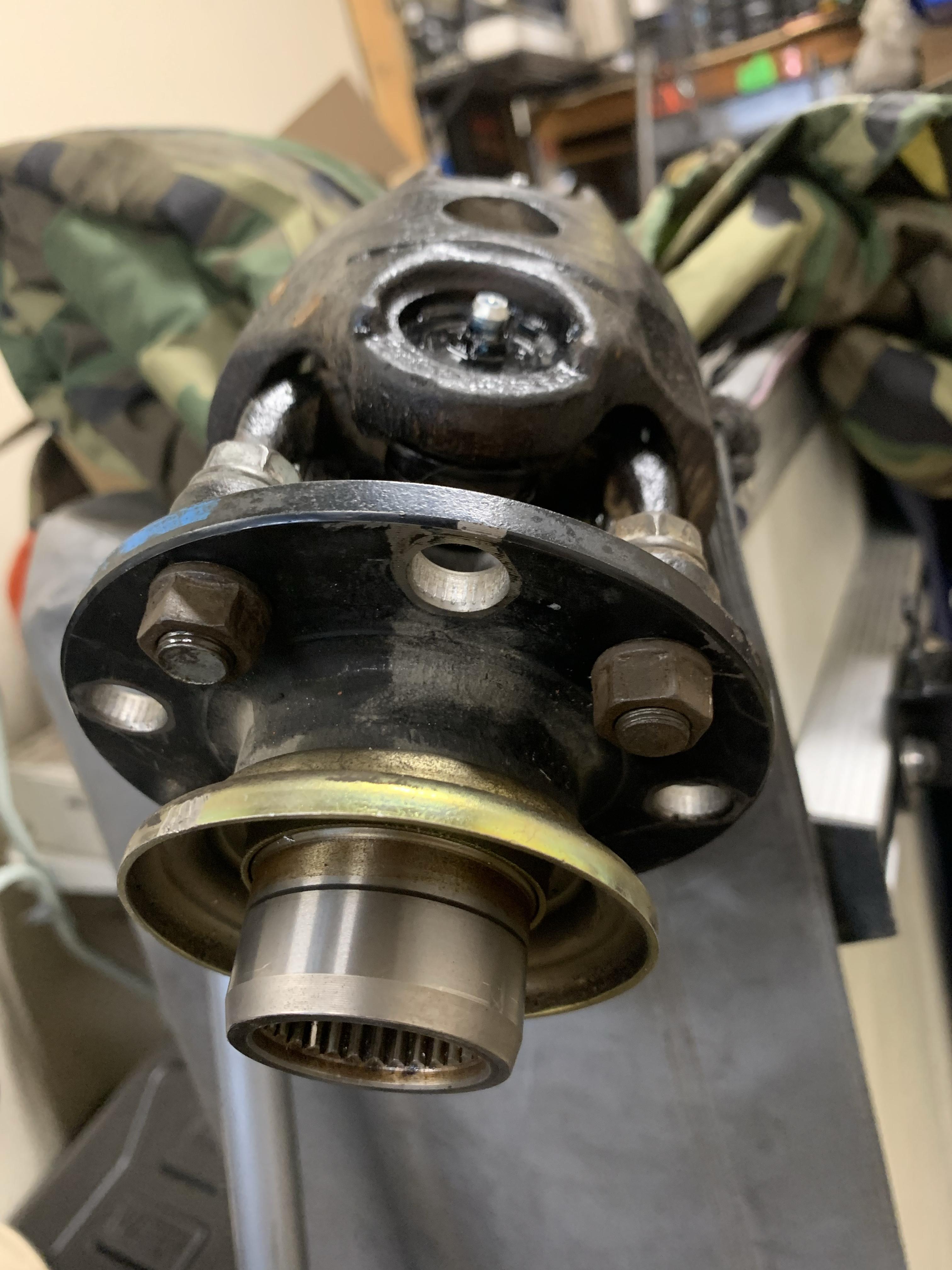

So my front long spline came in from Japan and I dropped it off to my local driveline shop in Fife. Drivelines NW is where I went, so I’m just waiting for the shaft to be done. The front longspline of the shaft is brand new. The extended shaft is .095 wall metal and the Double Cardan is a original 85 and will have newly installed u-joints. I was going to buy a whole new DC, but choose not to and just rebuild the one I have.

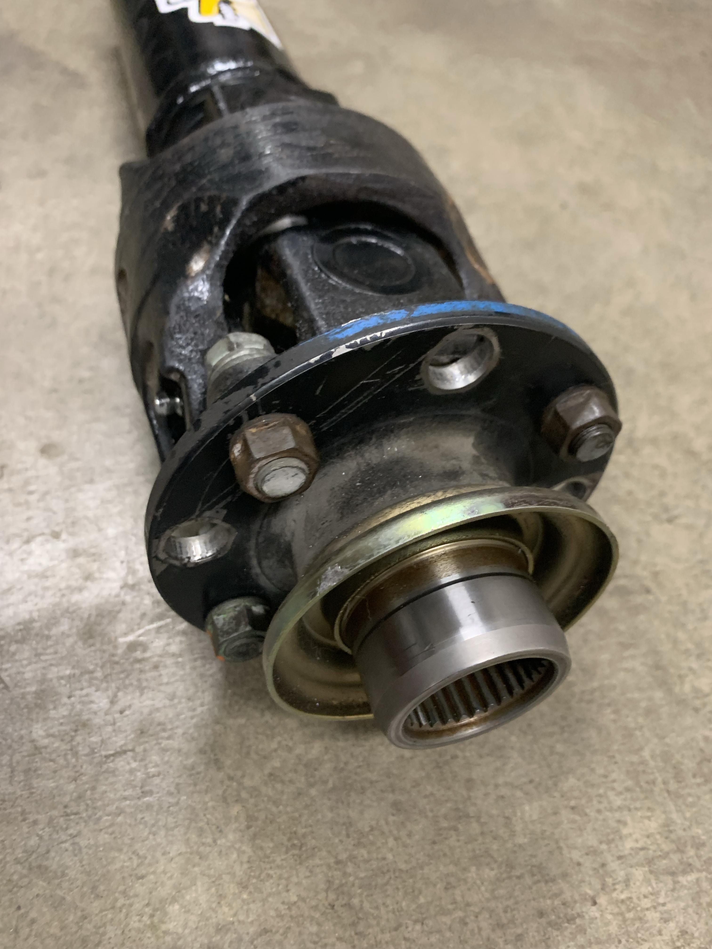

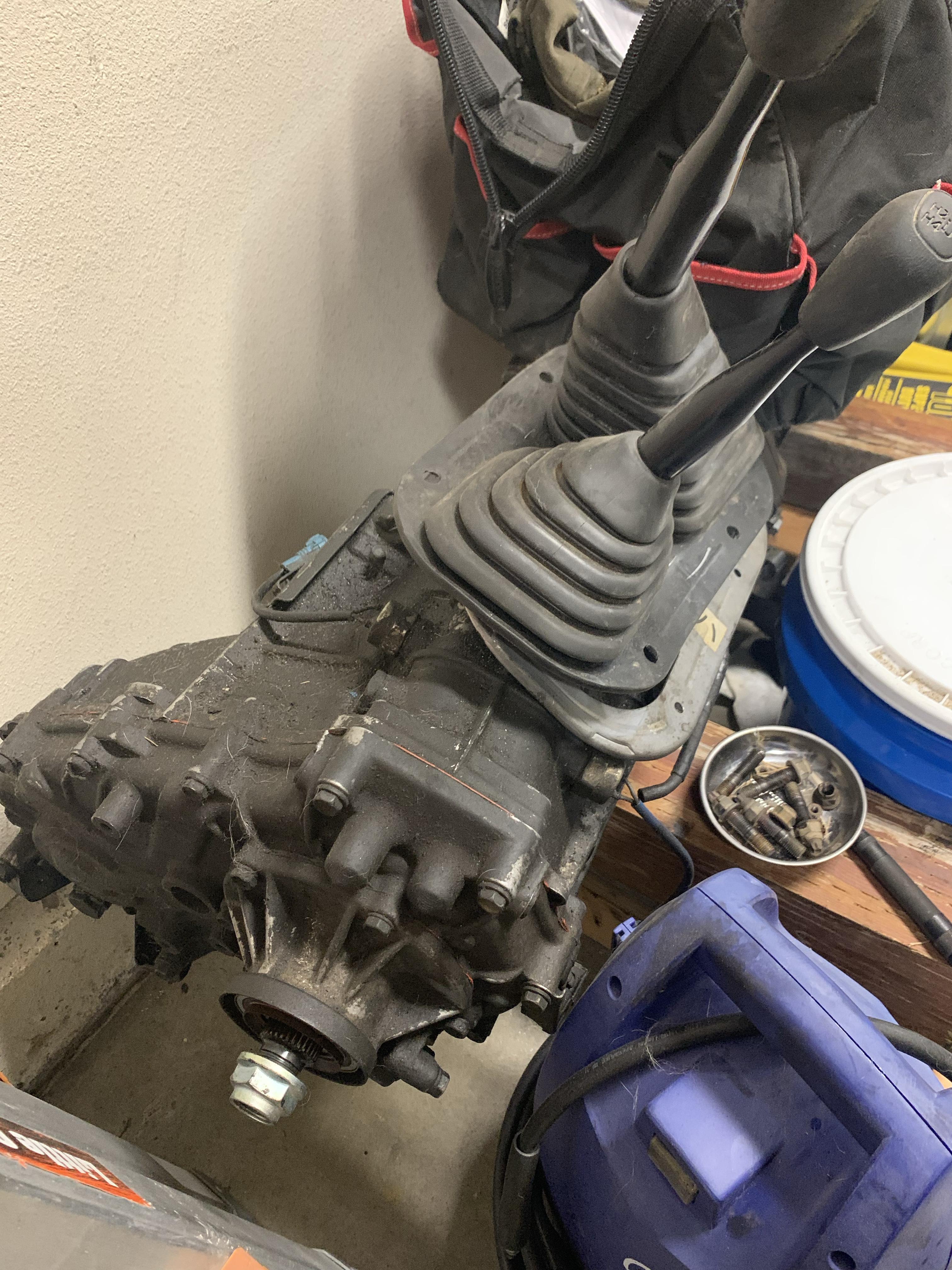

Finally received my long spline front driveshaft from Drivelines NW, Inc. I didn’t realize the flange on the backside of the t-case is 60mm x 60mm. The flange on the back of the 85 shaft is 60mm x 68.3mm. I went to my extra 5speed t-case and removed both front and rear flanges to see if the splines was the same. It is and the rear flange is 66mm x 66mm with a 11mm hole. I took the rear flange and drilled 4 10mm holes for a 60mm x 68mm pattern. Didn’t have to spend money on a triple drilled flange.

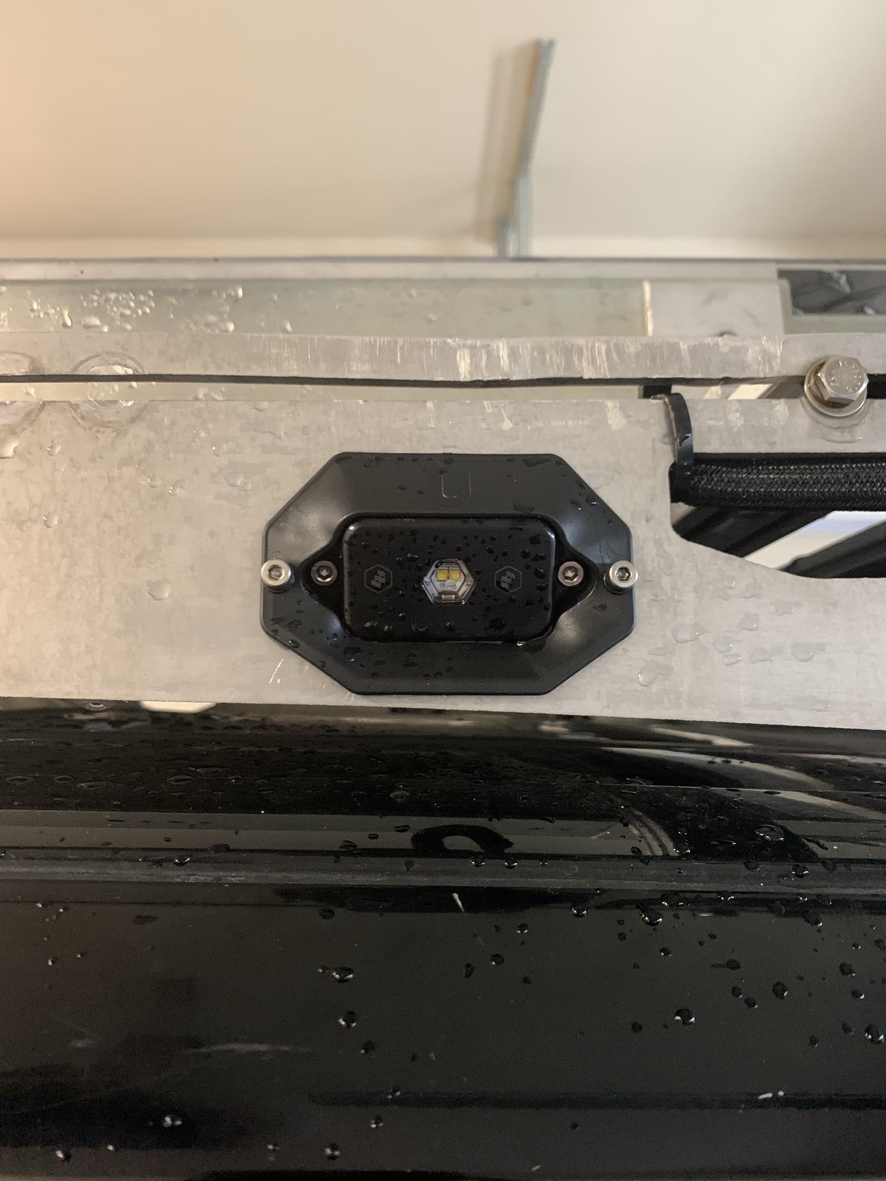

Finished installing my Baja rock lights (4) on my Sherpa Matterhorn rack and my Infinite Offroad 12watt extra large Shadow Reaper RGB+W Rock Light Kit. I only ordered 4 for all wheel wells. I think I’m going to order 8 of the 6watt magnetic ones. These lights are bright!

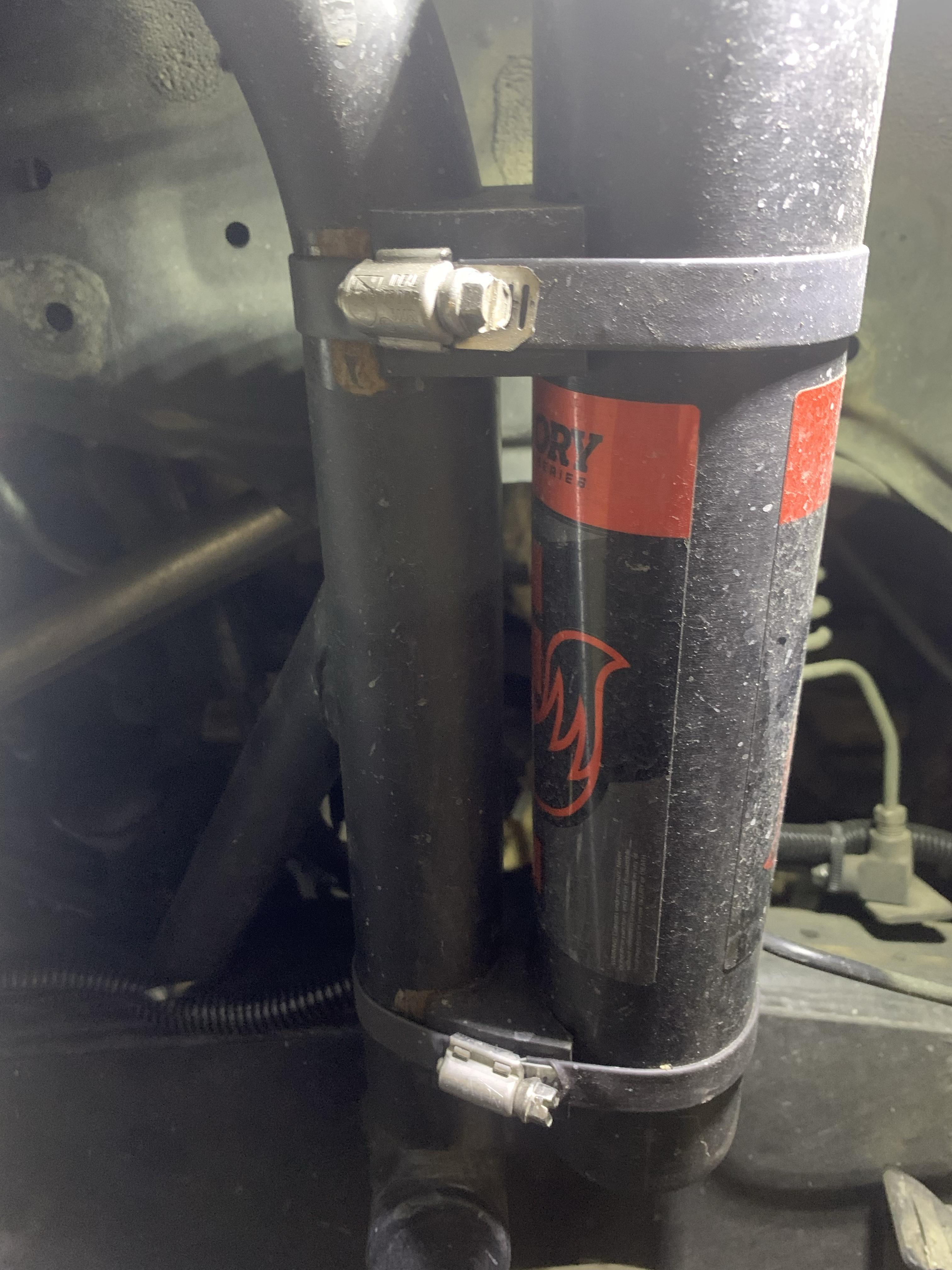

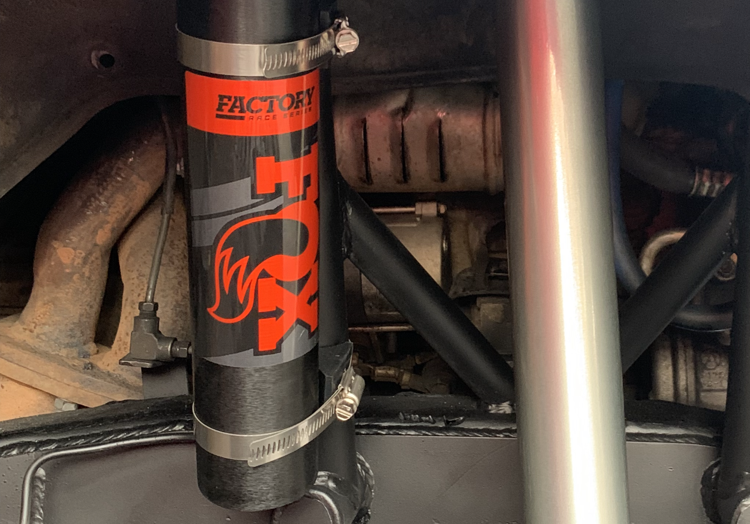

Something to share if you have Reservoir shocks. My rear Fox shocks came with a clamp from fox that holds the reservoir to the shock, but my front shocks came with a rubber spacer and two clamps to hold it together.
Now this is a thing I learned back home in HAWAII when I used to have a Hot Import Race/Car show 95 Honda Hatch w/a JDM TYPE R block running10’s in the mid 90’s. Street legal, full interior with a 150 shot of dual stage Nitrous. I competed in Hawaii’s Fastest Streetcar Shootout in 97 and took 3rd in that event.
The clamp is covered in heat shrinking wrap. I know it’s stainless, but it’s on to prevent the stainless from scratching the reservoir. It’s the little things. I just wanted to share. Alojah people and have a safe and blessed rest of the year. [emoji1686]

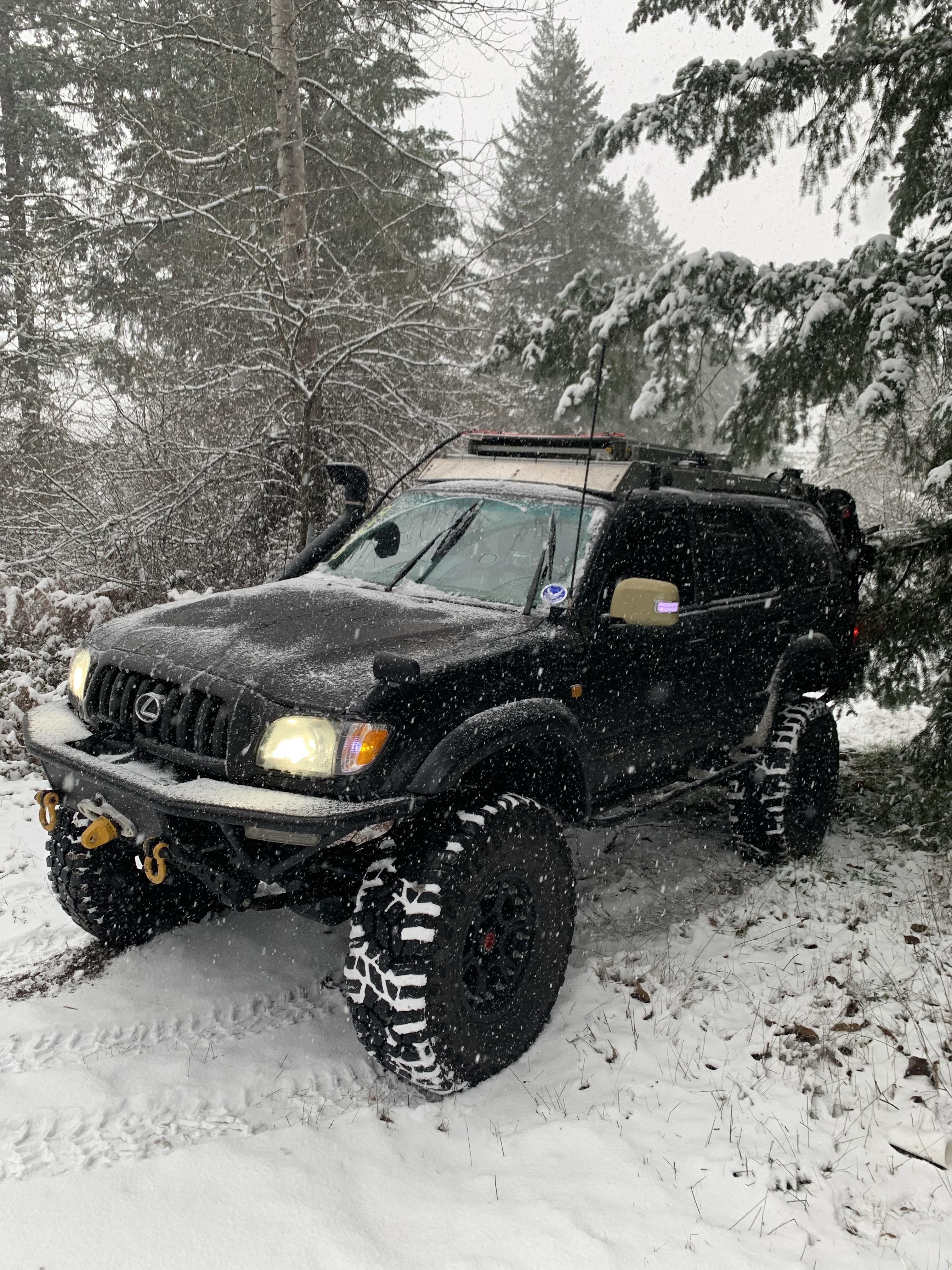

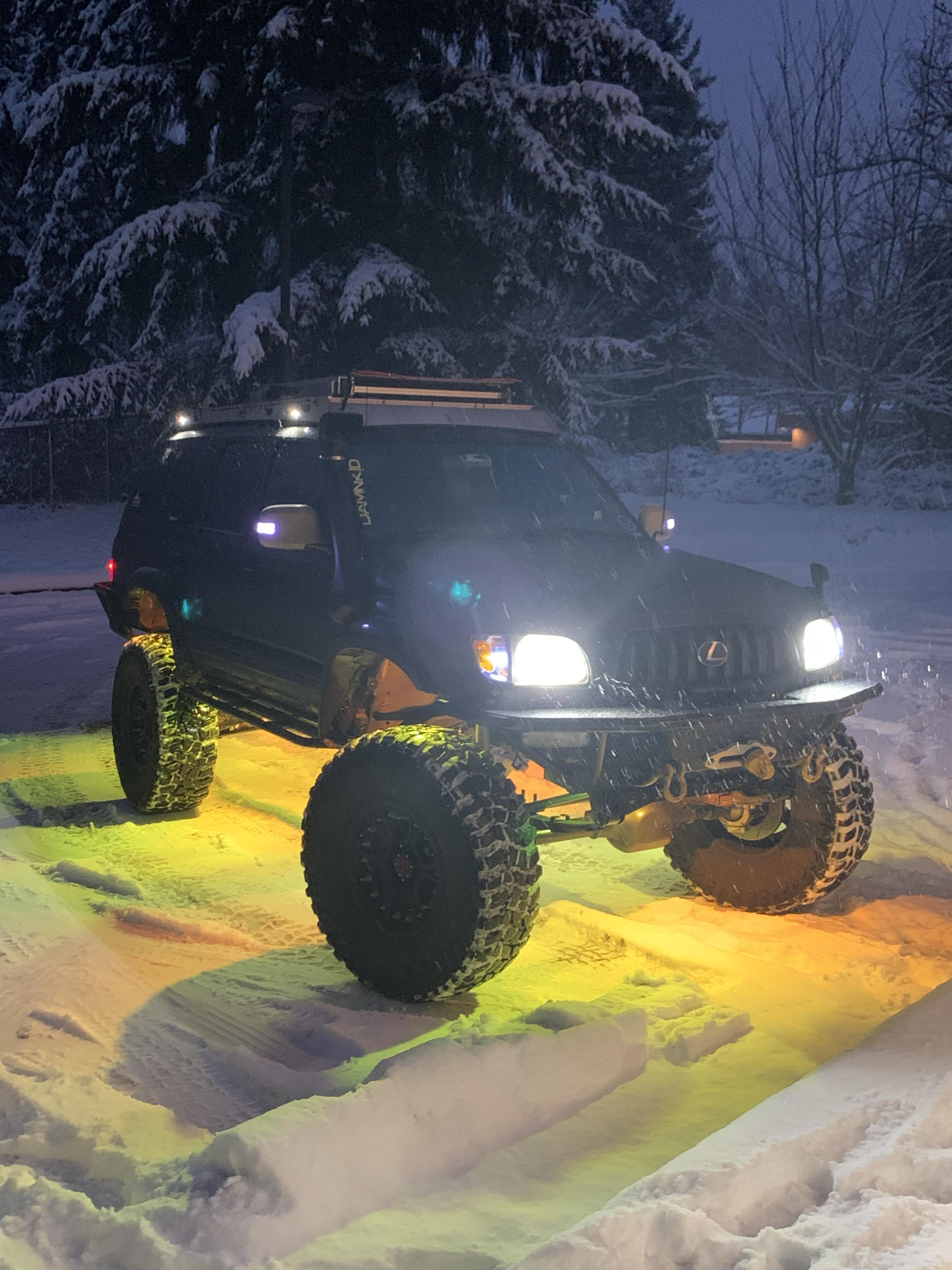

Took the truck in the mountains to do a shakedown run. Truck did good in the snow and stuff. Was wheeling in about 3 feet of snow on the top of the mountain. It would of been deeper if it didn’t rain all last week. I only took pictures coming down the mountain because I didn’t have the proper gear to jump in the deep snow and I didn’t feel like being wet.

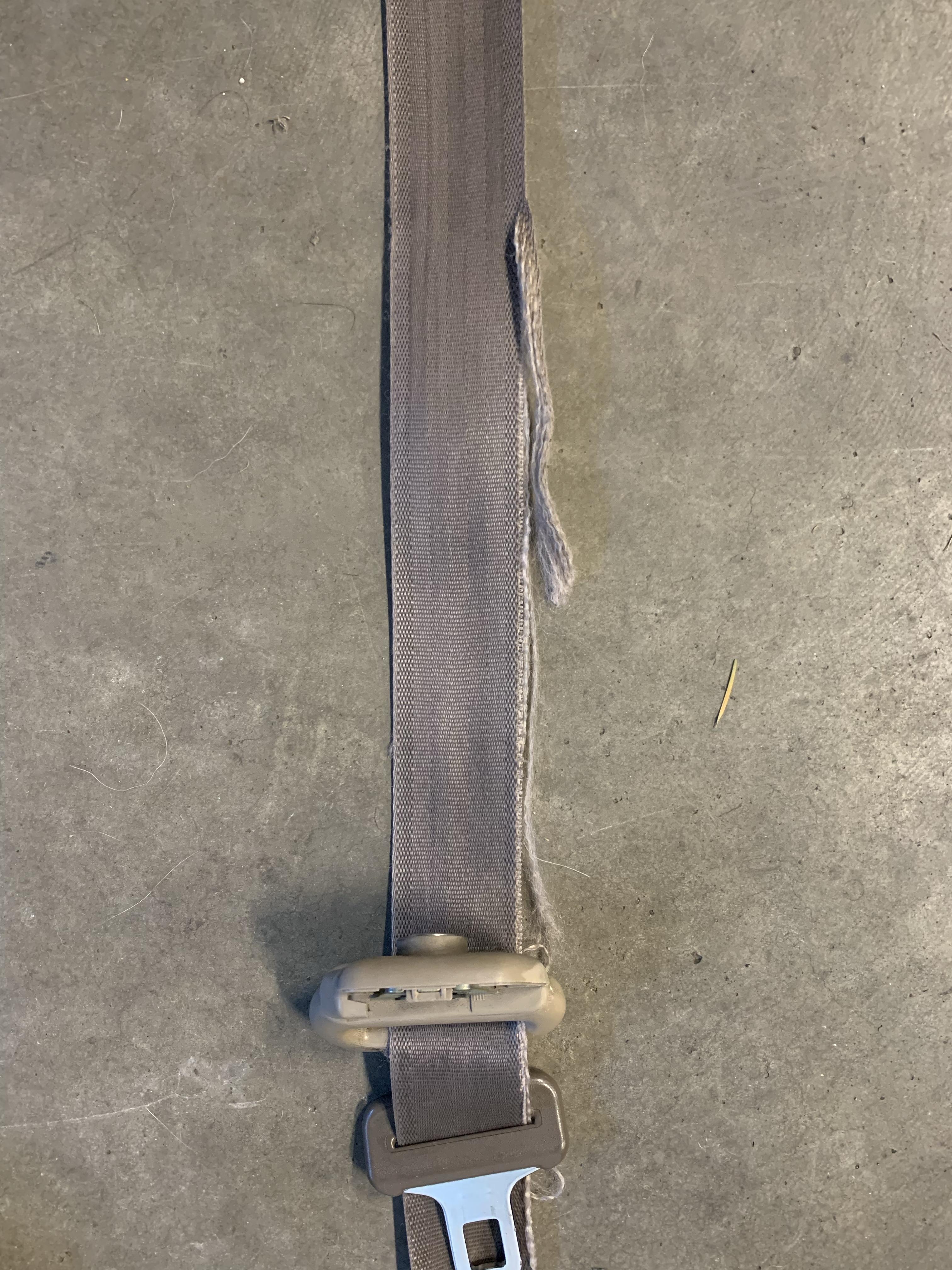

Fixed my drivers seatbelt because it was fraying a lot. I cut off the frayed part and it immediately started fraying again and it was getting hard to move the buckle up and down. I found one local to me for $20 and in great shape. Also not stained or molded. Here’s a picture of the frayed part.

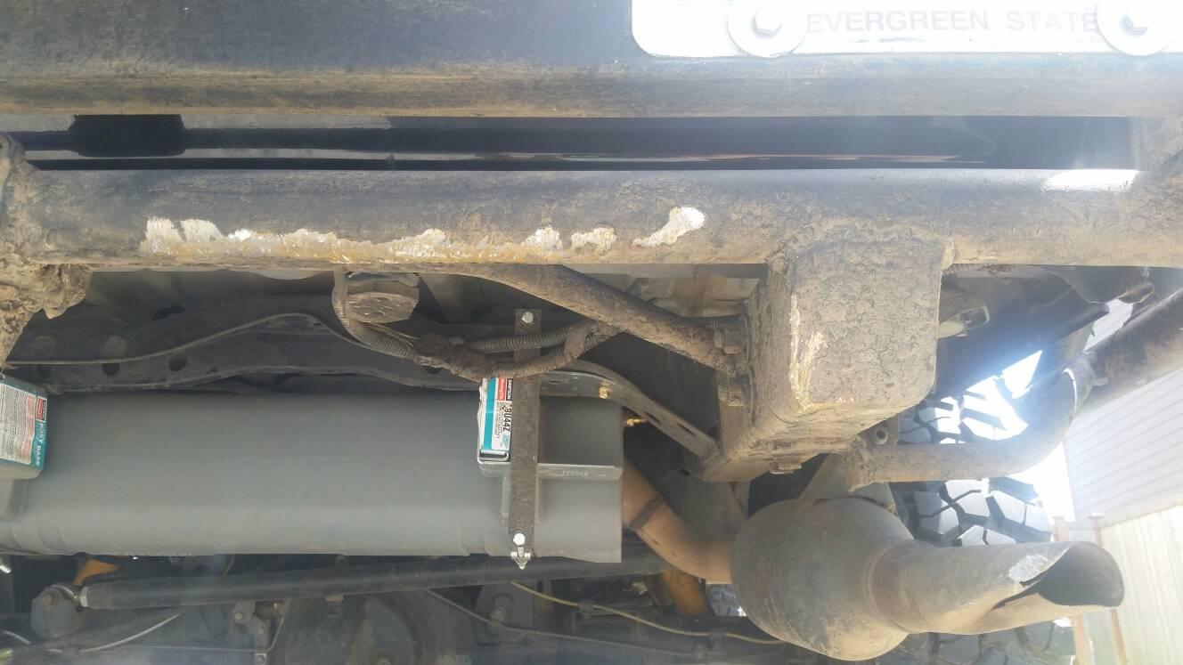

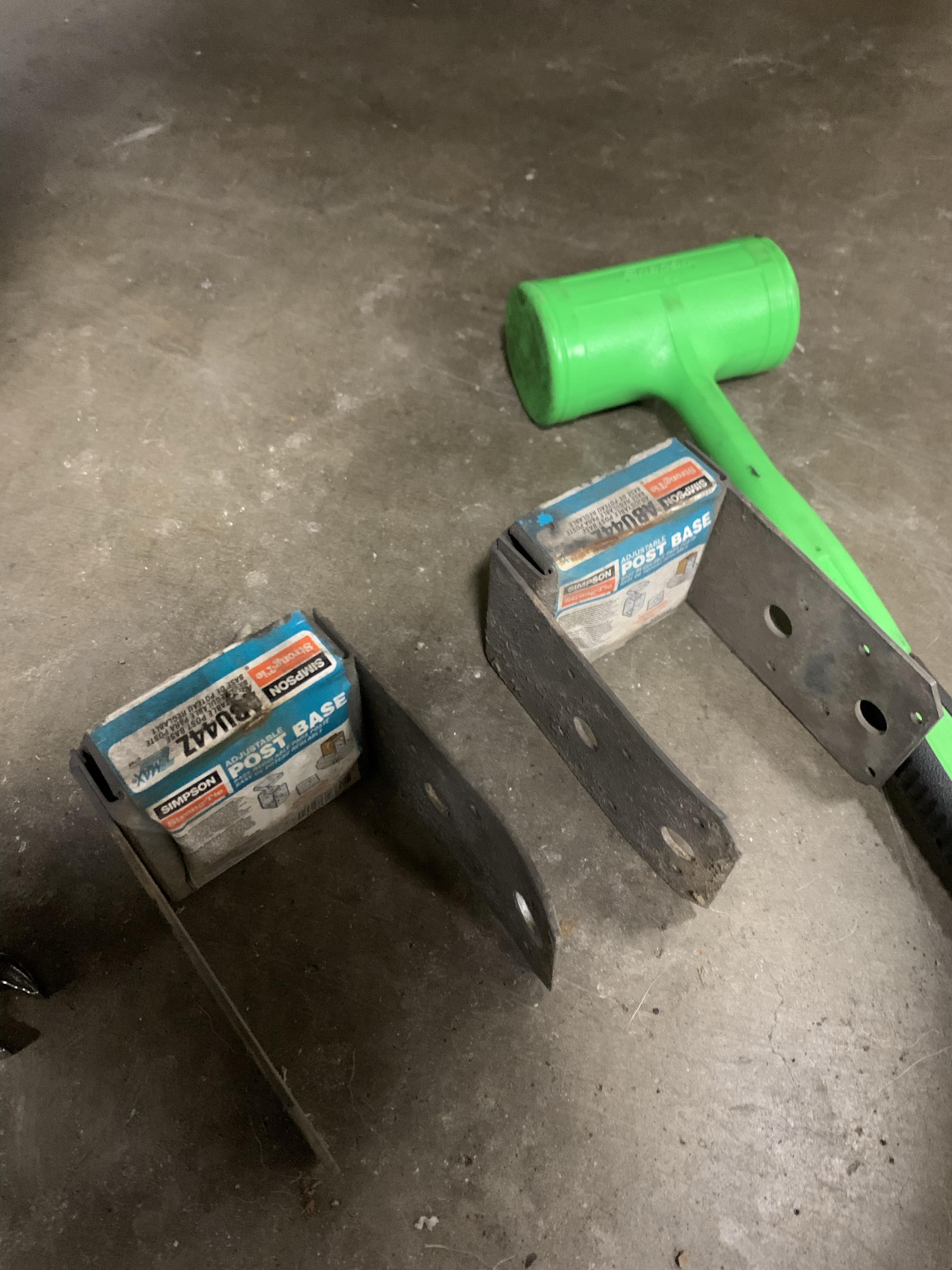

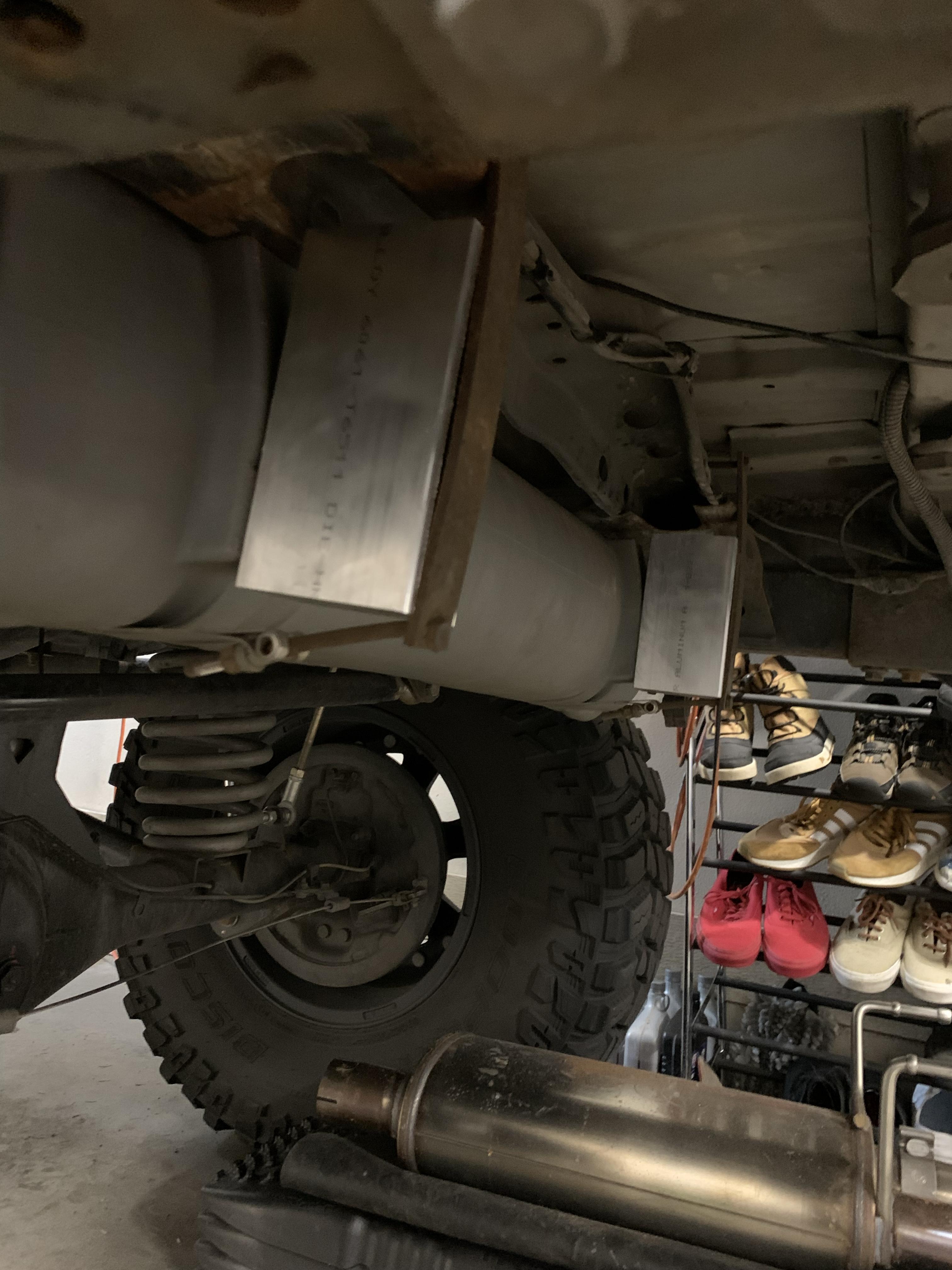

So I went back to skool to finish my projects that I didn’t finish. Since I had my rear water pressurized tank made by WaterPort. I got it in 2016 when they first got started. I got it a few days prior to the Northwest Overland Rally in June of 2016. It came with a D clamp and it was meant to be strapped to the frame or there was a bracket that was offered to mount on the frontside of the bed. I didn’t know better at the time, so I went to Lowes and looked for a bracket to mount my tank. A 4x4 wood bracket was the closest thing that I made work and it held up during wheeling and daily use. I finally made a bracket out of 6061 Aluminum. The flat D bracket is about 8 inches long and an inch wide. I notched the 1.5 aluminum bracket an inch wide to sit in while being tightened. I might make another set with revisions. The one I made looks good and works.
The old
The new
