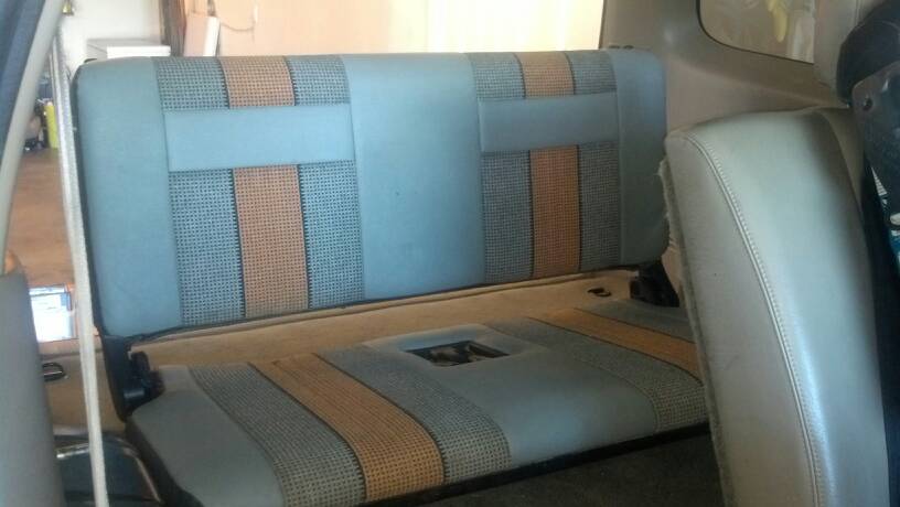

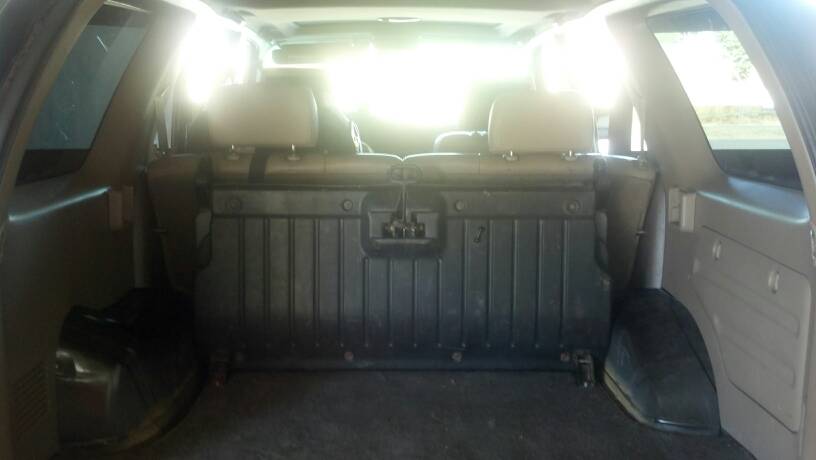

Installed and extra Seat from a sidekick/tracker rear bench. Going to build a sub/storage box on the L side and a low storage box on the R wheel wells.
This would help me ride with my four kids and the Dog :confused: Comfortably. How did you attached the seat to the Truck. This is definitely my next mod. Would save some Serious Bickering also...

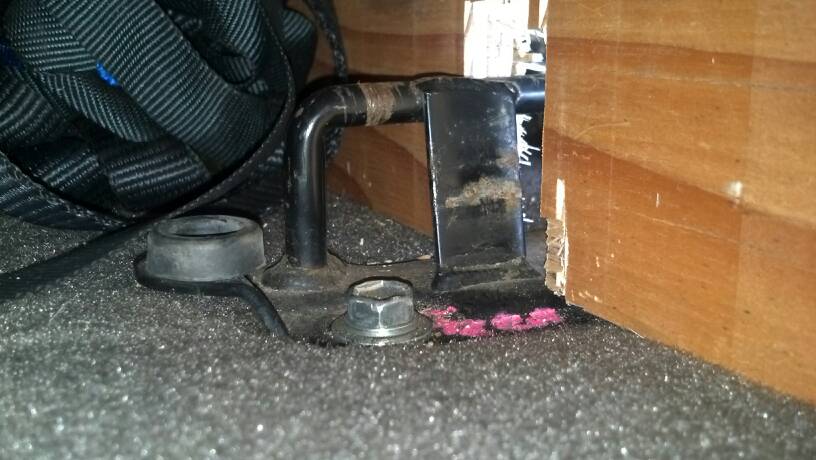

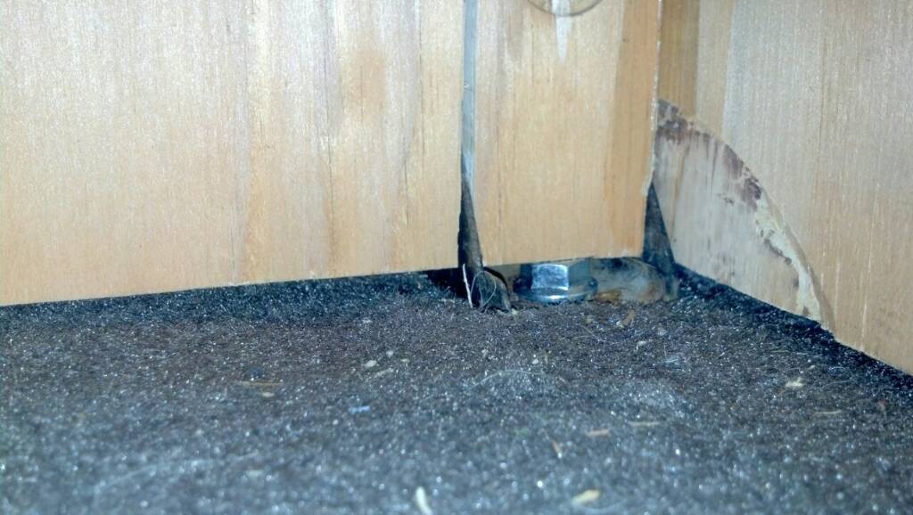

I used the stock mounts to mount it to the truck. I'll take pictures tomorrow.

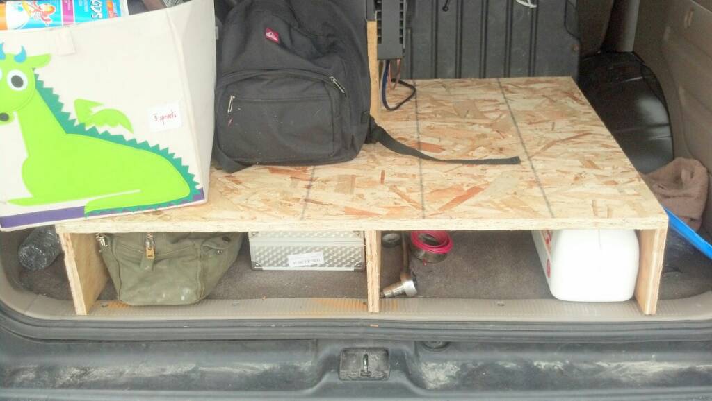

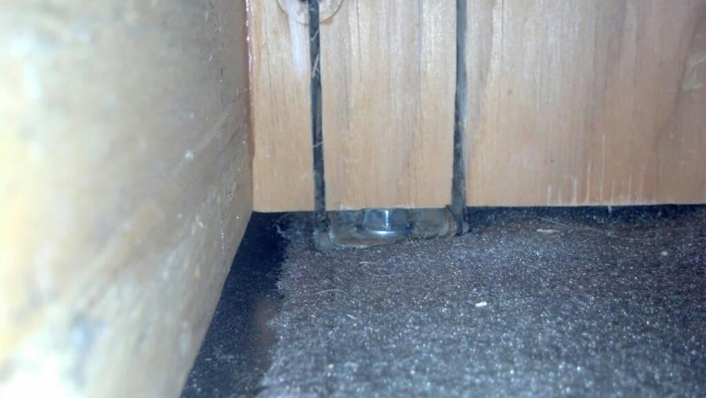

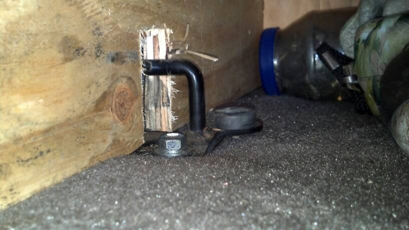

Ok here's the mounting points of the seat. I currently have a home made storage currently in the rear, so sorry for the junk pictures.
Storage
Left front bracket has 2 points(forward&backward), but only showing the rear point.
Right front bracket has also 2 points (forward&backward), but only showing the rear point.
Rear middle bracket has 2 points side by side.
Left point
Right point

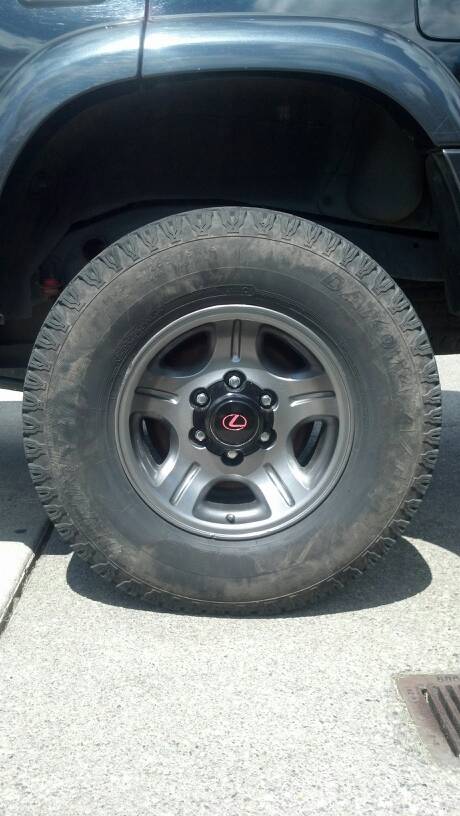

Painted the 2 rear rims. It's hot outside and I'll finish the front 2 tomorrow. I'm going to take the kids and jump in the lake.

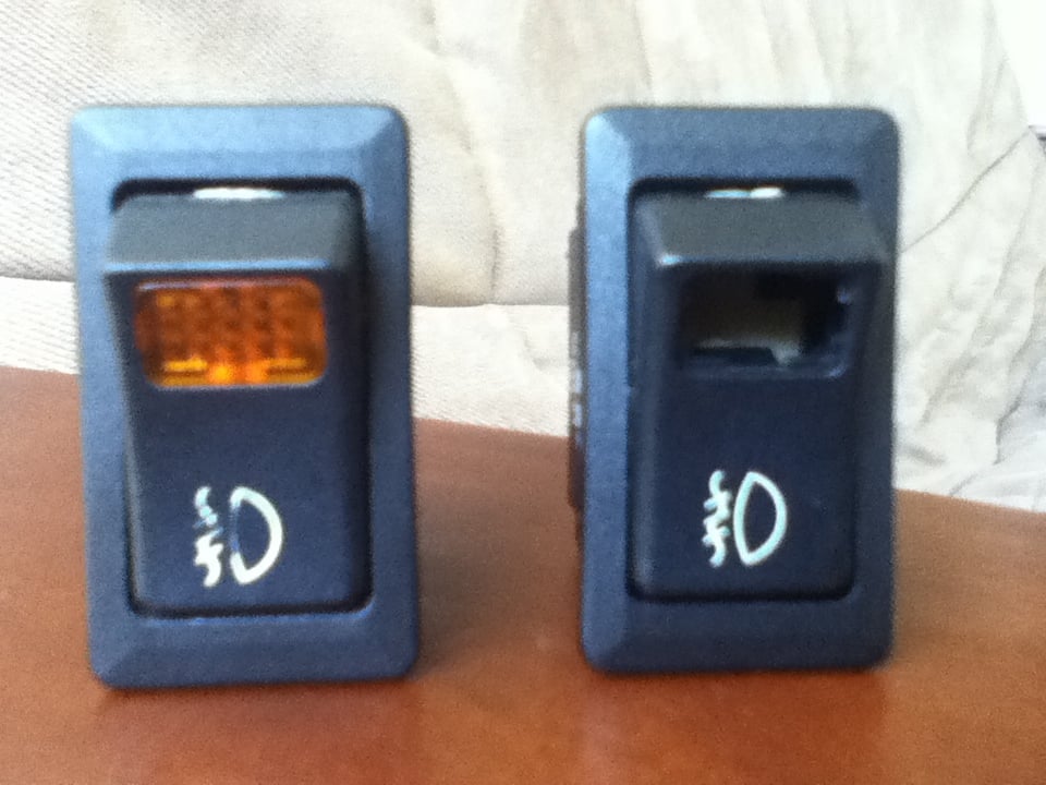

I'm curious about the lexus headlight switch. I have a 2000 SR5 I'm going to add fog lights to and I have the same switch from a 2000 Camry as a donor. Was the switch plug and play? What happens with the lights when the switch is in the auto position?
Thanks
A bit of searching reveals runner headlight switches 96-99 are interchangeable and 2000-2002 are interchangeable. Does anybody know anything different than this. The 2000 Camry switch I have appears to be applicable in a runner 96-99. Also does anybody know what other switches with fog lights work in a 00-02 Runner?
Installed a reverse light that I got off a Mazda 5. Made in Japan and Kyoto brand. Big difference in lighting. Used 1 of the OEM foglight switches I had. Didn't know how to wire up the wires to the foglight stalk switch I installed.
