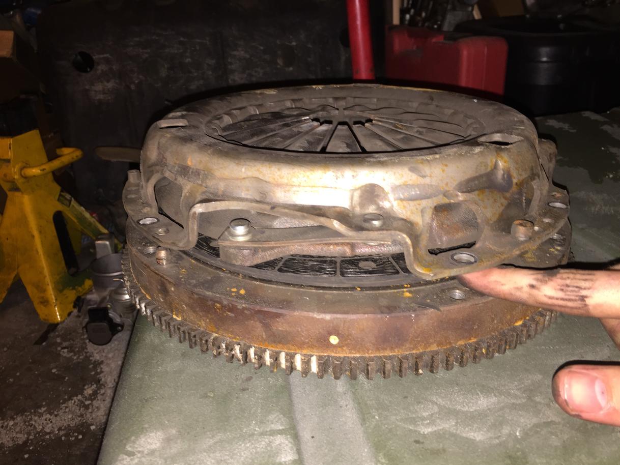

The clutch fork doesn't feel right. Granted I don't know what it should feel like but it doesn't feel like it did before I installed it, that's for sure. It just kind of clanks when I move it back and forth. Maybe the slave applies a lot more pressure but I don't want to force it. Tell me how I can make sure its working properly before I go further.
I suppose this might be perfectly normal if the throwout bearing is now snug up against against the diaphragm springs, but it gave me that sinking feeling....
Uh-oh. Danger, Will Robinson.
Do you have the slave cylinder bolted on and how does the pedal feel? Did you have the clutch fork snapped on the pivot point?
No, neither of those. I just panicked when I fiddled with the clutch fork by hand. I only have the tranny bolts all in and torqued, nothing else connected. I'm sure the fork is still mounted on the pivot. I panicked because I couldn't feel the release bearing sliding back and forth like I could with the tranny out. But after thinking some more I calmed down, and figured that is probably normal when its installed. But confirmation would be nice.

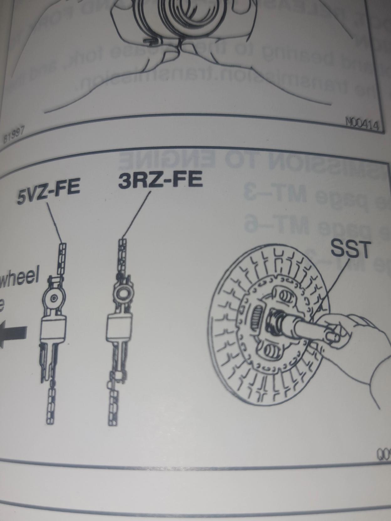

But then...my overthinking brain started wondering if I put the clutch disc in the right way. If I am to believe some older threads here, that state the springs should go IN on the v6 3.4, then I did it wrong. But I am not convinced of that. I had no trouble getting the pressure plate on, and I definitely placed the T/M side OUT. But according to the threads that is wrong, but don't believe it. Maybe its wrong with the factory pressure plate but I can't believe Aisin has been marking their disc and pressure plate kits wrong all these years.
3rd gen 5vz AISIN clutch nightmare F-up
This pic shows a disc the wrong way, and the pressure plate won't even go on. I had no such trouble.
Maybe hooking up the slave and testing it should be my next step? I'm in no hurry because the rest of my parts don't come until later next week, so I can afford to be careful or even drop it again if I have to. But I will need a darn good reason to do that, lol.
152747d1428532728-help-stupid-clutch-disc-question-b178fc27-2804-4fa6-b28f-0d682a9d8dfbd1b3d35e-374b-4826-a7e9-a9cb315d2e2d-jpg
The clutch can go in the wrong way. The Factory Service manual shows this the proper way. As that is correct if wrong it won't go together properly.
I don't have an FSM for the 4runner but I found the page for the Tacoma
here 3.4 V6 Clutch Orientation - Important! | Tacoma World
and it looks like my tranny has to come out again.
I was hoping it would. This has been so much fun I really wanted to do it again. :target::israel::clap2::mod:
Looks like Marlin had theirs marked wrong at one time too. Marlin Clutch Disc Orientation - stamp on disc does not agree with FSM
Its really inexcusable that Aisin is still marking them wrong for this engine, at least 7 years after the internet knew about it.
These clutch kits are for many vehicles. The FSM shows the clutches go in backwards on the 4 runners. I suspect you didnt take any photos when taking the clutch apart. Marlin used to have the FSM photos with their clutch kits showing and warning of this issue in the 4 runner.
I included a photo from FSM.. I hope this helps you. I know I remember my mistakes more then my success.... :-)

The only thing I found askew other than the backward disc is one of the pressure plate lock washers had opened up and spread out to an unsafe degree, and I failed to notice that when I torqued it to 14 ft/lb. So it's probably a good thing I put the disc in backward, because that washer would likely have failed eventually and the bolt would have been very loose. So I just need to find a washer. Think I will also buy a new torque wrench just to be safe. I calibrated mine last year but I doubt my calibration was perfect.
