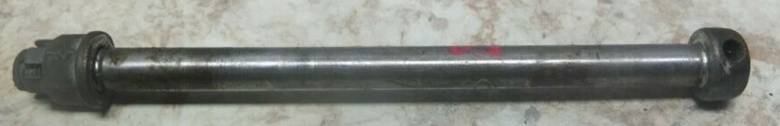

For installation "rails" I have used, to good effect, a pair of axles from a small motorcycle. Most any 50-175 Honda/Yamaha/Suzuki/Kawasaki has a 12mm front axle with 1.25 thread. These are plentiful on eBay.
The photo shows such an axle with the nut still installed.

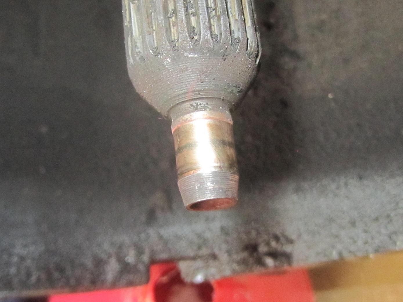

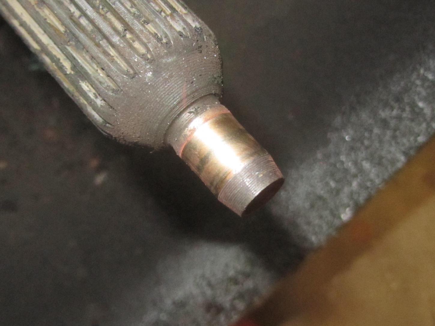

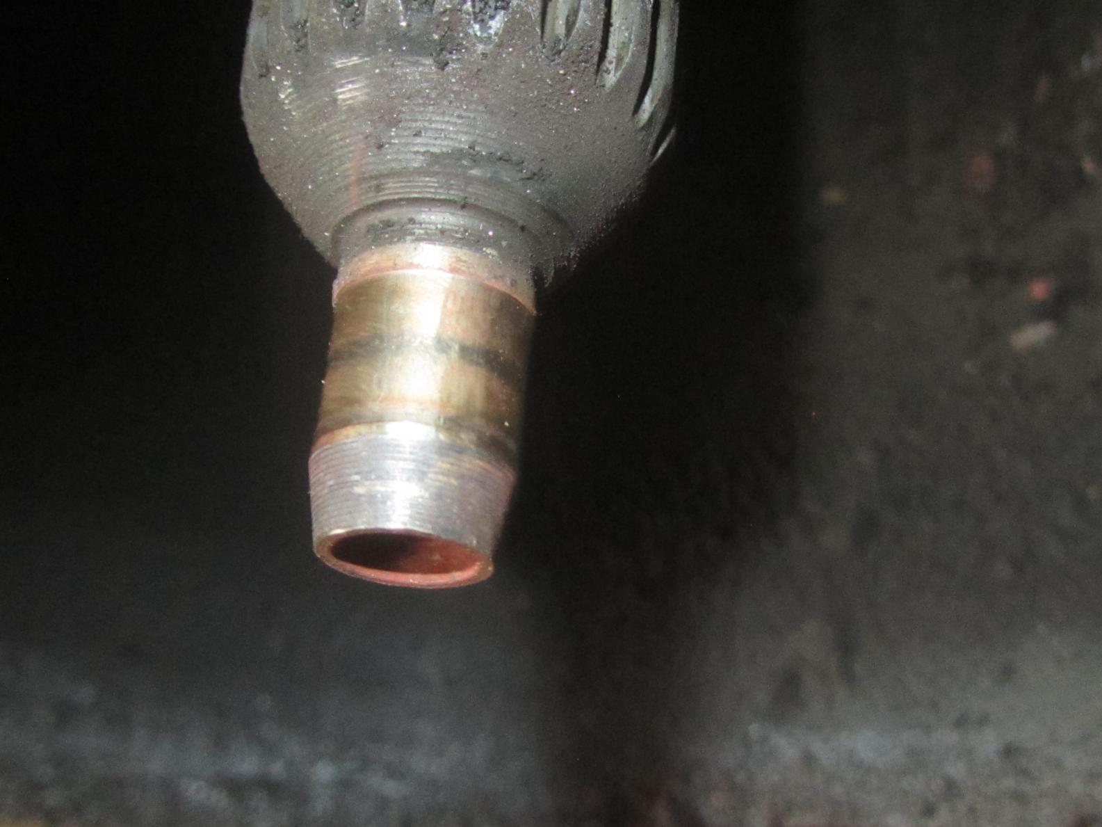

How does the transmission input shaft look? I've seen some with wear on them where they touch the pilot bearing.
I think it looks decent to good considering the miles. It certainly isn't "chewed up"
At some angles it looks like there is more wear than I think there is, due to lighting, and it disappears at other angles. My fingernail doesn't feel much but I do think there is some minor wear. But that's my uneducated opinion

Clean that up really well and check it out. Its probably fine. You want the splines clean of build-up before putting on a very thin film of grease too.
The area of most concern is not there at the pilot bearing, but back on the snout that the throw-out bearing rides on.
Make sure you use an OEM TOB if that hasn't been mentioned in the thread before...

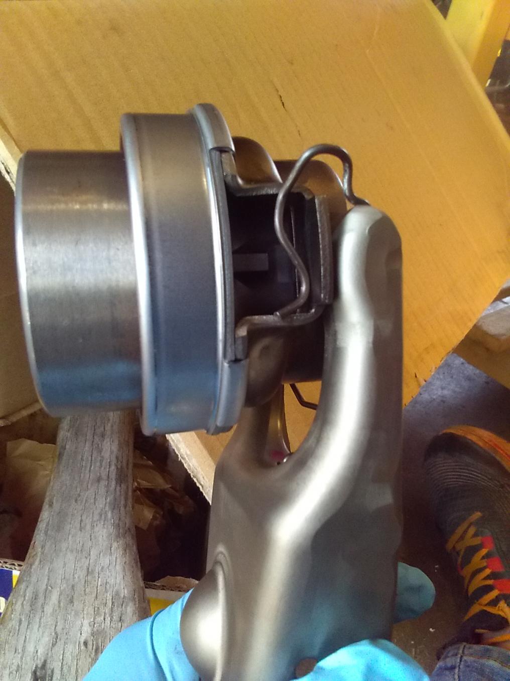

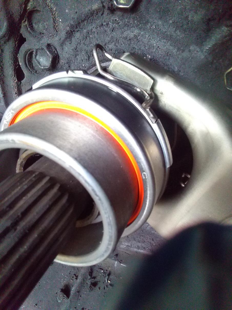

So now I have the release bearing and fork properly and lightly greased and in place, but something doesn't seem quite right. It seems to work as it should, and I know the fork is on properly, but that clip on the bearing worries me. Gotta do more fiddling until I'm 100% certain. May have to post a video later if it doesn't start reassuring me.
Here is the question I'm encountering. When the fork is in hand, its easy to bring the retainer clip all the way onto it, like this:
In the picture above, the end of the clip is almost flush with the tines of the fork.
However, as seen in side view above, then the wings of the TOB don't ride on the rocker surface of the tine. So that must be wrong (right?).

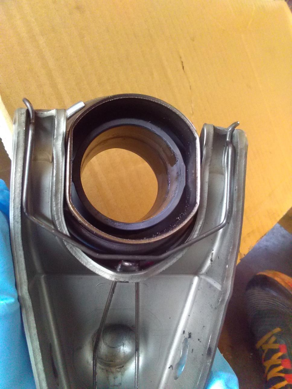

When the clip overhangs the ends of the tines a bit, as below...
...the clip looks awkward but the tines and wings line up properly. This seems to me to be the right way, but when I move the release bearing back and forth when installed in this position the clip wants to work its way off. However I might be moving it farther than it actually moves when pressing the clutch, so maybe I worry about nothing. But I'd rather worry now and get it right than have to do it again!

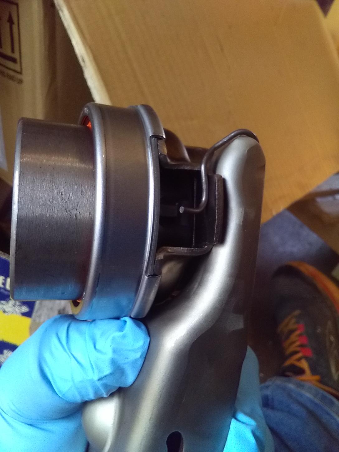

Here's the way it looks installed, the way I think it should be, with the clip overhanging the tines as in the 3rd photo above
