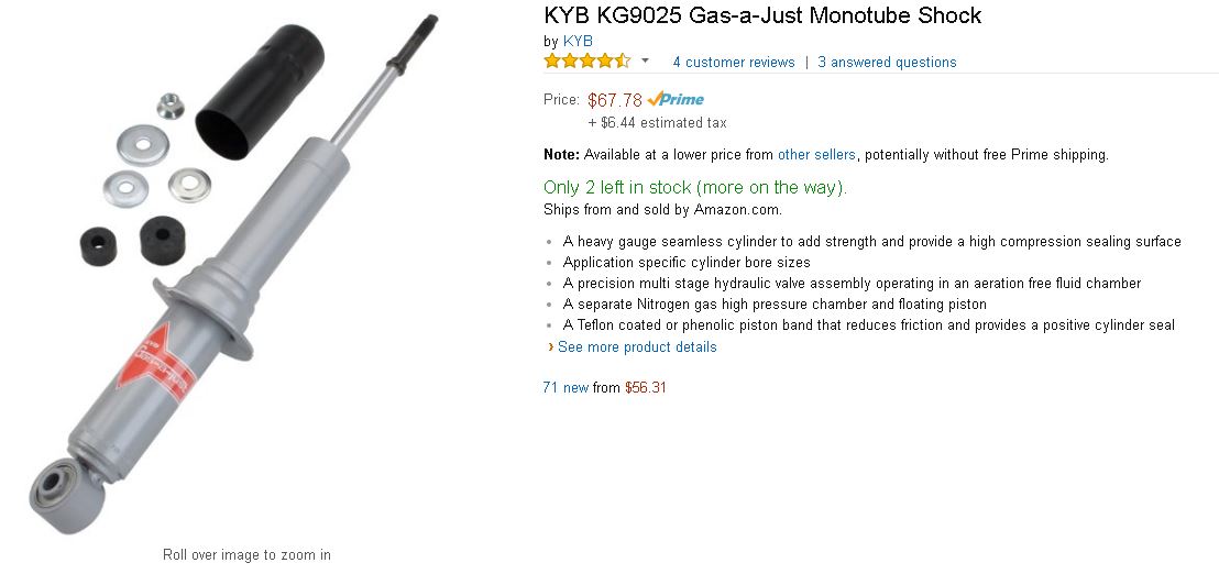

Other than the Bilstein 5100s - any other front shock (budget wise) you can suggest to pair with the front FJ coils?
Currently, I am looking to get these:
90% paved 10% mild off-road for camping/snowboarding trips
Thoughts?

I have always liked gas adjust. In the 2nd page of this thread, you will see I had them on the silver gunner and also on my previous 98 4runner. Excellent for the cash and I have nothing bad to say about them. But I do think for the extra cash, the 5100's are better and worth it if you can swing it. However... either way you are not stepping wrong.

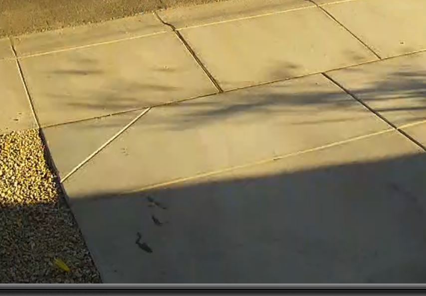

So the other day I was checking air pressure / doing general service on the silver gunner. Pass rear rim was a bit black and oily... ah hell. Looked under and sure enough - blown axle seal. :sad: :sad: :sad: :sad:

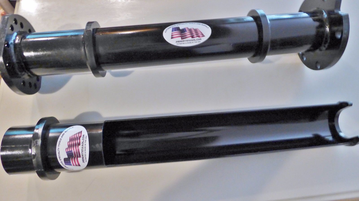

Well, with two 4runners in the stable and possible a 3rd on the way for my oldest boy, went ahead and plopped down the cash for the right tools to do axle seals easy. They were about $420 shipped. These, combined with my press tools will make removal of the retainers / abs ring and all the BS pressed onto the axle - super easy and stress free. They also save the cash of having to buy all those parts (no cutting them off or damaging them). So when all is said and done, all I need to buy for the job are bearings, seals, o-ring, new shoes for the brakes, Brake fluid and 80w90 (have fluids on the shelf always)
Hopefully all comes in by this weekend or at worst, will do it next weekend.
The tools:
The sign spotted on the driveway on one of my security cameras

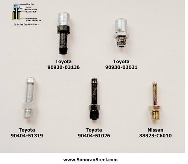

Combined with the axle seal replacement, I will go ahead and replace the rear breather and do a DIY breather mod for both 4runners as it is dirt cheap.
Here is all you need / reference this photo for a visual of the parts:
- 1qty of 90930-03136
- 1qty of 90404-51319
- some hose and clamps
As many have done, just route the line up to your gas filler neck area so the breather is inside the area with the gas cap. About $15 in parts shipped / maybe $20-25 in total with hose and clamps. I figure if I am going to replace the breathers anyways, why not. Now if I ever have to cross deeper water... I will not have to 2nd guess anything. That, and you get the function of the stock breather placed in a location that stays clean.
