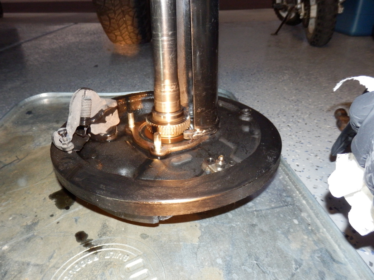

First up, axles pulled and went to use the ebay tool. Demmit... the horseshoe grabber thingy is to thick to properly grab the ABS ring. Had to use my chop saw and take about .125 off the thickness to get it to work. Told the seller about it and he promptly apologized and refunded a bit of the purchase price for the issue.
After taking the material off, the tool made short work of yanking things apart.
Another shot in the old press.

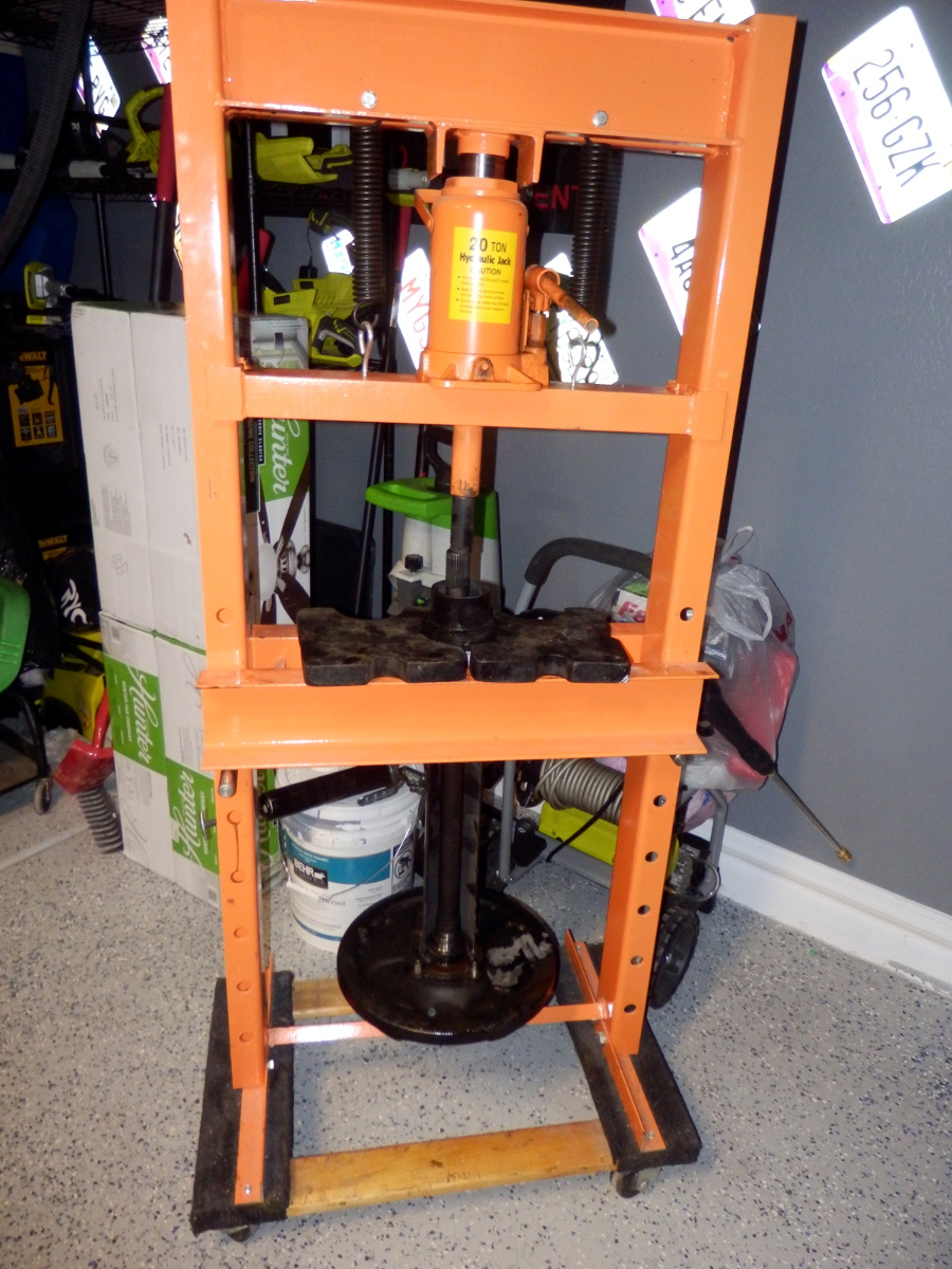

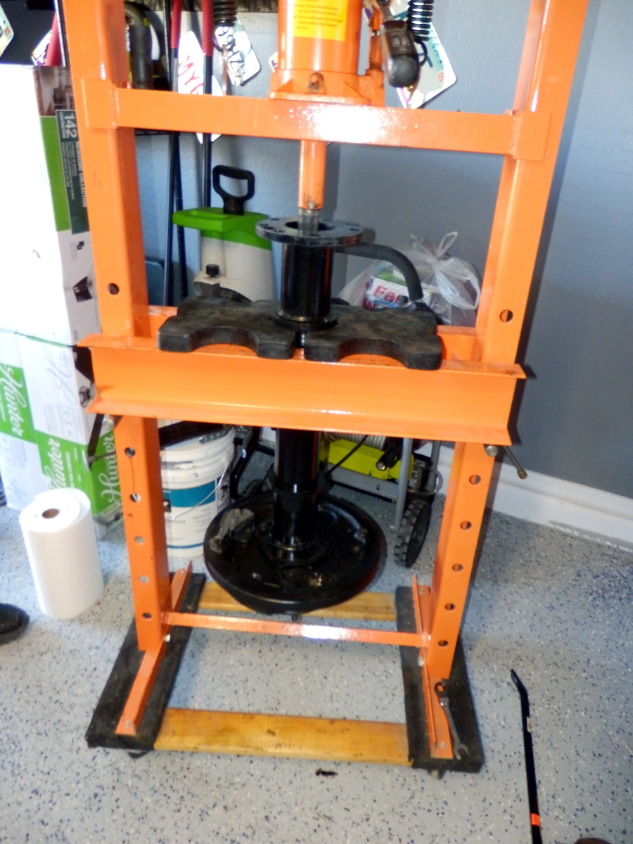

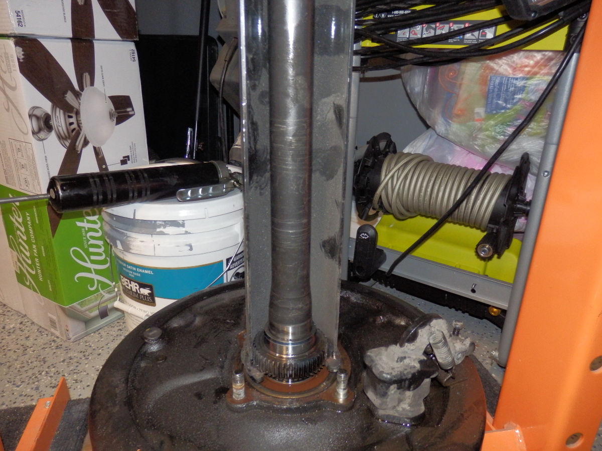

Next up, pressing the axle shaft out of the bearing. Which at the same time presses off the retainer ring (after removing the snap ring of course). I also had issues with this tool but it more came down to my 8-10 year old HF press. The opening on the press deck was only 4" This tool needed at least 5". So I had to cut the cross bars on the press deck to fit everything properly. This is not high pressure / stress work so it was not dangerous. I will be adding adjustment parts and tube later on to re-finish the deck and make it safe again.

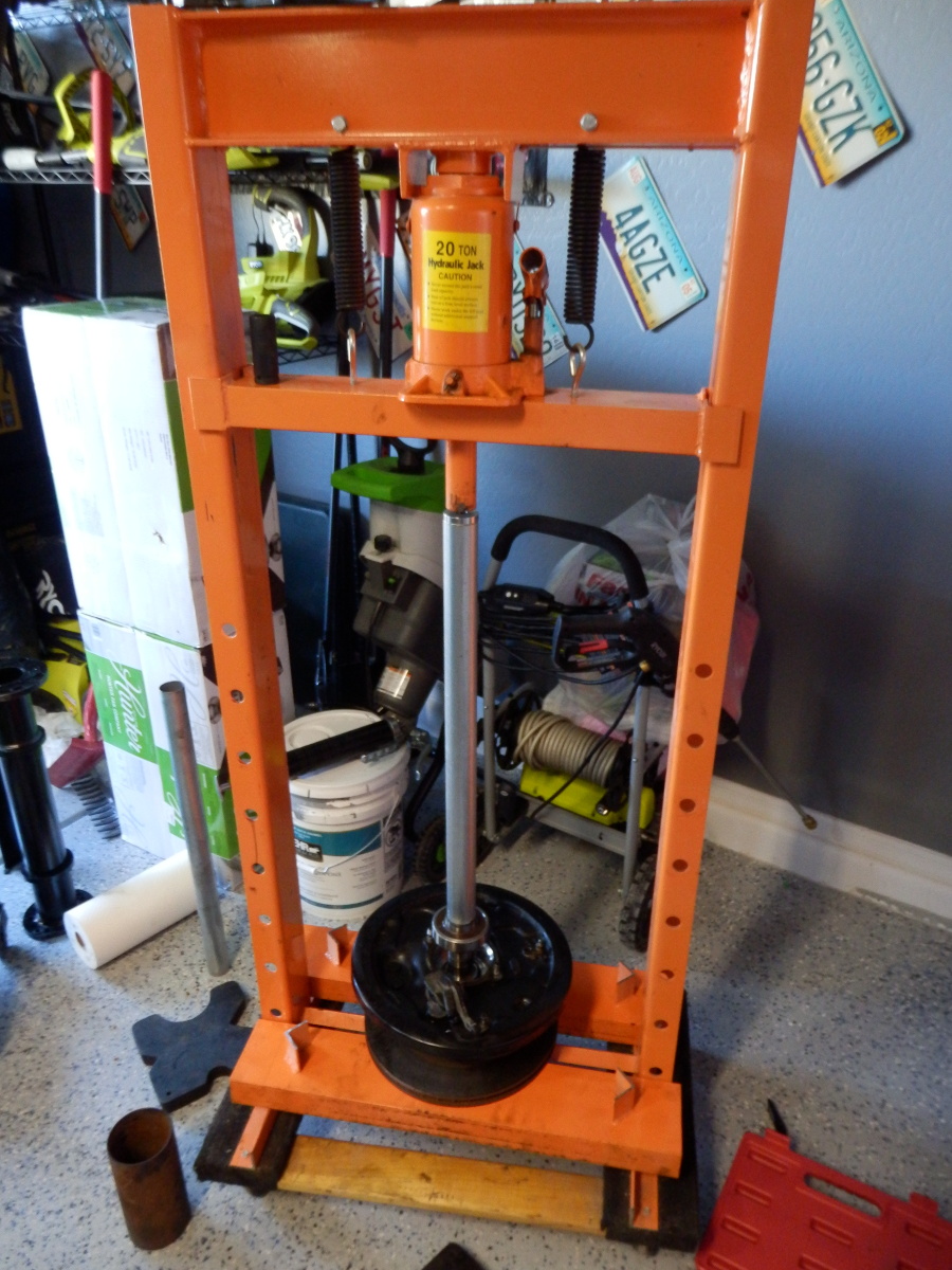

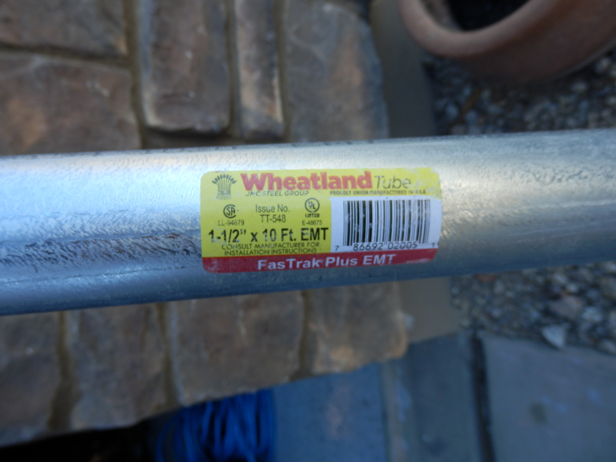

Found this steel tube at home depot. The thickest part of the axle shaft is 1.577 and this tube is about 1.6 ID! This is what I used to make a tool to press everything back together quick and easy.
Now to put things back together.... Here is that tube I was talking about - cut to the length I needed. In my HF bearing race / seal driver set, I used the 44.5mm as a press cap on the tube. It was a flawless fit like it was made for it. You can see it on top of the tube Nice! Also notice the newly modified... press deck sitting on its sides at the bottom of the press. This allowed me to use the rotor mount trick below. Just to reinforce the statement... these little tricks are for low pressure press-work only like seals, retainers and such. Setting up the press as pictured for doing something high stress with the press decks sitting on the bottom legs is just stupid.

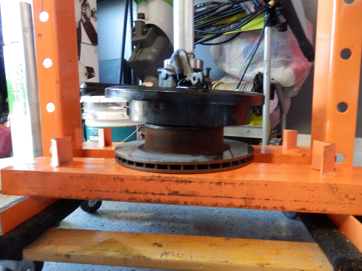

To support the whole assembly while pressing back together, I use an old 4runner rotor (never throw old rotors away, they make killer low pressure press tools for bearings and such!)

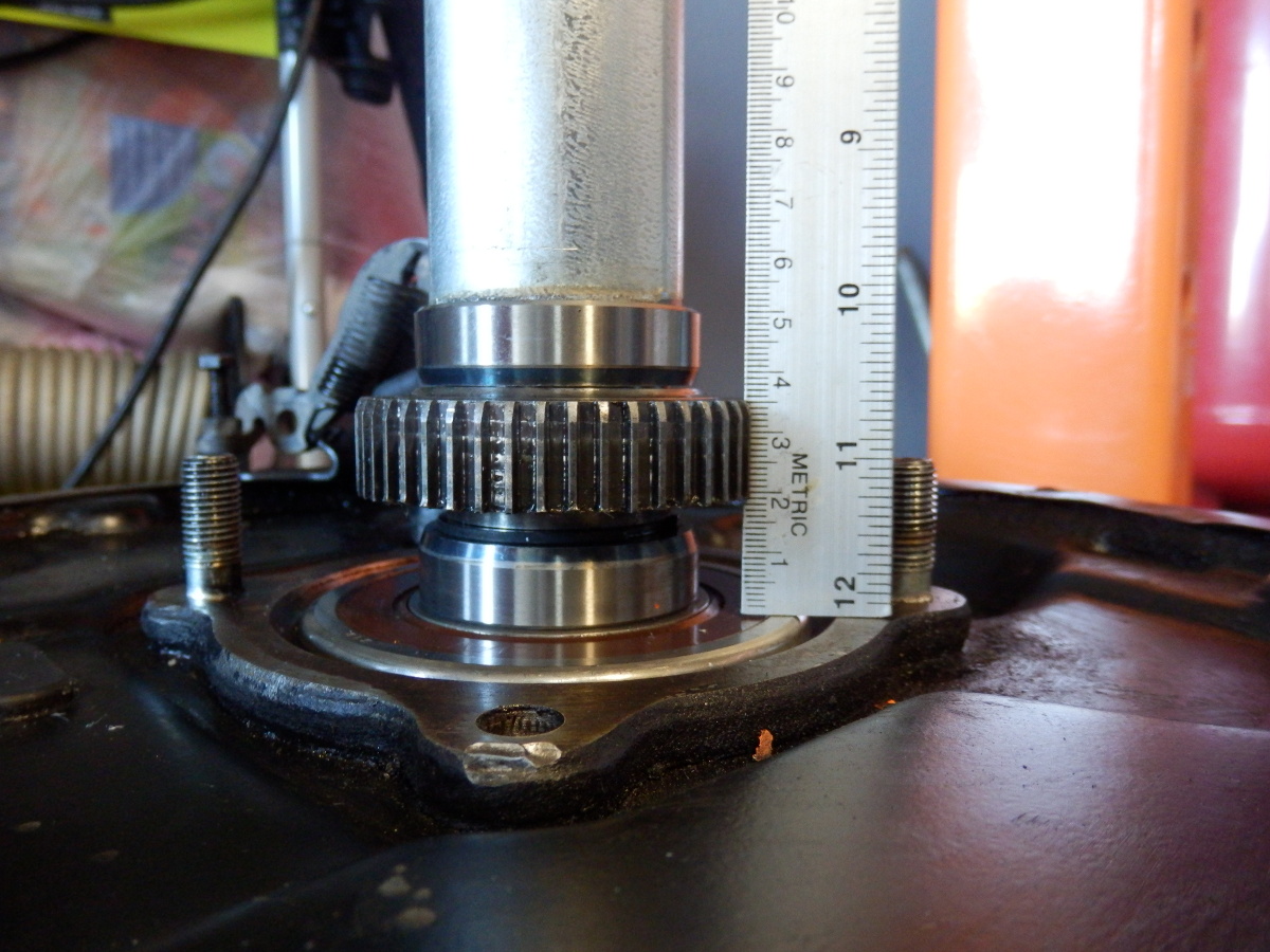

Setting the depth on everything. In this photo
- Bearing retainer pressed flush
- ABS ring pressed to 19mm (was best centered at 16mm)
- Seal race at 38mmish
Here is a photo with the ABS ring at 16mm

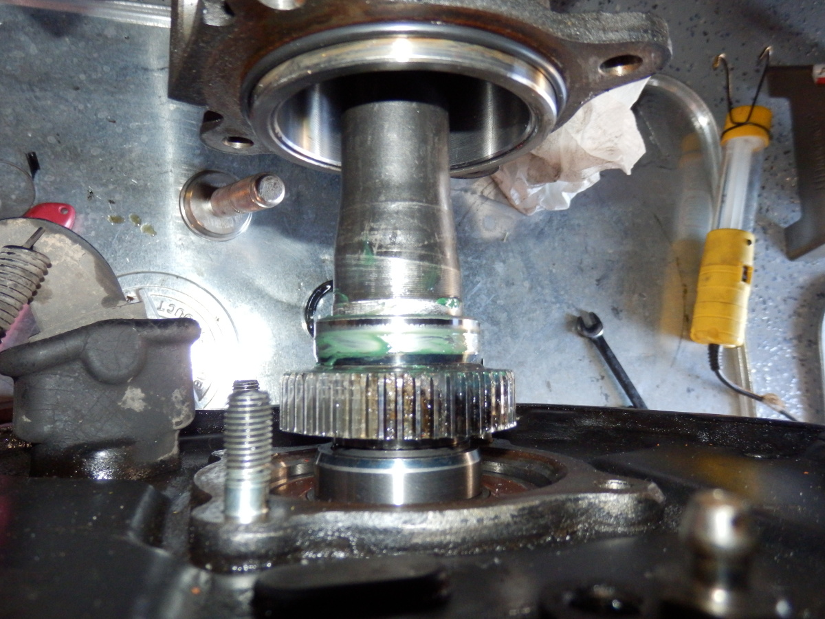

Quick grease test. This was not bolted up and the new o-ring pictured kept the housing from being flush - so in real world, this was close to centered on the grease test. Plenty good for me :)

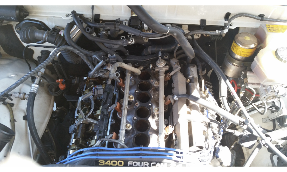

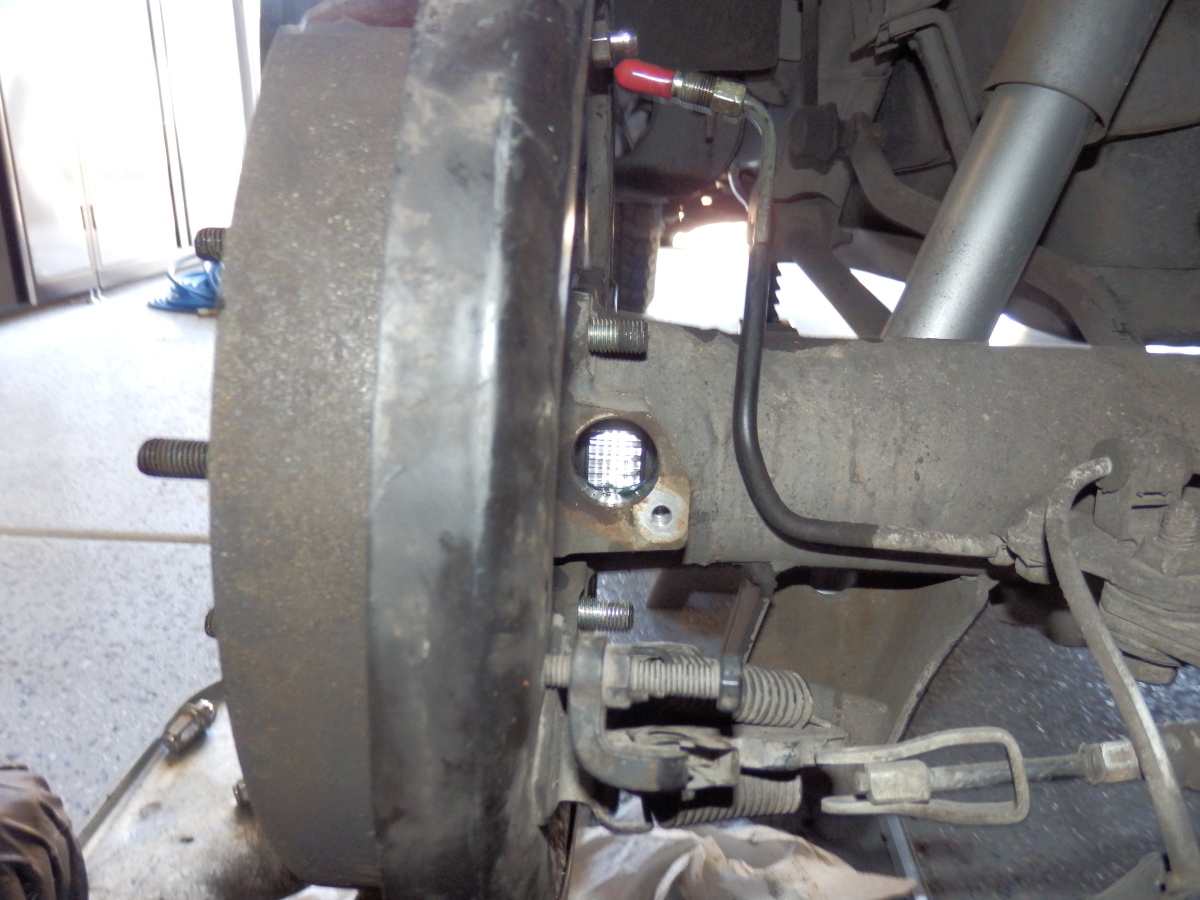

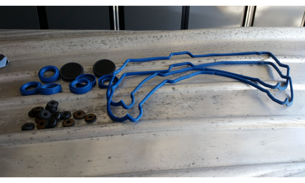

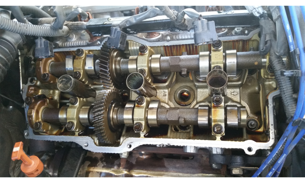

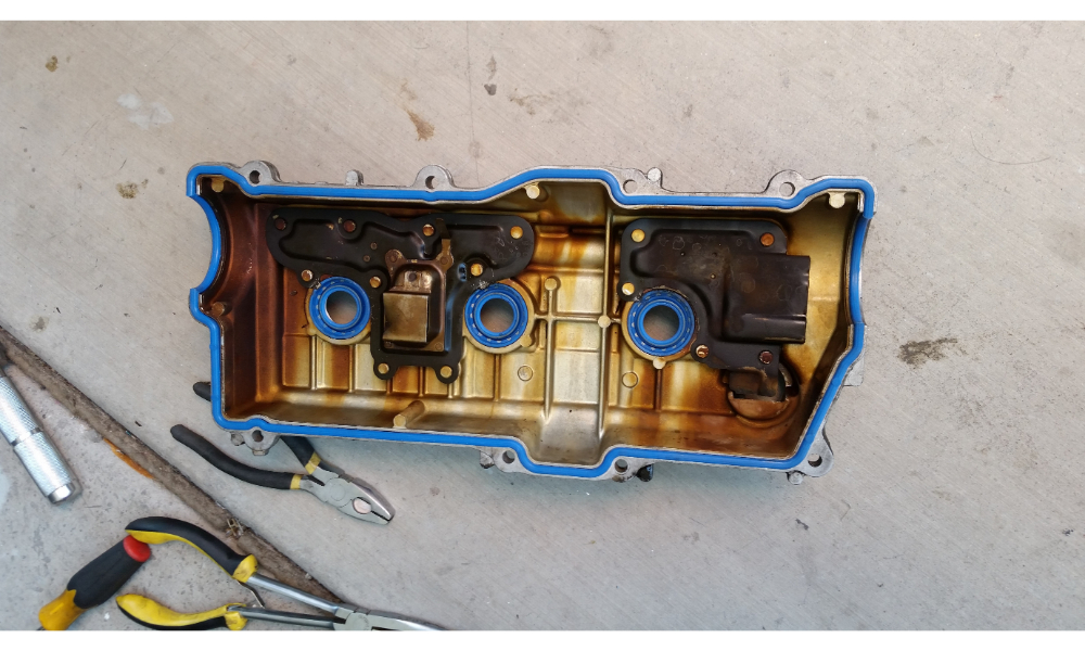

Been a while but wrenched on whitey this weekend. Replaced rear drums and shoes as it was time (no photos) but also finally knocked out valve cover gaskets. Went felpro on the gaskets themselves for this job as I feel they are better than OEM per previous experience. Felpro has come a long ways. Had great luck with them in subarus as their headgaskets are designed to combat the 2.5l sealing issues. I know some guys call them failpros when trying to use them in race applications but for me, no issues here! Their valve cover gaskets have been top notch for me.
Will not bore anyone with all the steps to do this job right as it has been done before. But some tips:
- Prep is EVERYTHING. Clean your valve covers thoroughly in the gasket channel. Use denatured alcohol as it works excellent at cleaning off oil
- Remove all 4 half moons and clean the hell out of them and the spot they sit in. These must be dry and squeaky clean. Reseal using FIPG or a good hi-temp RTV. I have had such good luck with permatex red on transmission pans, I started using it on applications like this. Has never let me down. For some reason I never have the best luck with copper RTV. Maybe just bad luck so I stick with red
- Same thing applies to the rear cam knockouts. Clean the spots they sit in thoroughly with q-tips and denatured alcohol. Make sure this area is DRY. I used permatex red again on the packing areas around the cam caps. Just before torquing down the valve cover (has to still be loose) reach back and make sure the cam knockouts are pushed all the way in. In every case, I find them not seated perfectly straight by a mm or two. You can feel them shift when you push on them. Once they are straight, press down on the VC and put a bolt in towards the rear to hold them in place
- Hopefully you let the car sit overnight before doing this job so as much oil as possible would have drained down. If so - their should be minimal oil on the seal mating surface of the heat. Use q-tips and denatured again and make sure this area is perfectly clean and dry

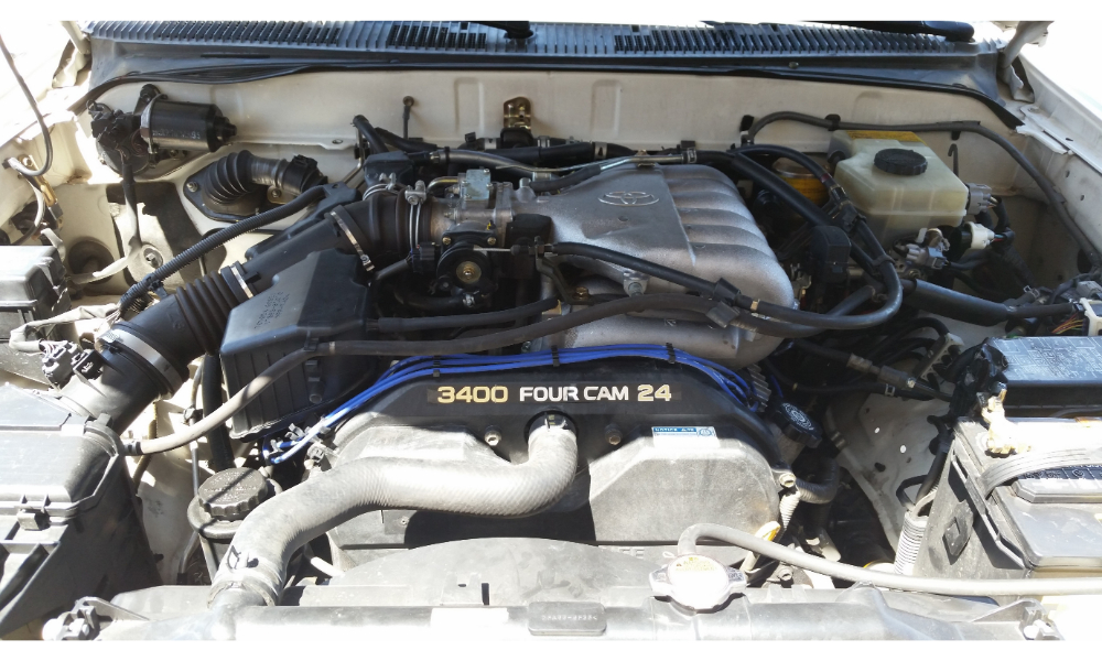

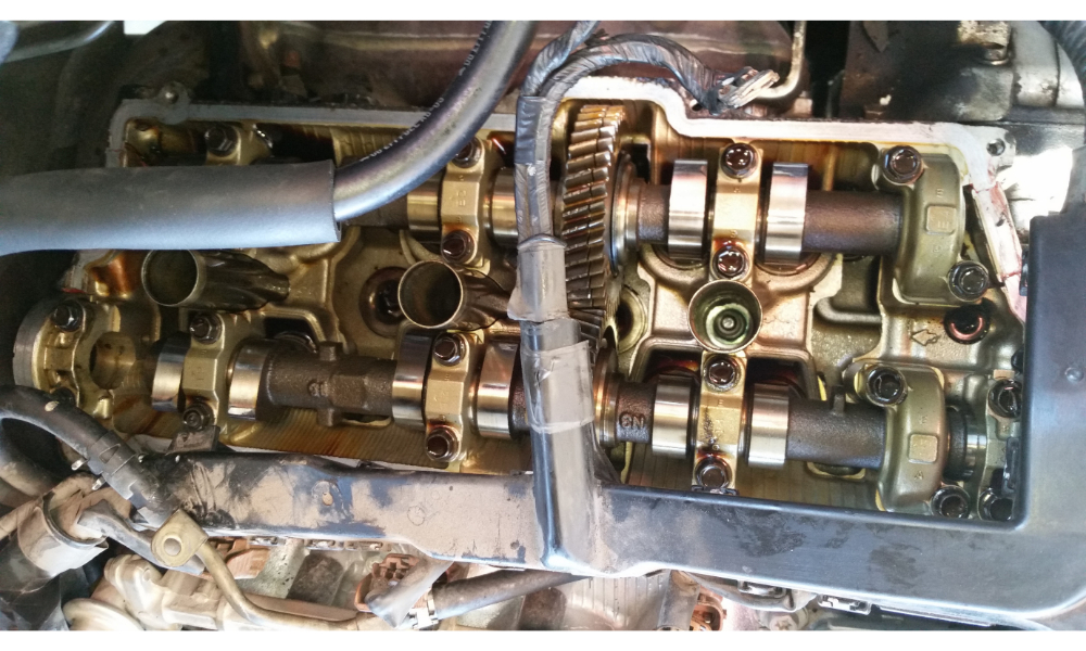

A few quick pics of the fun:
Pretty damn clean for 265K miles! Rotella and religious maintenance FTW. Pics taken before cleaning the seal surfaces. Had just reinstalled the half moons and knockout seals.
Ahhh it is nice again to have fresh air when switching to outside air - no more burning oil smell :)

It is not a total kit but partial sets:
- Cam plug seals Fel-Pro TCS 45979
- Valve cover grommet set Fel-Pro ES72422
- Valve cover gaskets + spark plug gaskets Fel-Pro VS 50422 R
