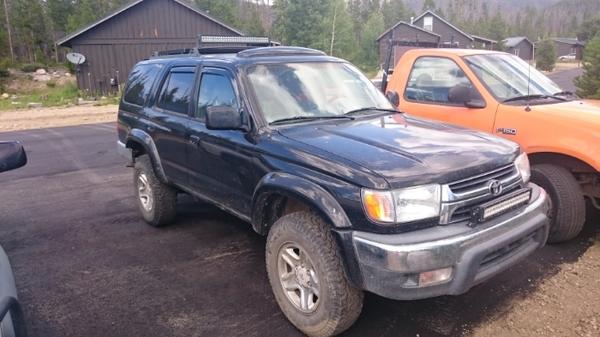

So It been a few months since ive updated my build but I have done a good amount of mods. So lets get to it,
As all of you with a sunroof know when its open that little bar that pops up to deflect the wind gets very annoying and ive been meaning to deal with it. Also the light bar up top causes a little buffeting at high speeds so I was hoping to fix both with a sunroof visor.

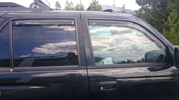

Also I had been looking at getting in channel window visors as well since they work so well to let the heat went out when the car is parked to help my 12v fridge and also are excellent when camping in the rain.
Everything was an easy install and i'm very happen with both. Sunroof open is very quiet and it fixed the light bar noise!!
all 4 windows cracked and sun shades in windows keep the car cool and batteries happy :bravo:
Links to the ones I purchased.
http://www.amazon.com/gp/product/B000182EU0?psc=1&redirect=true&ref_=oh_aui_detailpage_o02_s01
Amazon.com: Wade 72-88491 In-Channel Wind Deflectors, Smoke Tint, (4-piece set): Automotive

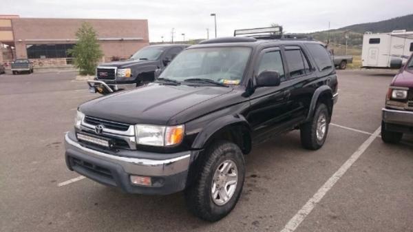

Thanks man, Idk about the rack yet but it will be a short one that doest cover the Sunroof. If I use it for lights I want them set back so I wont get reflection off the hood. Also I think im use a NMO mount for my Ham radio antenna and I want that in front of the rack but behind the sunroof.
