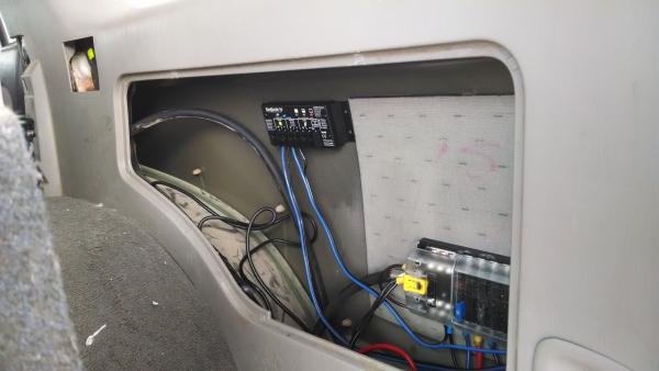

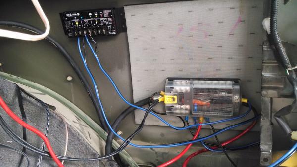

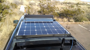

Finally got my 85w panel installed and my new morning star sunsavor. All in all im pretty stoked how it turned out, I copied an idea I saw on here by revmoving the rear storage cubby giving it way more room. I moved all the electronics to that spot and put a blue sea fuse box for everything.
I left made the wiring an extra 10ft so I can pull the panel off and lay against the car for direct sun when camping.
The 2 30w will be hinged together and brought along camping trips for extra juice.

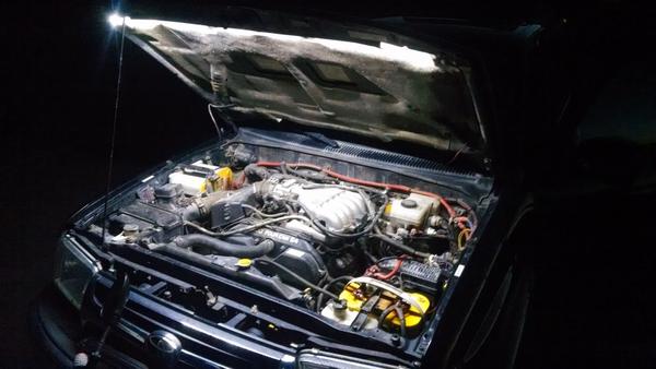

So I got an idea after seeing someone use LED's for a under the hood light. I have an old mercury switch I had from an old project.
I also had a 12v LED strip from another project I havent used yet. So I thought they would both work great for an automatic hood light. Everything went together smooth and only took maybe 30minutes. Ill have to wait until its dark to test it out.
8b0ac309-3536-4287-a257-b85532a5d0ac_zpsbyjtake4.jpg~original
The Mercury Switch
e587872e-7c12-4ce0-bb28-33671437cb96_zpstyxfbzpf.jpg~original
the switch being connected
14b5cdc9-17a7-454c-b5e2-c18d19441061_zpsjyno22zo.jpg~original
switch taped in the right direction, so when the hoods up its activated.
34a4f5d6-54ed-4812-ab7f-134ce015bcc4_zpsk1qkoccg.jpg~original
LED strip, The angle on the metal is perfect. I always added a few strips of gorilla tape cause I don't really trust the sticky side of the strip.
I will update yall with night shots when its dark.

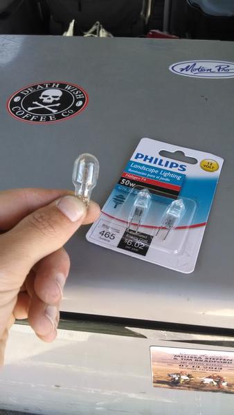

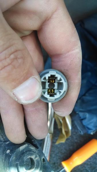

While I was still fiddling with my idea's for LED back up lights, I saw a post for using T4 50w bulbs in place of the stock reverse bulbs. They were only $6 shipped on amazon so I went for it.
I used Philips t4
http://www.amazon.com/gp/product/B001FA08YC/ref=oh_aui_detailpage_o02_s01?ie=UTF8&psc=1
All you have to do is smash the plug terminals together so it hold the new bulbs better.
Like the hood Ill do an update on the lights tonight.
How bright are those reverse bulbs? Compared to stock. Is it truly bright white?
I didnt do a side by side comparison but so far i'm very impressed. I don't even feel the need for the led bar backup light I had planned, but time will tell.
