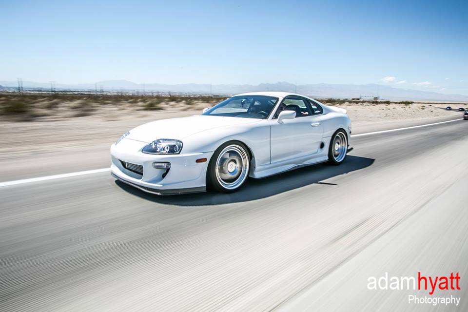

Had a friend come over today and snapped a couple pictures of it. Still working on the little things but I am extremely happy with the progress so far.
