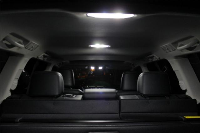

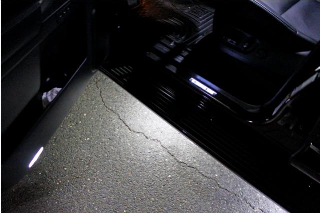

-Interior lighting is terrible if you have children. No driver controlled dome light. No 3rd row dome light. Terrible rear cargo lighting. Especially if you are using this vehicle to camp.

I tow a small bit and I found installing rear airbags (Airlift or Firestone) eliminates the sag on mine, filled to 60% or 20psi, with 400lbs on the tongue and 300lbs in the rear cargo area. Plus, the ride remains compliant when you air it out when not towing or being loaded. Lifting the vehicle will still not solve your sag issue unless you get HD springs for the rear but then causes the rear to ride like a HD pickup. As for the interior lighting try replacing them with 5K LEDs from like v-leds.com or similar. It's true lighting is poor in the foot well areas. As for the power, a V8 option would have been nice but with all the +40mpg avg requirement that may never happen. Try towing it in 4th gear, in some of the towing discussions it keeps your tranny cooler, gets better mpg, prevents gear hunting and is more responsive.
