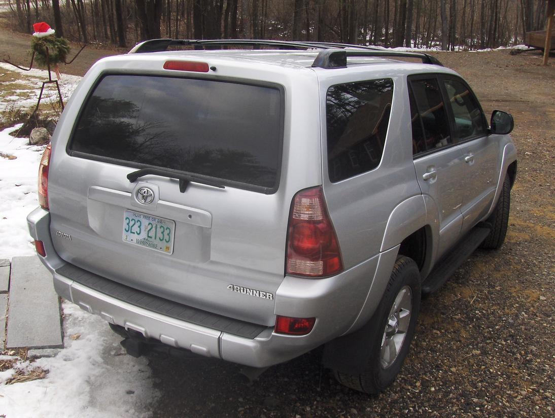

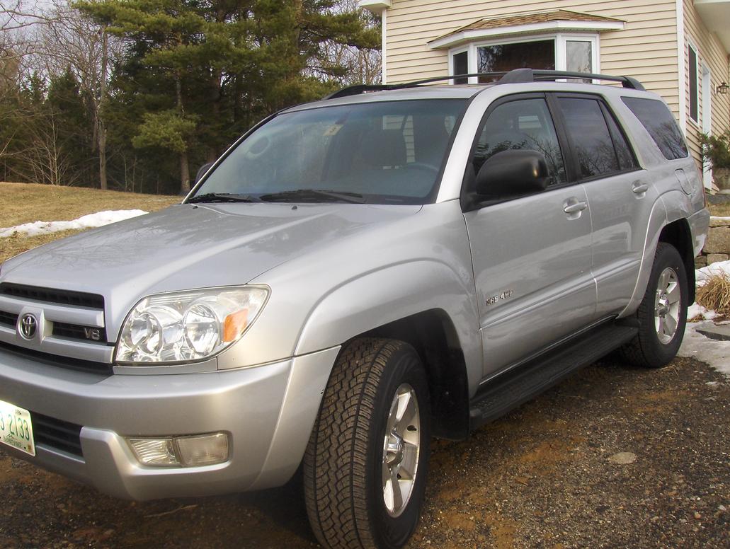

Bought a 04 Honda Pilot for 9,000 off a used car lot and found out it had torque converter rumbles. Returned it back to same car lot and traded even for this 4Runner. I think I made out even better. What do u think? This V8 is a beast! Came with new tires, moon roof, tow pkg, and remote starter. I found out that it is a one owner truck from Boston and I called him. He said it has been serviced regularly at Toyota except the timing belt. It never towed anything and was only in 4 X 4 a few times to get out of snow in the driveway. He's a single guy and a businessman which explains the clean interior. I need to bring it back to the used car lot though because I am hearing creaking noises when going slow over bumpy roads. I think it may be worn bushings but really dont know. Otherwise its in great shape. Hopefully the used car lot can fix it under the one month warranty. Perhaps I should buy new shocks as well and have the mechanic install those too? Any suggestions?

Congrats on the new buy. Definitely check to make sure it will easily switch into 4LO, I've read cases of folks who buy trucks with 4WD and it won't turn into 4LO. If it works, great, if not, and you plan on using it, then you'll want to make sure it gets fixed....to pay out of pocket, I hear it's quite pricey.
If you keep it, make sure you switch it into 4LO at least once a month to keep it lubed up and working correctly.
Otherwise, can't think of anything else.....just pay attention to little stuff when you're driving!

Its a 2004 and just turned 148,000 miles. Not a lot of rust underneath (typical New England rust) and no leaky actuator or any other spots that I could see. However, today the check engine light came on along with the VSC and Trac Off all at the same time???? Its going back to the used car lot dealer tomorrow for them to check this out. Possible 02 sensor? Or are the lights coming on connected to the fact that it makes creaking noises like the sway bar bushings or control arm bushings are bad???
148k.... get the t-belt and water pump done...better safe then sorry... As for the CEL, the vsc and trac off will come on when the CEL comes on, they will set a code saying the engine has a fault code, just the way it works...Anyways if you decide you want to bring it to another shop to look at it. Let me know, Im a tech at a specialty independent toyota shop... shoot me a pm if interested. Thanks
