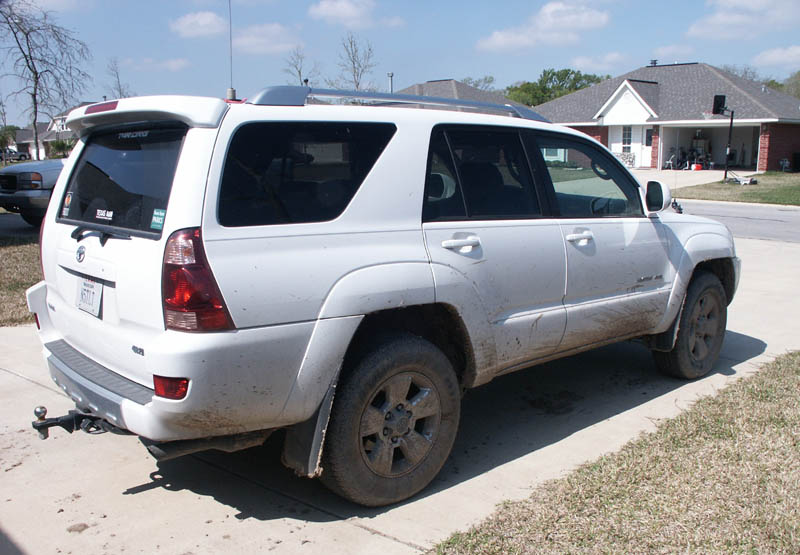

But, she does enjoy getting dirty these days...here's a recent pic (she's been MUCH dirtier, tho):

Mud!!!When did you find time to get muddy?
I'm taking a week off and heading out at 5am tomorrow in search of mud, trees, dirt, rocks, nature, you name it. Expedition mode on.:cool:

I found this mud taking a shortcut while hiding the "foxes" in our last transmitter hunt. ok, so the "shortcut" took me waay off the side, through a bunch of mud, down a few extra roads, and then back down the road a couple of blocks... my 4r wanted to go have fun, who am I to keep her from having fun! ;):
