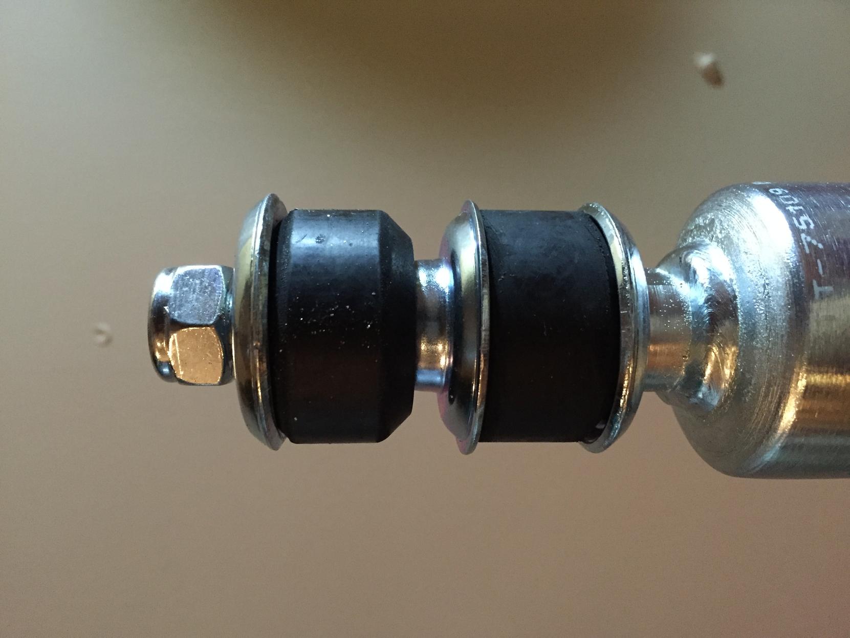

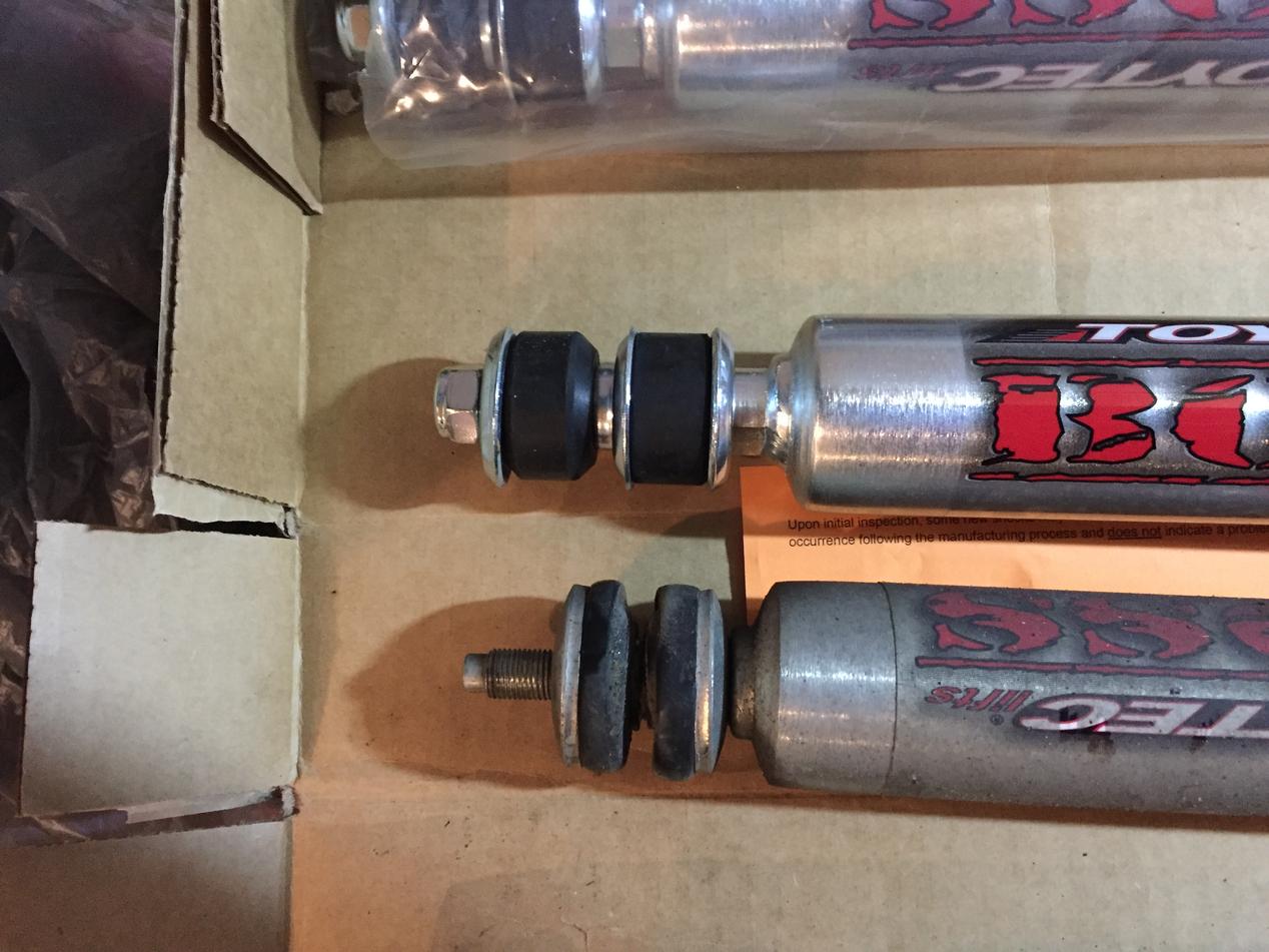

Got my replacement shocks in today and got them installed. Definitely different. Bushings are narrow but thicker and fit into the grooves of the mounting point. The lower washer also had a lip, i'm guessing they did that to help ppl center the shock on install.
In the second picture, new shock on the top vs old on the bottom.
