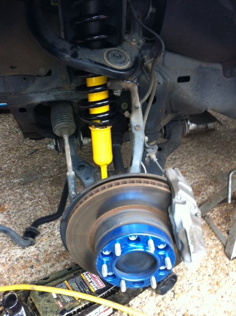

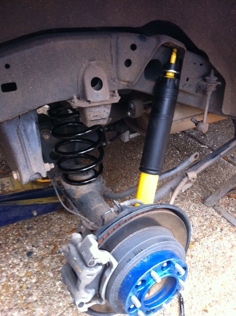

Installed an OME lift yesterday, with help from my brother-in-law. After 6 hours, it was a success! I did break a @&$% ABS sensor line so I'll have to figure out how to get that fixed..
Anyways, the details:
Replaced my Daystar 2.5 / 1.5 with an OME lift:
Up front:
885 Coils
OME Nitro Shocks
.5 Top Spacer
Toytec Diff Drop
In the back:
Toytec Superflex Coils
OME Nitro Shocks
I took before & after measurements from the center cap to fender. Please note, these aren't stock measurements, but measurements going from a Daystar to an OME lift. I was hoping to get an additional 1.5 inches and even when the lift settles, I'm confident I'll be there.

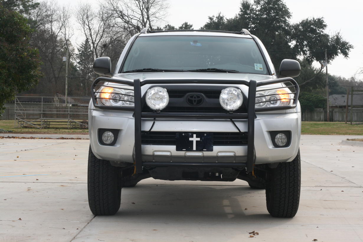

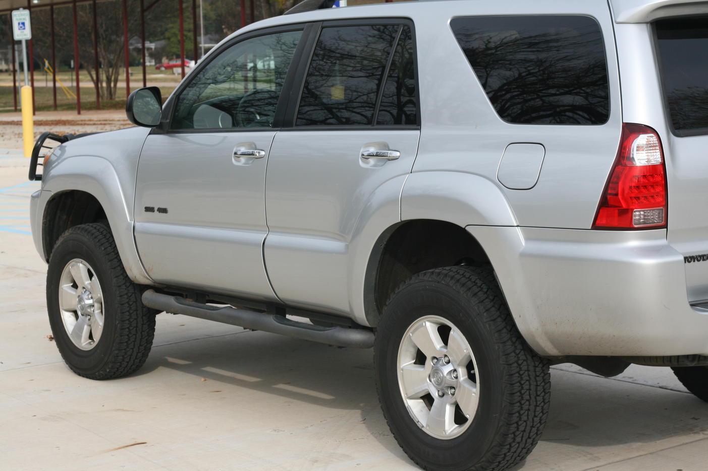

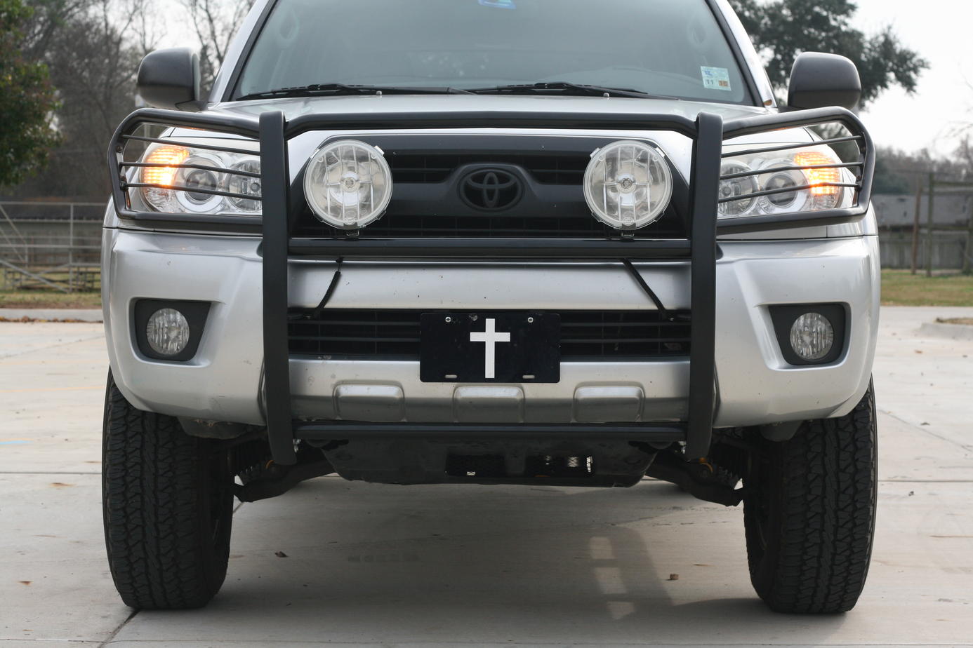

So, before things settle, I gained +2.5 inches in the front and 1.25 inches in the rear. Onto the pictures! Oh, I never took pictures when I added the brush guard and Hella lights.

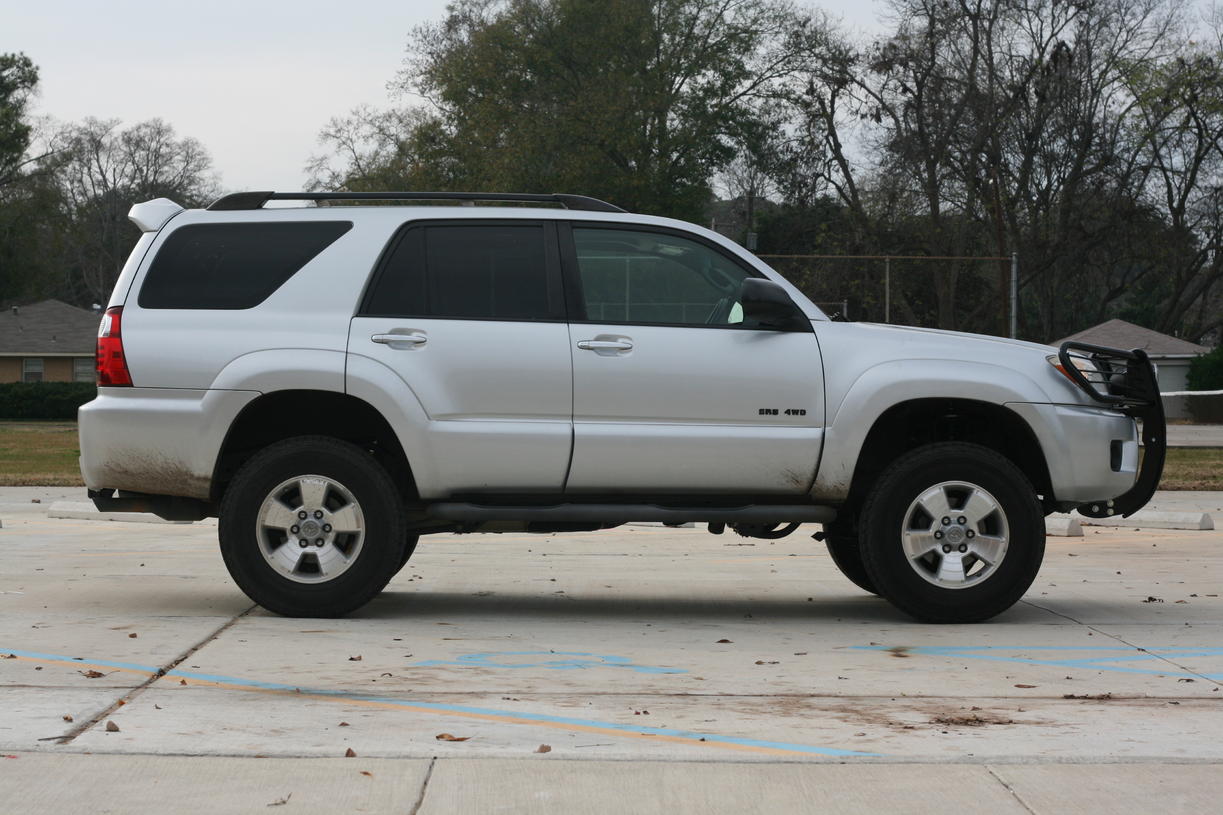

More Pics - OME

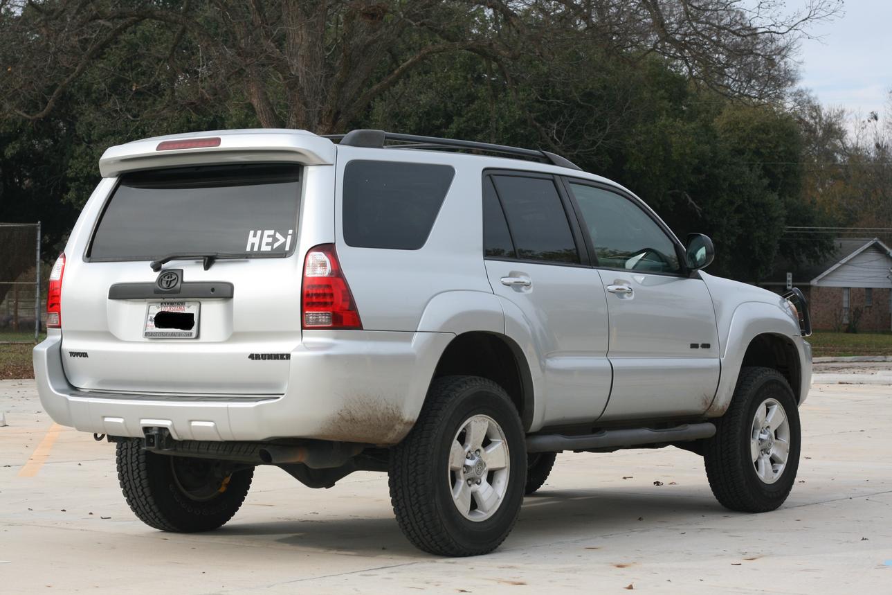

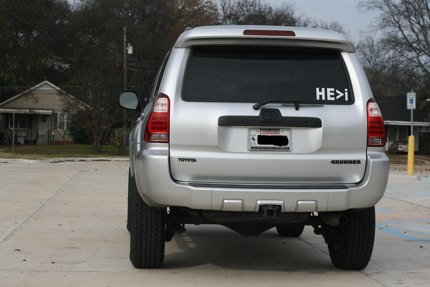

After pics
After Pics
More After Pics
Alignment
Got an alignment today and the difference is night and day. My 4R is still stiffer with the OME suspension, but it drives so much smoother after an alignment.

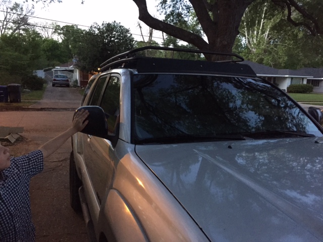

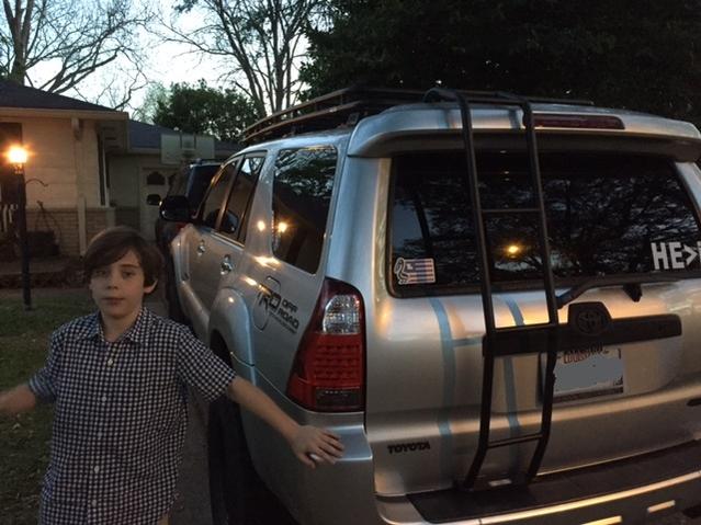

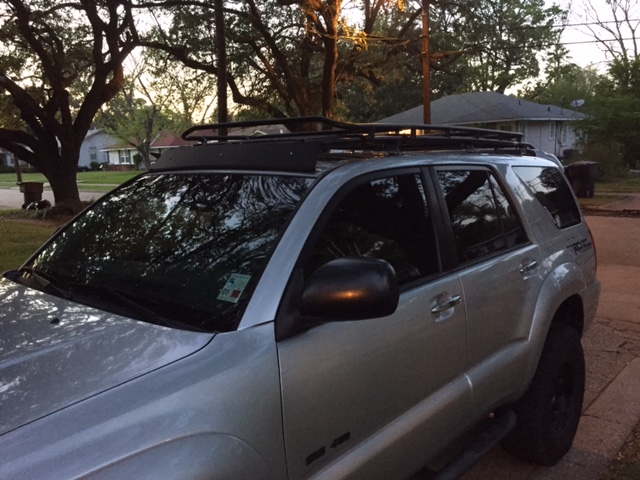

Finally, after 20 weeks, my GOBI Stealth Rack came in.
I haven't updated this thread in a while and my 4R has definitely changed since my last post. I'll update with pics after the weekend.
GOBI Rack Installed
Installed the rack this weekend. It was a pretty straight forward install.. The instructions were detailed and this forum (plus a few YouTube videos) were helpful! Sorry the darker pictures -- I plan on posting new pictures when time permits.
Now I just have to figure out which light bar to get ... :)

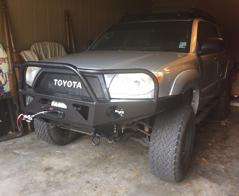

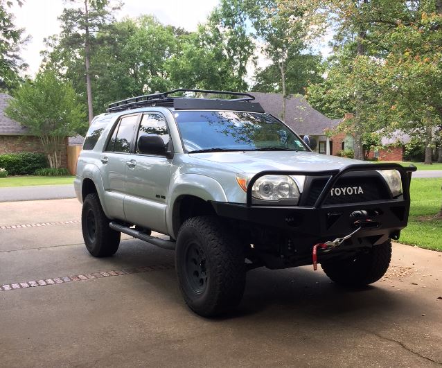

CBI Bumper
Installed the bumper, PIAA 510s and Warn VR8000 winch. I love it and my 4R rides so much smoother. I went with the 885 springs when I got my lift and the additional weight of the bumper really increases the ride quality.
