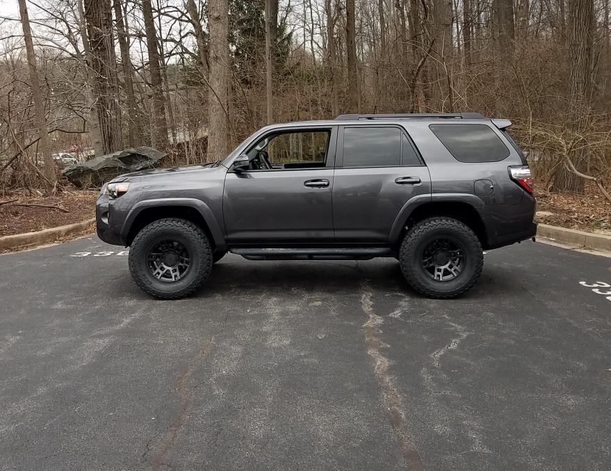

And here's our 2/1.5 on TRD pro stock wheels and tires.

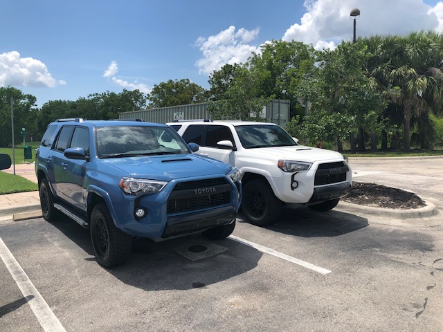

After a bunch of texts back and forth with Jason and even a phone call, I decided on the 2/1.5 lift kit! Actually, I should say lift kits. The wife and I are both getting the 2/1.5 kits for our Pros. Ordered Sprint Boosters for both of us too! Yes, we have almost identical vehicles... long story.
I've been into performance vehicles for 20 years... hotrods, off-road, etc. And Jason provide some of the best customer service to date. Super nice guy!
I'll post some pictures when I get the kits installed. Now I just have to decide on tires... 275 or 285, and Toyo R/T, Nitto Ridge Grappler, or KO2?

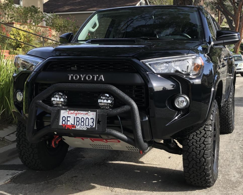

Very pleased with my 1.5/1” kit with 275’s. No rubbing whatsoever in full articulated angles. No mods required and I like having mud flaps. I do think that the 2/1.5” with 285’s is probably the best looking setup and I may think about it in the future. Jason was great to deal with and I purchased a Sprint booster from him also.

That looks really good.

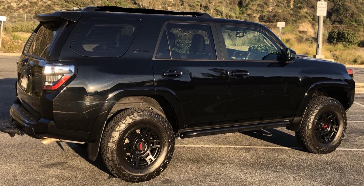

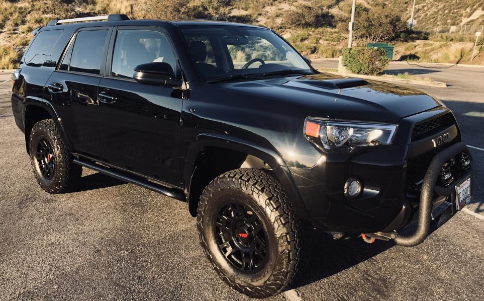

Yes it was. This is a reputable shop in So Cal that other forum members use and really like. I couldn’t believe it myself when they said, $50 for the spacer install and $120 for alignment. I went back to have my Shrockworks sliders installed and I will continue to use them. Pic with sliders installed.

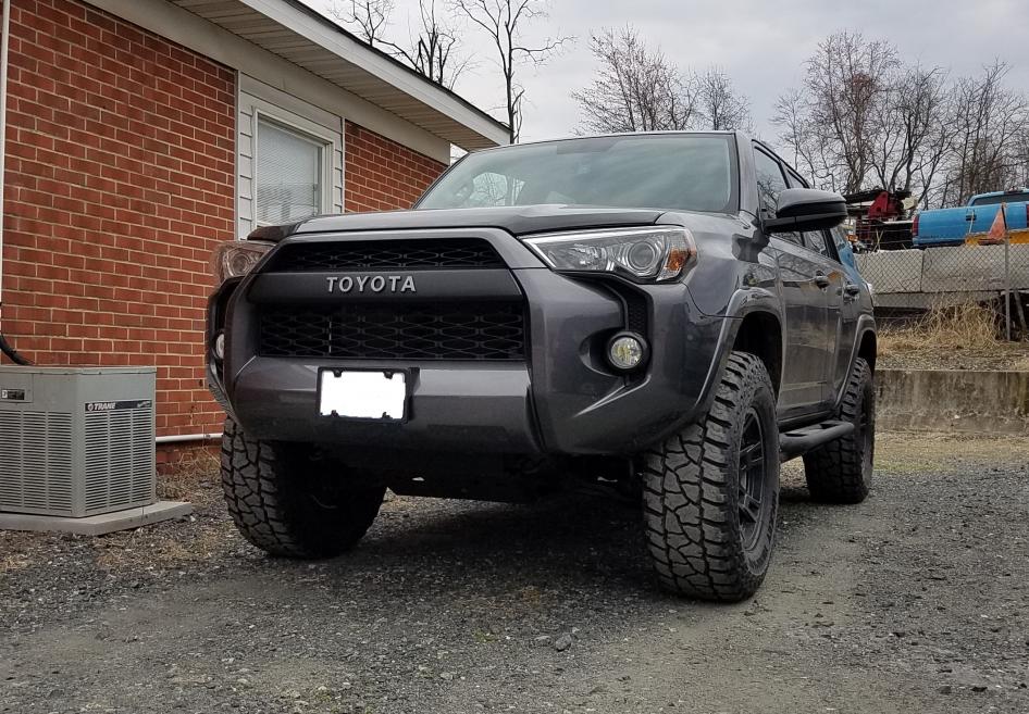

TRD Pro suspension, 2" rear cornfed spacer, 3/8 front cornfed top hat spacer, 1" ToyTec lower spring seat preload spacer. Gain is 2" rear obviously and a total of 2.5" in the front over stock SR5 suspension. 295/70/17 Mickey Thompson ATZ P3 tires, no BMC, nothing but a fender liner mod, no rubbing at all.
