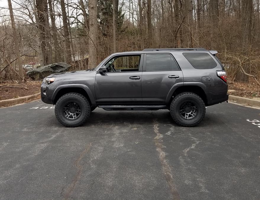

Step into the 295 world! You'll be happy you did.

It's actually really funny you mention that. I hadn't thought about 295s at all until recently but I've been seriously looking into them. With Kings set at 3" I'll have to see how much I'd have to trim. Did you have to do much?

I'm lifted 2.5" front 2" rear Nothing but a fender line mod and bumper trim. No BMC needed, no rubbing. Wheels are 17x8 with 4.5" BS and 0 offset. That's the golden number for the best possible fit and least amount of issues with rubbing. Here's mine when it was only lifted 1.5" front and 1.5" in the back with 295s, same wheels, no rubbing. This is on road of course lol.

I don't exactly have your Cornfed kit. I have the 1" ToyTec lower spring seat with a 3/8" Cornfed top hat spacers up front. With the Pro suspension, that gave me 2.5" over stock SR5 suspension. In the back, I have 2" cornfed spacers with Pro 5160 shocks.
They are FX Pro wheels in gloss gunmetal. Wider, lighter, better back spacing than stock Pro wheels. All around much better fit for a larger tire, even a 285.

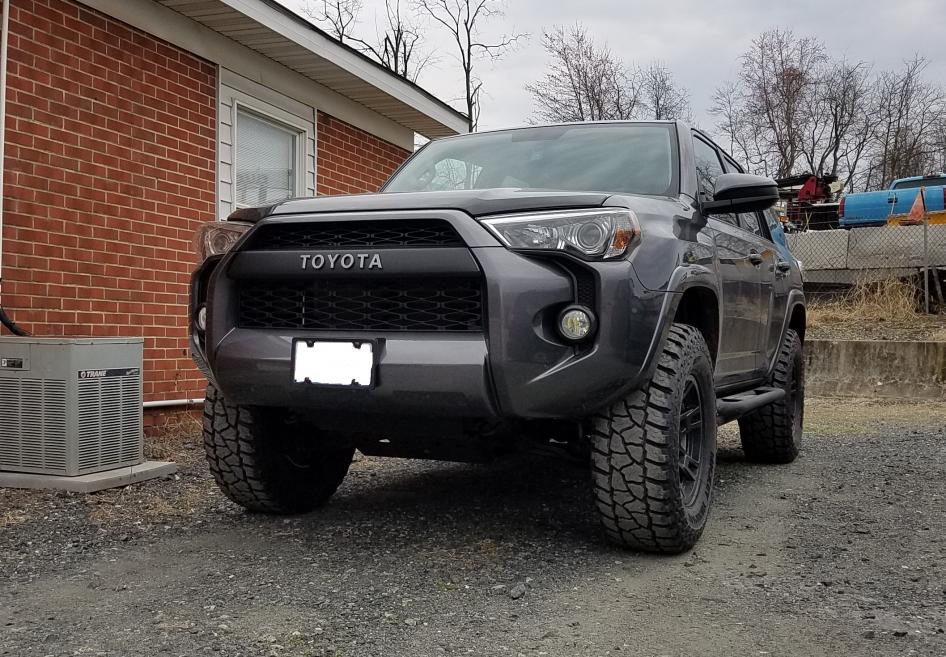

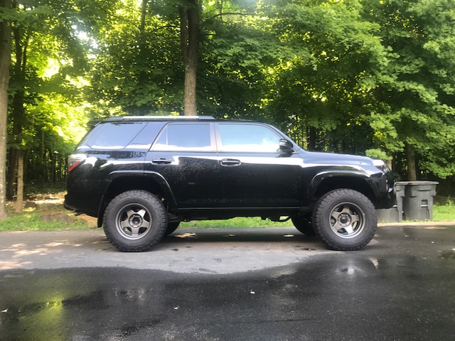

Hey Guys,
I just purchased a TRD Pro for my wife and she ended up wanting a lift... I didn't want to drop $4k on Kings/Icons for her to just use it as a daily. I came across this thread a few weeks back and became interested in the Burtman spacers. I got in touch with Jason and he suggested the 2/1.5 kit. So far I'm beyond impressed with the ride quality. In all honesty my wife keeps telling me its more comfortable than stock... I personally took it out on a few local trails to check for rubbing during articulation and I honestly cant believe how solid the suspension felt.
Here's a crappy cell phone photo for now, but expect some much better photos to come soon. Also, we're bumping up to a 305/70/17 from the 285's that are on it now.

Nice, glad you like it and happy to help you out! And yea, you wife isn't crazy. I've had people say this before. The front spacers are a split spacer design, not one big spacer like most do, this splits the tension and makes the ride quality awesome, some say it feels better than stock! I added my logo to the pic and hosted it:

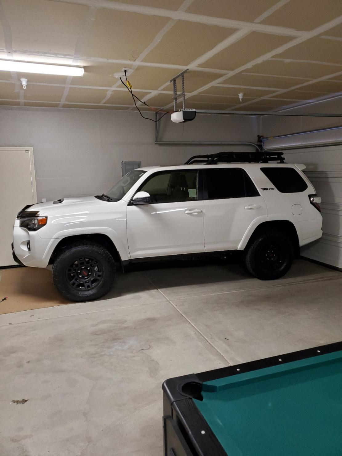

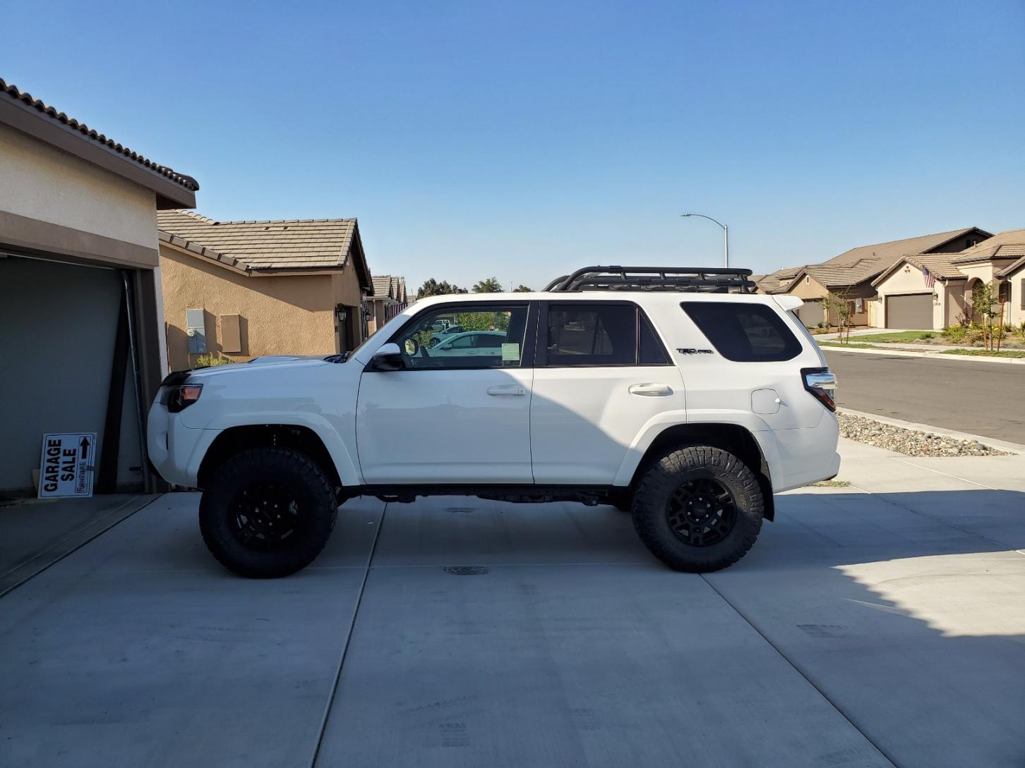

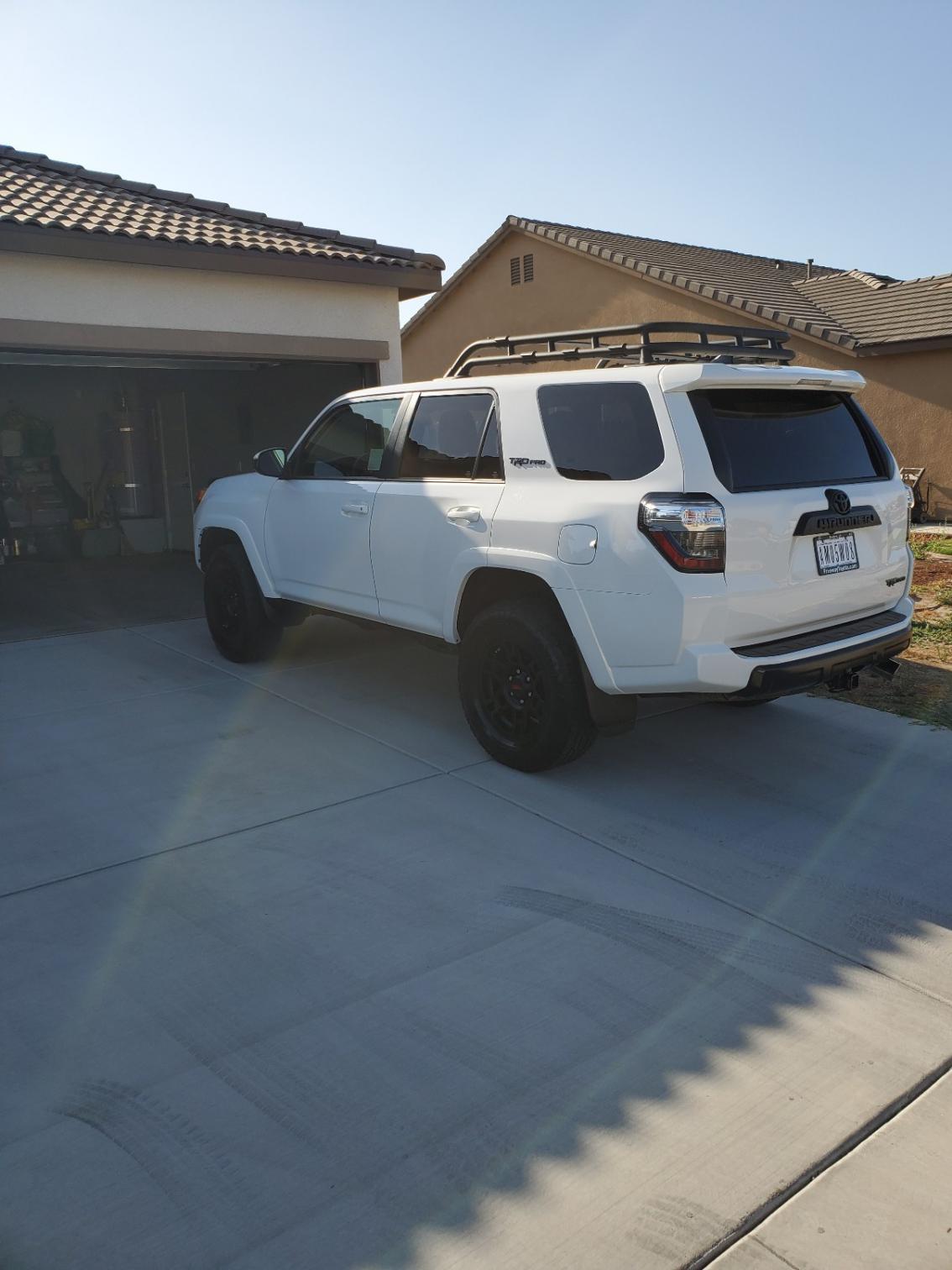

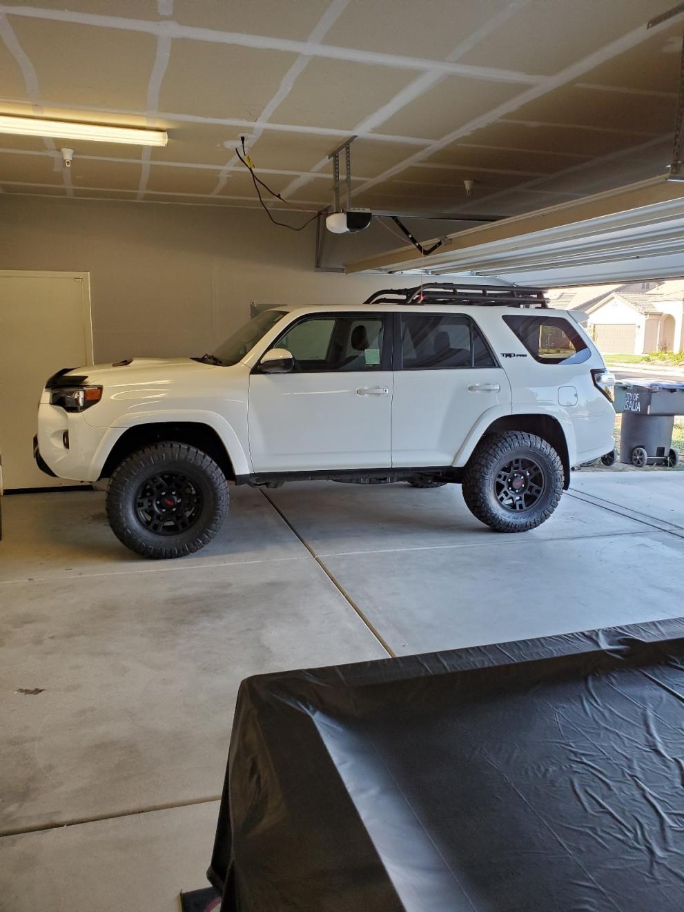

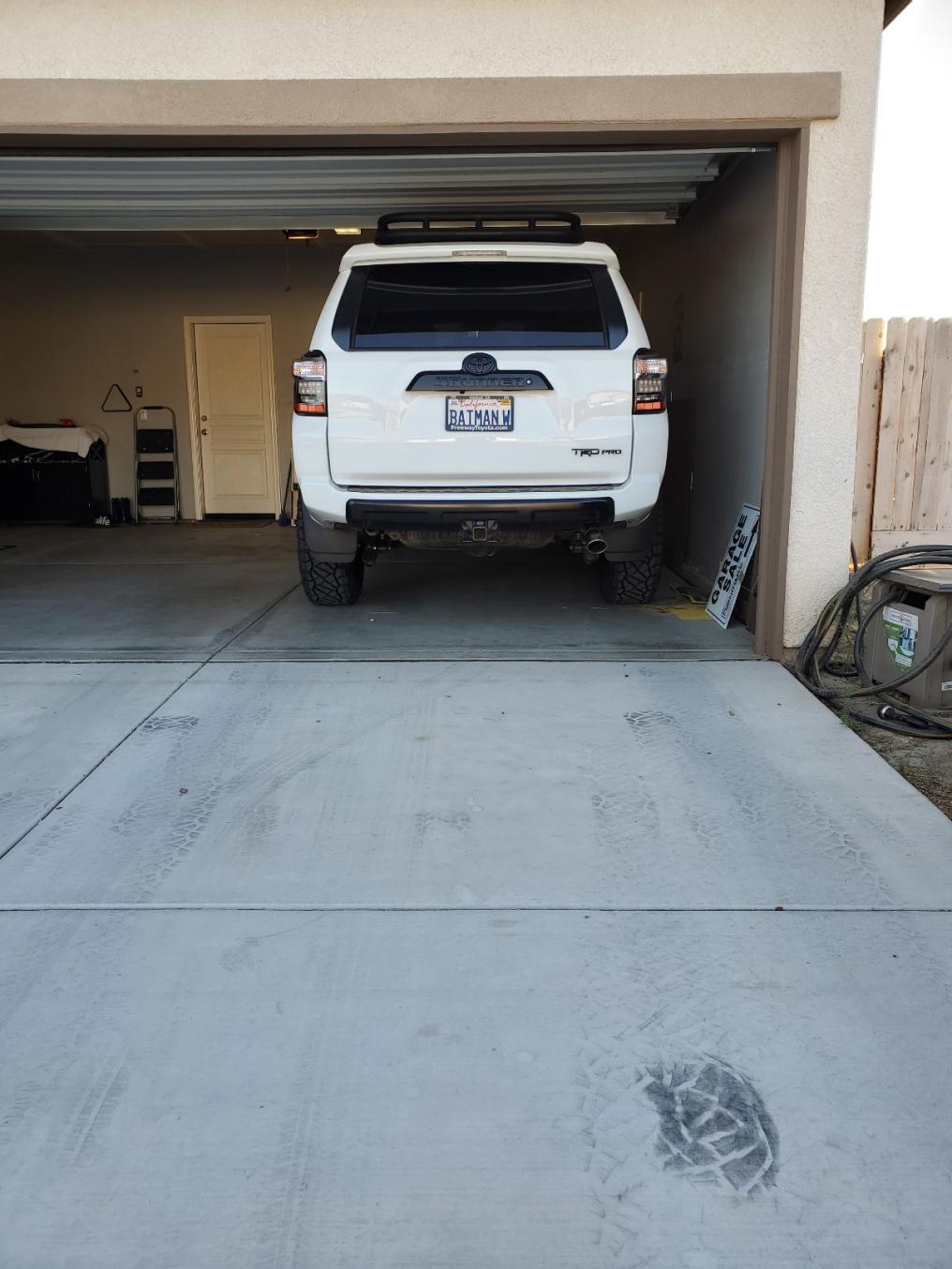

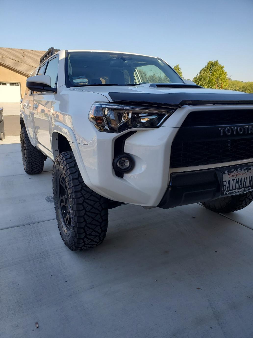

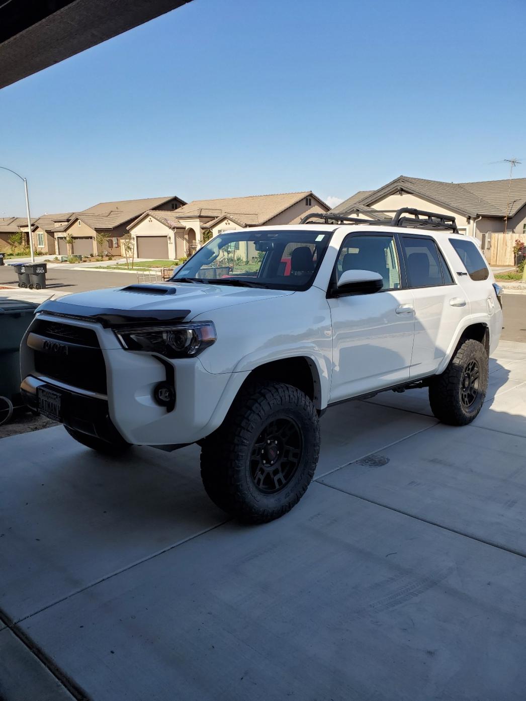

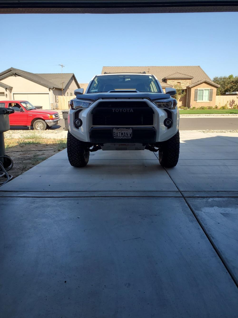

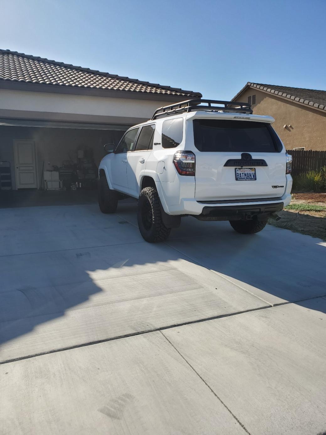

For you 2019 TRD Pro guys who are having trouble finding which lift to do and what size tires you can have...here you go!
Just put on my Cornfed 2"-1" suspension lift, spidertrax 1.25" and Nitto Ridge Grappler 295/70r17. That's right we can have 295s on our 19 Pros. Got to lose the front mud flap and that's it.
All parts were ordered from Burtman Industries. Jason the owner is awesome! He will take care of you, if you find a part you want somewhere else just ask him he can get it for you cheaper.
Enjoy before and afters! Absolute perfection

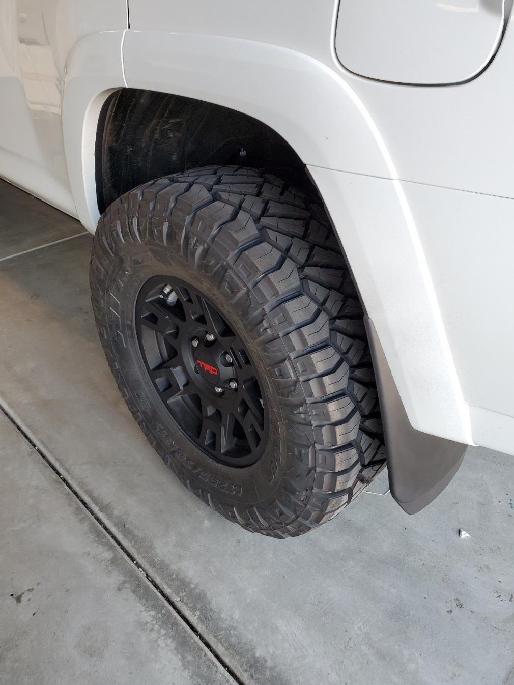

Here's a close up of the Nitto Ridge Grappler 295s. They look very beefy I love these tires. And with spidertrax they look amazing down the side of the Pro.
Any rubbing ?
Very little only on backing up at full turn. I will probably have them take a little off the body mount since I will be taking it offroad. They are going to do a pie cut and reweld so it looks like nothing was done.
