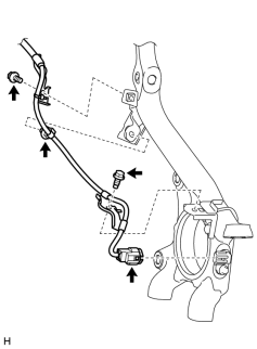

There are 4 clamps held on with 10mm bolts that can be taken loose to give it enough slack.
You can get by with just taking the middle 2 loose really.The one on the UCA and the top one on the spindle.
